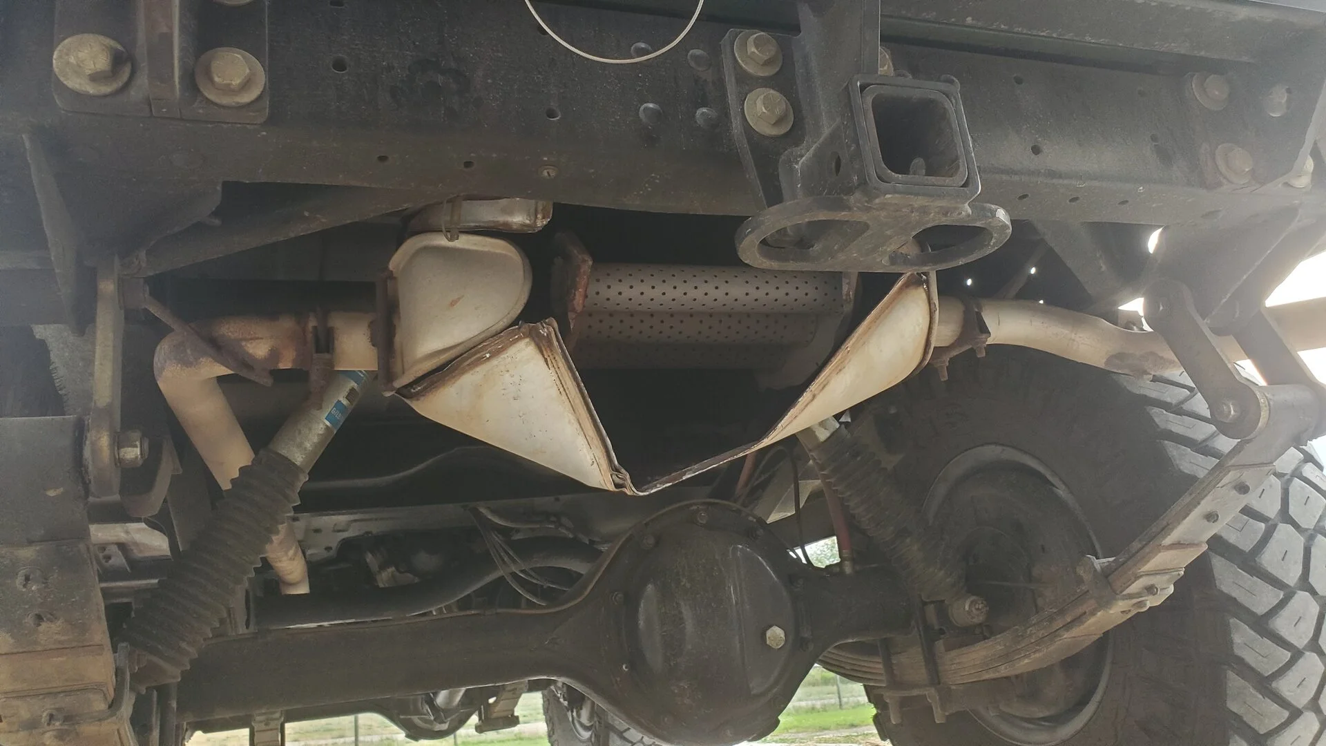

That muffler sounded like a pipe bomb blew up in my garage! I’m pretty sure I’ve tossed hand grenades that weren’t that loud!
Whoa. What happened to the muffler?
My guess is some unburned fuel, for whatever reason, found its way out the exhaust and ignited once it got hot enough.
I had the exact same thing happen to my FJ55 a couple years ago. Ended up having bad timing and burnt #5 valve.
That would be my guess as well. I had to run home in a hurry yesterday because my dogs were attacking a fawn, I ran it hard on the way home and shut it off pretty fast when I got home. A few hours later after I finished up with some other stuff I started it up to back it in the garage, as soon as the engine fired the muffler exploded.
My theory is that some gas vapor built up from running it hard and shutting it off so quick, then the ignition from the engine set it off.
It would be a great time to check valves-timimg-carb.
I did pour a full bottle of Seafoam in the tank on Monday night when I topped the fuel off.
Holy sh*#. I would have crapped myself. Crazy to think that just by starting it up again somehow it was ignited all the way back there.
When mine blew, I had a hot weather non-start, and hit the key right away without waiting a bit.
Engine had a hard miss just after. Ended up pulling the head and replacing #5 exhaust valve. Right after this, a friend asked me why I was running with the timing off so bad. He spent a solid 5 min resetting the timing and haven't had a problem since.
