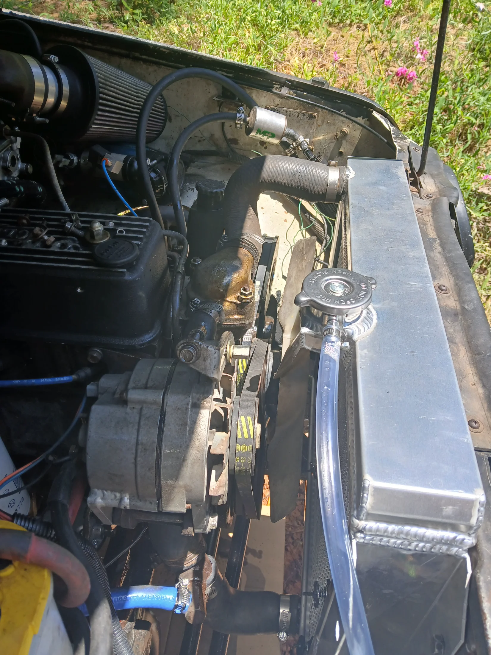

I run an aluminum crossflow, double pass radiator in my pig with a LM7 and use the chevy clutch fan. I have done 85 up hill in 115 degree temps with the AC on. I do not worry about cooling with my setup.
Can you post some pics?
Thank you.
