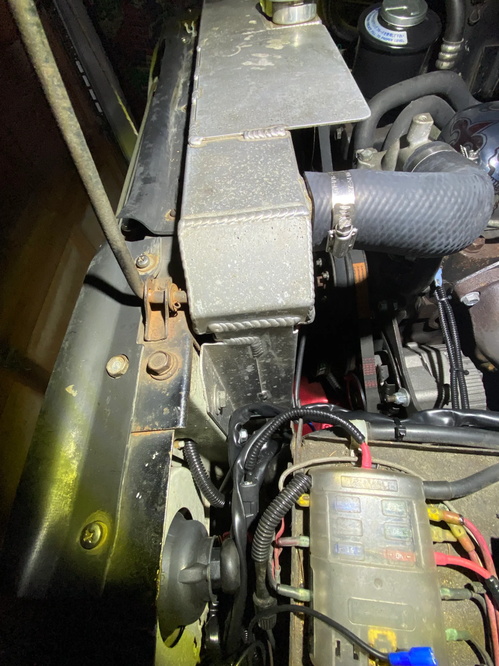

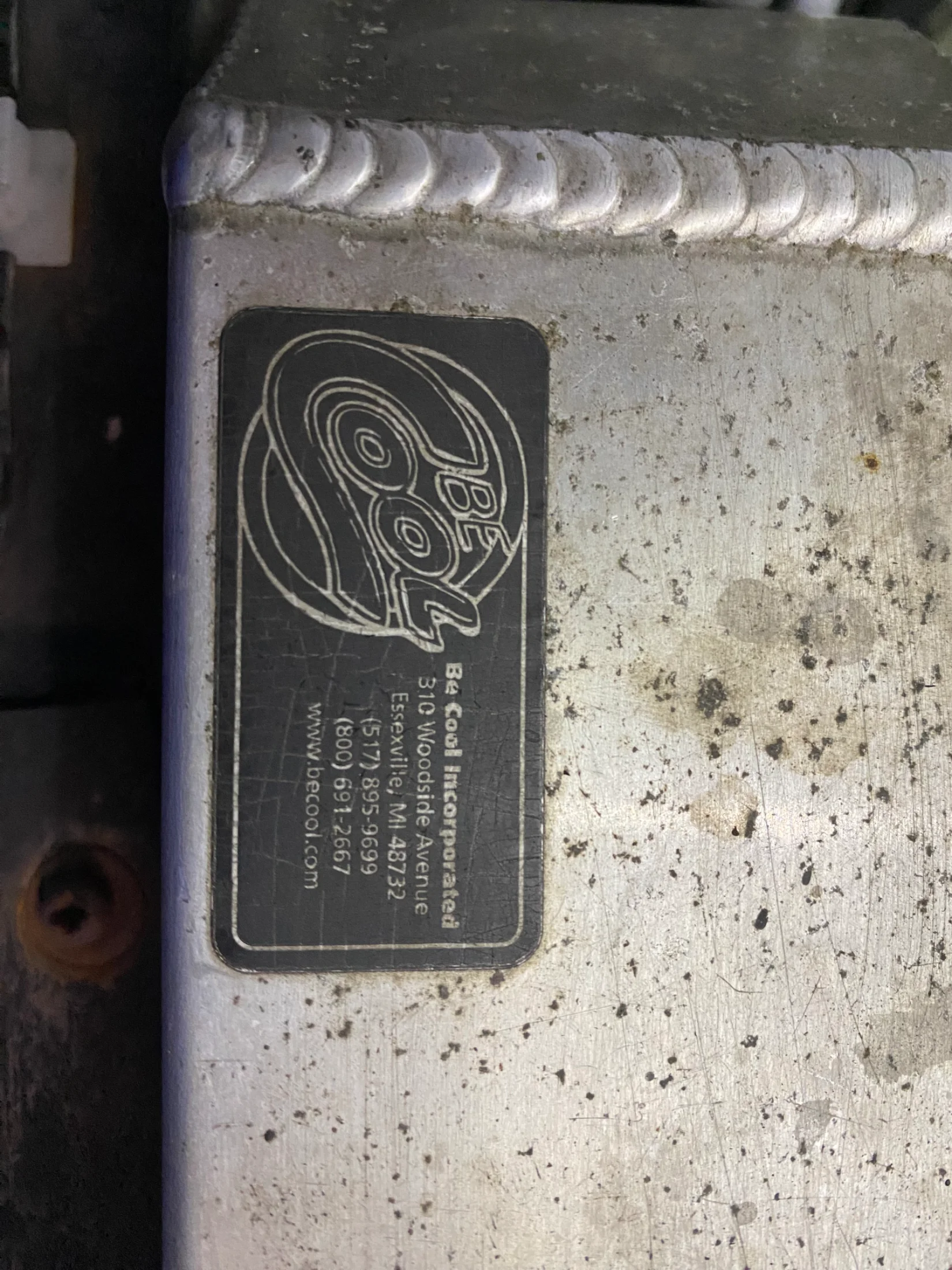

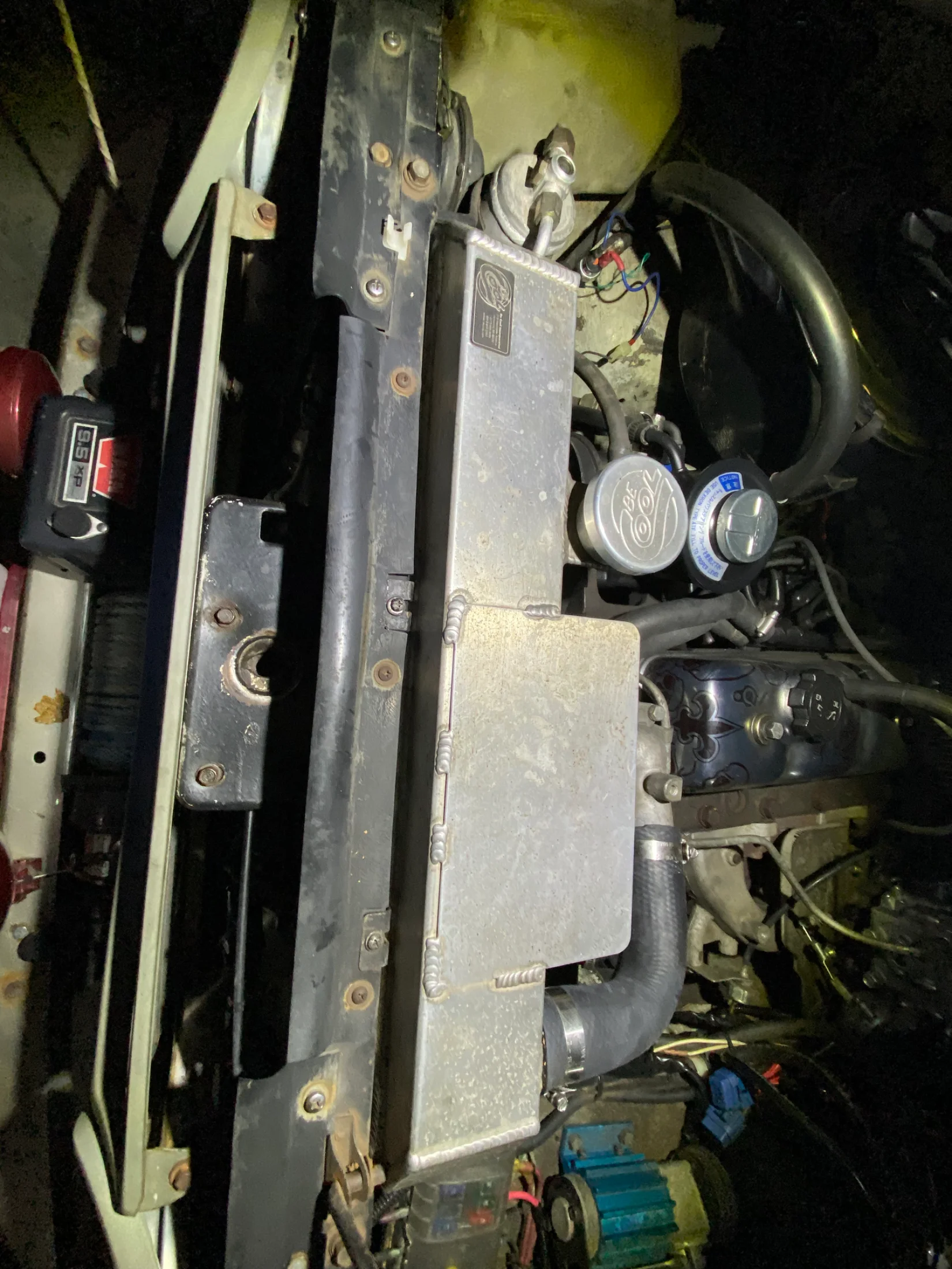

Just went through this too. I got an old OEM style rad from LCMoneyPit and had it recored. Cost about $800 to have done properly. Works great. I had a Be Cool Aluminum radiator in there prior. As JMack mentioned earlier, it was stout for an aluminum radiator and clearly well made. It lasted for well over 10 years but I am not sure if they still make them. They do make a 40/45 version but I’m sure if you call them with dimensions, you can get more details about availability. Including pics of what I had before I pulled it. I believe they are US made in Michigan.
