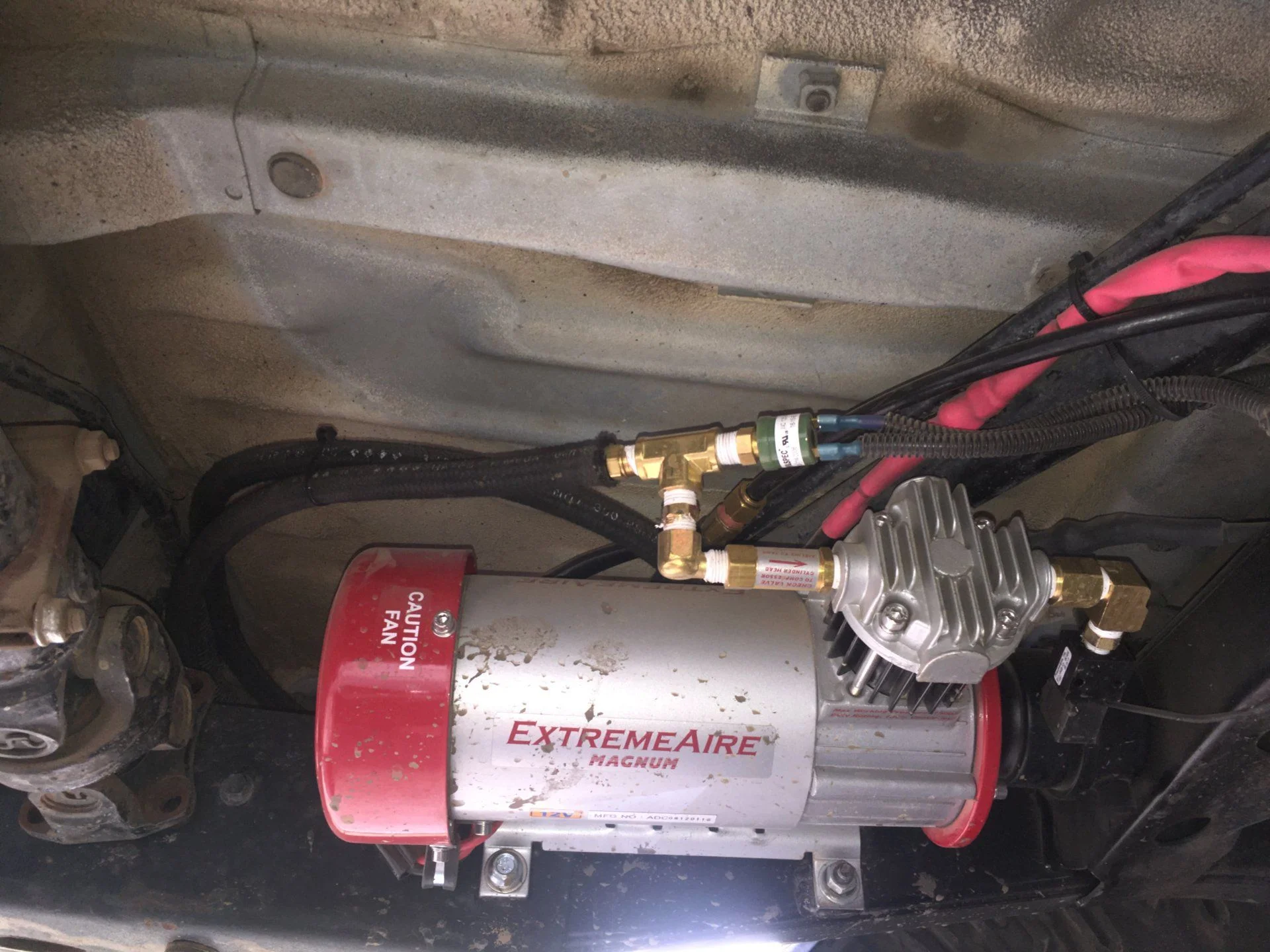

Outback Extreme Magnum here. Weather proof and ok to submerge briefly which means you can mount it under the vehicle where it’s not taking up valuable cargo space.
The Magnum model draws 90 amps for 1.5hp of 100% duty cycle. It takes a 37 from 10 to 30psi in just over 2 minutes.

This intrigues me. Just looked up the price, ouch! But under the truck sounds great.
I keep a rubber “cork” in the inlet of the air filter canister until time of use. The feed line is air brake hose routed to te front bumper. You can order a kit that come complete with everything needed to install or, if you think you can save money by piecing together you own install kit, you can do that too.
The company is in Vacaville, CA about two miles from I lived until 6 months ago when I escaped CA. I went to the company owners facility a while back. He was friendly enough to spend an hour showing me around and demonstrating one of their portable units on my rig.
