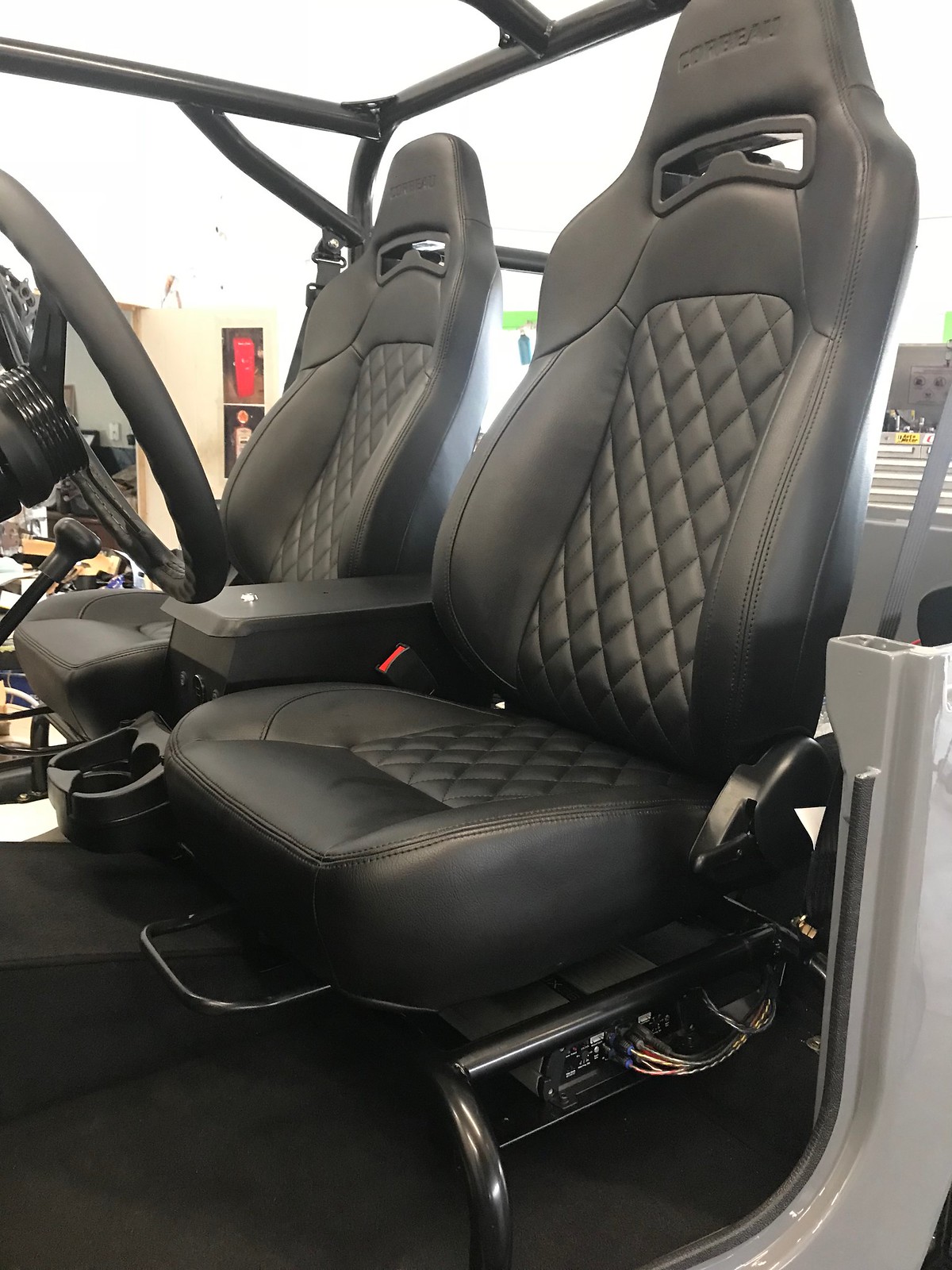

Aftermarket seats.....
Here you go... Corbeau's
