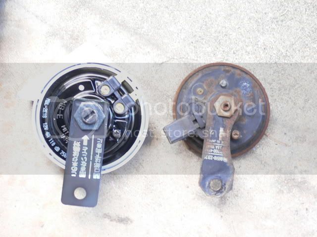

New horn vs old horn. Dang that thing even looks wimpy:
Tip: Make sure you get the correct horn on the side it should be on. If you get this brand of horn, you will see what I mean. The connections face in a way that will allow for the stock wiring/blade terminal to reach the new horn terminals. They will also bolt right up to the existing hole.

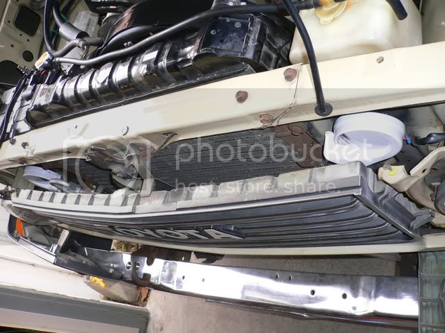

After removing the headlight bezels, carefully disconnect the electrical connections to the old horns.
This is what they look like from a front view:

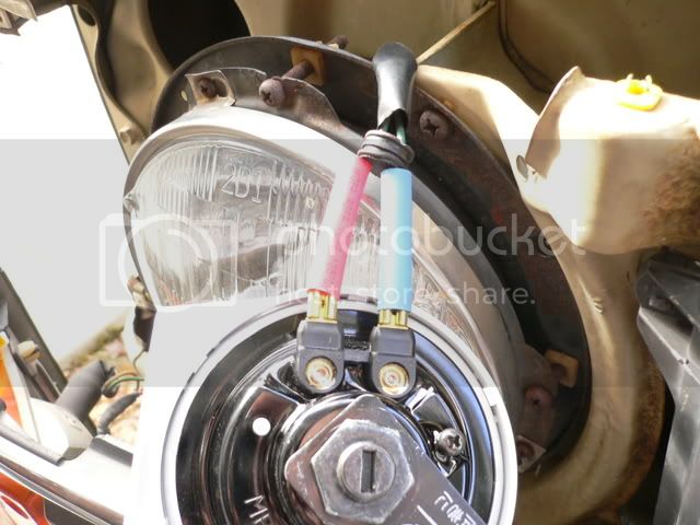

Stick a small flat blade screwdriver into the front of the connector. There is a locking tab that is part of the metal blade that you can depress down and then pull the wire with the blade terminal out:
The original blade connectors will fit onto the new horn terminals. You might have to squeeze them a little to get them to fit nice and snug:

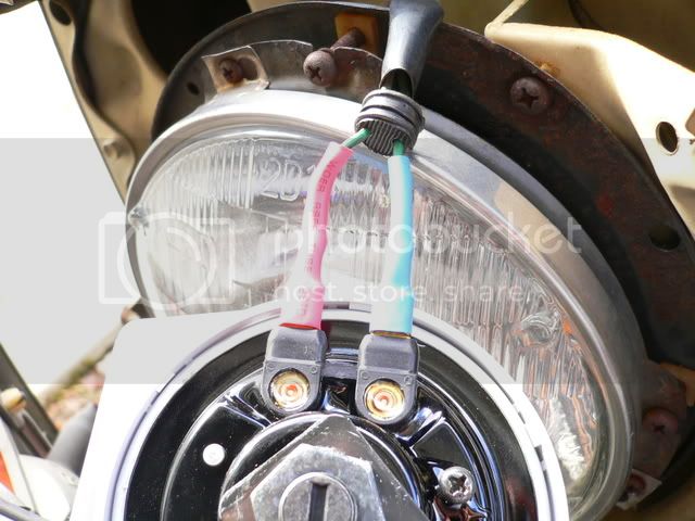

I used shrink tubing to protect the wiring and blade terminal from the elements:
Shrink tubing shrunk:
Final product installed:
