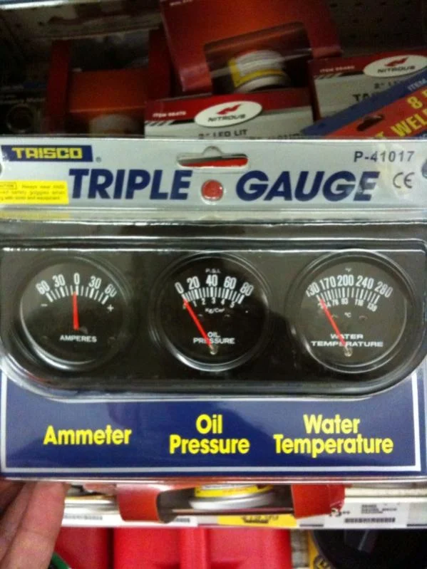

Other Guages
I found a set of other guages if you want to go cheap on this mod. I havent tested them, but they "seemed" ok.
The best part is they cost $16.99 at Harbor Frieght.
hmm, wow - will have to see what the mounting pattern is like on the back.
Too bad the faces are ugly as sin, but good price.
