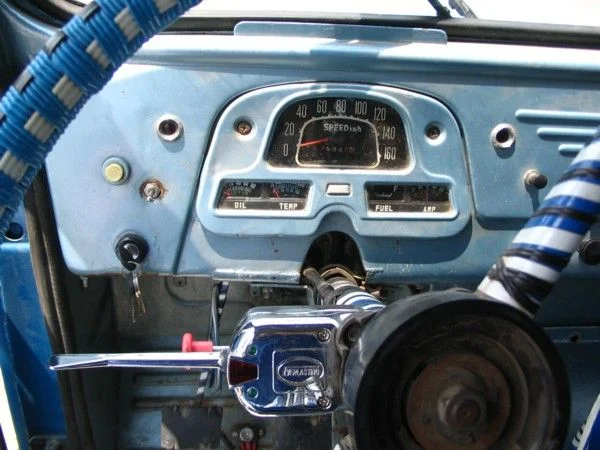

Aftermarket (even mechanical) gauges into STOCK cluster!!!
I will be sending you my cluster once pricing is finalized as well... I have 73... Great looking work!!!
That my friend is something you need to market! Hands down! Get the bugs worked out and make sure you can install it without any dash paint issues and you have a winner!!
The early and late model "OIL" "TEMP" "FUEL" "AMP" lettering I re popped in a decal. You would simply re paint the inner black plate that gets rust trace on the edges (as pictured on yours) and then apply the decal to what ever spot you wish. This will also allow one to place what ever gauge they want in each hole.

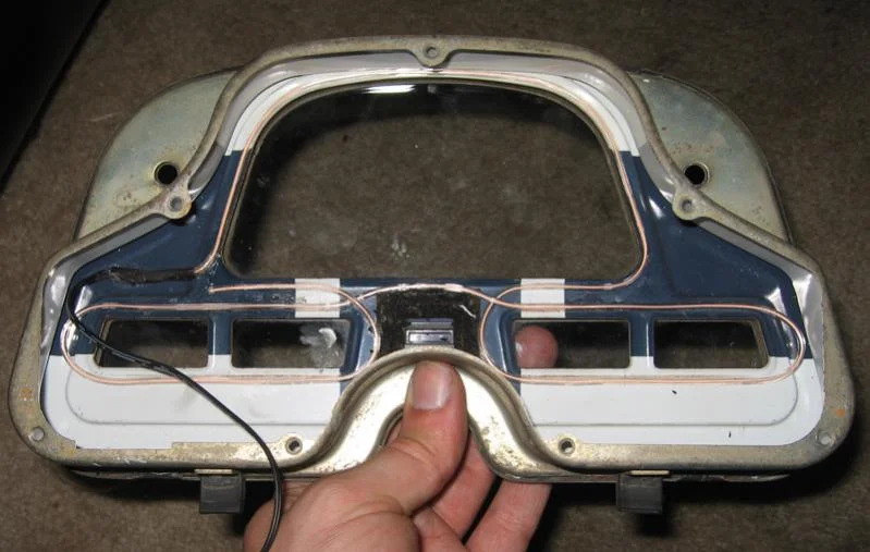

I took my test cluster out and installed it in my truck today for a fit check, worked great... with one of two small adjustments that I'll incorporate in the final version.
I was also thinking about the "EL wire" issue, and even though I think its a superior solution, I can understand if some people would rather just stick with LEDs (e.g. if you were to buy brackets only). So the brackets I'm going to have cut (as soon as I get my RFQ back :rolleyes:) will have provisions for backlight LEDs, whether you use the EL wire or not.

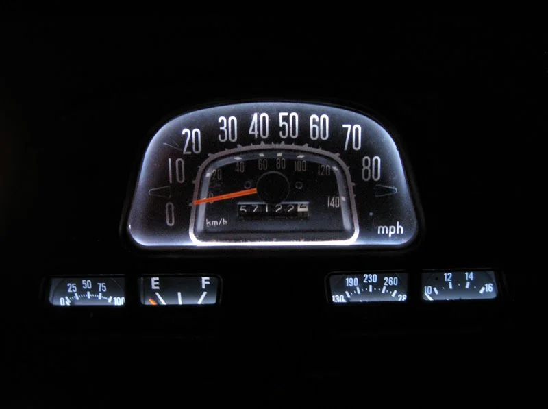

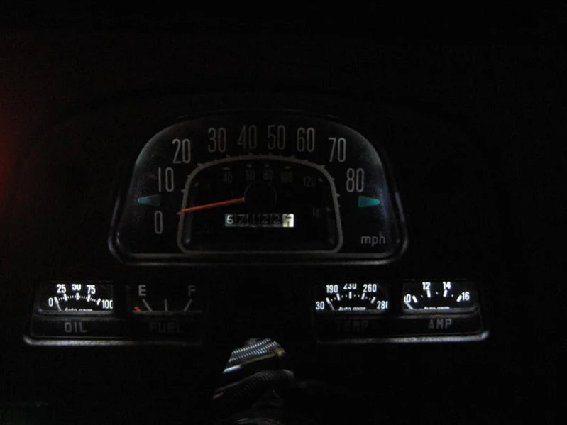

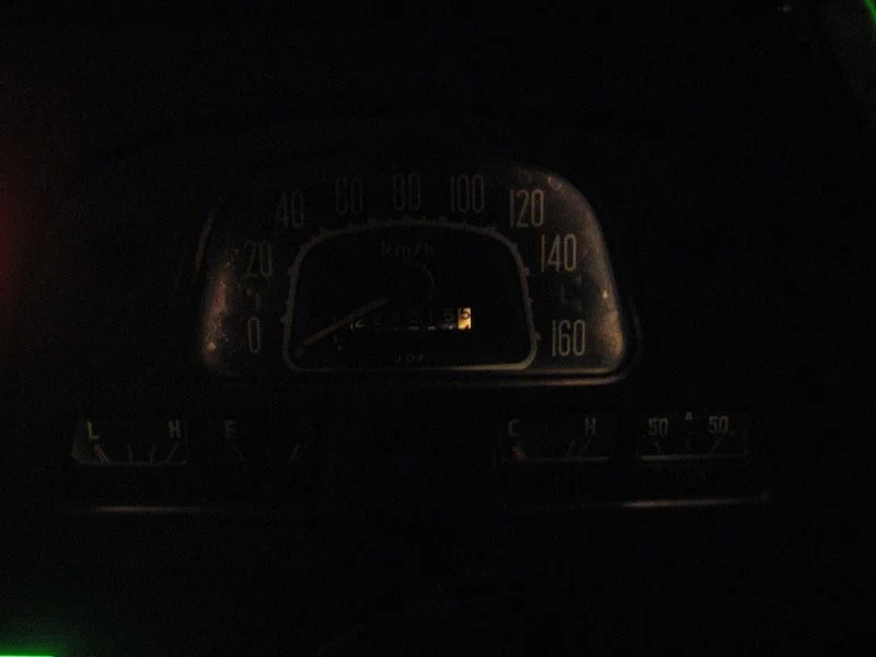

Accordingly, here are some shots of the illumination with the LEDs, compared to my original (stock) cluster. Its damn hard to get a picture that really represents the brightness, so this is a little dim but good for comparison. Hint: the dim one is the original :D
I'll post some shots of the EL wire-d version when my wire arrives.

EL wire arrived today, will try to get some pics up tonight.
As promised, EL wire pictures! As I expected, its awesome.
I realize this is not for everybody, but IMO this is the ultimate gauge cluster upgrade. Still, I'm giving everyone who is ordering the option of LED backlights or EL wire backlights - there is no cost difference.
