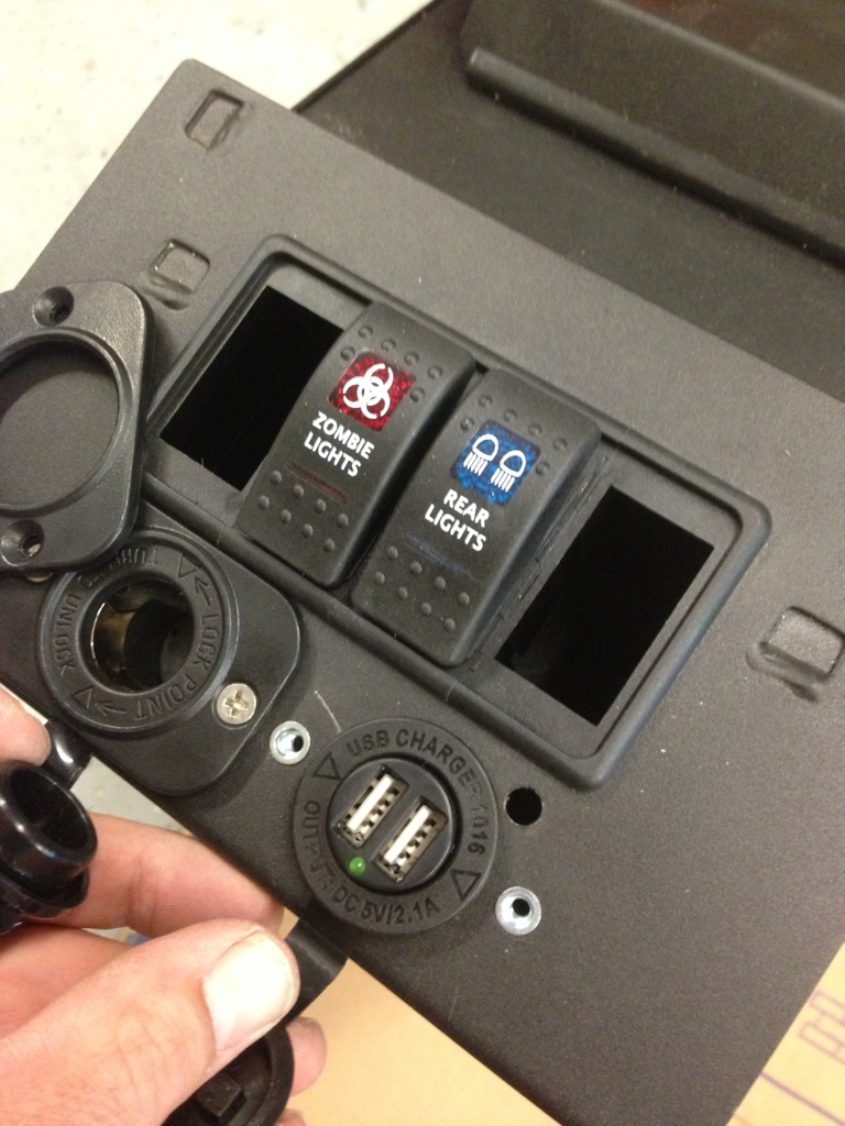

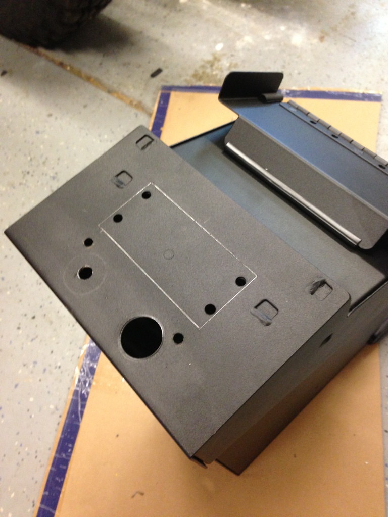

I decided to mount my seat heaters to the front of the console as opposed to the dash. There was a lot of "measure three times, cut once" involved in this. I also added a 12v socket and a dual USB charger as well just for grins.
Anyway, here are some photos:
Scribed and ready to cut. Notice I positioned everything where it will cover or remove the existing cup holder holes. Also, I used a sheet metal punch to cut the holes for the chargers:

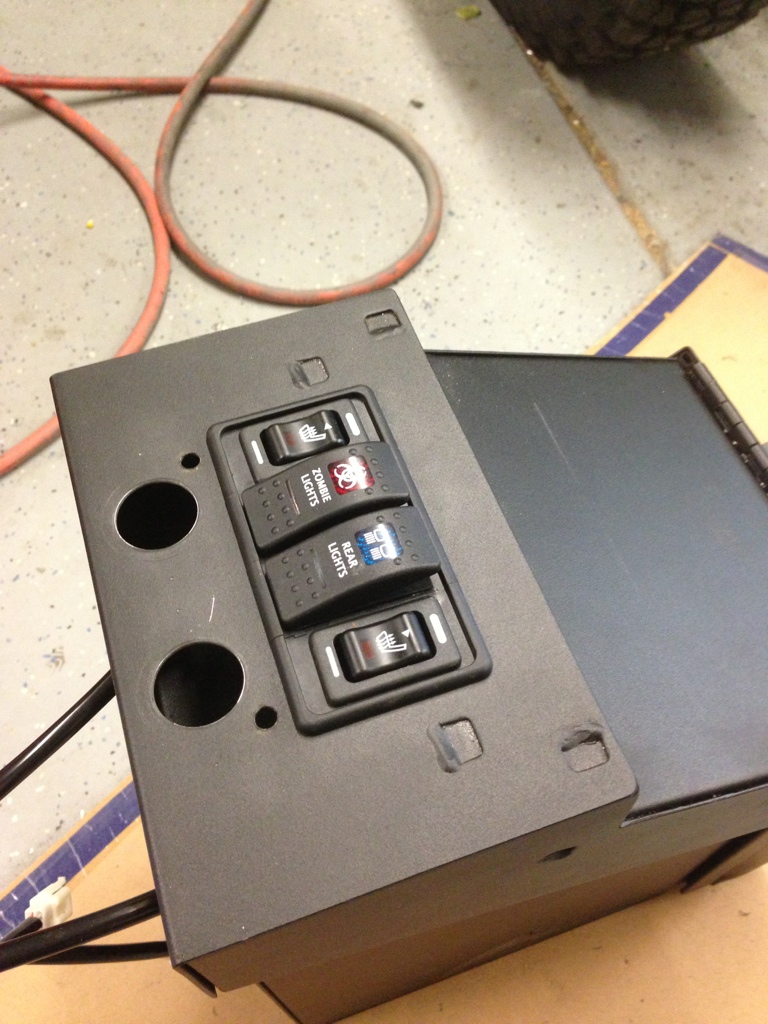

I used the modular carling switch brackets from Air On Board. The openings are too large for the provided seat switches. The widths are good, just too tall. A bit of shimming is all that'll be needed to get them to mount nicely:
The rear light switch will control the spare tire mounted flood light I'm planning to use and I'm adding interior lights using red LED lights. This will preserve night vision and since it'll look a bit like a battle ship CIC, I figured "zombie Lights" wasn't too far off. I also used nut-serts to hold the charger faceplates, which I thought was a nice touch.
Heater switches mounted up and all done!

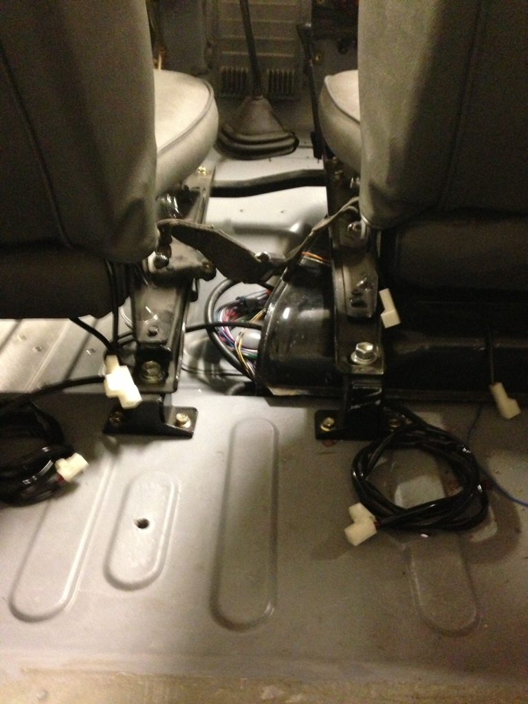

Lastly, making a cut for the pleat in the heater element was not an option for me as I had already had the seats recovered by a local shop and couldn't see how to remove the wire buried deep inside the frame that secured the pleat between the foam cushions without destroying the foam. All I did was remove the hog nose rings around the cushion base and pulled the cover up to slide in the heater element.
Not really great ones, but here are a few shots of the seats.
Here are the heater element leads coming out of the cushions:
I'd go take some for you but I've already got the seats (and everything else) removed for body and paint work and they are in storage right now.
This is what it looked like last week... before re-disassembly:
