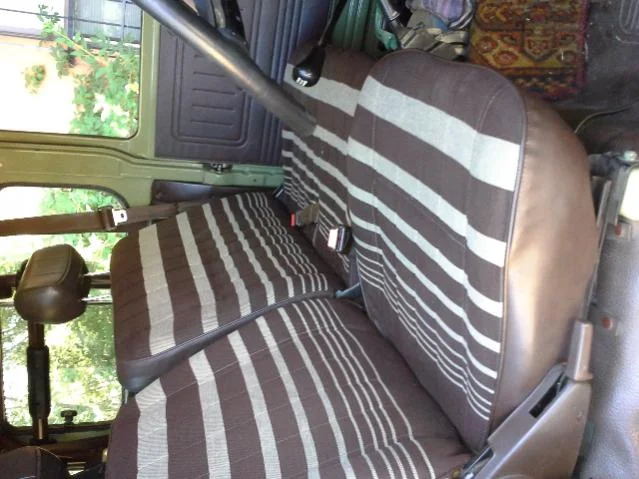

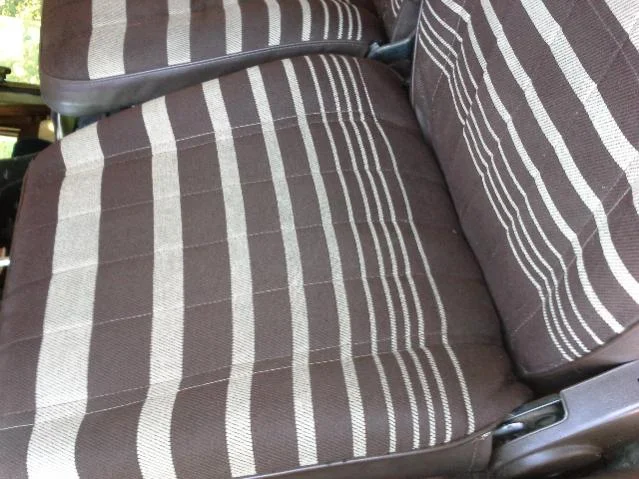

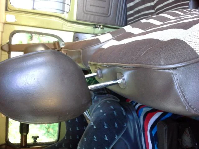

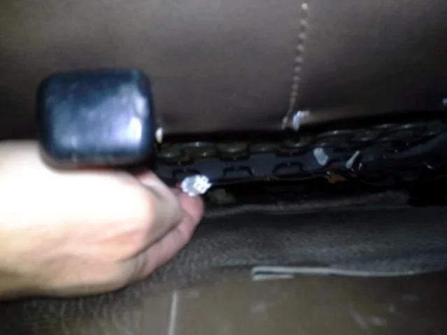

Ok, diver's seat recovered with the heaters installed. Next step wiring up the heaters and installing the switch. Then installing the passenger heater. Time is in short supply but I hope to do this over the next few weeks.
The upholsterer did a passable job: not show quality, but good enough for this daily driver. Warm bum for me this winter!
I used the seat cushions from a 1987 FJ60 (thanks BarryS and Dans-HJ45), which are just a tad bigger than the 40 series equivalent, but much more comfortable. Being a passenger seat, of course they had very little wear (not that Barry in unpopular, mind you). I also used the seat back and springs from the FJ60 seat, so I now have, in effect, a new driver's seat. I now sit about 1" higher than before, which is an odd (though not unpleasant) feeling given it is the same car in all other respects. I am 6'6", so didn't really need the added height for visibility or anything. However, the seat also sticks further forward by about 1.5" and gives more support to my legs. I wish I had done this seat before going to Denver for the Rising Sun Swap Meet!
The only drawback is that the 40% driver's seat no longer has the same profile as and the LX stripes no longer line up with the 60% passenger seat, but I can live with that: as I said, this is a daily driver, not a show car.
There is one drawback I had not thought of. Because the heaters cover the whole cushion, you can't attach the flap through the middle if the back and bottom which sucks it down slightly in the middle. This does not really bother me but we'll see if longevity of the upholstery is affected. From a comfort perspective I don't notice a difference.

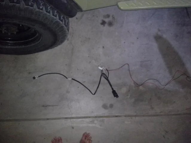

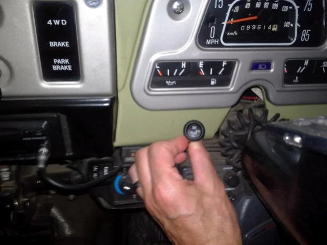

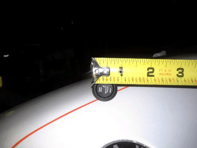

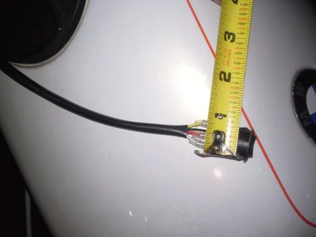

it looks fairly simple and street forWard. the kit comes with a relay and fuses so it will simply be a matter of extending the wiring with the appropriate gauge and hooking everything up. the only part I have not yet decided is where I will mount the switch. if I had a u s version with bucket seats and a centre console the decision would be easy. with my bench seat however it means I will have to mount it to the dash. Bracket? Not sure.

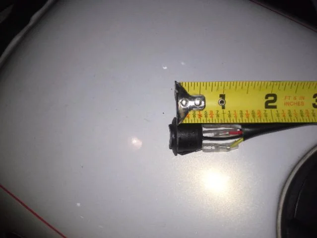

Post a pic of your switch. I've installed a few sets and they came with micro-rocker switches. If this is the case we used a uni-bit and mounted one set in the plastic hinge cover area since they are such a low profile there was no interference and they were out of the way enough to not hit when you get in and out.
I will post when I get home. They are quite small but not sure if they are that small. I'll need about a 1/2" hole for the rocker but if I recall correctly the switch is about 3/4" long. That is a great idea though if I can swing it.

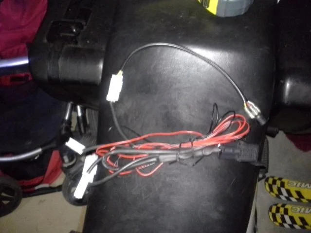

The electrical hardware seems to be very good quality. I think the switch is too big to mount on the seat so either on the dash where the lower dash pad is in US spec cruisers or in a bracket mounted to the bottom of the dash. Thoughts?
The relay mounts to the seat it seems, so I'll need to extend the wiring to the switch and the battery. I could mount driver and passenger to the left of thesteering column-not ideal, but....thoughts/suggestions?
