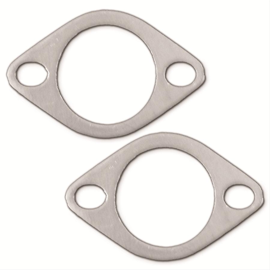

Get the remflex gasket kit. It’s far superior to the OEM. It’s like two or three times as thick and expands with a few heat cycles to take up any gaps you may have, though you shouldn’t have any if your machine shop did it right. That manifold/intake combo is a real PITA to seal up and the remflex is THE answer to your headaches. You can find them on eBay for cheaper than going directly through the website. I think I paid $45 as opposed to $75 or whatever the remflex site has them listed for.

Couldn't find these guys you were talking about on EBAY!
Would you please send over if you have a sec?
Dan
Oh wait... maybe I found them here... SOMEONE TALK ME OFF THE LEDGE BEFORE I IMPULSE BUY THESE!!!! I may be 1 banana but I swing one massive plantain ill tell you.
Its 2 am I obviously need to go to bed.
Talk me off the ledge,
Beehanger
Is there an intake remflex that's equally as necessary?
