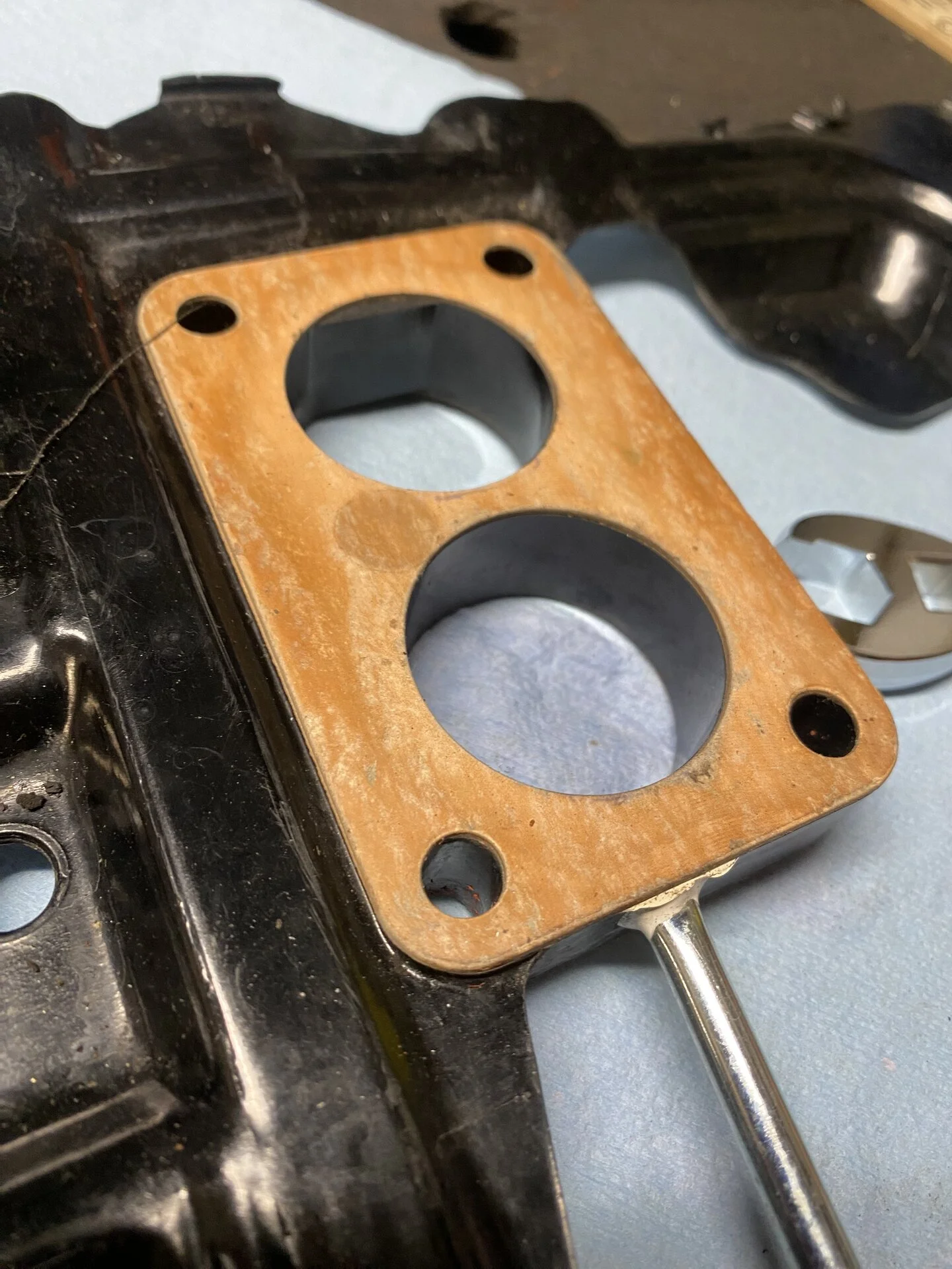

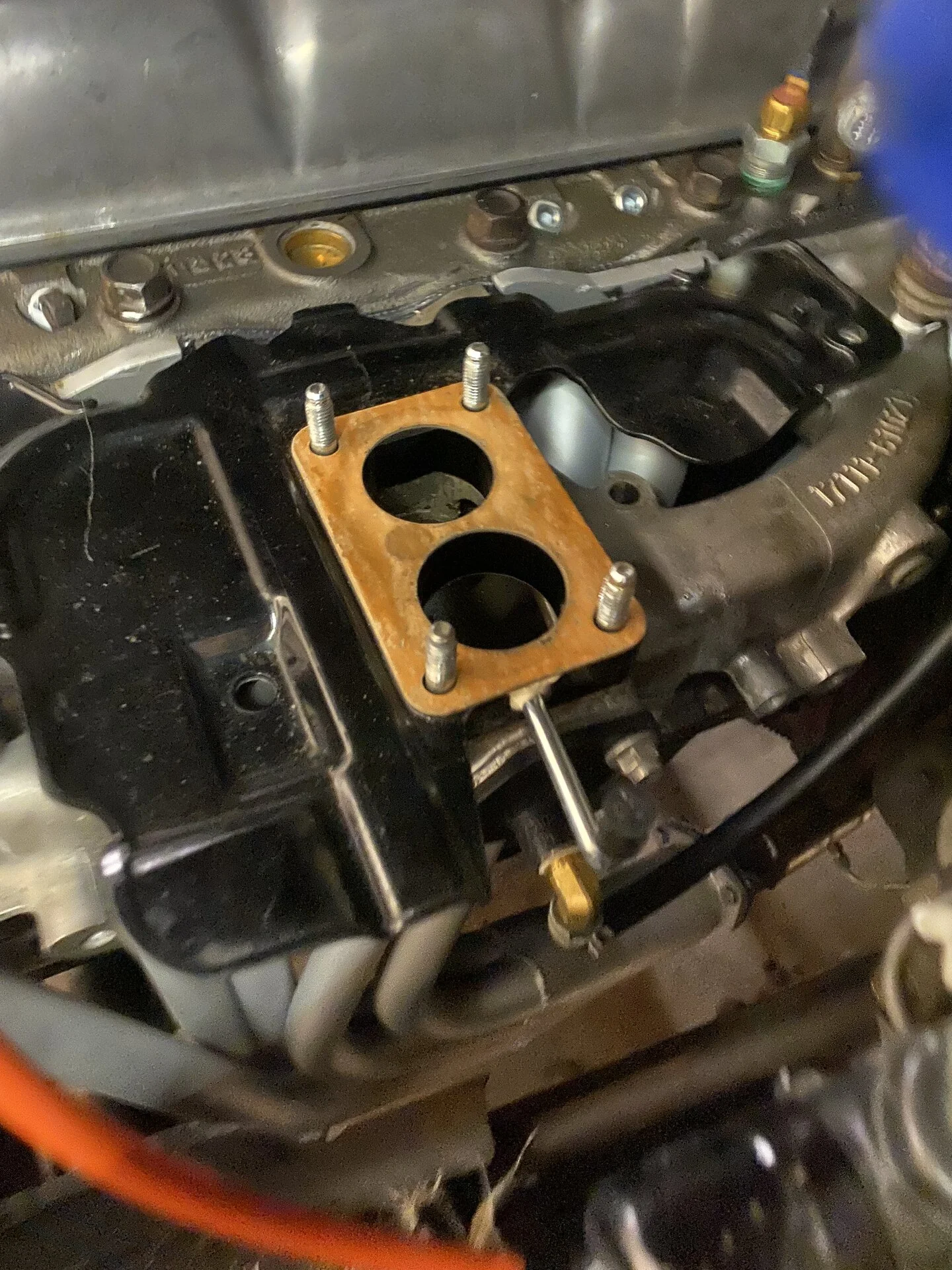

I didn’t have a vacuum leak as far as I know at the carb/insulator plate surface, but when I pulled it the gasket seems to be soaked in gas. Is this normal or indicative of a vacuum leak?!

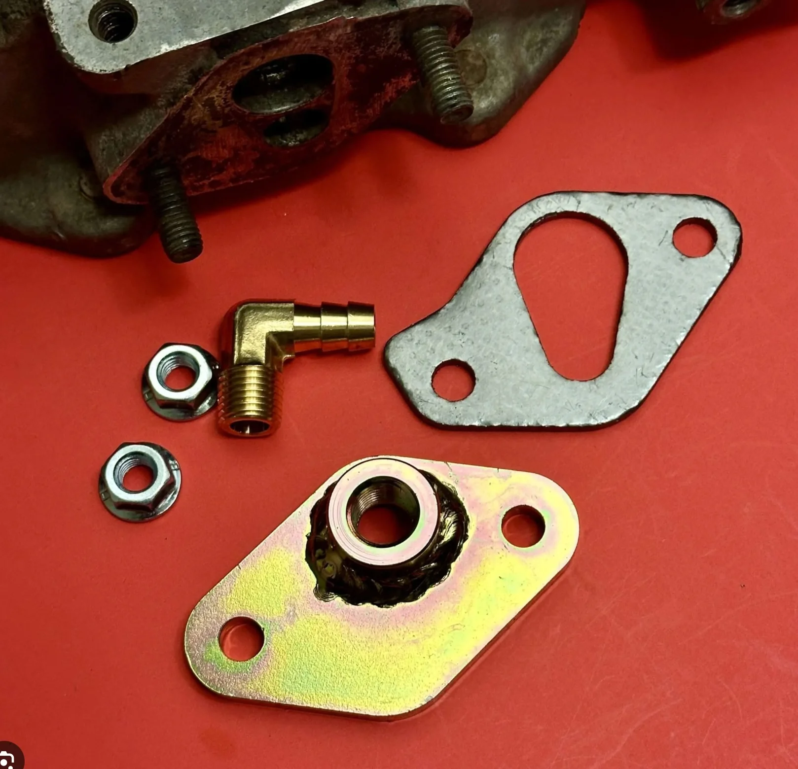

curious what the recommended torque is for this EGR to intake gasket (see photo). I haven't been able to get this fella to seal properly and after two tries I'm clearly doing something wrong.
What's the torque spec and How many foot pounds at a time in sequence? What's the final torque recommended for a crush gasket like this?

Also, It seems like the gasket doesn't go all the way over the edge of the block off plate, does it need to form around the plate to seal properly?
