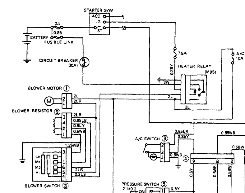

There's a circuit breaker in the fuse box that looks like a silver can with a hole in the top of it. Poke a thick gauge paper clip wire down the hole to to reset the breaker.
If that doesn't work, remove the blower motor and put 12V to the leads and see if it spins.
The different fan speeds are controlled by a resistor pack installed in the air duct near the accelerator pedal. Remove it and see if the resistor coils have burned up
Yep. If not the breaker, it could be the switch, the resistor, the motor, or relay - or a bad ground. I was having similar problems and traced it to the blower motor, which I replaced.
The heater lever that moves from blue to red is opening a heater valve on the firewall to let warm coolant into the heater core...a kind of miniature radiator under your dash. Your air was warm because the engine was warmed up and the valve was open. The blower is electrical and operates on 12v hot and ground wires going to it on the bottom right under the glove box. It has nothing to do with the recirculate-fresh air lever. That lever just opens a door to let fresh air in and is not connected to the electrical on the blower motor. But the door is between the vent and the blower and may be jiggling the plug when you slam it. Try to unplug your wires on the bottom left of the blower motor and plug back in making sure you have a tight connection. Also make sure the wires themselves are not loose/burned/corroded in the plug.
Also to test my theory just turn the truck on and turn the blower on to any of the positions and while the blower is NOT running, INSTEAD of slamming the recirculate lever, just wiggle the wires coming into the blower to see if you can get it to come on.

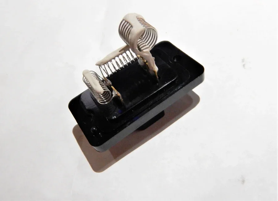

Mine started acting up again - it was the resistor. The O'Reillys blower I linked above is crap anyway, loud/doesn't spin smoothly. So OEM blower stays in place after a good cleanup. Everything back up and running perfectly again.

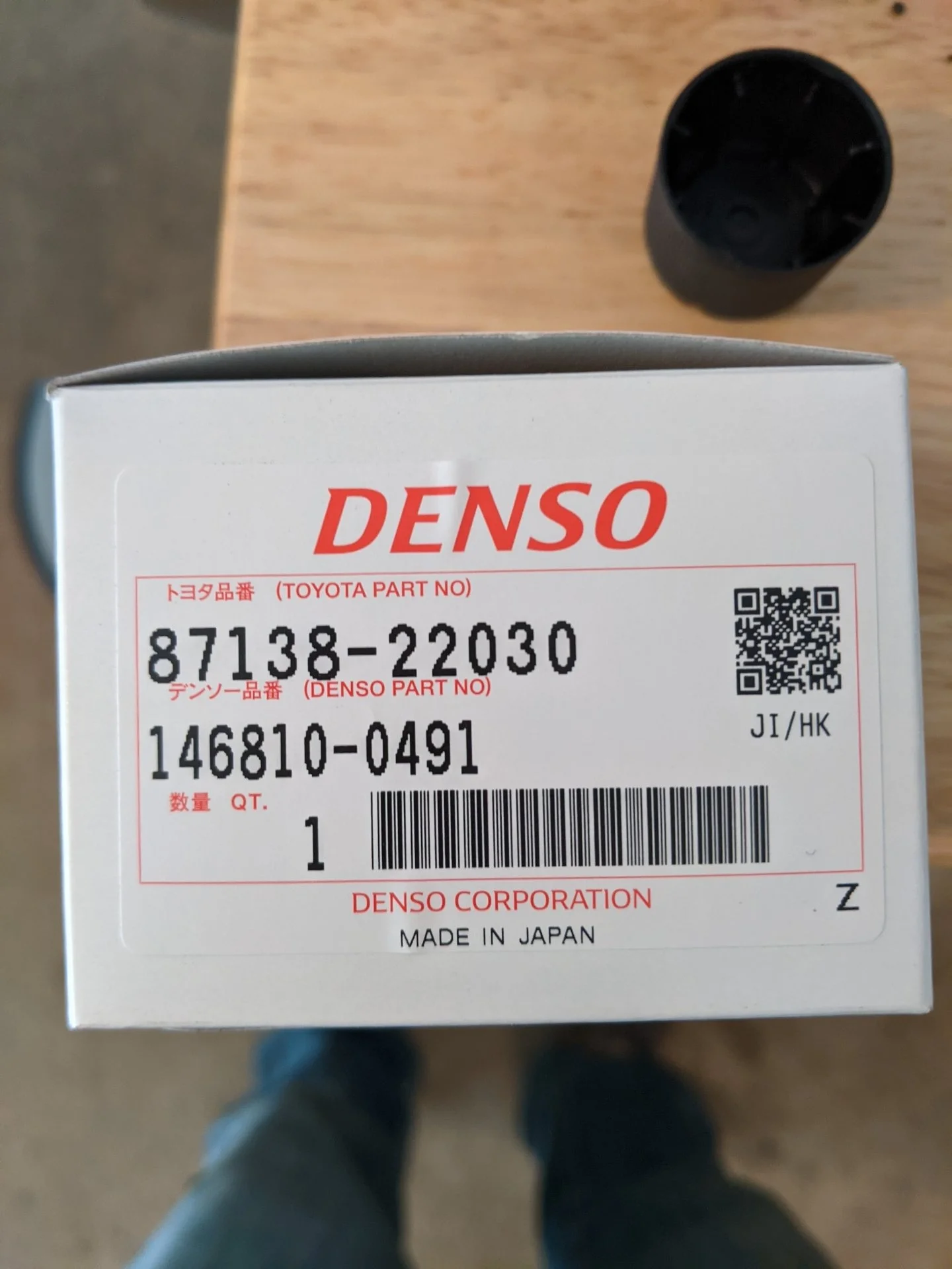

Nice find! I got my resistor from O'Reilly's a couple years ago and it was a made in Japan unit. A very happy discovery. That unit costs about $47 though.
