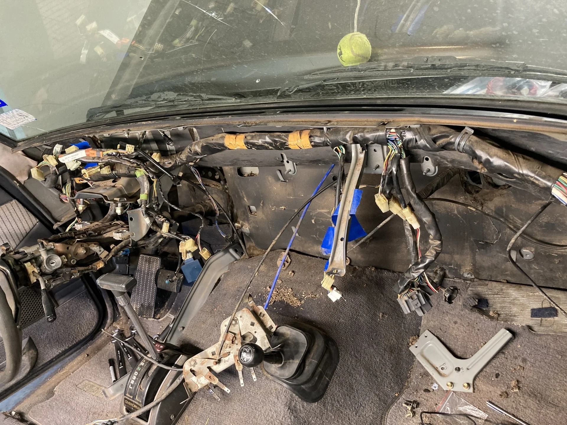

Those top and bottom screws hold that metal shield in. Looks like you are missing a screw, I wonder if your shield is loose inside the housing? I think getting a thin piece of plastic and making a mounting adapter is your best bet at this point… beside ripping the HVAC system out. o_O
Yeah, I need something that will fit in that slot but that the outside part is slightly smaller so this thing won’t move and so it will create a full seal. When I took the old resistor out, I did hear something fall back there. Makes sense now. But no, I’d like to avoid removing the entire HVAC system. Now for the custom piece or back to the super glue and duct tape plan.

I wonder if the metal mounting plate for your resistor has fallen down behind the plastic housing? Maybe an earth magnet could pull it back up?
Magnet would probably work but I think I’m just gonna leave it in there and retro fit my new resistor in there with a custom metal heat shield. It’s about time for me to start working on the old gal, so I’ll let y’all know how it goes.
