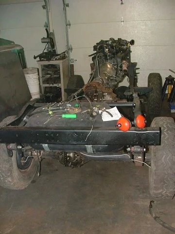

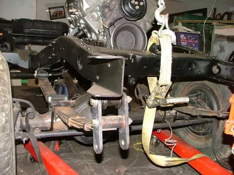

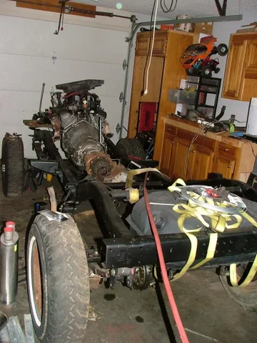

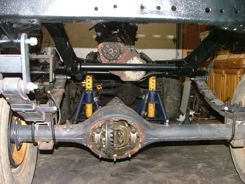

I got the motor put back in, springs on with new hanger pins from MAF, and said "screw it". Time for an SOA. I figure I'm moving tto Colorado and want to have some fun out there. HEres the cliffs notes: Measure, cut, weld, measure again. The pinions "should" point at the outputs minus 1-2 degrees for u-joint lubrication when the full weight is on the rig. 0 degrees is bad, FYI. I took the long ass lift shackles and drilled new holes at stock length after I made sure they would have the required range of motion for the springs to completely flattn out. I left them long for now incase I want the extra height. Cut and turn is coming but not until about the last thing so they are where they need to be with the full weight on the truck.

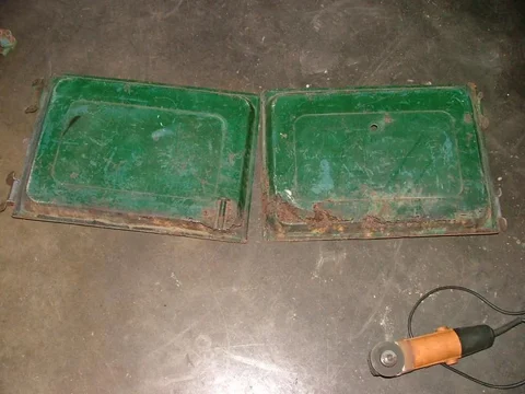

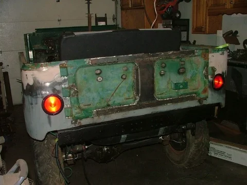

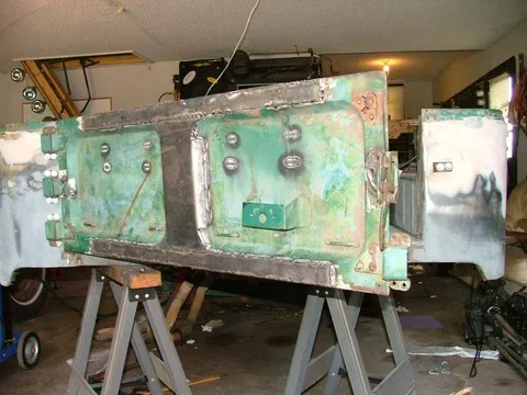

Hey, heres something cool. My rear doors were shot so I wanted to weld them together and make a drop tailgate. Cut some steel, burned it in, and had the gate. Its ugly but it is cheaper than buying one. ( yeah, I know thats been done before but I'm not done yet. ) I had the hinges to make a drop gate but only 1 latch.......hmmm..... So I made a big ass swing gate. the latch I had would only work on the passenger side but the driver side hinge mount was a little thin. I just flipped it upsidedown and mounted it that way. Added an extra hinge to the gate so there are 3 on the driver side and mounted the latch to the other. I works really well and fits great. The damn rust is now on the top inside but that is getting taken care of soon. Enjoy.

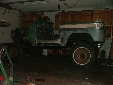

As of right now here is how it sits. I have about 2 months to get it done because we need to get the house on the market and a garage full of cruiser is no good for that.

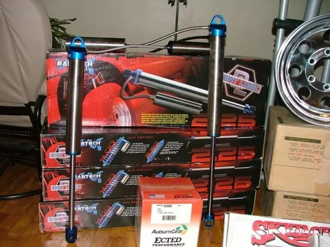

I always have to go back through the pictures to see where I was. It's crazy seeing how much has progressed since the last post. I came across a very rare oppertunity to pick up a lot of goodies for a great price. The planets kinda aligned and I got some things I really wanted and some I shouldnt have bought (or bought'n as I hear it around here alot).
I got the wheels I have wanted since I was 18, tires, and shocks. Probably too much shock for what I need but they are BADASS!! I also got an Ected for the wifes 8.8 in her XJ, and some Double Flex control arms for resale. Also got some corbeau seats.

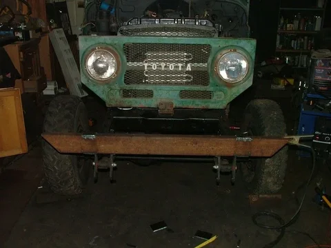

Time is pressing so I made a simple bumper out of 2x4" steel.Notched it at the bumper mounts and also notched the mounts. I had to beat it it witha sledge but it is all pretty flush together. Welded everything in and It's good to go.....for now. Still need to burn in the winch plate and box in a hole for a winch cable.

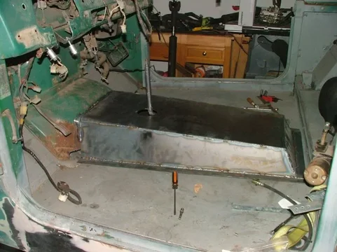

I got another sheet of 16 gauge and tore into making a trans tunnel. I cut the factory tunnel apart to use the front where it is contoured to the firewall/ kick area. Started cutting out pieces of 16ga and came up with this.

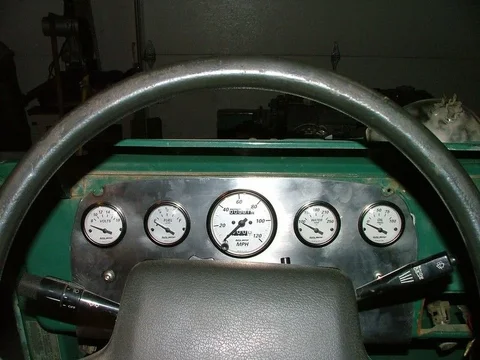

Oh yeah, I also got a set of Autometer gauges in the deal I got earlier. I took a piece of polished stainless (actually a mudflap :p) and marked where I wanted to cut. I really liked the configuration they were sitting in the box they came in so I went with that. That also meant cutting up the dash a bit more. Got it cut, bent the lower to contour with the roll of the dash (with a vice and a broom handle) and got it mounted. I burned up 2 hole saws cutting the holes. Ended up having to plas the speedo hole and spend alot of time filing. Since the pic I added green LEDs for turn signals and a check engine light from the painless harness (same deal). It looks really good with the dash pad on.

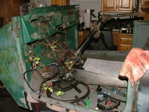

I started tackling the wiring for the column. I wanted to use all the switches on the column instead of the dash so it took some time to figure. Everything should work like it's supposed to. Still waiting on the wiper relay and getting all the lights going (to fire the flasher) before I can be sure. I think I have enough diagramed out to be able to re-create it easily, well somewhat.

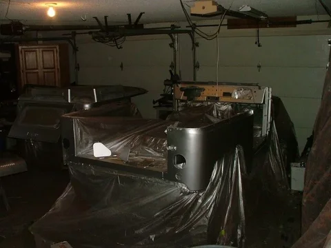

The wife has been pressing me about painting it, and with the warm days, well not cold as hell days, going away I went ahead and started masking. I bought a gallon of Rustoleum rusty metal primer (because its dark) and a gallon of Rustoleum "aluminum" paint. I figured the dark primer would darken the aluminum to just the color I wanted. Got it primed and shot, and the aluminum was still aluminum. Super bright, blingy friggin aluminum. Wifey actually said it looked like I "chromed" my truck. I know you guys don't know me very well, but I HATE chrome. Polished aluminum......mmmm:rolleyes:, stainless.........maybe, but chrome. Nope, not for me. But you know what, it was done. Not going to mask it and do it again. Not this guy. And you know what, I'm glad. I don't think I could be happier. After putting on the trim it looks better than I could have thought.
