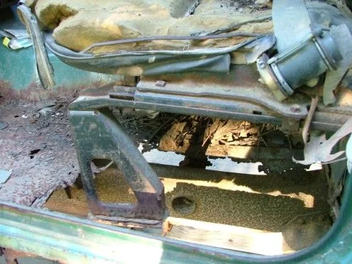

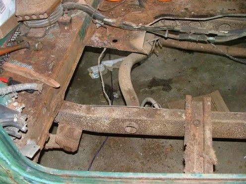

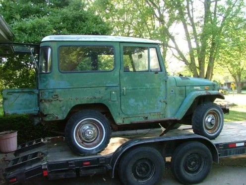

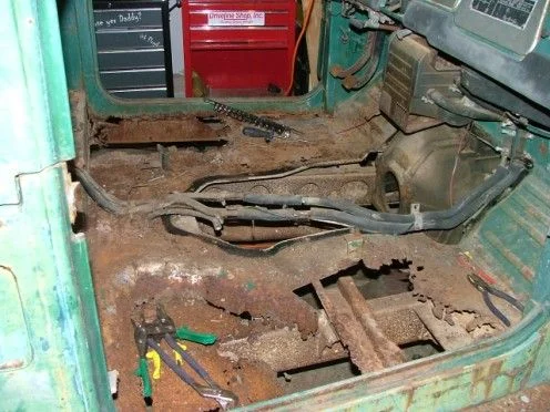

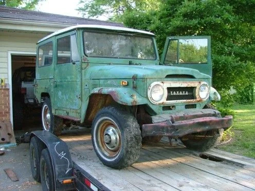

Well, I've been on MUD for a while now. I figured it was time to post a buildup thread of my 09/72 Fj-40. She was pretty rough when I got her, actually traded a mossberg shotgun for it. The truck had been sitting in a field for a few years and very cancerous. Rats nests inside, mud wasp nests EVERYWHERE. Even though the sheetmetal was pretty bad in spots the frame was solid
So the wife was a little worried, but since I was only out a shotgun she was OK with it......... Well, until she saw inside. Out came the shop vac and cutoff wheel and it began.
[/ATTACH]

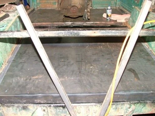

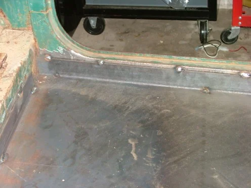

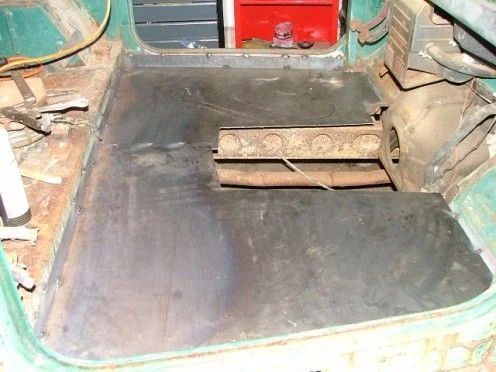

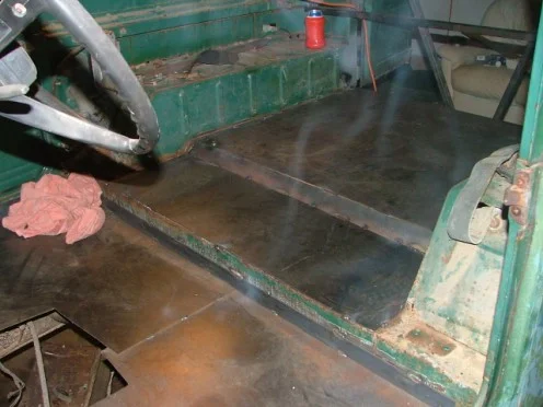

I bought a sheet of 16ga steel and a couple pieces of 2x2 angle. Cutting out the cancer and replacing the floors went really fast. I used the angle to "frame" the inside of the pans and give the new metal something solid to mount to. It also added strength to the tub at its least supported area, the door sills.

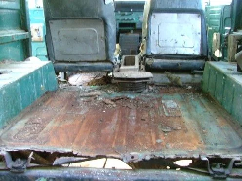

After the front floors were in, I moved to the back. Cut out all the old floors and cut my piece of steel to replace it. Keep in mind the tools I am using are a 4" grinder w/ a cutoff wheel, a BFH, and really not too much else. I scored the steel in 2 lines to "brake" it the redneck way, and made the folds to make the rear sill and rear floor area as 1 piece. It came out really well, except I bent the wrong edge and it was too narrow side to side, and too long front to back!! Hmmm..... More angle iron, mainly as a filler this time. Plus it let me "brake" the front lip to get the sloped piece to the lower section of floor. It came out OK, I was a little pissed for a while. The rear is REALLY strong now, though.

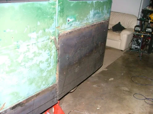

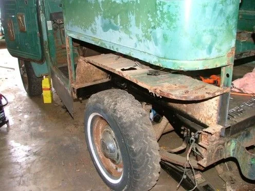

The interior was coming along nicely. Instead of finishing it up I got a little ancy about the outside. Out came the cutoff wheel and off with her skins!!
Took more 16 ga and started welding. This was a hard step as I had NO help. All the straight parts were ok, but making the bend was a pain.
It would have been easier with an auto dark helmet, but all-in-all it came out OKl

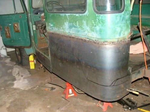

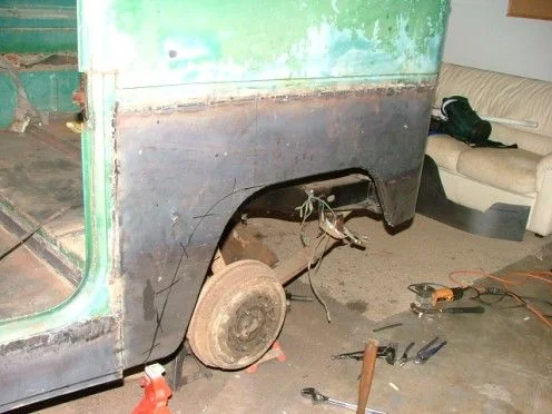

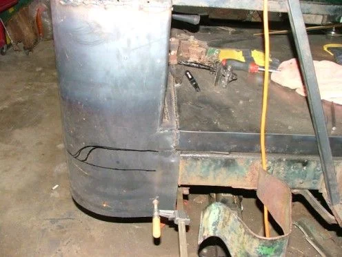

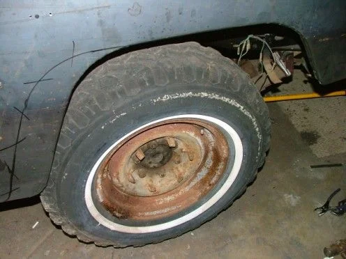

I took the old skins and traced the wheelwell line onto the side. I decided I was going to flip the springs so I moved the line 4.5" straight back.
Broke out the harbor freight air reciprocating saw I just picked up for this step. Then I broke the harbor freighr air reciprocating saw I just picked up for this step. Hmmm... Back to the cutoff wheel.
I made the cut 1/2" lower than the line so I could fold it over to make a better edge. A pair of vise grips and some patience made a pretty decient edge. Made relief cuts around the curves and hammered it all to where it needed to be.

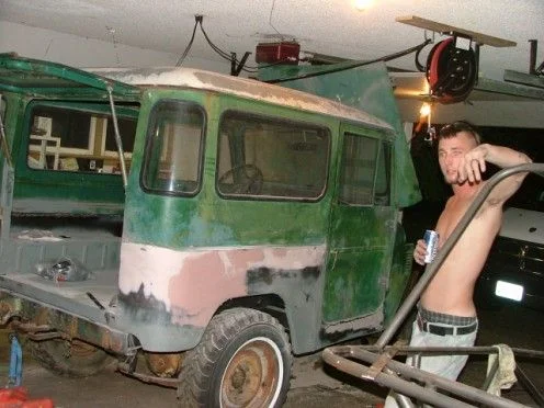

After I had gotten all the welds ground down with a 7" disk sander, I used a little filler to smooth things out a bit. While I was doing this, a buddy stopped by and convinced me he could do the other sides filler work for me. I thought "sure, he's taken auto body. Probably knows more about this than me!" I'll show you.
MY SIDE (crappy pic, very thin filler, the grey is primer)
HIS SIDE
I'm not a fan of filler in the first place, but if I HAVE to use it I will only use the minimum amount needed. Apparently, he thought differently. I know my truck will lean to the passenger side if I leave it like that. And then my wife will freak out thinking its from her. I have some sanding ahead.

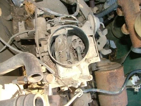

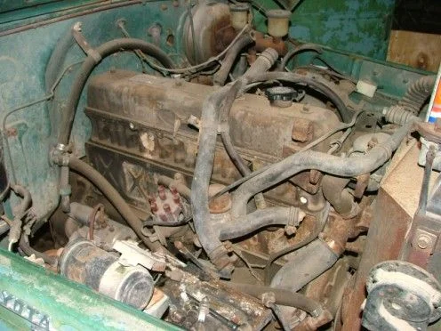

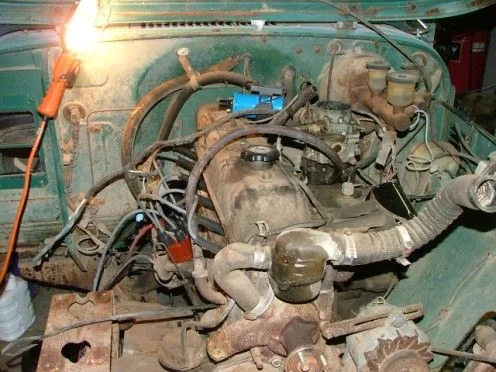

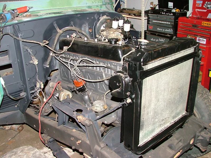

After all that I needed a break from body work. Time to get the motor looking good and running. Ya see, before I started tearing into everything the carb was full of mud dauber nests and the motor looked like a$$.
I rebuilt the carb, not too hard. Put it on, hooked up power, and started cranking. (well, after ner plugs, wires, cap, rotor, and soaking the cylinders in penetrant for a few) She fired.....kinda. ran for about 6 seconds and that was it. Good enough for me. I knew everything was there to make it run, so time to tear into it. Pulled the VC, manifolds, all accessories, etc. Everything was DIRTY.

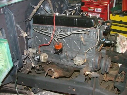

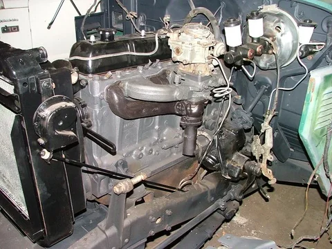

and a wave of my magic wand (or a late night) and I had this......
You must realize, this is before I even knew if it ran or not. I have since found out it does run....... Not that it matters because I have a 3fe, a440f, and a split case coming. That means I have to wave the wand again.

Hey nice work man what did you clean up the engine with?
Power washer on the block with some degreaser and a wire brush. Also used a wire wheel on the valve cover. What really made the difference was pulling the fenders, hood and bib so I could get to the hard to reach spots.

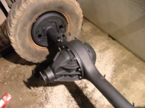

The shackles front and rear were pretty rough so I ordered a set of 1.5" lift shackles from Ebay. (bad idea in retrospect. They hang WAY low in the front.) I pulled the axles front and rear, wire wheeled them to death, and gave them a fresh coat of paint. I sprayed them gloss black first with a coat of flat over top. I like flat black better but wanted the better rust protection of gloss. Should've not been so cheap and just gotten POR-15.

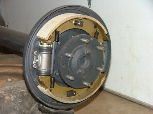

The drums were hard to remove but I finally got them off. New wheel cylinders, shoes, springs, freshly turned drums.... it went together alot easier than coming apart.
