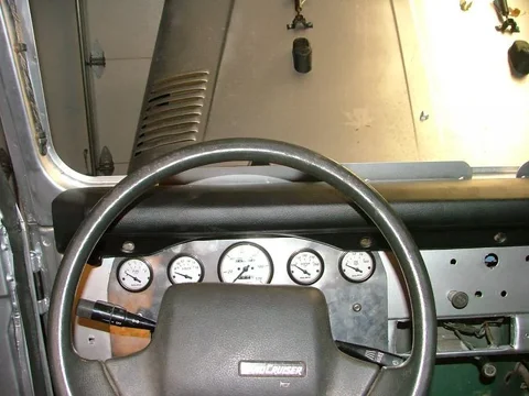

Alright, finished wiring up the gauge panel. I went to Radio shack and got a male and female 12 pin connector. The type with the crimp on pins you insert into the connector. I have a ton of wire, but only 4 colors. Red, black, yellow and green. We do alot of commercial accounts at work and they are left over harnesses. You have to do alot of remembering with only 4 colors to wire a truck. I had wires running out of the dash in sections, just had to remember what section/color was. I had soldered the pins after crimping on the gauge side but only crimped them on the truck side. Every one of them pulled out while trying to disconnect the panel. This was right after I had had made an awesome pigtail. Couldnt tell what wire was what after that. Had to pull the whole thing apart on the truck side an find the sections again. Soldered them the next time. Oh yeah, that required more parts from radio shack.:mad:

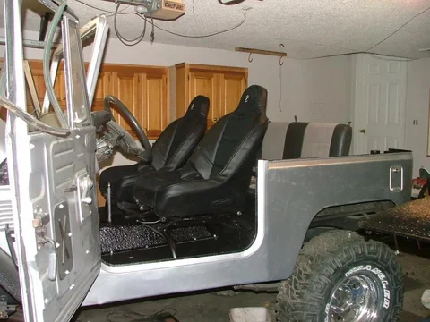

Also got the dash pad back on. I bought a new cover a couple years ago and finally got it installed. It'd been sitting in the box under the roll around rack I have for the roof, my daughter climbing on it every now and then. An ya know it, the only time she ever did that was in good clothes. The pad fit pretty well for what it is and how bad the dash was.

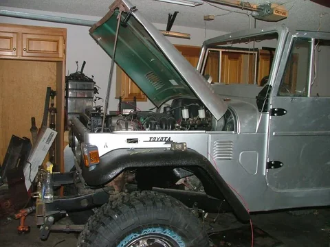

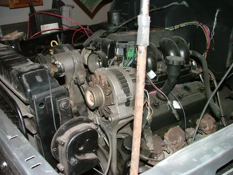

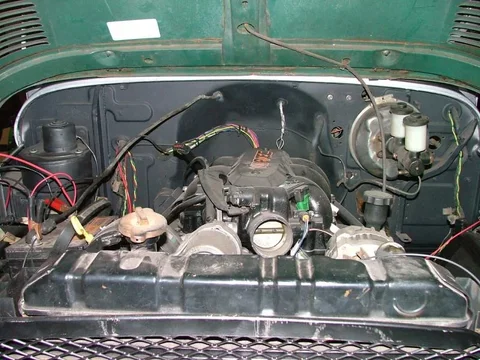

I hadn't even really stood back and noticed how the motor fit with the front end on. Came out pretty decient for 2 minutes with a tape measure.
I still have to decide where I want to mount the battery and figure up a ground. Thats why the wirings a bit of a mess on the passenger side. I think I might mount it on the firewall right behind the motor. That'll leave the ps inner fender for an air compressor. I was also going to paint the underside of the hood but it's the only part left with the original color. Paying respects, ya know. Or maybe just too lazy?

I have lights, too. Everyting works like it should. The 60 column light switch actually fires relays for the park lamps and the headlights. I robbed the fuel pump relays from the chevy harness and used those. The 60 column actually sends a ground from those relays to the headlights which are constant hot. Either that or the ridalin is wearing off. I had to reverse the polarity on all of it to work with this truck. That meant checking continuity with every wire and the column itself. Shorts are bad. The lights wont pull enough to trigger the factory flasher so I bought an electronic flasher. The lights flash fast but they work. Later model front parks were put on because the original plan was a quick re-do of the truck. I just knew I could rebuild this for under $2 grand. They have 3 bulbs instead of the original 2 element bulb (I assume, never actually saw one). The lower amber is my park and the upper and side are now turn. Not really to sure how "correct" that is but it works for me, i guess.

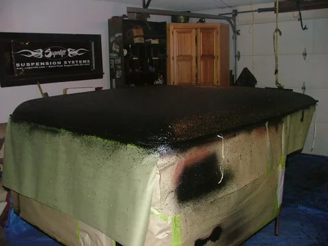

Started prepping for a liner. Cleaned it, spent a couple hours with a grinder scuffing it. It took alot longer than normal because all the new metal doesnt scuff with the same tools as a painted surface. Hence the couple hours and grinder. I can scuff a truck bed in about 4 minutes and a tub in 15. Not this time.
I taped everything off starting with line tape. It is a very narow tape, pinstripe like. There is a string glued to the edge that cuts a clean liner edge. Got everything masked and ready to shoot. The liner I bought was a "mix it in a pail" DIY stuff from ebay. Not fun. You mix the base, activator (which is the consistency of candy when its being made, kneaded) and a reducer. After that dump a pound of rubber shavings in for texture. It wouldn't have been that bad with a decient gun but the one sent was as bad as I've seen. Material came out way too slow. I spent a total of maybe 3 hours spraying. Just spraying. Got goop everywhere. The floor, the garage door handle (both sides) and the living room remote (spongebob, mommy was in the shower) and me. Like I said, not fun. Came out alright, though.

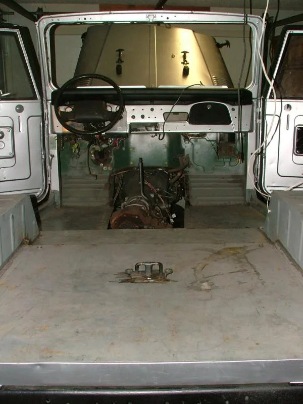

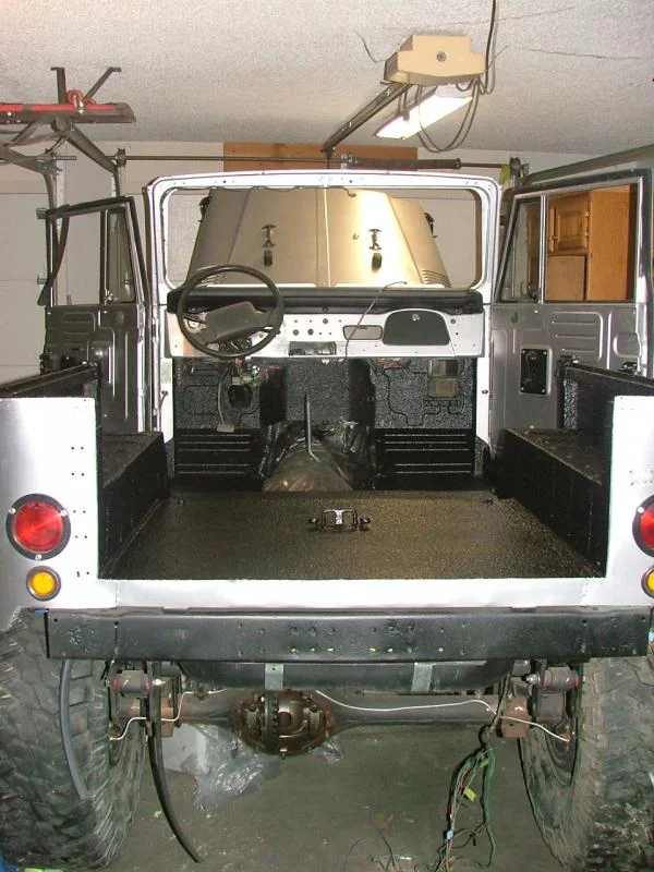

I waited all day at work to come home and de-prep it. Pulled all the lines, got the paper, plastic and tape off and this is what was left.

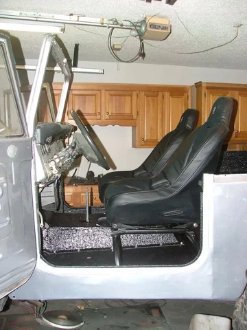

I Could finally install the tranny hump for the last time, which now that I think of it.......it's going to be a PITA to do the few things I need to do with the t-case and shift linkage. Got excited, I guess. Hmm...... Oh well, I got the seats in and tailgate on. Sprayed the gate too, that's why I wasn't too worried about metal finishing it. Liner hides welds well.

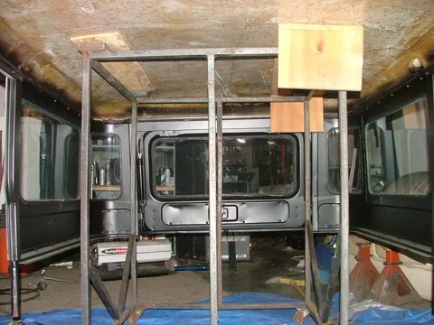

Theres the inside of the top and the roll around. I had to crawl through that to spray it. Airhose and light cord getting tangled kept it interesting. I still have to put a headliner in it, not really priority right now.

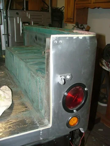

my biggest thing is the rear quarter panel (mind are pretty beat to hell) how did you bend yrs?? im no expert so from what i can tell it looks every bit as good as bought rear quarter panels
I cut out the old quarters following the seam edge inside with a 4" grinder with a cutoff wheel. Cut out a rectangle of 16ga sheetmetal from the corner of the sheet (so I had 2 straight edges @ 90*) and used little welding clamps from Harbor Freight. Clamped it in along the top and front and tacked it here and there. As for the radius bend around the back I just pushed on it with my hip as I tacked the metal around the bend. That would have been easier if I had an extra set of hands. The bottom edge I cut about an inch long around the wheelwell and just folded it up with a modified pair of vice-grips (flat steel welded to the jaws to make a wider mouth with straight edges) and alot of patience. The areas around the curves were done with a smaller pair of vice-grips. I had to make relief cuts from the edge to the line I wanted so it would fold in right. It is by no means as nice as a production panel but unless you look for it, it doesn't stand out.

I'm running the stock manifolds. I've got my engine so far foward the firewall is the least of my worries. I don't think they would be a problem even with the motor further back. I hear monte carlo manifolds are a bit easier to work with. Have you seen Texicans thread about the 4.3 in a 40? https://forum.ih8mud.com/40-55-series-tech/43710-4-3-tbi-40-a.html
He uses the monte manifolds.
