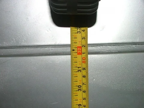

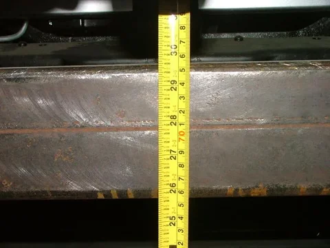

I had a question of height after the soa and 35s. I went out and took some pics with the tape. Here's the center of the door to the ground:
Here is the rear:
And the front:
I also have 8" between the tire and fenders / quarters.

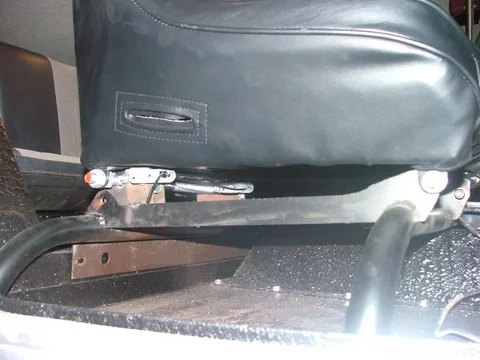

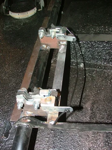

I've been wondering how to get the kiddo into the back seat easily. I wanted to make the passenger side seat able to flip foward but wasn't sure of an easy way to do it. Then I remembered I had a couple bear-claw latches I got off of an airflow tailgate I warrantied. Fabbed up some brackets to hold them and used some 5/8ths all thread. All in all it came out really well. The latches pop by reaching under the seat about an inch and pulling a lever. It works alot smoother than I would have thought.
I just realized I need to figure out a way for the seatbelts to work with it tilting now......... hmmm.

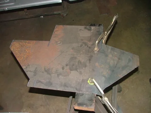

I also made a battery tray today. I've got some room between the firewall and the engine, So I designed it to fit there. It will bolt up to the firewall where the heater bolts in to the inside. It sits low and fots pretty good. Not too bad for a Plasma cutter, hammer, and a vice, eh?
