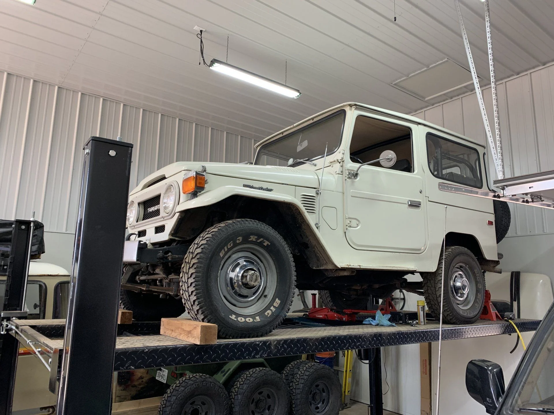

After years of debate on whether to keep this rig's suspension stock, the 40 finally went under the knife today for a new HFS 4” setup. I have been very happy with this same lift on Pikachu. With the 2.5' over stock shackles in the rear, the HFS has a clean and level stance. The OMEs that I have installed all sit ass high, which drives me crazy. Even the OME folks told me that there's no way around it, so HFS it is.
I am working on it a little at a time, but hope to have it wrapped up in a couple of days.
Naturally, I am keeping all of the original suspension in case I ever go back to it one day. For now though, I’m going to enjoy the better ride and look.

I’m installing the whole kit, including their shocks, greasable shackles, bushings, etc. Also running shims in the back.

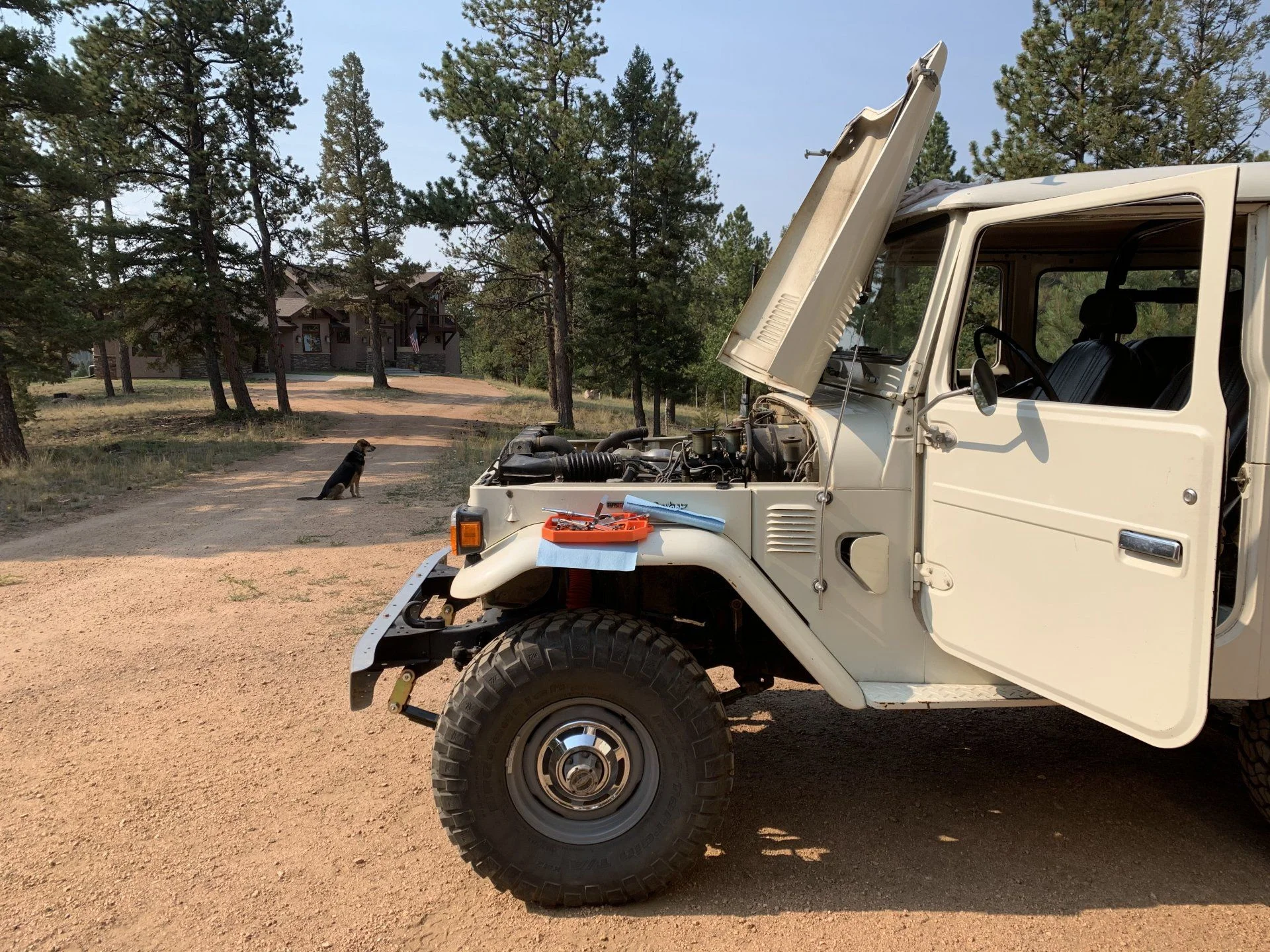

Happy Fall from a crisp and cool 9,100 feet in Divide, Colorado. Just installed new OEM points and tightened up the HFS suspension after a couple hundred road miles.
