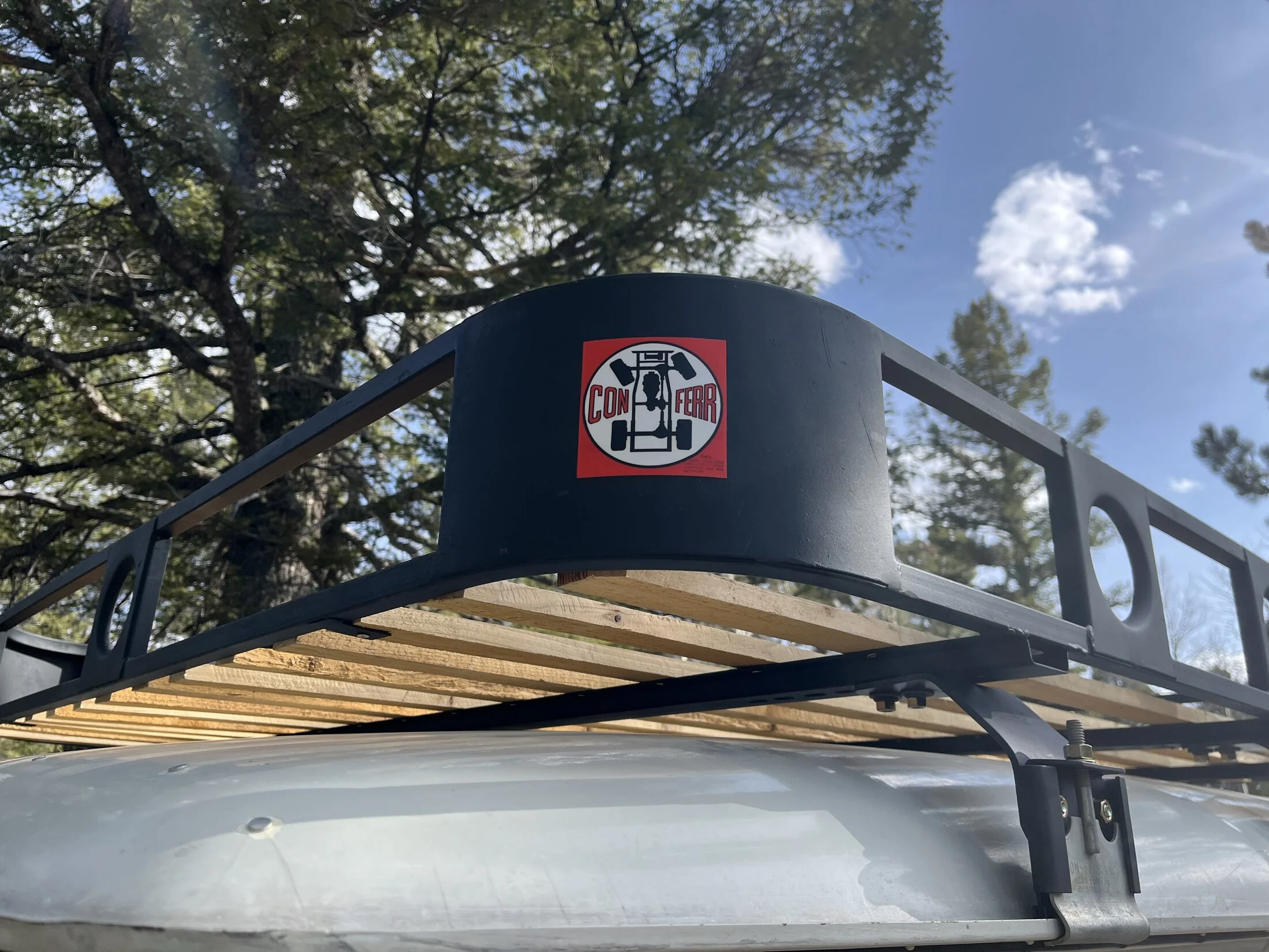

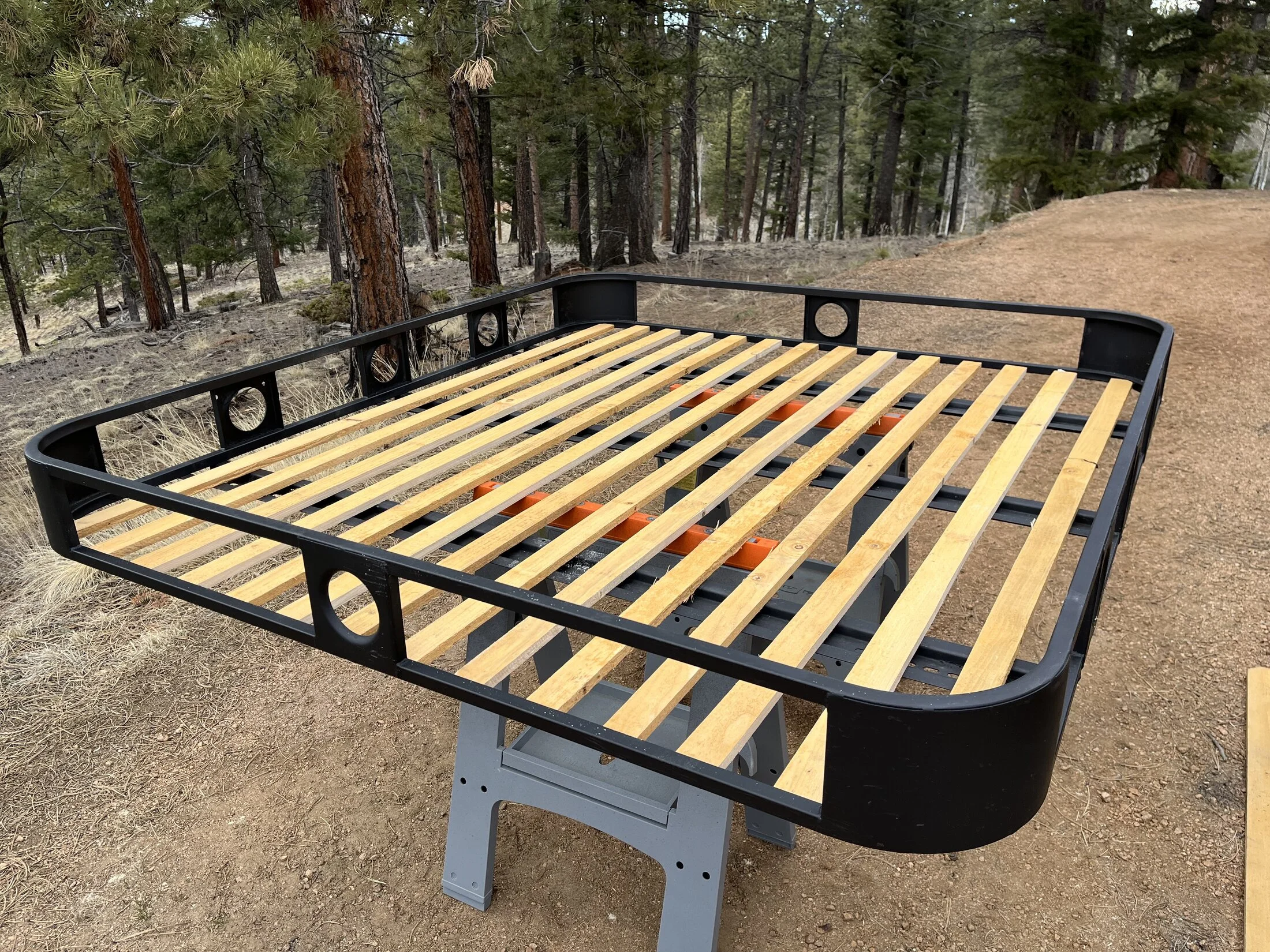

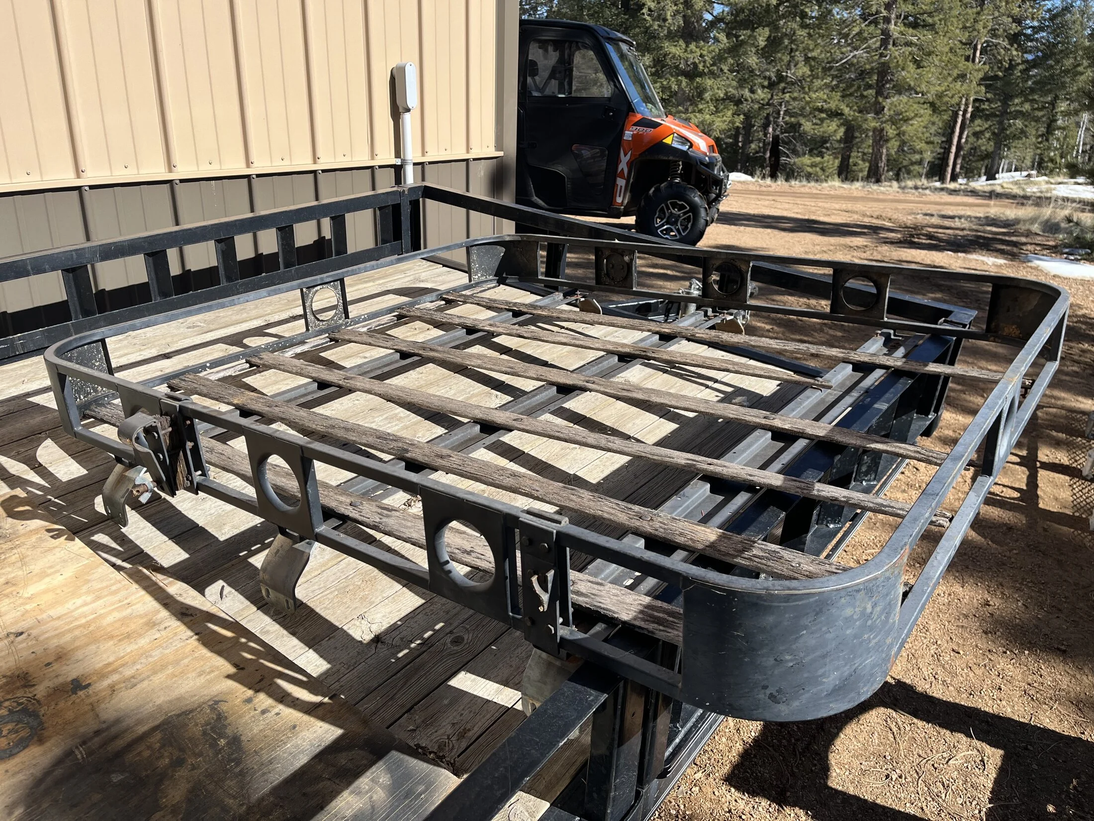

So by chance, I picked up two large old-school Con-Ferr racks a few weeks back. One went on Pikachu, and the other needed a little more work and is going on this 40. Here's what it looked like when I picked it up.
Obviously it needed some paint work, but the slat flooring gave me an idea for a more classic look.

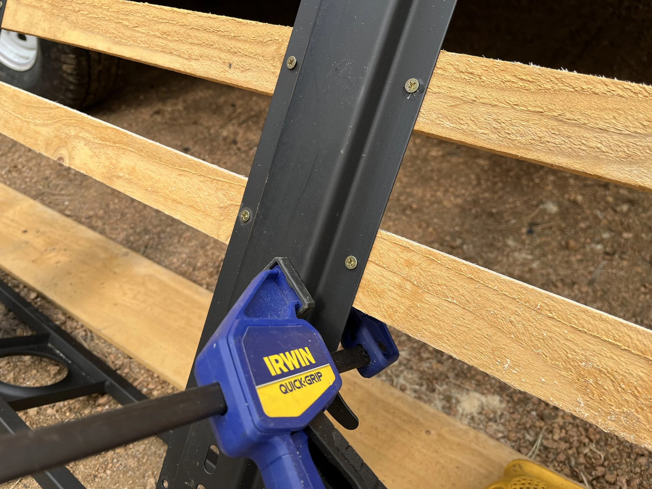

I bought some pre-stained 6' cedar fence pickets and cut them into three strips each. Turning out pretty nicely so far after 88 brass screws and counting.

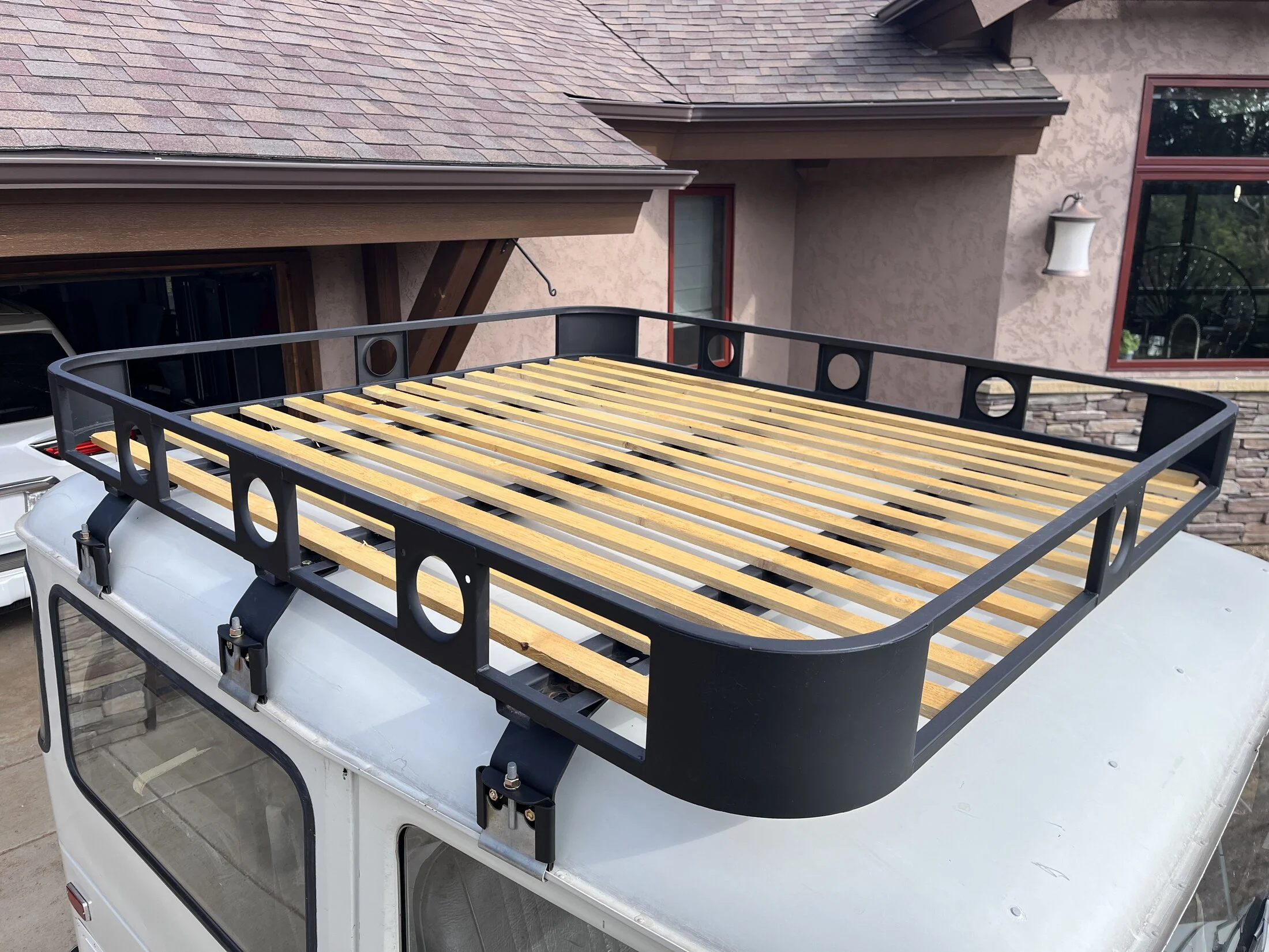

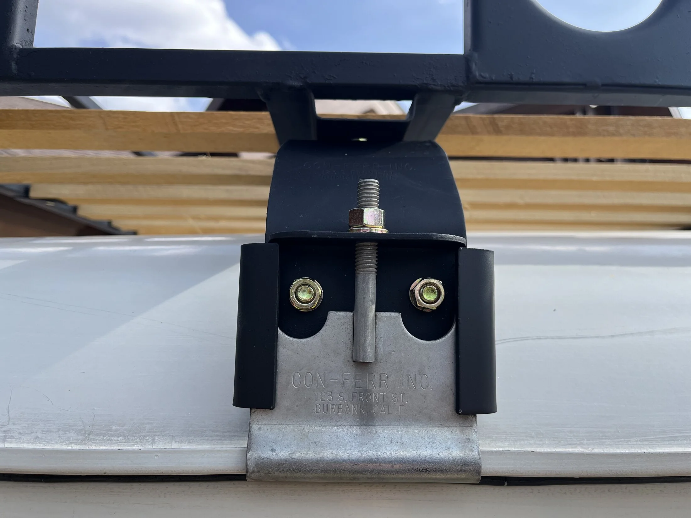

Got things buttoned up with the rack. The feet were rusty, so I stripped and painted the steel but cleaned up the galvanized part and installed new hardware. I am really happy with it.
@Texican the decals are also applied on two corners like the originals were.
Middle pic looks like its lifting the drip edge some. Supposed to do that?
I think it’s just the way the camera caught it. But…you could easily bend a rain gutter with these old school racks. Gotta get it tight, but not too tight.

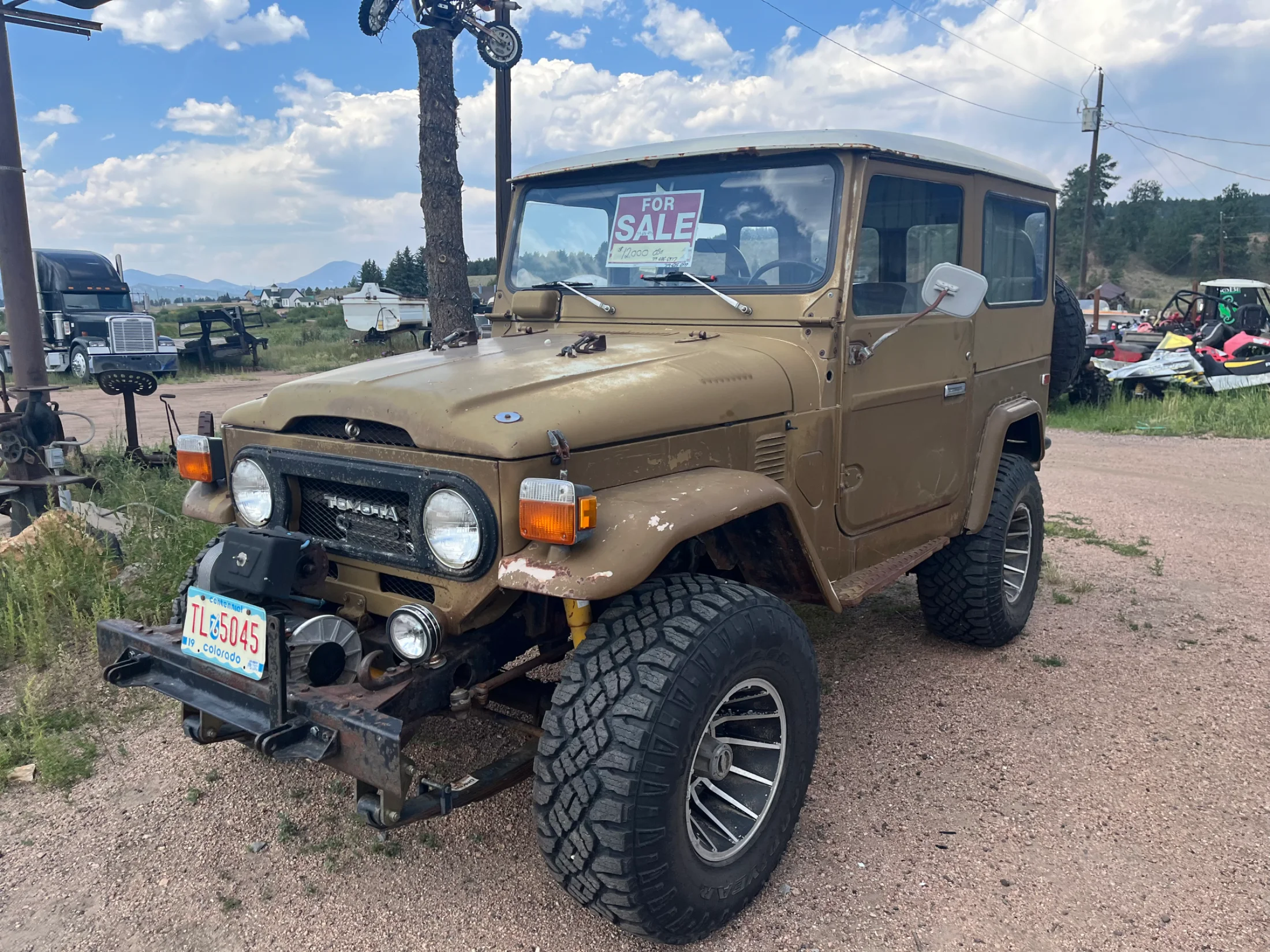

Ran into someone today who told me they thought there was an old Toyota "FJ boxy thing" for sale down the road in Florissant. Thought I'd roll up on a CJ-7, but whattaya know. Sure enough...
The fender flares cover uncut wheel wells. Not too much rust and the paint looks original in most places. Original '76 license plates and an 8274 to boot.
Just always nice to see these in the wild.
