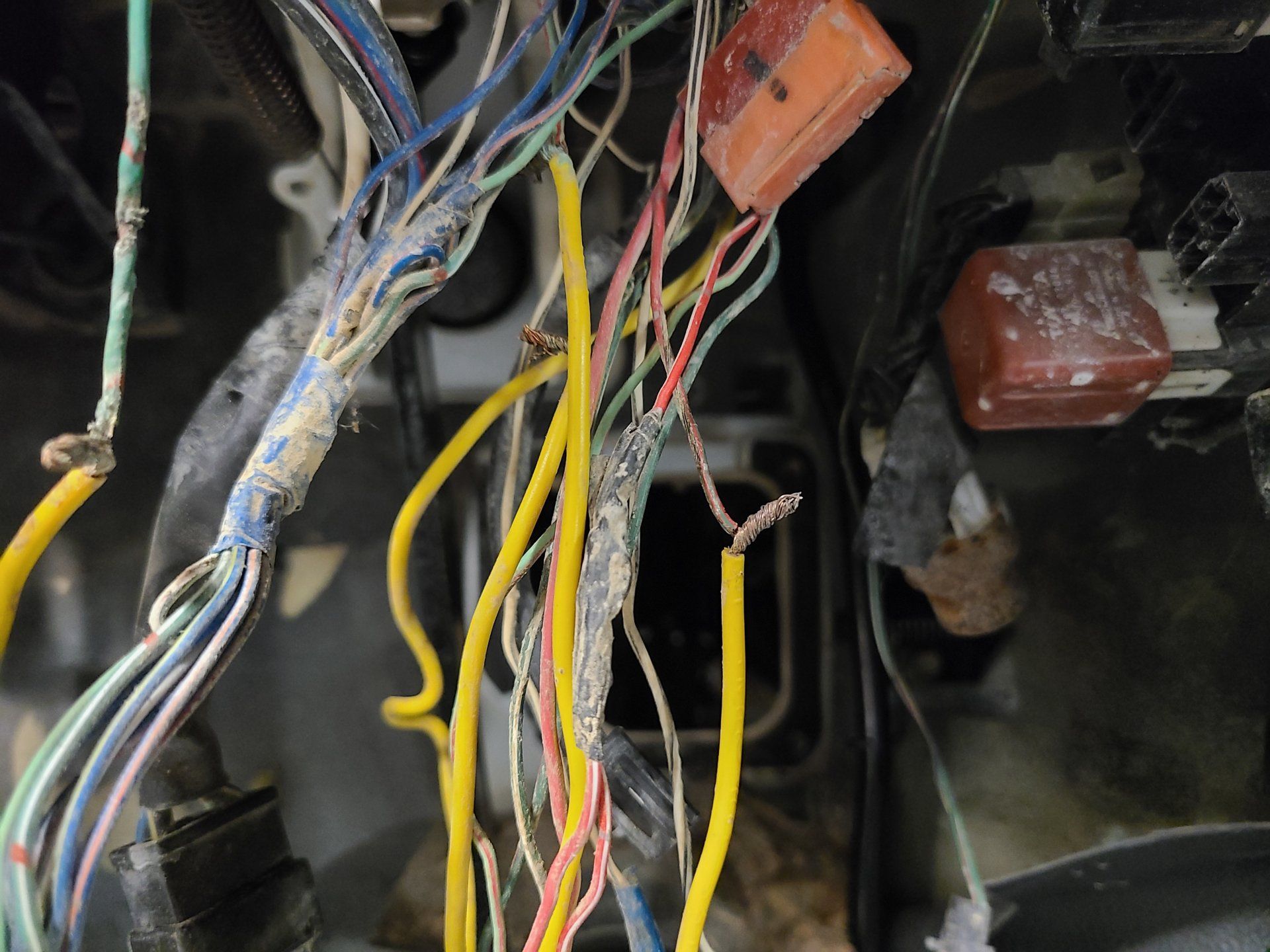

We found this lovely mess......described as probably being hit by mortar fire at some point according to my tech.

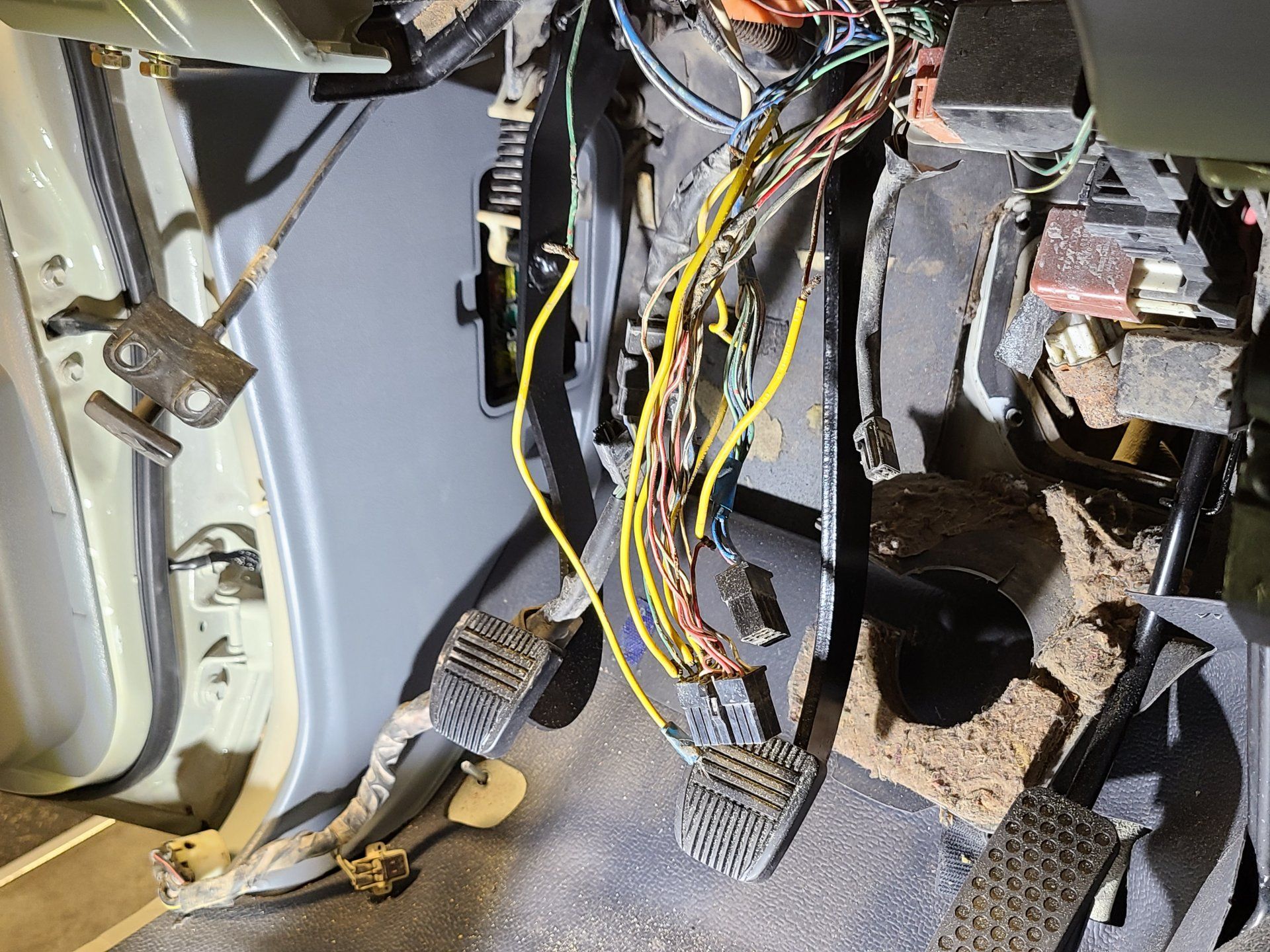

This is the main harness behind the dash. It's been cooked....melted....fried.....repaired(I use this term reluctantly).....and basically just a giant mess. We'll try to sort thru it.
A bunch of yellow wires usually indicate something isn't right.
See all the wires twisted together? That's how connections are made in the Middle East I suppose.

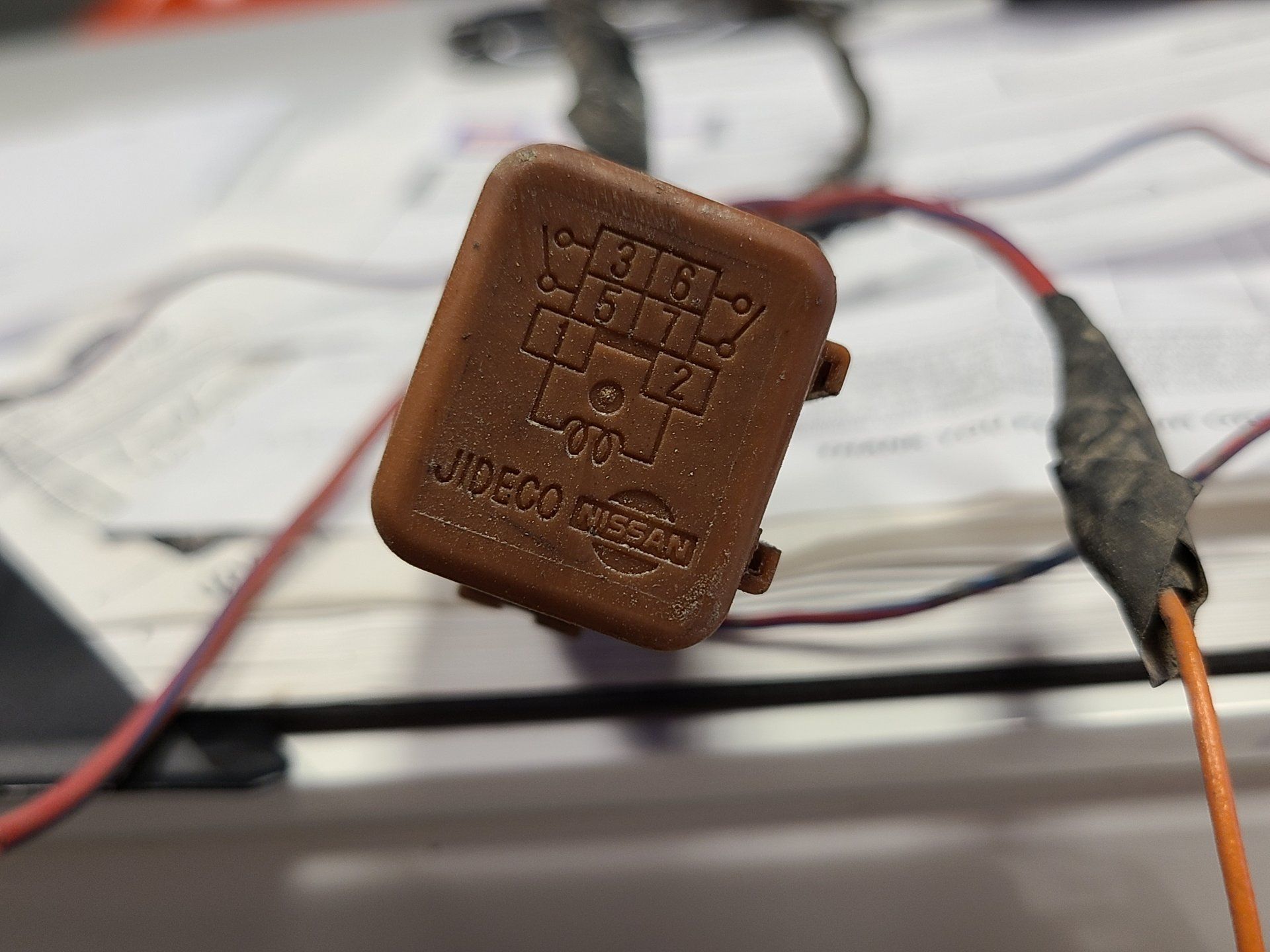

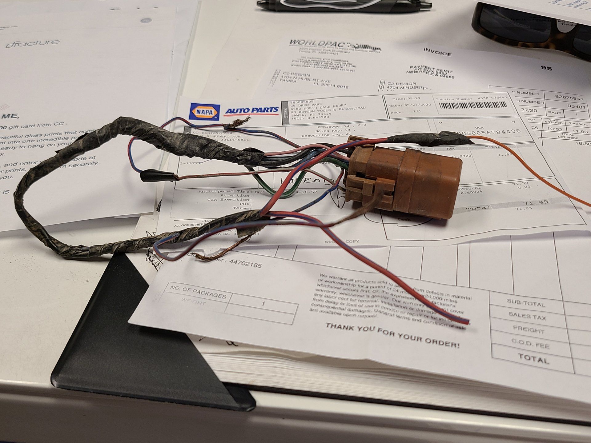

I'm by no means a wiring master but I know enough that Nissan relays probably aren't required for a Toyota starter. This was our starter circuit. No idea why.....well....kind of an idea why.

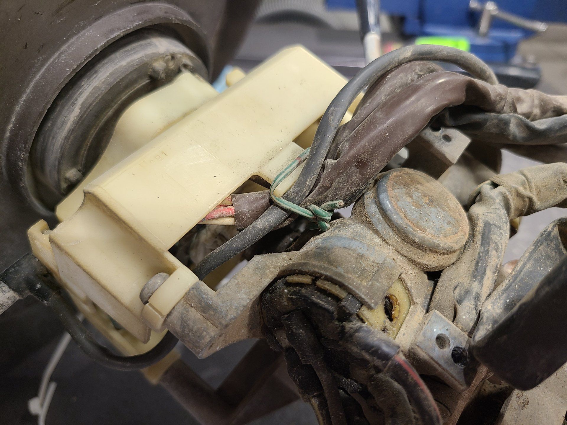

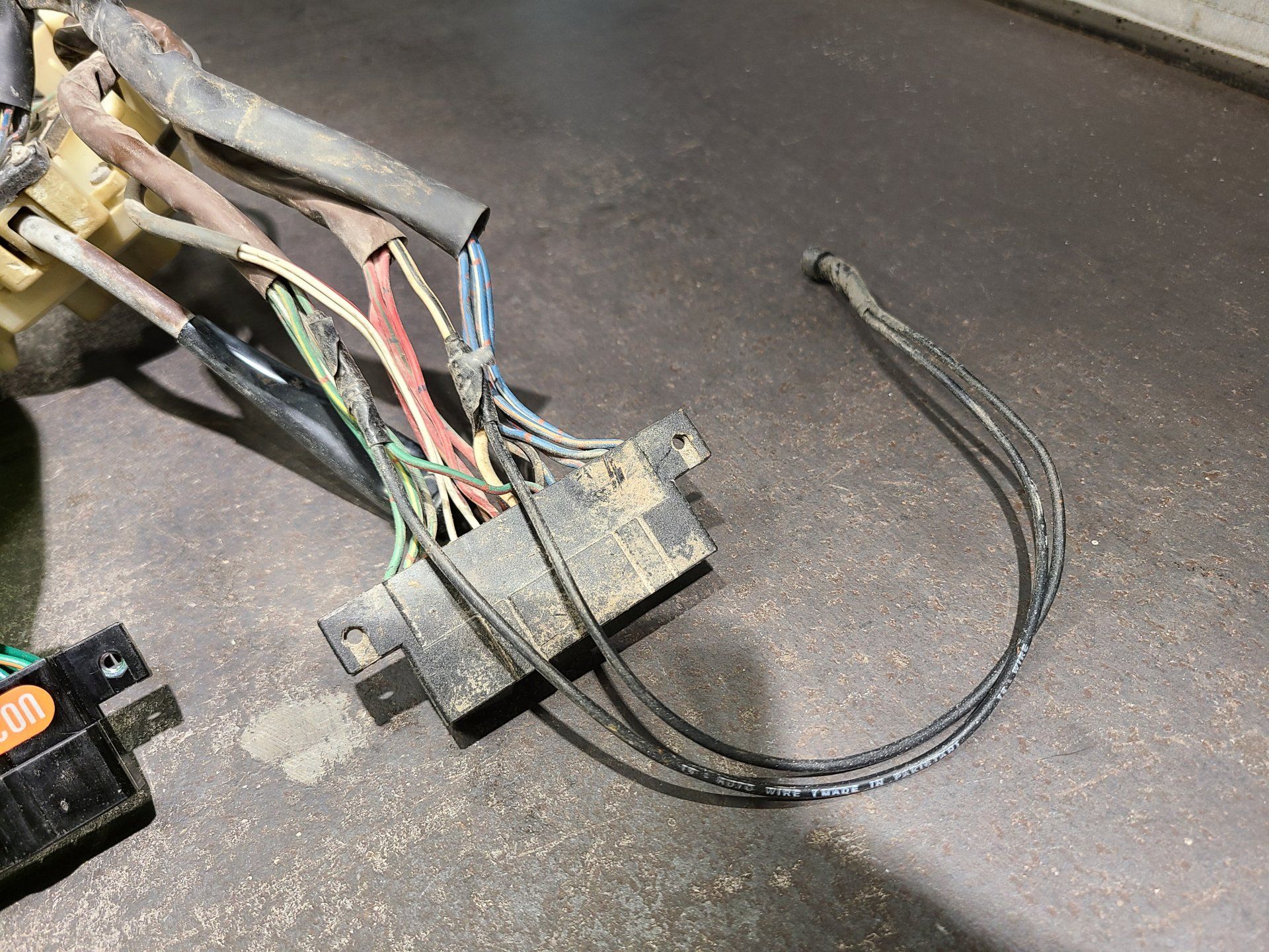

So we could never quite figure out why our headlights didn't work. Parking lights were fine but no headlights.....we poked around a little but didn't get into it too deep. Well we figured it all out today.

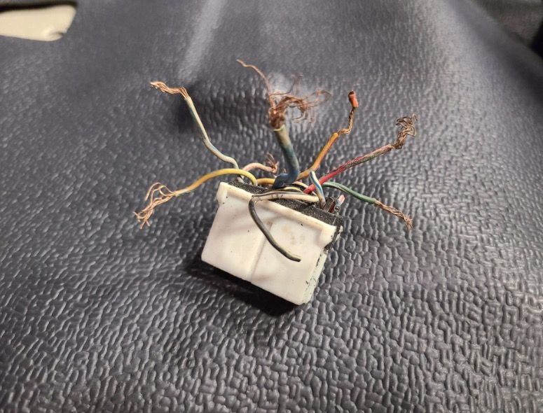

I have a new turn signal assembly....I aways put new ones in my trucks. I love having that new feel to the stalks....and how clean they look. This is what we found when we removed our original one....yes...that's wadded up paper.
Oh....and if you don't have a wire tie...just use some wiring. Ha.
Funny thing....there was a weird button(maybe a toggle switch) that was connected to the steering column harness....it was tapped into a ground and a green wire. Once we plugged in our new stalk assembly....we had lights. Pretty sure the added toggle was for the headlights. Also pretty sure the headlights shorted out at some point and probably fried/melted our harness. At least that's what I will assume. Or it was a mortar.
I have a new turn signal assembly....I aways put new ones in my trucks. I love having that new felt to the stalks....and how clean they look. This is what we found when we removed our original one....yes...that's wadded up paper.
