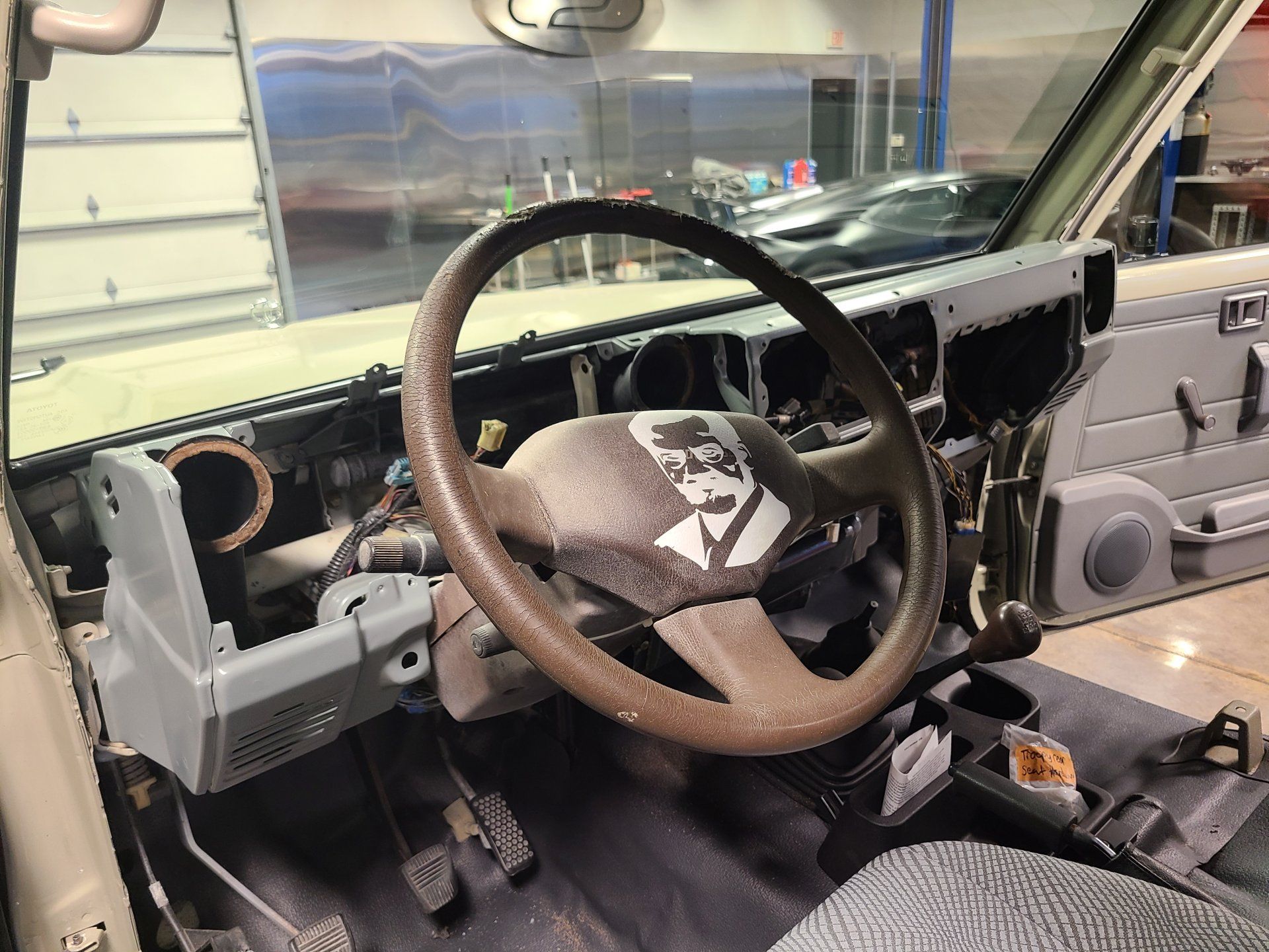

Working on assembling this part of things..
As usual Saddam is watching over things.....not happy either....his days being on that horn pad are coming to an end.
It seems like an eternity ago we had all this stuff powdercoated....
We'll mount this foot rest in the truck too....fits really well in regards to clutch pedal room.
