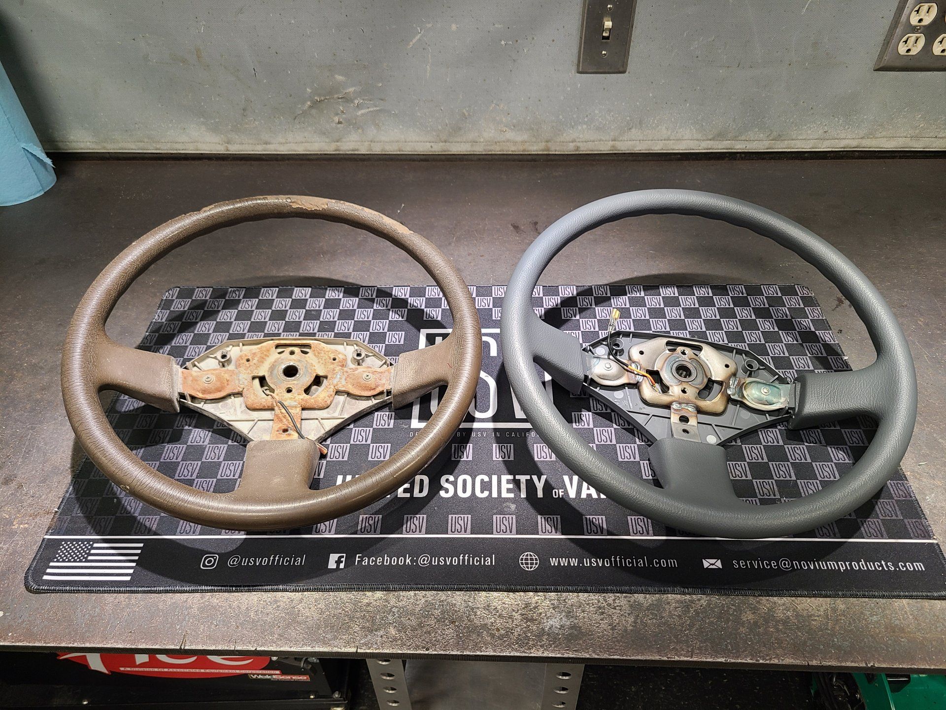

I don't know where Saddam is right now but I know he's not happy......today was wheel switch out day.
New steering wheels transform these old trucks.

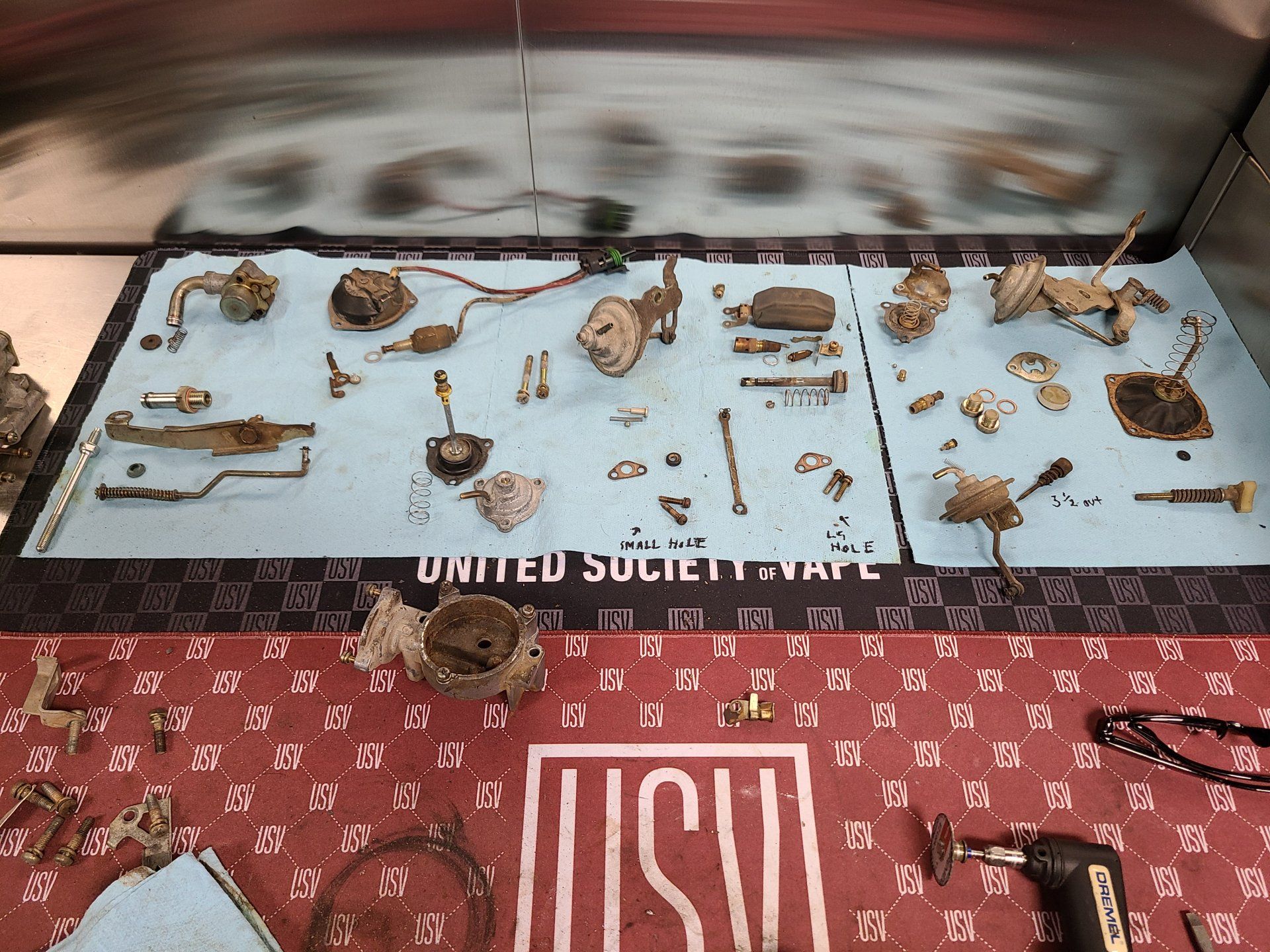

Spent a little bit more time on cleaning things up.....wiring and vacuum hoses on Troopy over the last few days. NOTHING was hooked up properly under the hood. So we tore in which resulted in this coming off....
I grew up spending a good amount of time at the beach always doing different board sports. If you've ever body surfed in shore break you know that sand goes EVERYWHERE.....places you can't imagine. I believe this carburetor might have spent some time body surfing at the Wedge in CA. This thing had dirt in places dirt shouldn't be....and a lot of dirt in those places. And the crazy thing is, the truck ran really well. Smoother than my 1FZ FE motors. Hard to believe.
Even more hard to believe when you take a look at the base plate. Yikes. New one ordered.
My FJ40 carb rebuilds have usually resulted in purchasing a Weber and being miserable so I left this one to the pro....

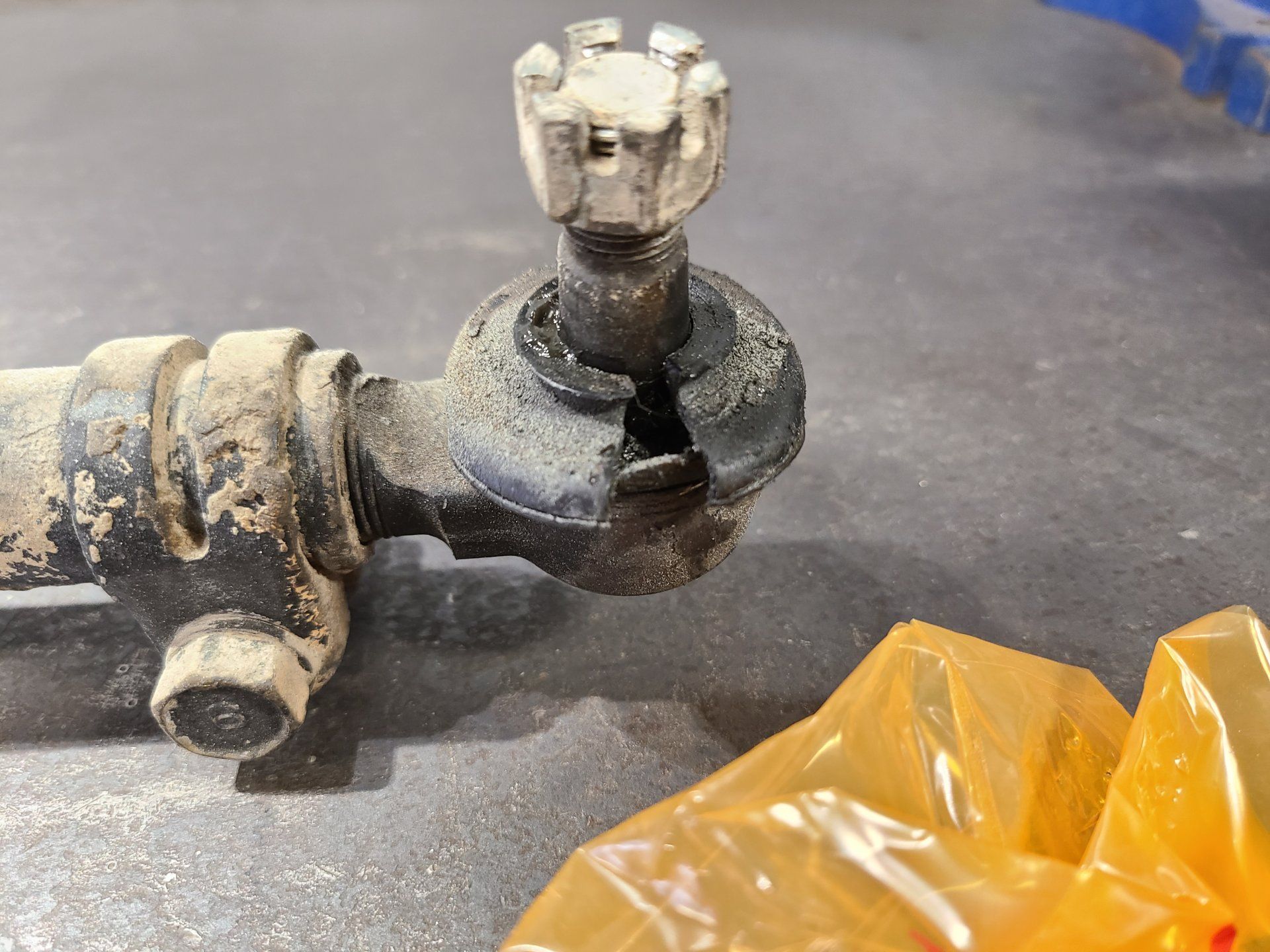

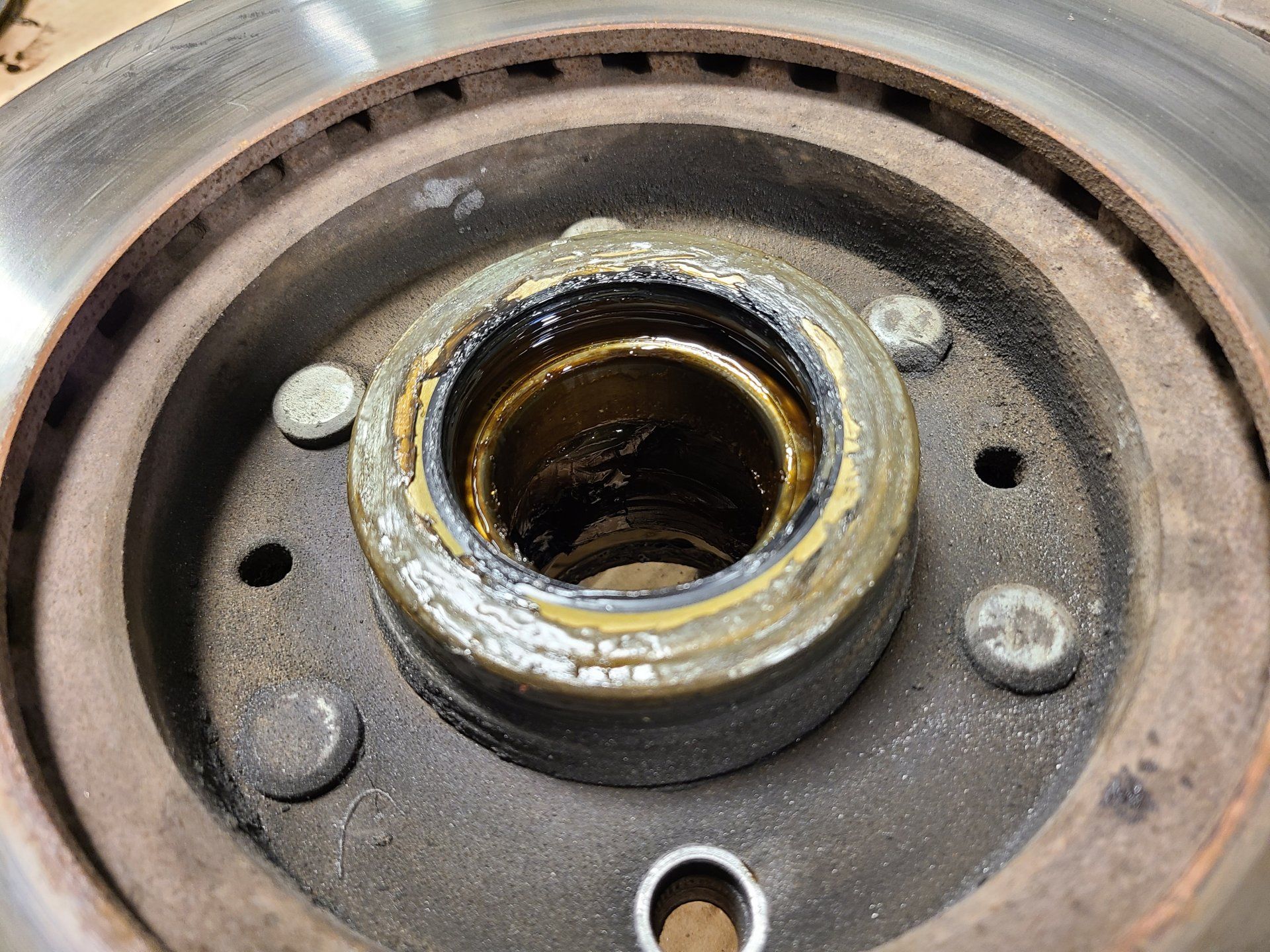

Tackling the front end on the Troopy this week.....it is.....well....interesting. Lots of home brewed fixes. Lots of RTV in places where RTV shouldn't be....oil in places where grease should be. And 'other' things.
Assuming this is a spacer for a caliper bolt that is not OEM....and the "spacer" is most likely missing from another part of the truck.
Some kind of really hard glue....like hot glue. That will keep them from leaking. Also, broken studs on both hubs.
Looks good....maybe we can get a few more miles out of it.
Every boot looks like this
Loading them up for a nice hot steam bath
This was really weird....we bent the bolt back and it came right out. Weird.
This was the better side of the 2.

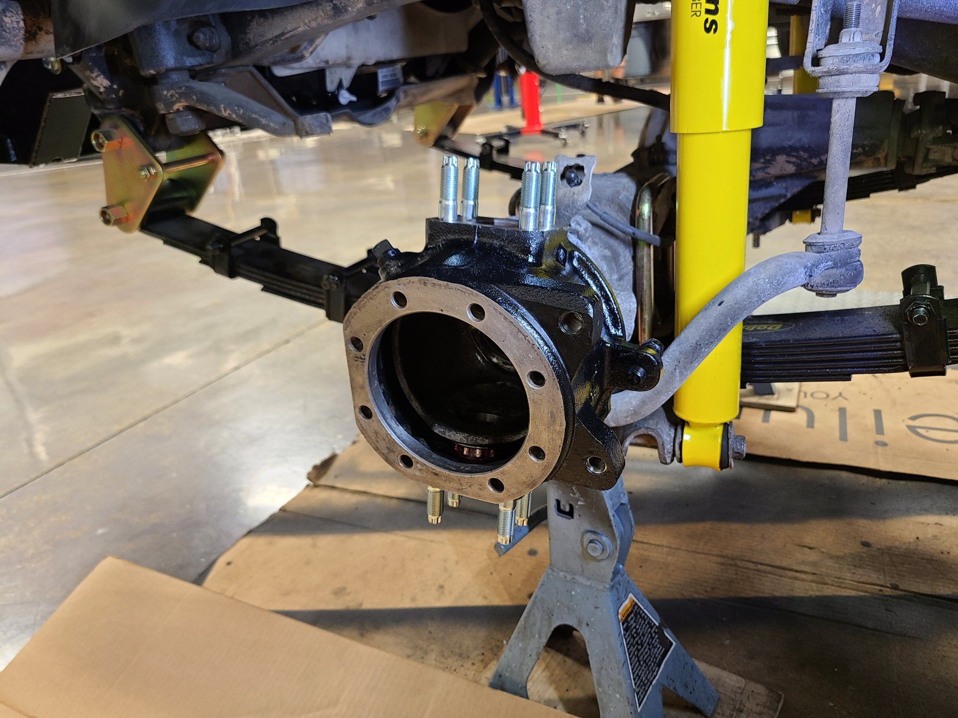

One of the bigger surprises with this truck....the birfields are like brand new.
All the other parts are starting to look much better.....
Apologies if I missed it somewhere but do you have a part number for that new steering wheel please ?
45100-60190-03 steering wheel
45130-60220-B0 horn button
Amayama seems to be the best bet for both of them......wheel ships from Japan, horn button ships from UAE. Looks like a LONG wait for the wheel from them.
It is a direct swap with some part finagling. I just converted my 70 from stationary to tilt steering.
That's pretty cool.....probably a fair amount of parts needed?
