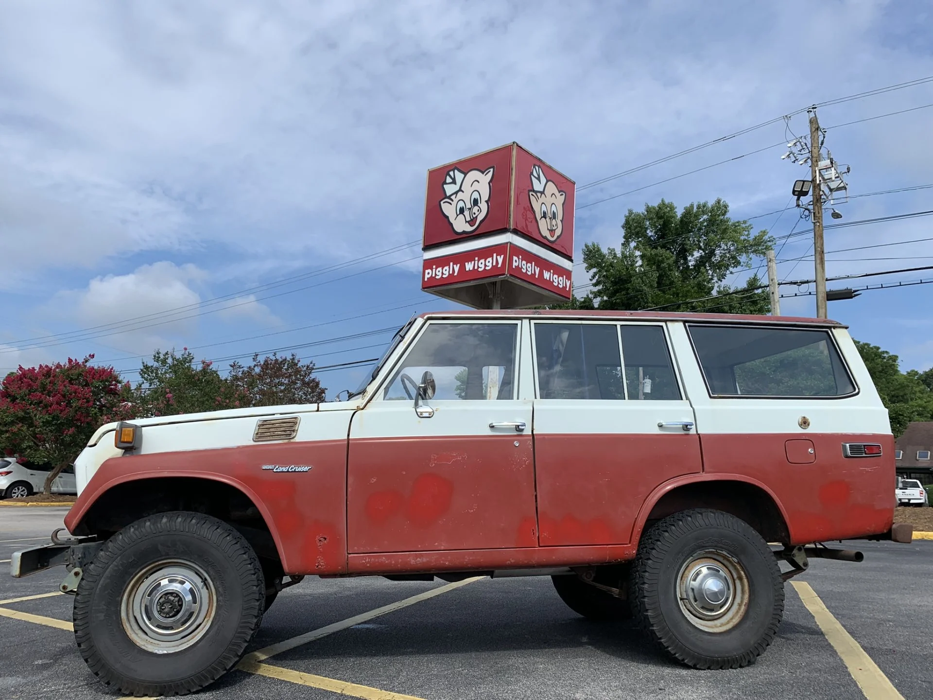

I think the Pig and Ms Troopy look pretty good together.

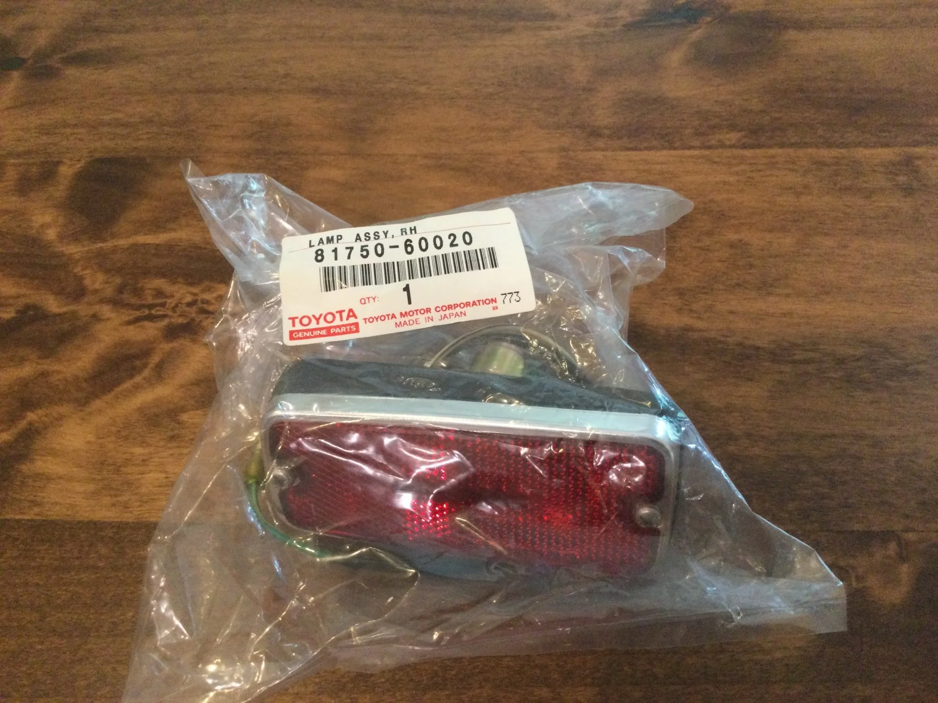

Turns out I only had a pair of NOS surround bezels for the side marker lights and not the actual light assemblies. After searching the internet far and wide (and checking with Yemen, etc.), I found the RH light assembly on a Japanese Yahoo auction with a buy it now price of around $15. Emailed Dave at Japan4x4 and he was kind enough to purchase it and send it to me.

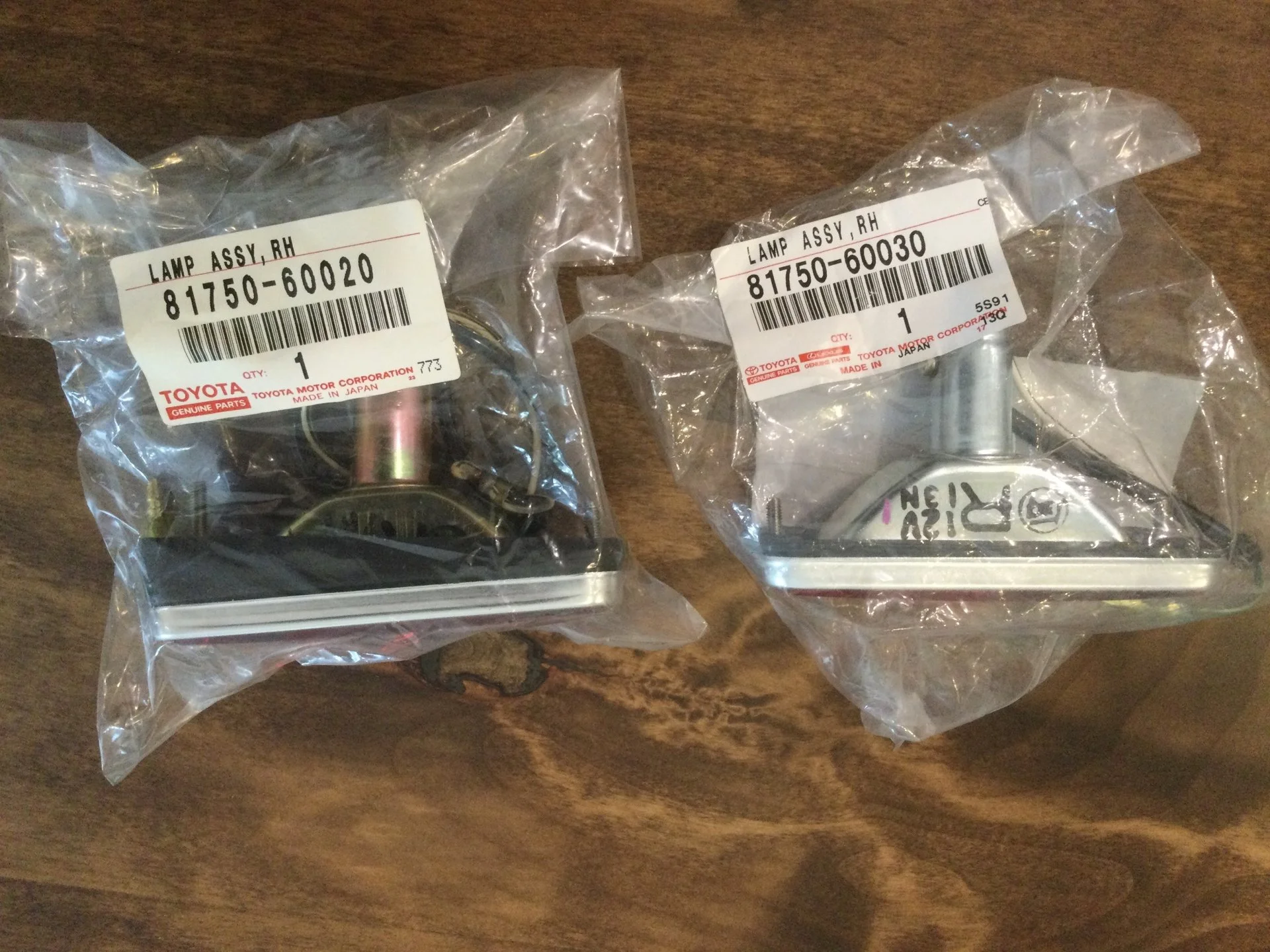

In doing some research I found out that the 40 series side marker light lenses are the same as the 55. Unfortunately the lenses are NLA but you can still get them if you buy the 40 series assembly (~$30 each). In doing further research, it appears that all the parts are the same except for the gaskets. Would love to find a NOS LH assembly to get the new gasket and/or find a source for the gasket. So far I haven't come up with anything.
