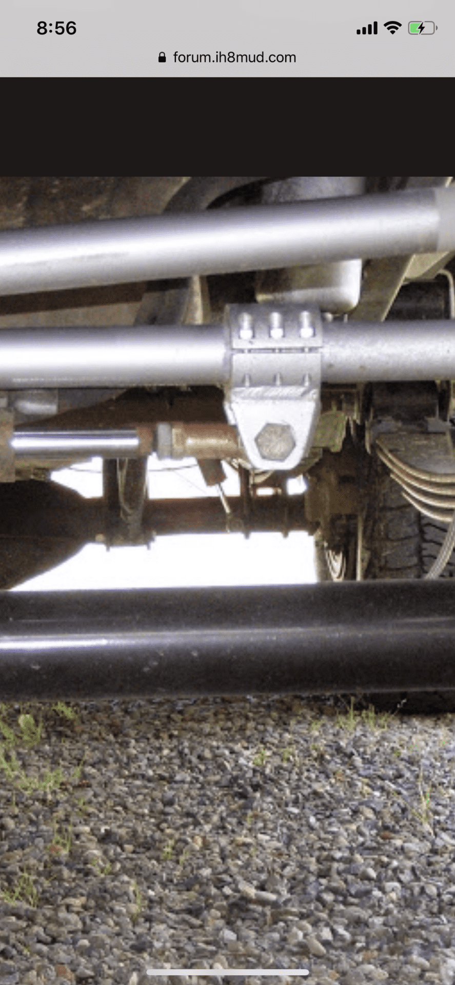

@boots4 where did you get the clamp that you welded the hydro assist arm to?

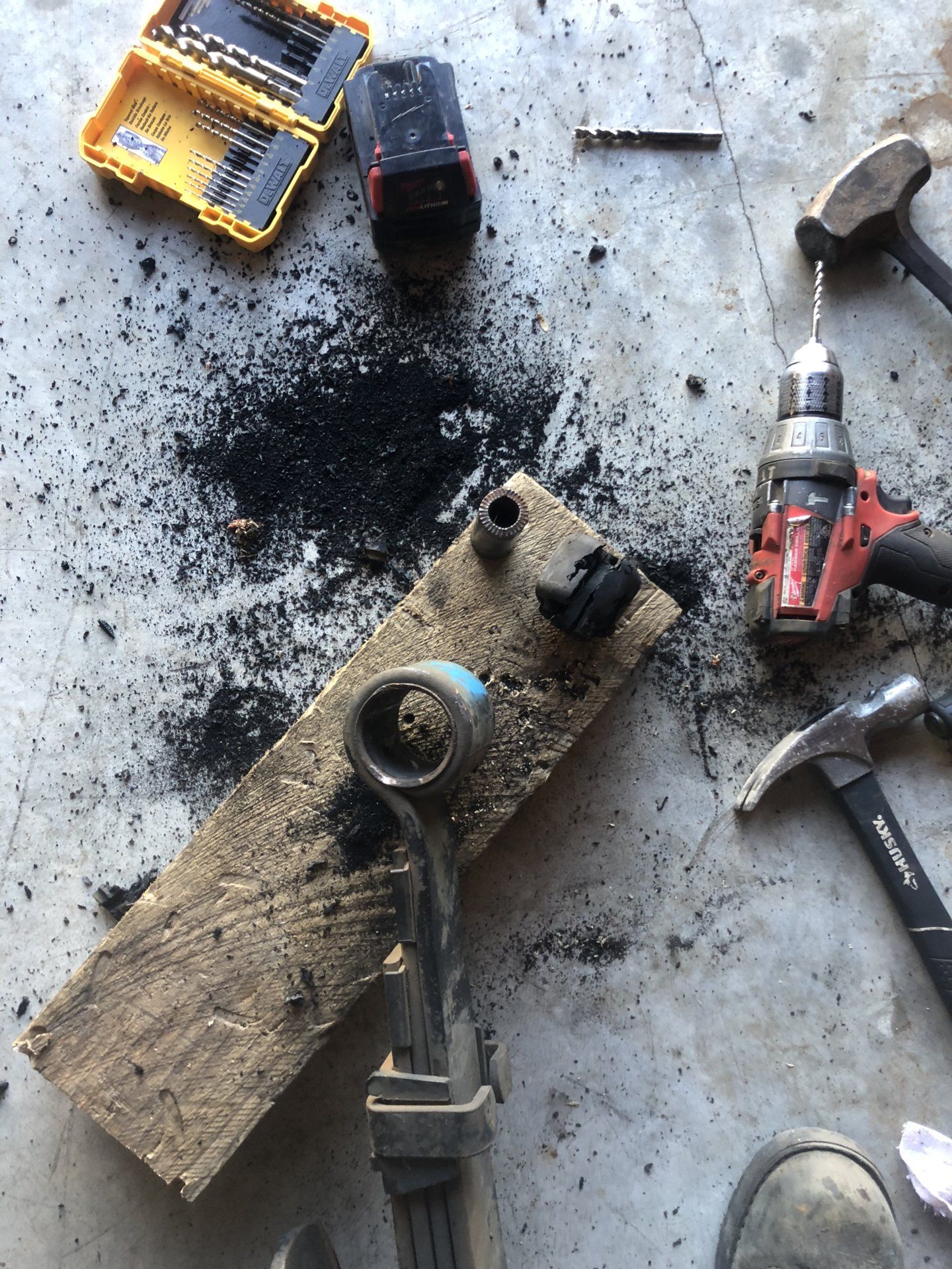

View attachment 1811105 Spent 1/2 hr today getting one of the Chevy bushings out. Drilled numerous holes with drill bit on both sides weakening the rubber. Eventually was able to get a section out and remove the metal tube from the rubber. 3 more to go...
Before you put your new bushings in check the bolt sizes, and check the bolt sizes on your frame brackets! On my Chevy springs one side had a 5/8” bolt and the other side had a 9/16”, apparently the change happened in mid 2000’s? Just something to look out for, it’s a lot easier to drill frame brackets on the bench rather then welded to the frame.
Yes good tip. I found there are 3 different bushings for the Chevy 63. Depending on the year and model. I don’t know what make, model or year my 63 springs came off of. I ran the spring by Superior Off-road and had Huston check it for me. He said he’d have the bushings for it and my rear stock 60s by Friday. He’s a Trail Gear dealer so he would also get the list of items I need for the knuckles. Had the ARB studs in stock. Going to add Aussie front locker and upgrade to Chromoly 30-spline axle shaft.

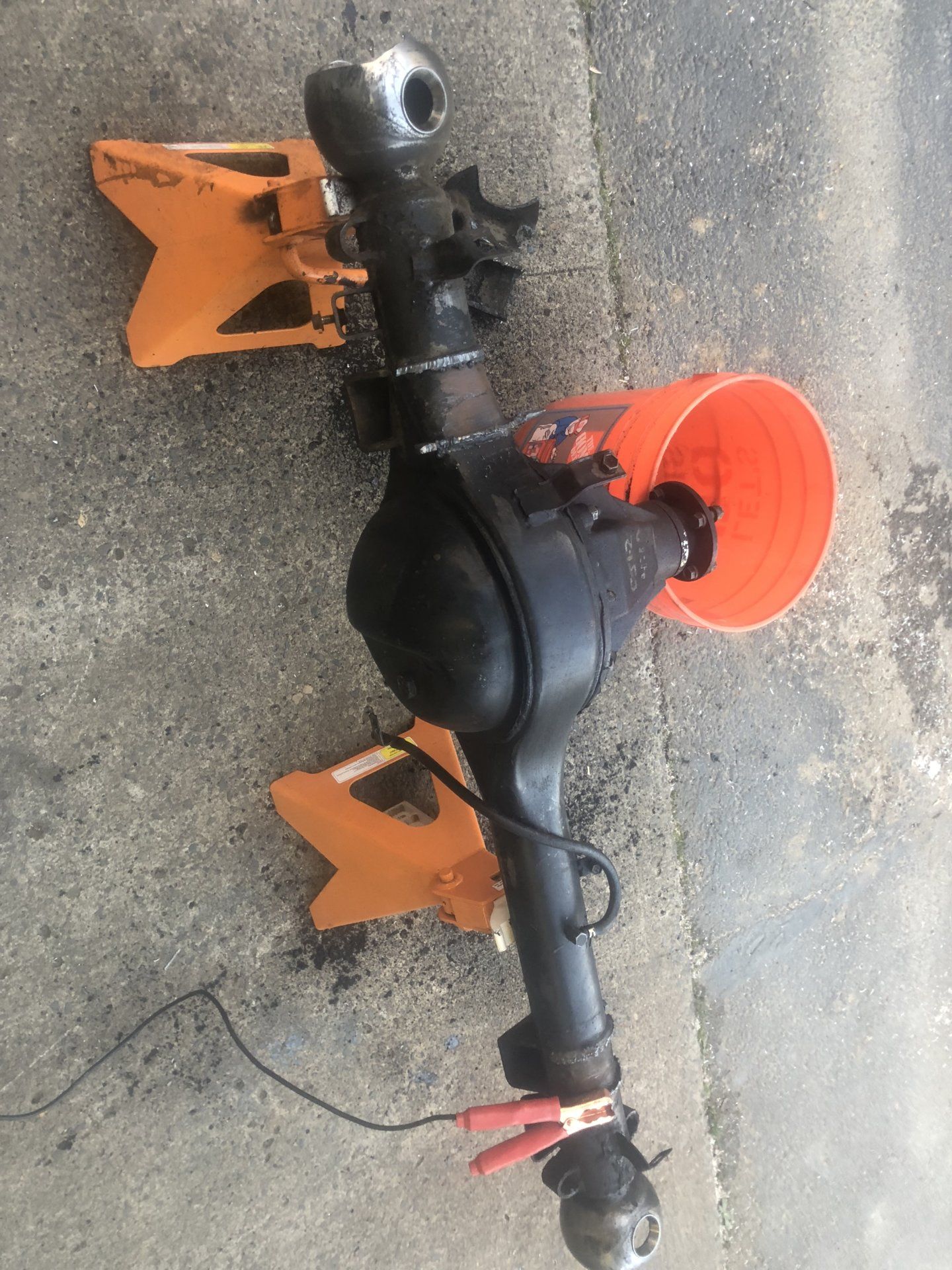

Got the perches cut off my front axle after work. Just need to clean the grit off and will be ready for Saturday. Used plasma cutter, angle grinder and flap disc... owe and good ole’ manual labor.:)
