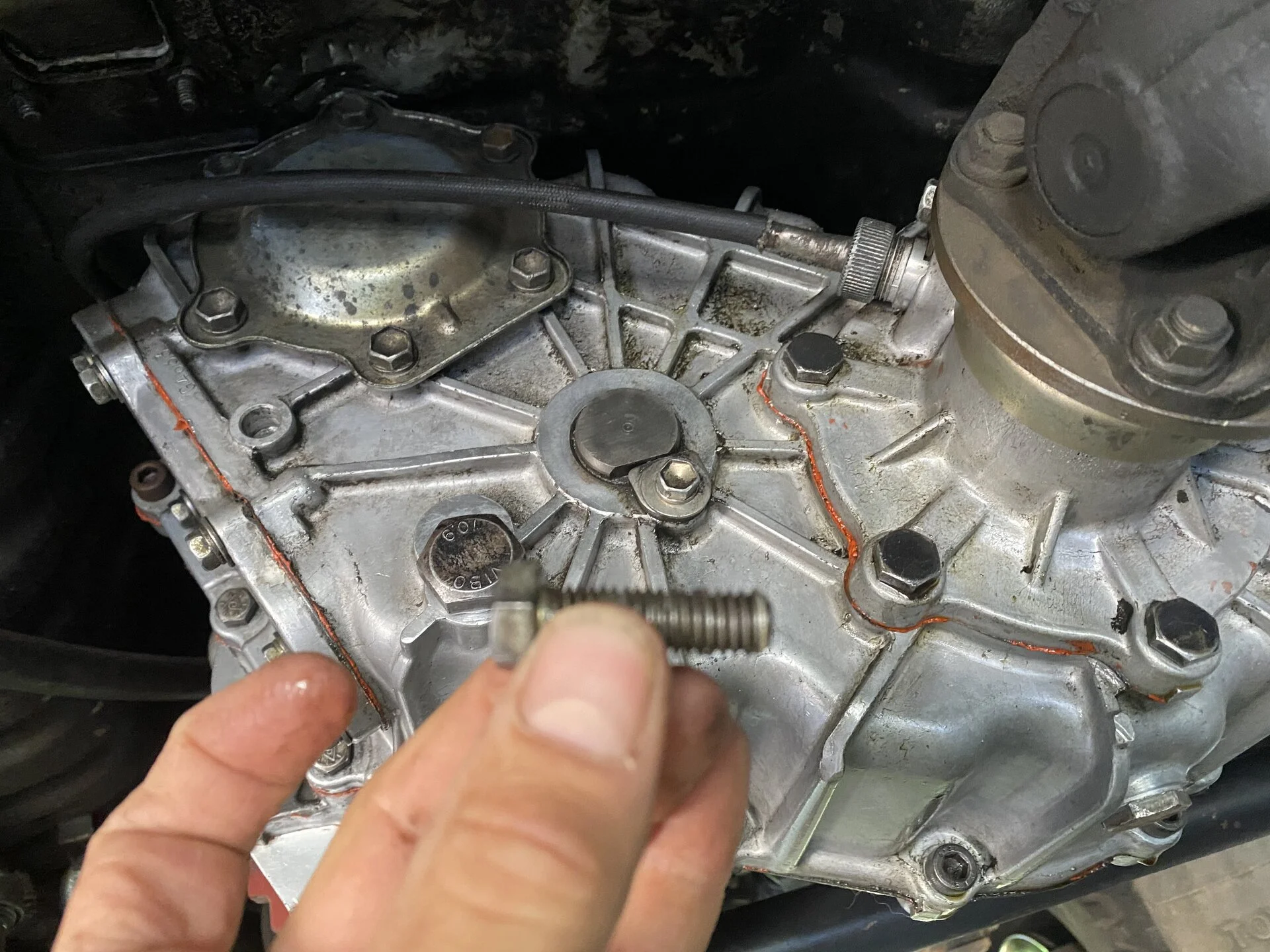

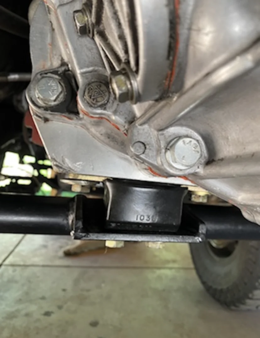

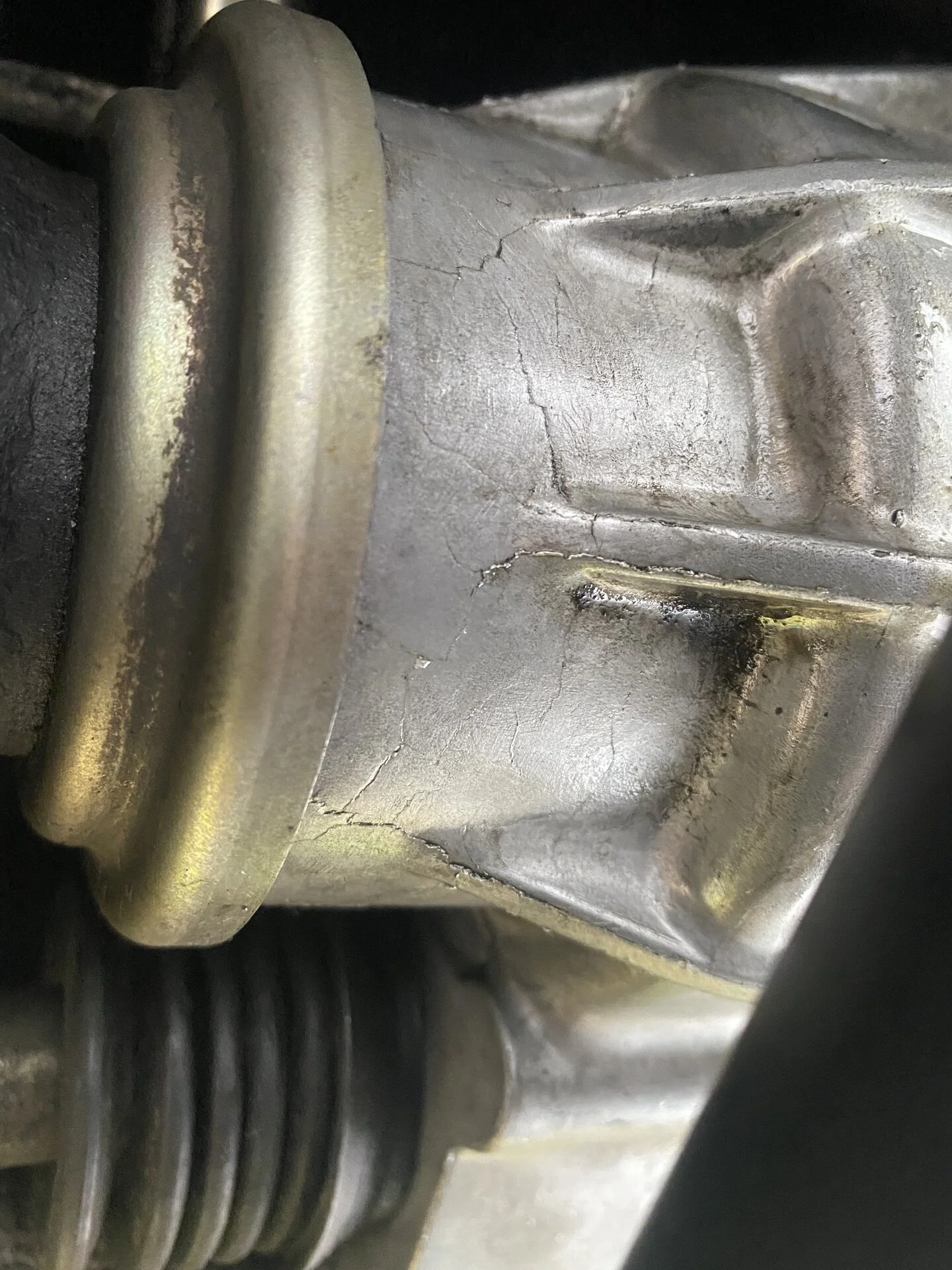

Well thought my gear oil leak was from my front output seal but after replacing it and still getting oil inspected further to see cracks in the Tcase.
@orangefj45 Georg at Valley Hybirds.👍. Stockton, Ca.
As mentioned during our phone conversation, those are casting ridges, not cracks.
Georg @ Valley Hybrids @ Cruiser Brothers
Got a pic?

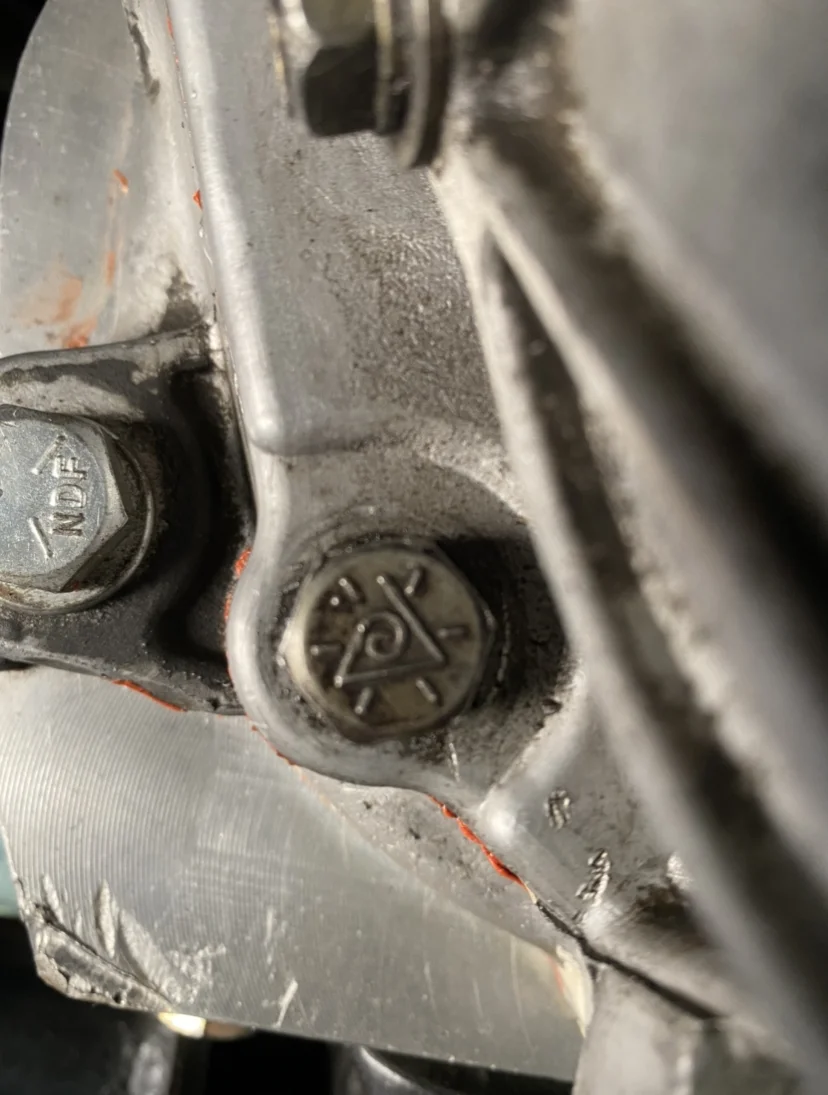

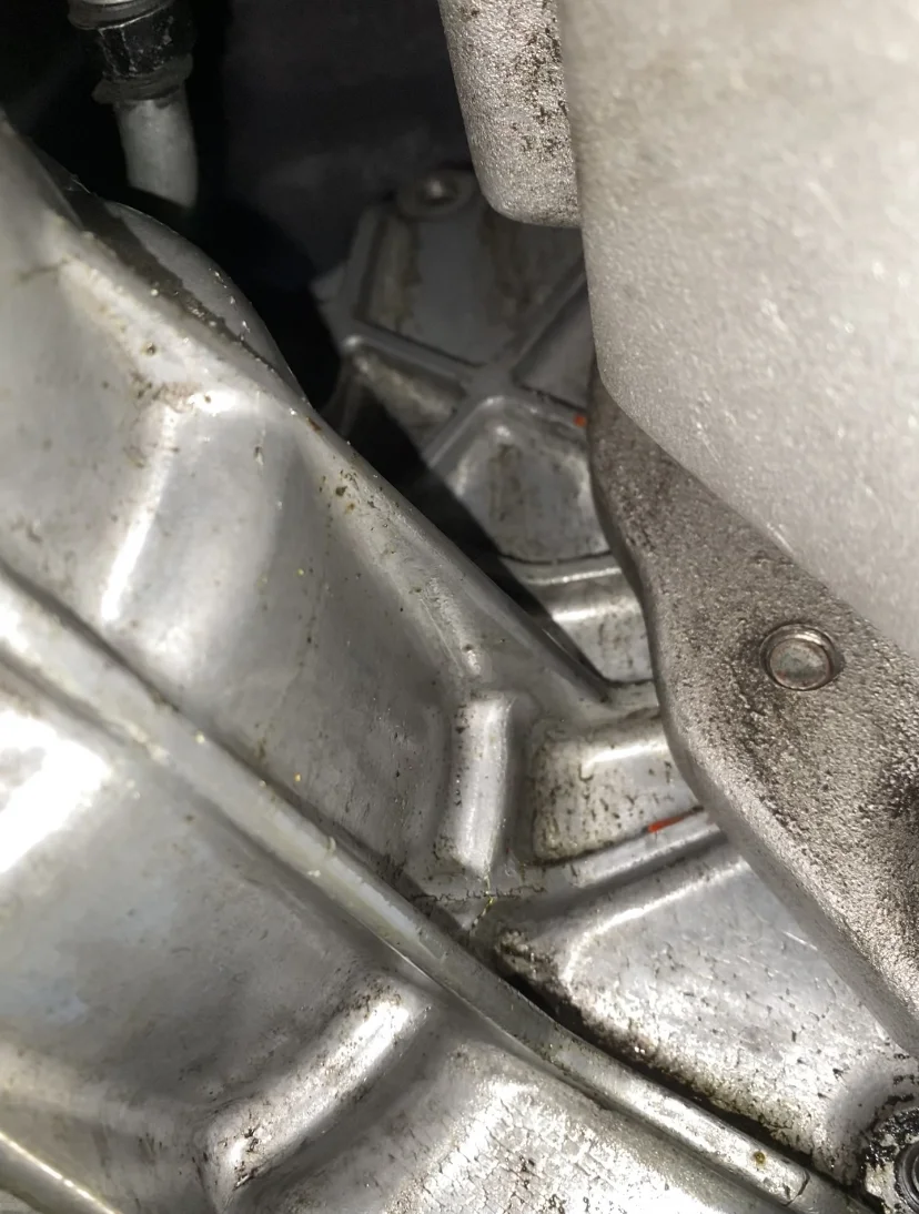

Drive to a wedding yesterday about 100 miles. Crawled under 60 to see the obvious trail from the back of the bolt hole.
Sure enough the bolt has hand tight.
Removed bolt and put some RTV on the threads and tightened it back in. Checked all the other bolts and they were good.

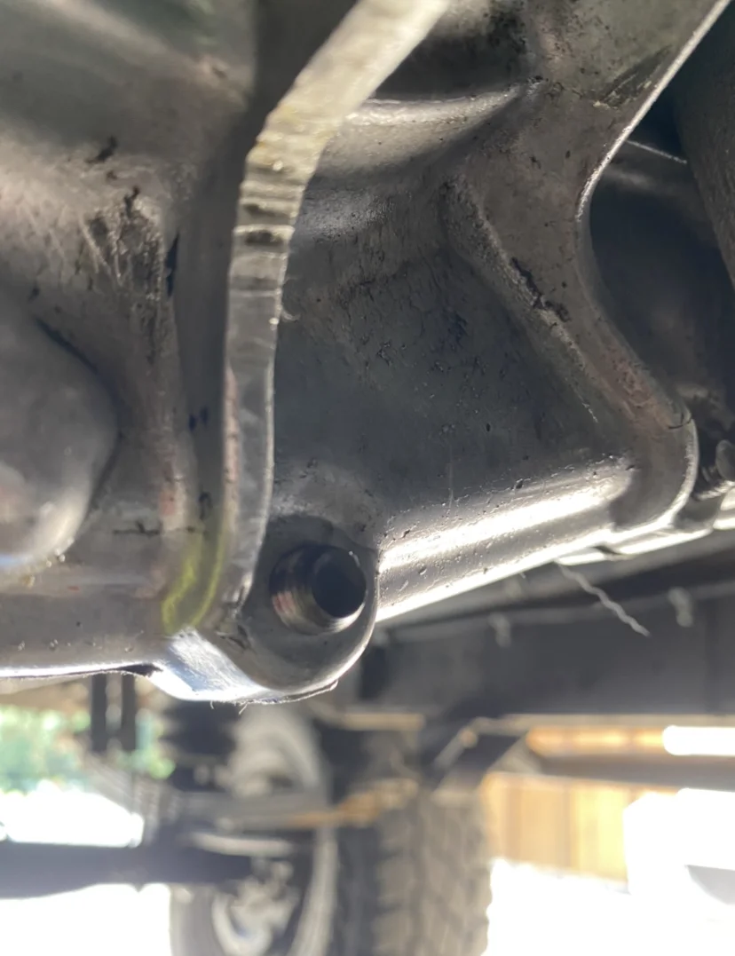

What bolt is that doesn't look oem?
Looks like 2F Flywheel bolts on the output housing.
Personally I like to drill and helicoil the AA adapters up to the Toyota M12 size and use the OEM Toyota bolts to fasten the transfer to the adapter. Especially behind a torquey engine like a 4BT. The cheap and undersized hardware (and frequent lack of dowel pins) is the biggest fault of their product in my view
There are 4 long bolts that go through the case into the advanced adapter.
The bolt which was hand tight has this symbol on the head.
There’s 5 Allen head bolts that pass through the case and stick out the other side.
You got them illuminati bolts
Very true and I agree.
However, I prefer time-serts; can’t stand helicoils.

Thanks Georg! You were right about the casting flaws. Super awesome to have experience on this site! That loose bolt was the source of the split case fluid leak.
Glad you got it figured out.
Yeah I’ve worked on a few of these …….. I think I have 6 of them torn apart right now.
