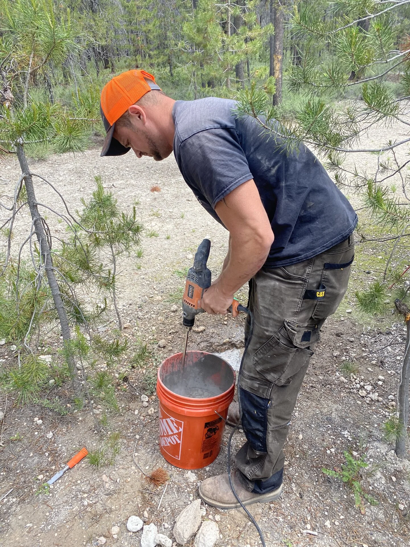

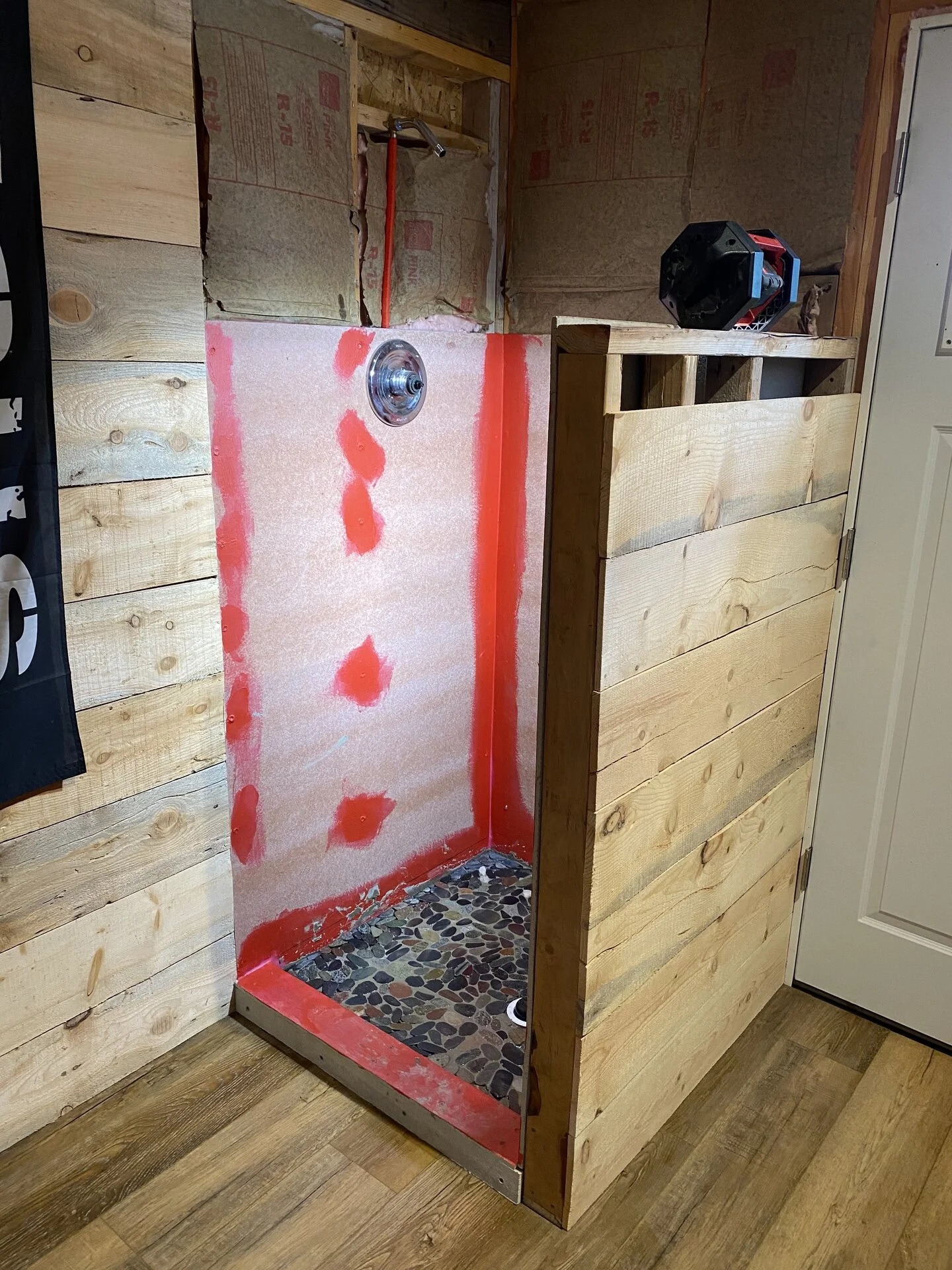

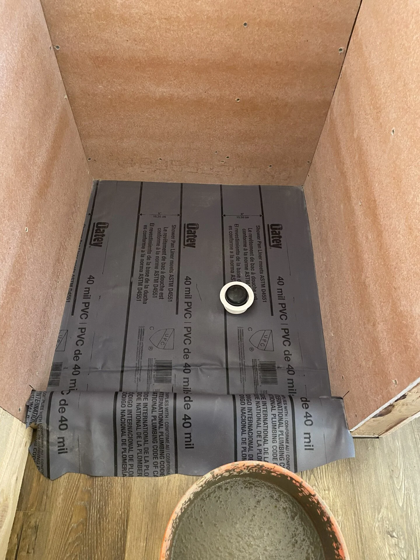

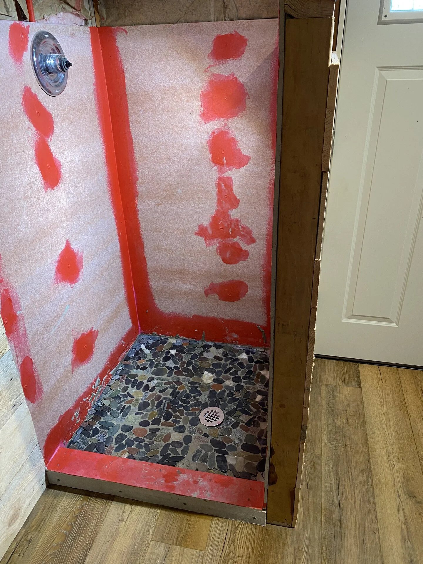

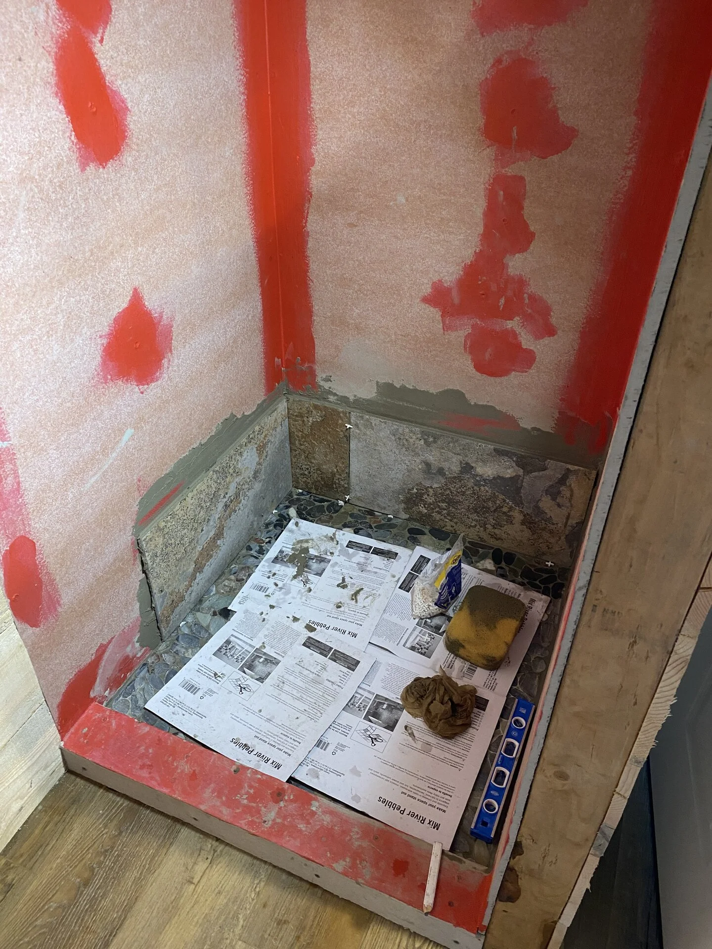

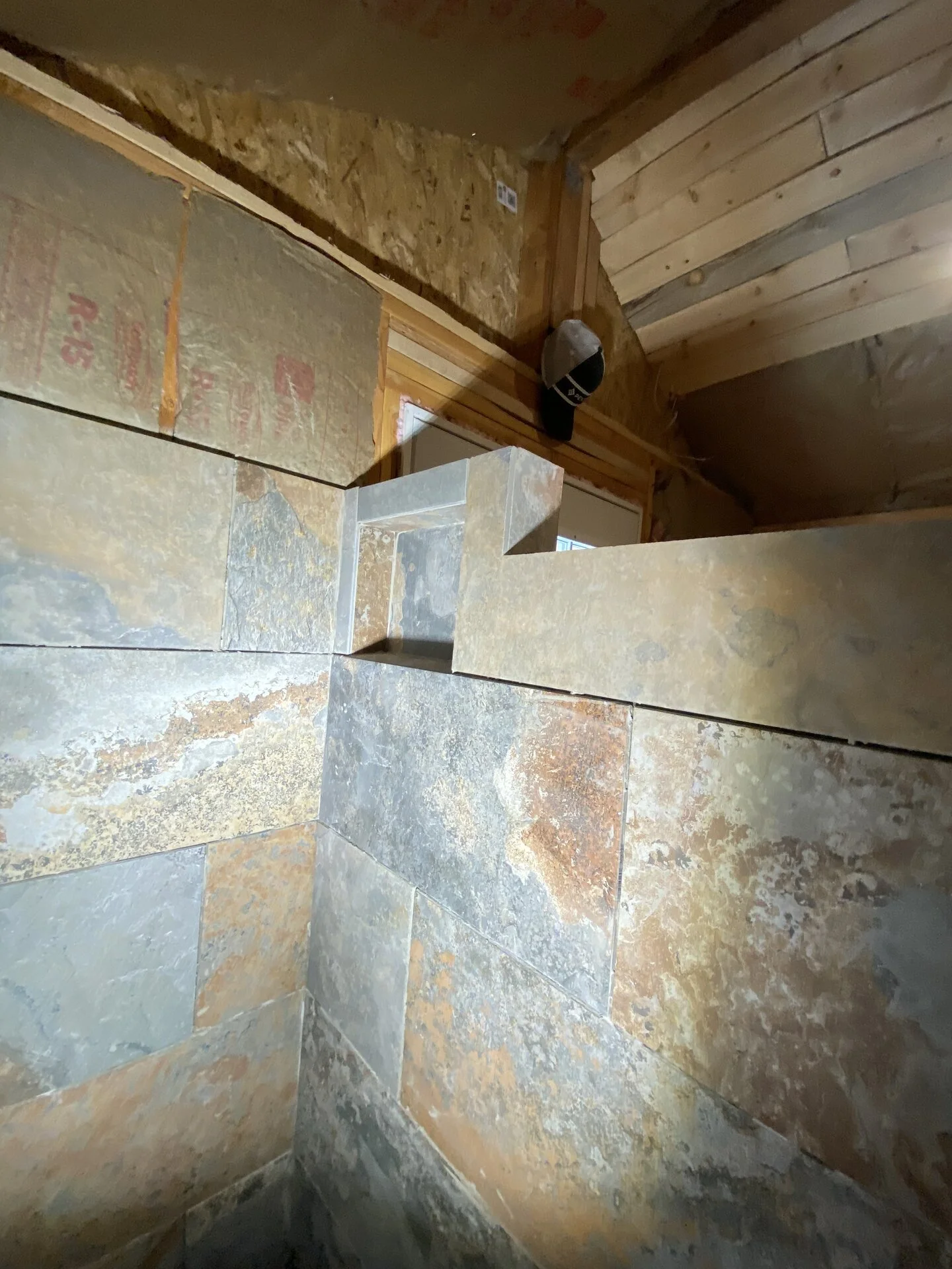

Installed the floor liner this morning.

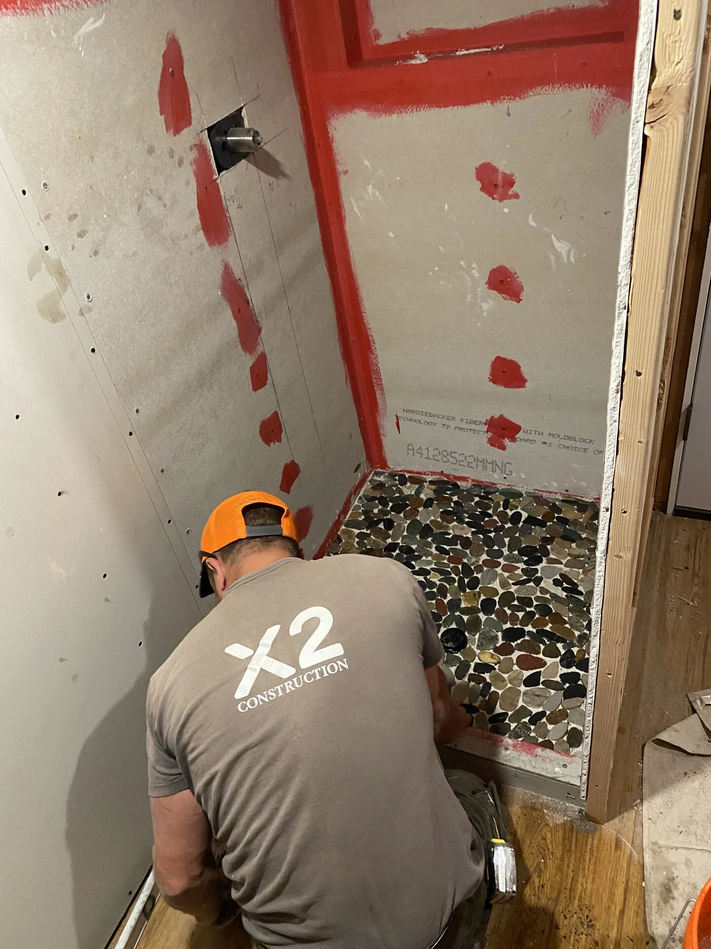

Installed the hardie board.
Travis mixing up the floor leveler.

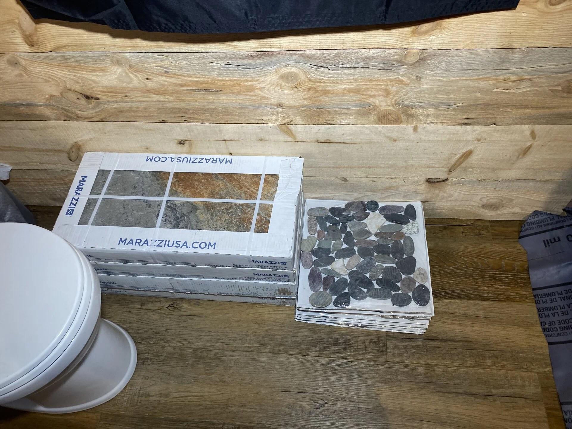

River rock floor tile and the wall tile.

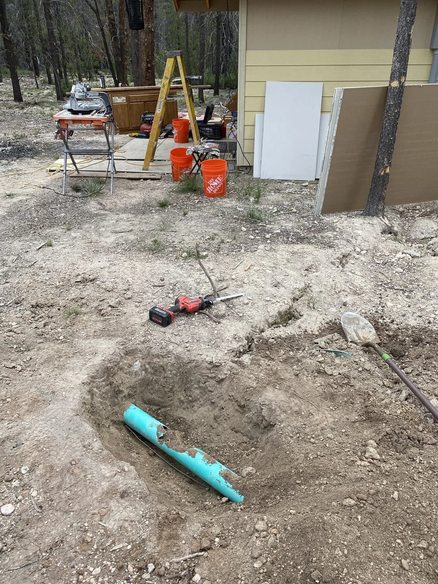

When Travis dug his trench for running 3” conduit for power he must of hit his septic line to the tank as septic the black water from the trailer was coming out of the ground when he drained it. Dug it up to see a chunk of pipe has gone. We were going to Klamath Falls anyhow to get materials so just one more thing to get.

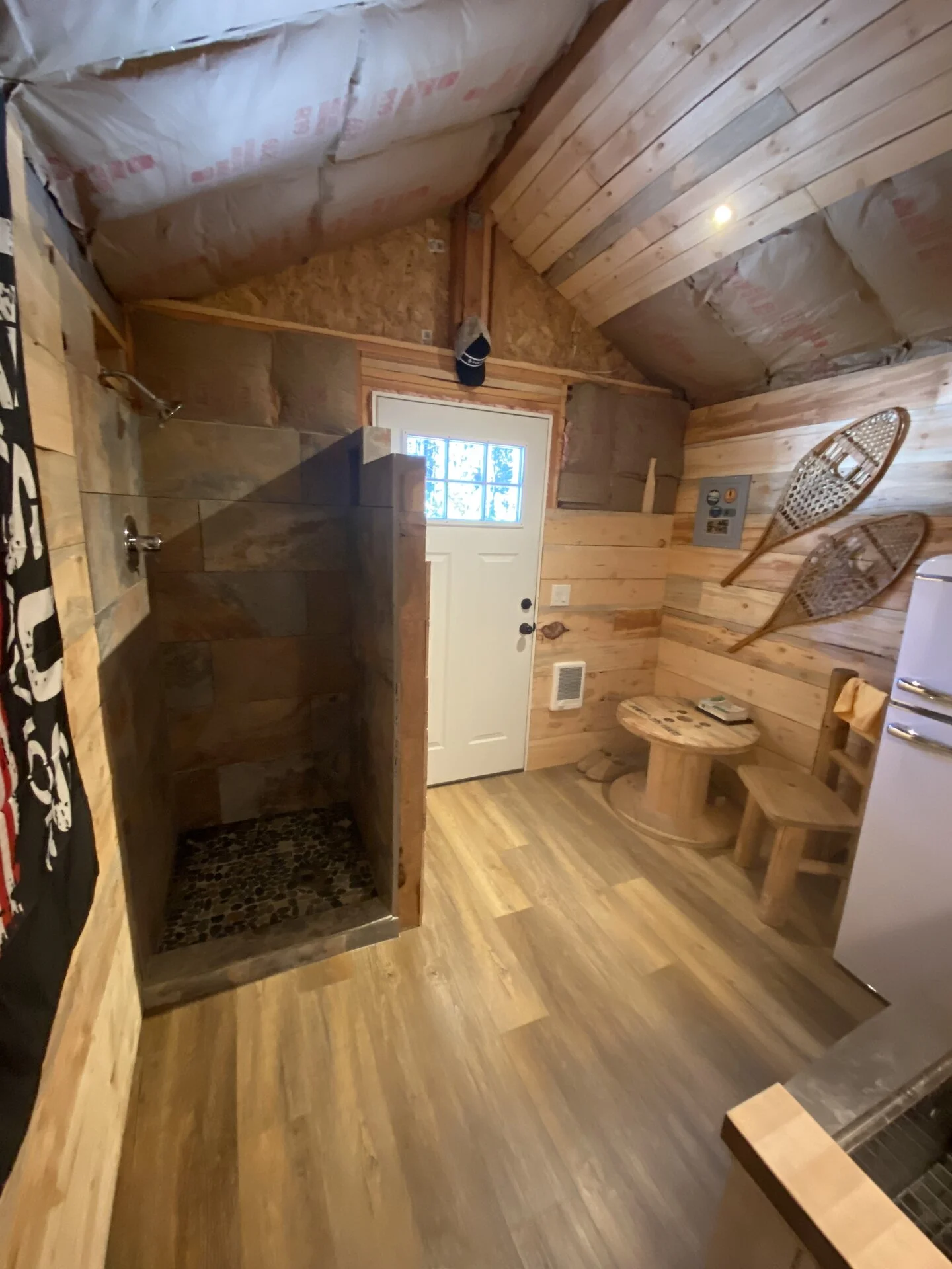

My shower
Travis working on his.

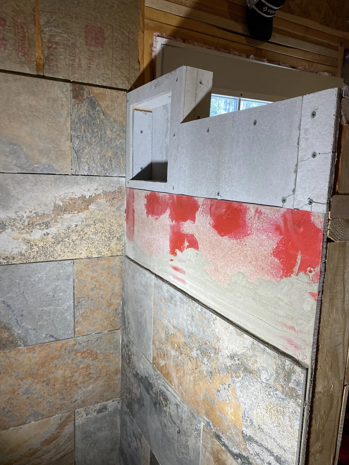

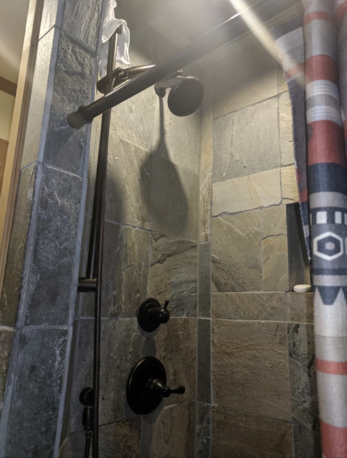

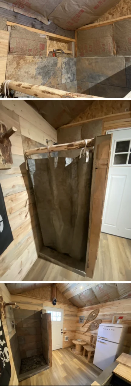

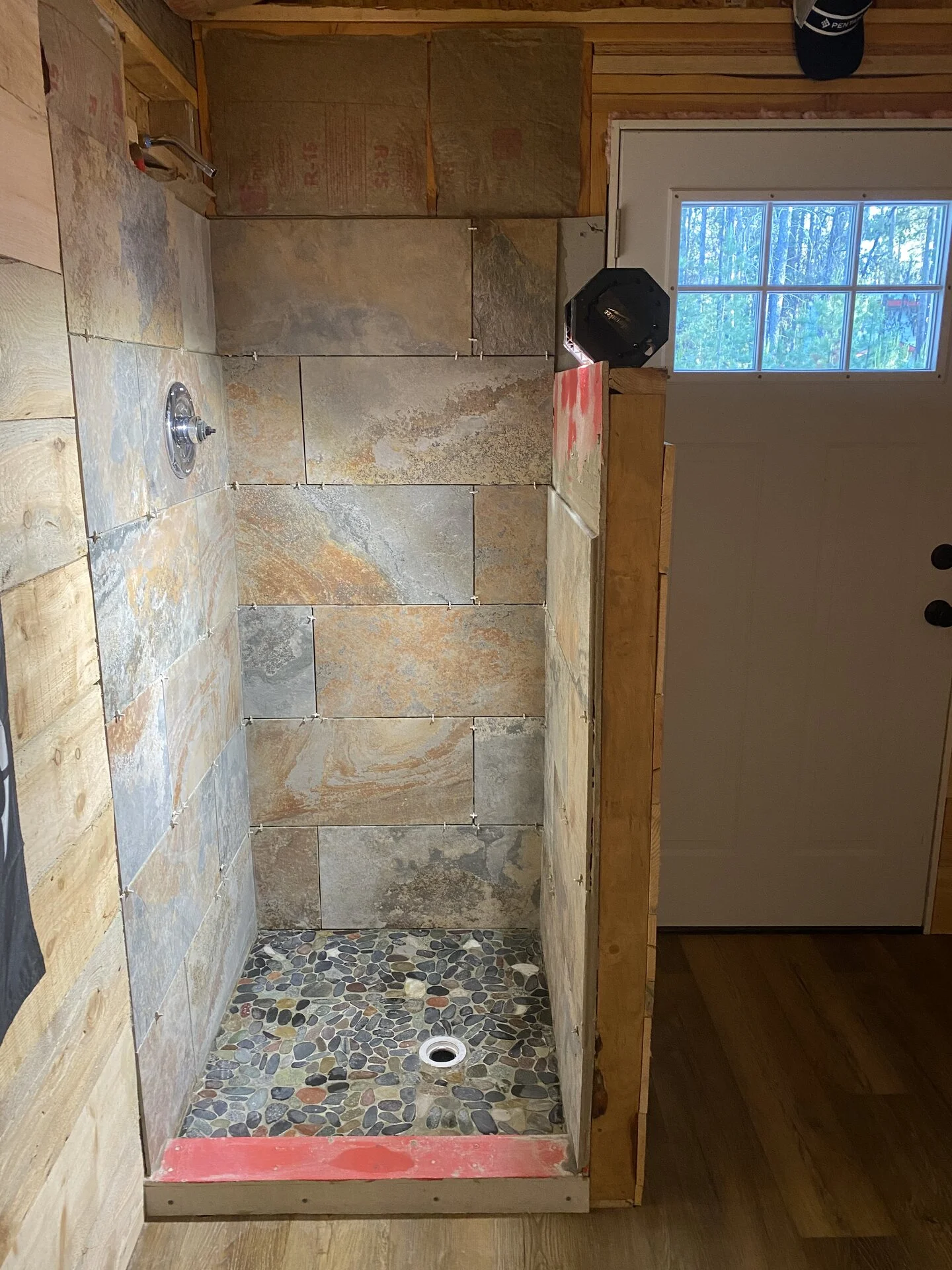

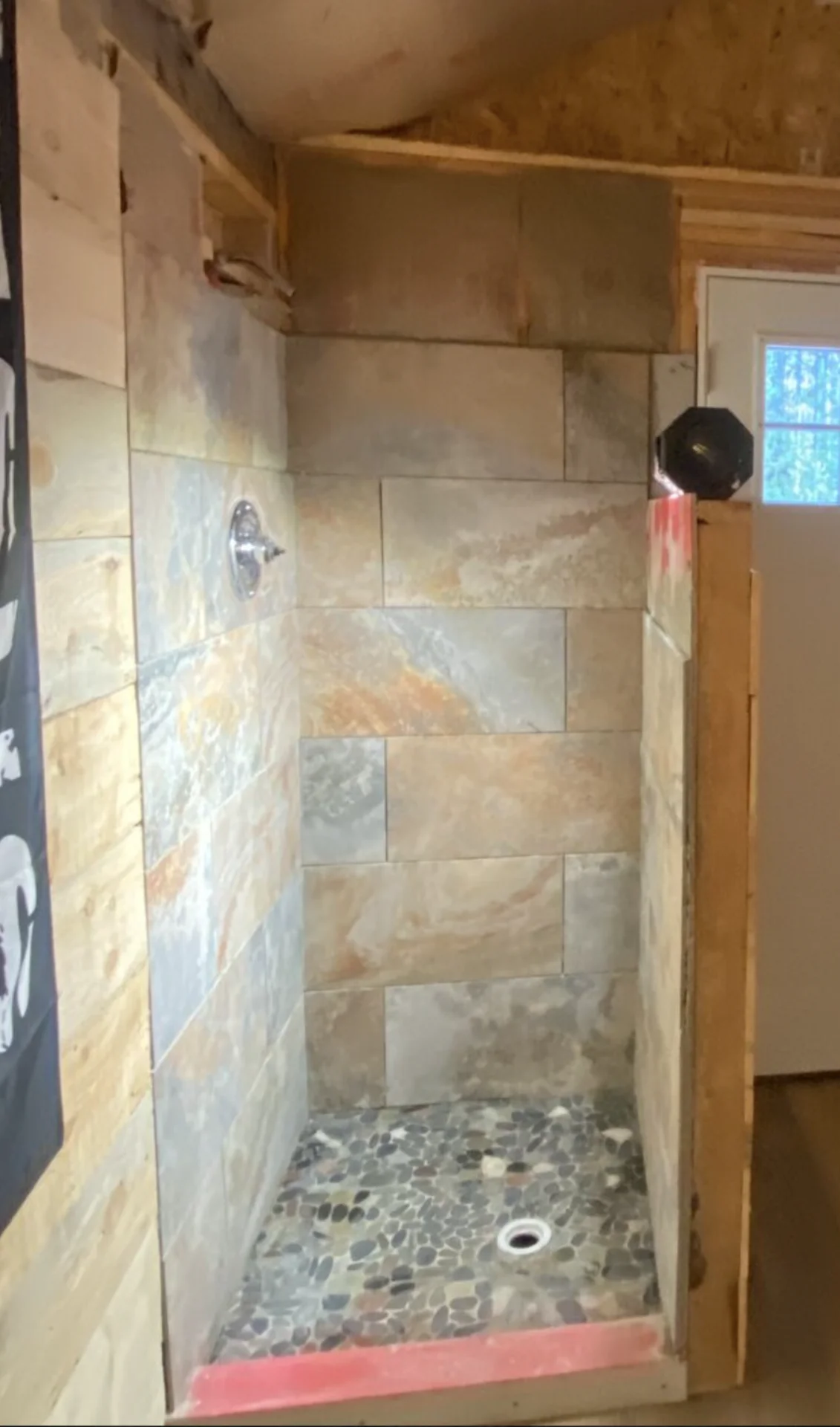

Got to work Thursday starting the wall tile.
Long day. First tile job I’ve ever done. So rewarding. Project Snowball❄️ and the Crater Lake vacation property have been such great projects.

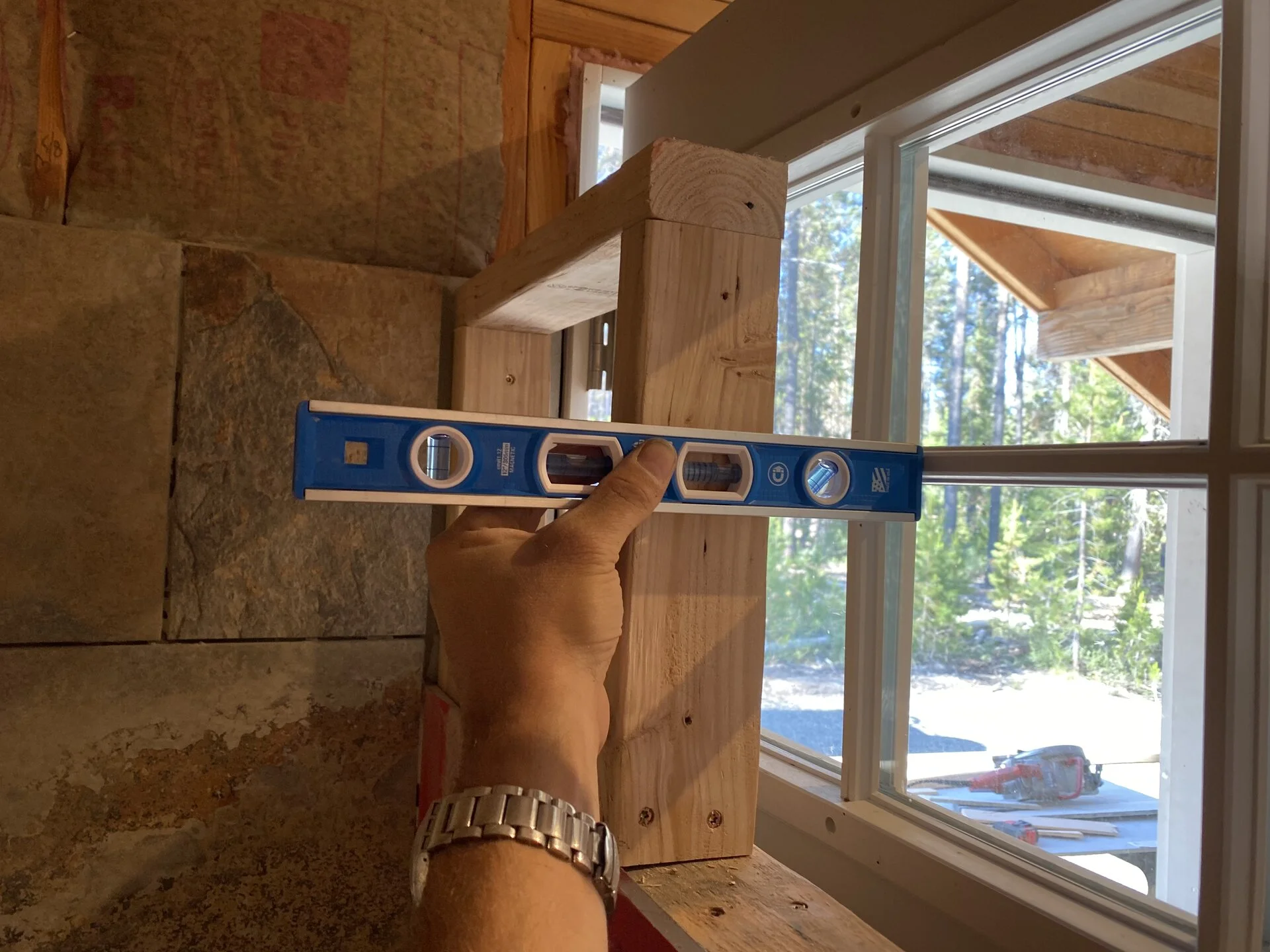

Friday morning worked hard to finish the shower as family and friends were coming later in the day to camp for Father’s Day weekend.
Decided to make a pocket to hold shampoo and soap. Used the window middle grid line as a level for the wall height on the shower wall. I liked having one upper row of windows to help let natural light into the shower.

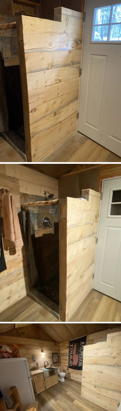

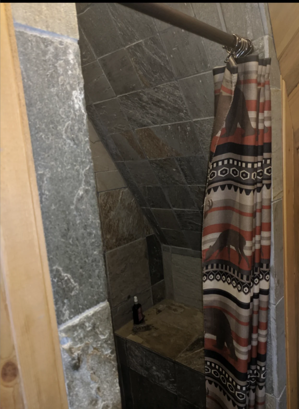

After everyone left it was go time to finish the shower. Made a towel and toilet paper holder. Then worked more on the pine paneling.
After finishing the shower and some pine paneling it was time for dinner.

One of my Fav Threads!!! I almost webt with that exact tile...so, close. LOVE the stone base I'm sure you kniw, but...don't forget to seal the slate.
