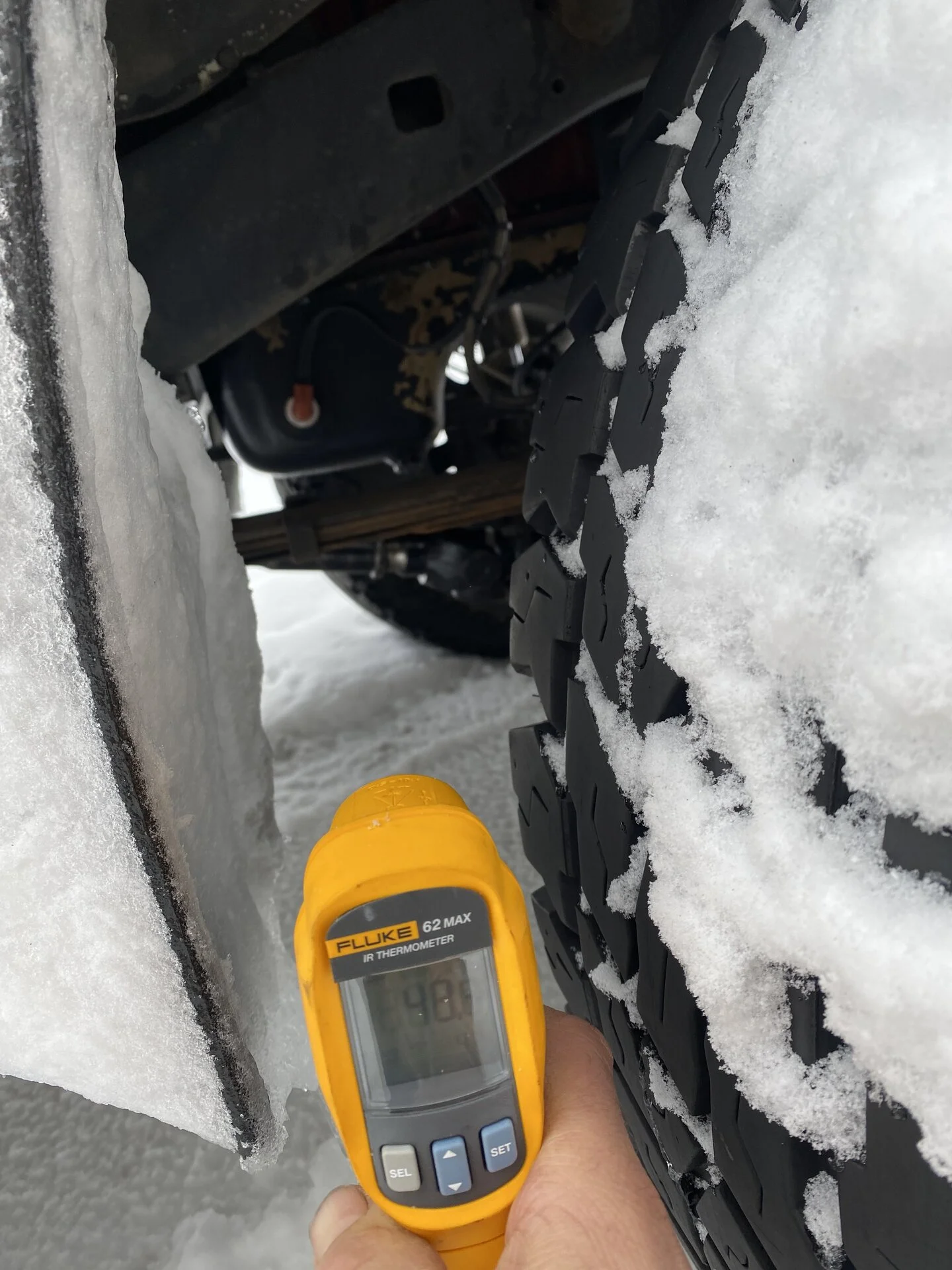

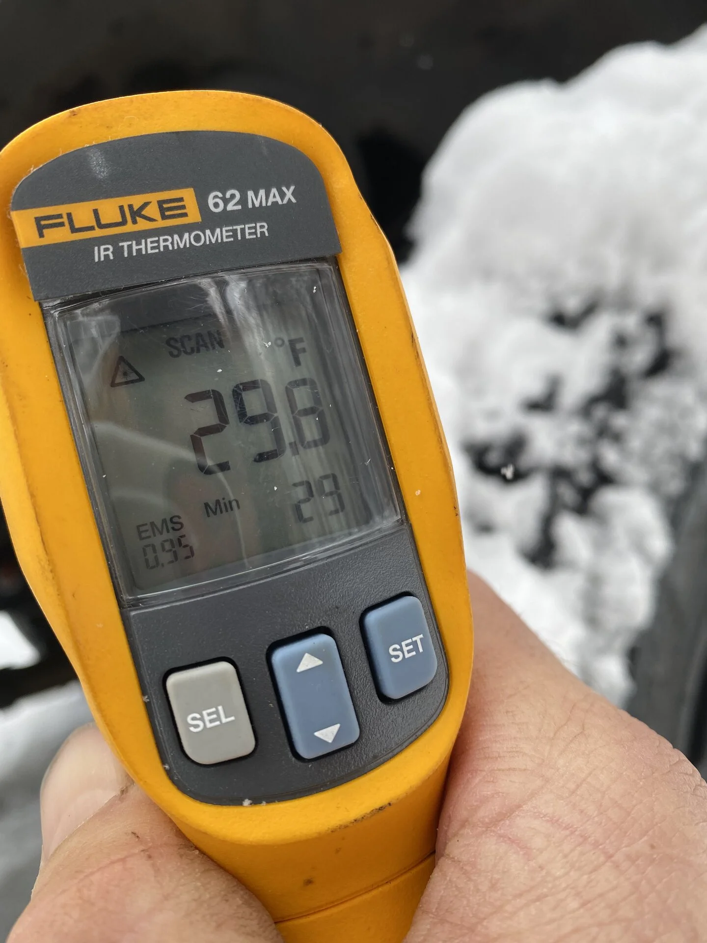

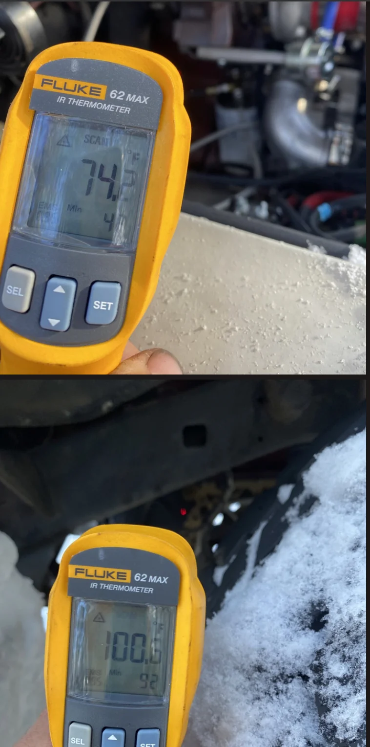

Also decided to plug in the block and oil heaters. I talked to a few locals down here that leave the block heater plugged in all the time in winter when they get home from work. Within about 10 minutes the oil pan went from 29F to 48F.

Without the grid heater in low 20s and colder it just took extra cranking cycles. I didn’t like that, for both the battery and starter. The grid heater made a big difference but then you have a cold block and thick oil. The block heater and oil pan heater made a real difference. Oil pressure used to be 80psi when it was really cold. Today it got up to 50psi on startup.

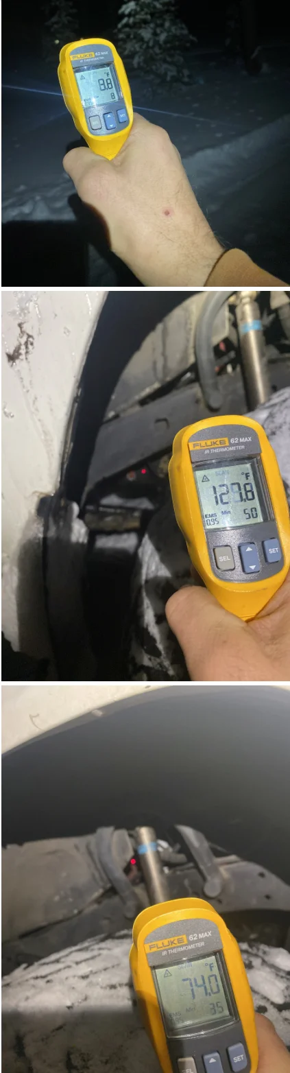

The block warmed from 29F to 74F in an hour and a half. The oil pan was up to 100F. Trip south down HWY 97 then east on Silver Lake Road.

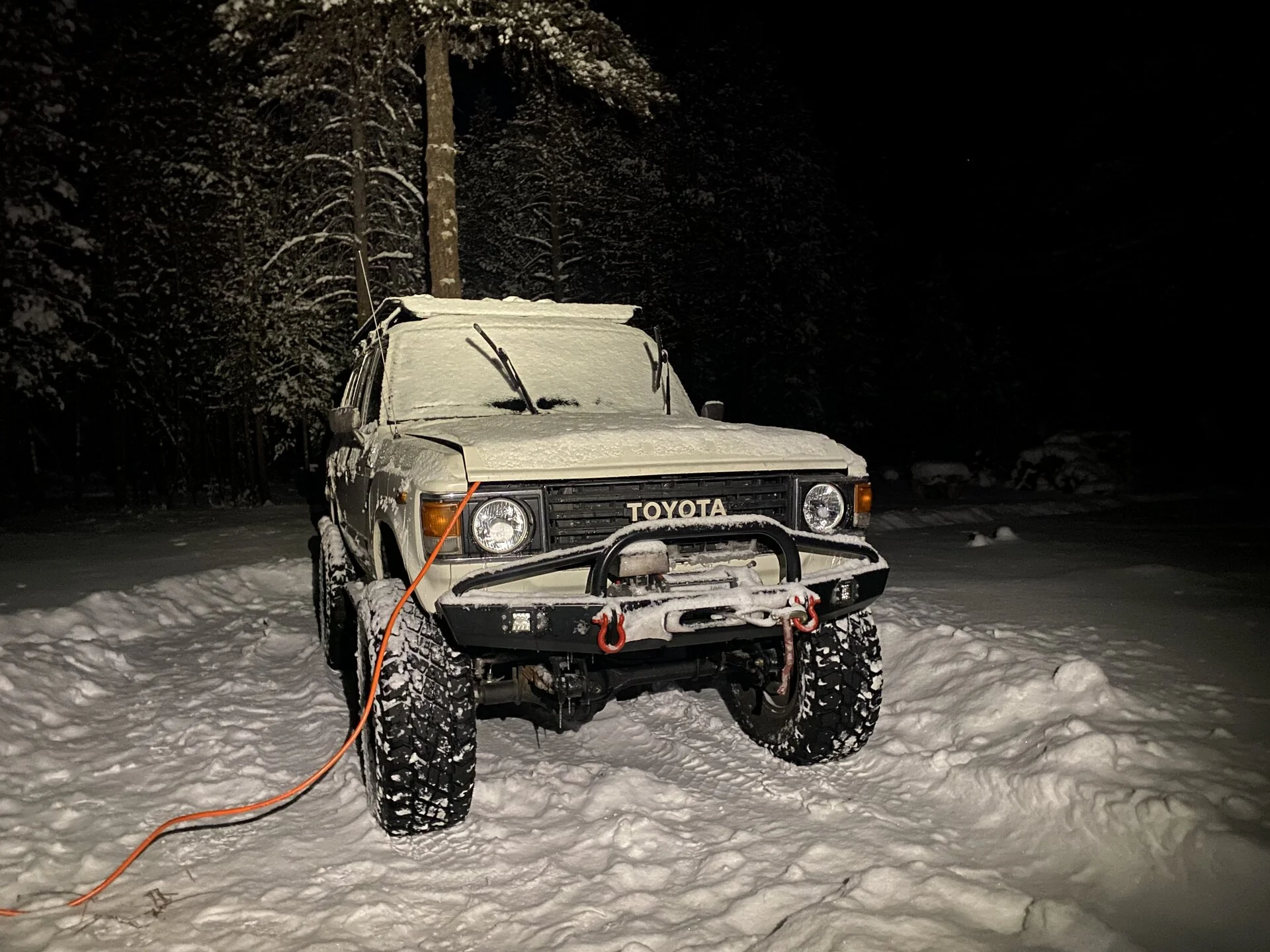

Got Project Snowball❄️ plugged in for the night as forecast low looks like -3F tonight. Already 8F but the oil pan and block heater are working great.
This mornings cold start.
When starting prior to both heaters there would be quite a bit of black smoke pillowing out even idling. What I really noticed especially with a white background is the lack of smoke. Also while warming up before the 60 would shake as it warmed up. It started as smoothly as it does when it’s mild. Took a drive around the community to check out more lots for sale. There’s actually the most I’ve ever seen right now. Unfortunately none are adjacent to Travis or my property.
