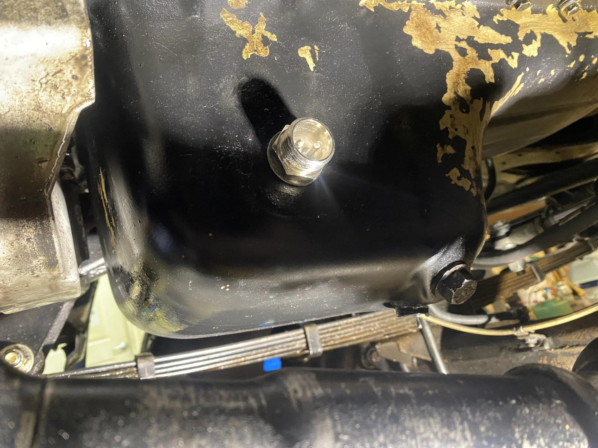

Changed the oil today. Just shy of 19,000 miles on the Speedhut gauges. While changing the oil I decided to remove the side oil pan plug and see what thread size it is.
Went to Napa and confirmed it’s a M22x1.5 which is awesome because that’s the size threaded oil pan heater I found.

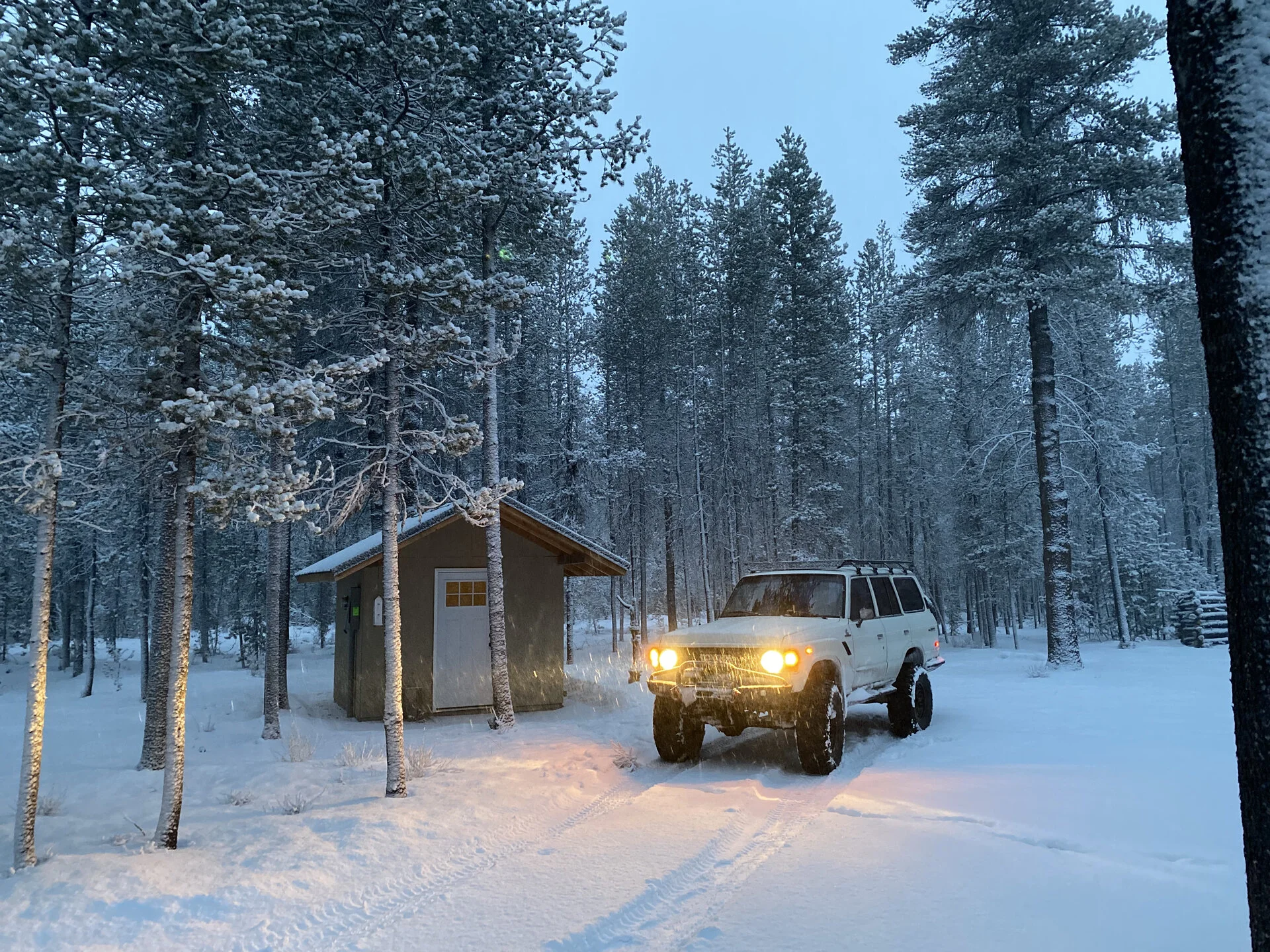

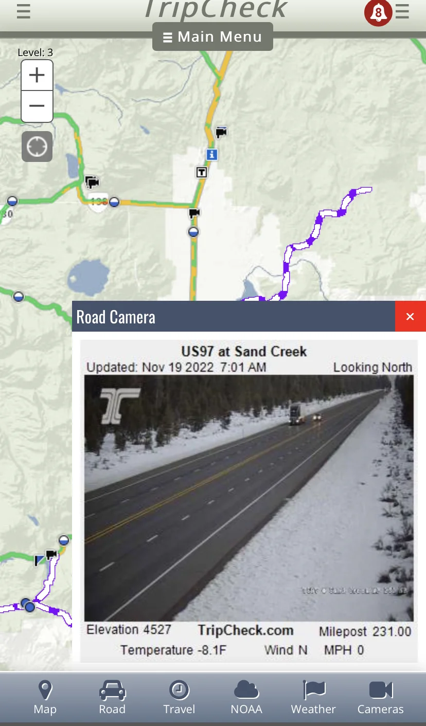

-8.1F this morning at the Crater Lake Property. This is why I want to be equipped for cold weather taking Project Snowball❄️ to the property. Now that I’ve got power I can keep the block warm with the new block heater and oil warm with the oil pan heater.

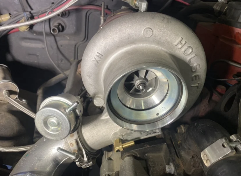

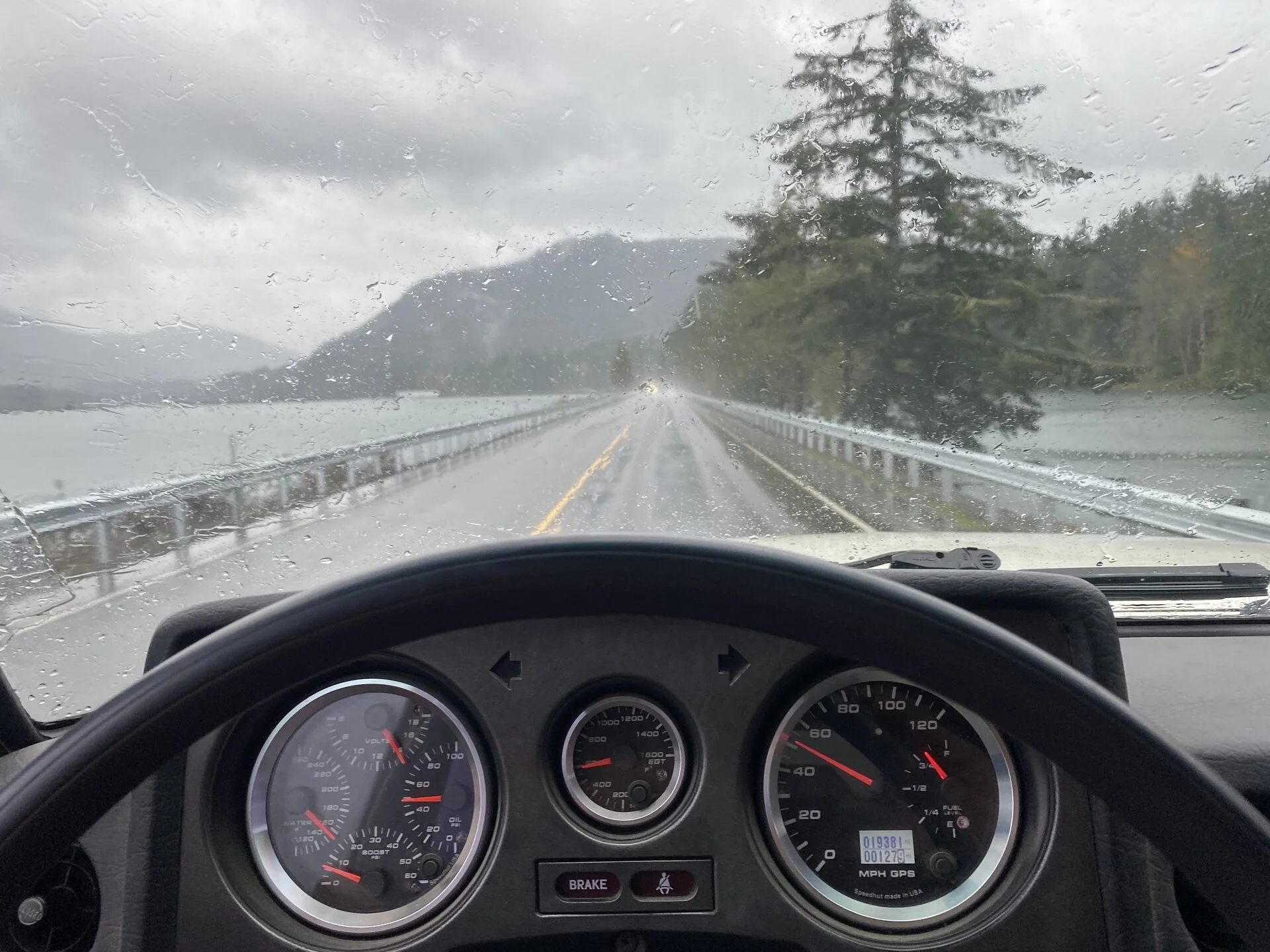

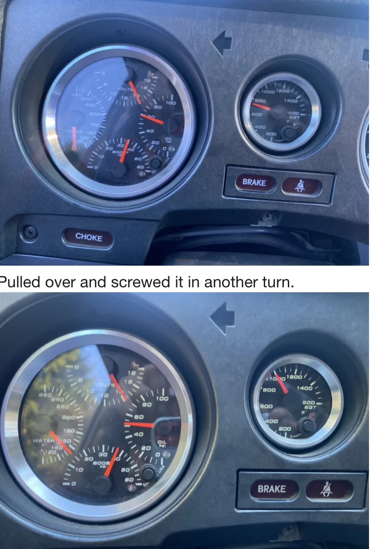

After changing the oil I decided to install the boost fooler on the HX-30 super and see just how much boost this puts out. I’ve been maxed out at 22psi. It spools super quick but at 22 psi the wastegate opens. Have been very happy with it but it’s time to turn it up.
Put a drop of blue locktite on the Allen screw as I didn’t want it to come out. I then took it for a drive home. Started with the screw about 1/2 way screwed in. Noticed an immediate difference. Up to 35psi.
38psi of boost. Not only does this turbo spool much quicker than the stock HX-30 but it produces some impressive boost! It climbs the grade home very nicely.
Took the kids into the Cascades for our Christmas tree run. East of Estacada on the Prometory grade heading up the Clackamas River pushing the hill my EGT would climb up to 1250F in 5th gear so I’d need to down shift to 4th to drop EGT. With the HX-30 super turbo I ran the hill at 70 mph in 5th at 2030 rpms and had just under 30 psi of boost. What a difference.
Some fresh snow overnight and feet of snow on the way this week in the PNW.
Got home and the oil pan heater showed up.

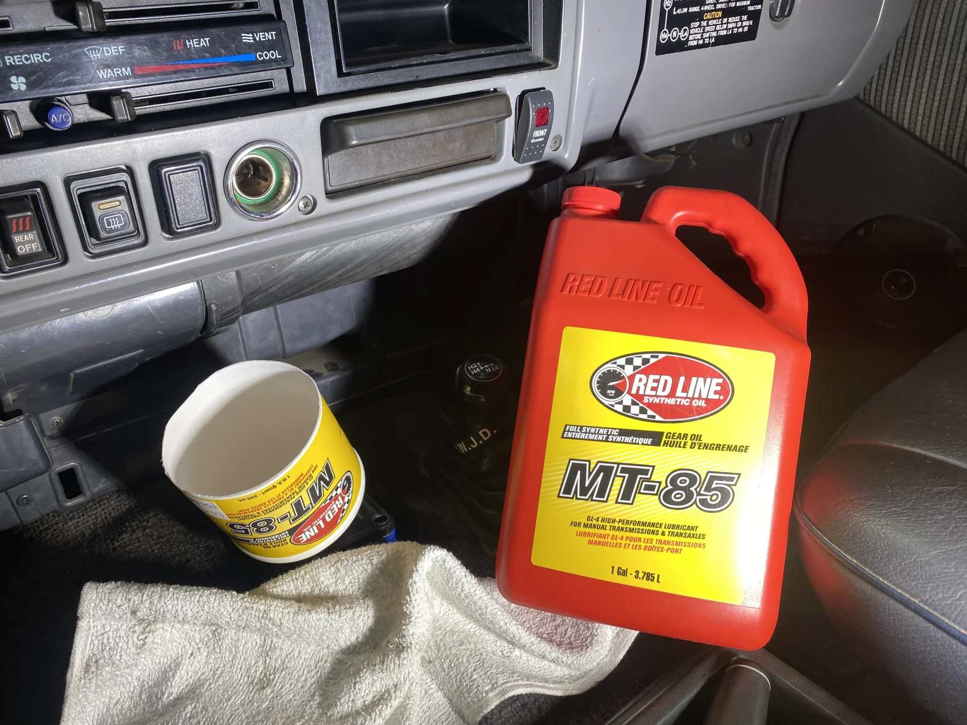

Just over 19,000 miles. My short throw shifter tower was leaking a bit. Ended up that 3 of the 4 bolts weren’t tight enough. I decided since I bought the Redline MT-85 it was time to replace the transmission fluid. Refilled with 5 quarts.

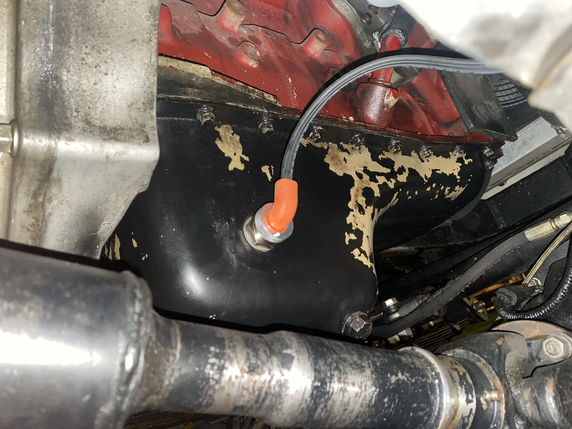

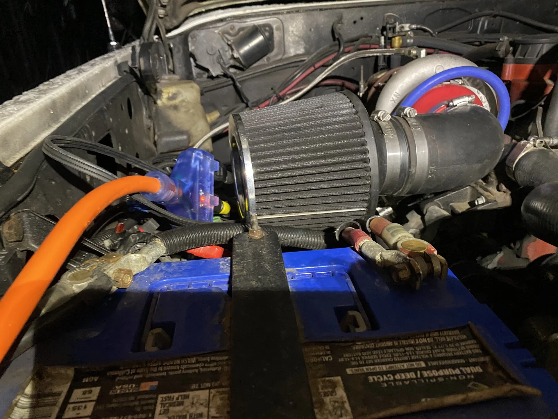

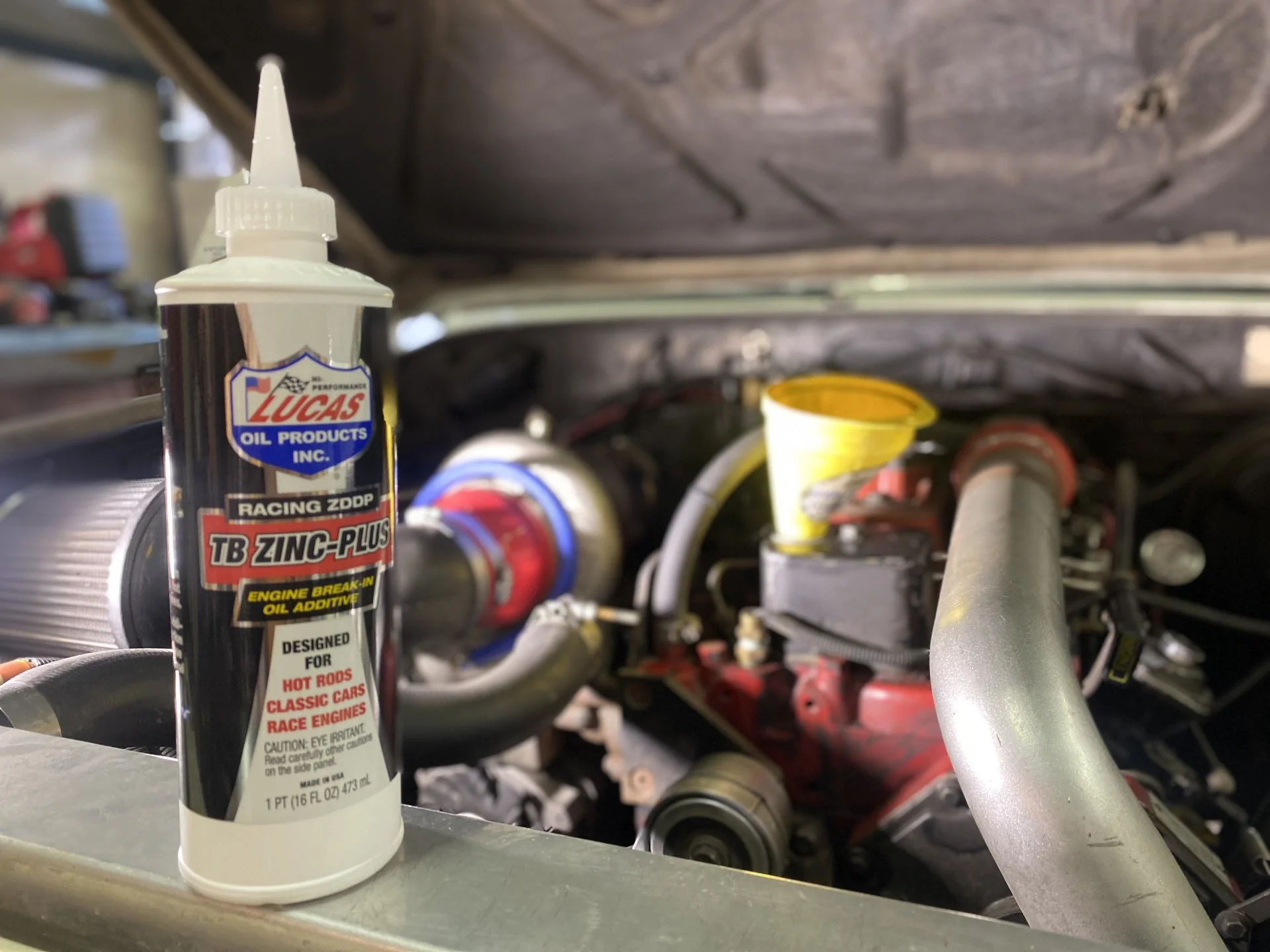

Then I drained the oil and removed the side plug and installed the oil pan heater. Added some zinc additive when I refilled the oil.
Connected the power cord and routed up into the engine bay.
When people see a couple power cords plugged into your cruiser you'll just have to tell them it's a hybrid.

Doing research, if you could do only one then install the coolant block heater. Thankfully the oil pan already had the 22Mx1.5 threads in the side of pan which made it a no brainer. Both of these cold start devices were very affordable. I liked the idea of having warm oil to quickly lubricate the engine.

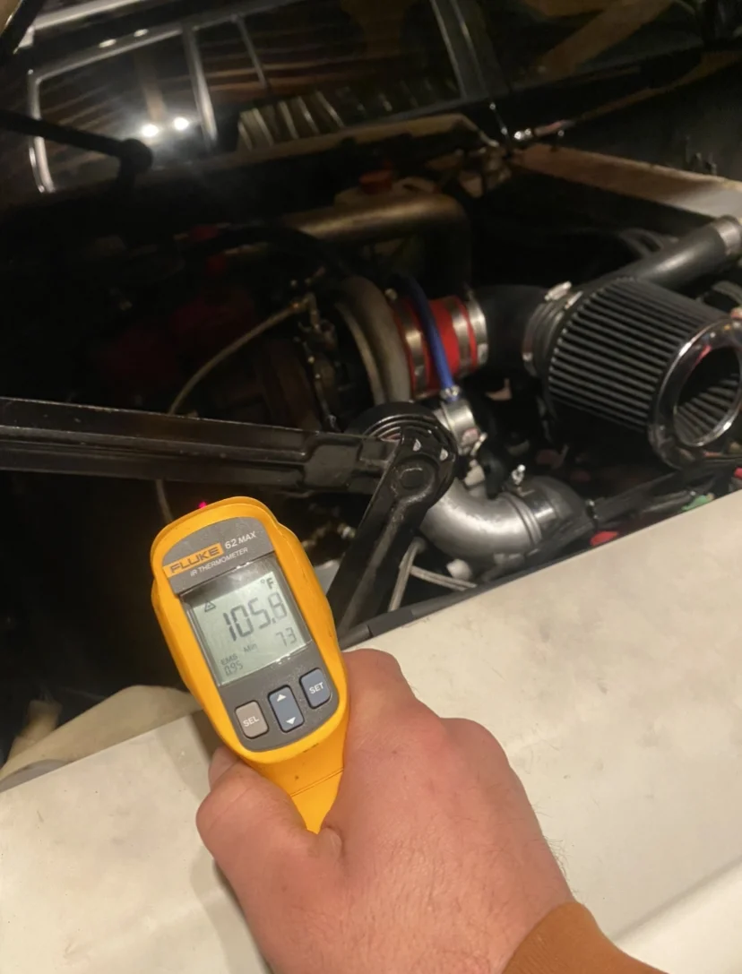

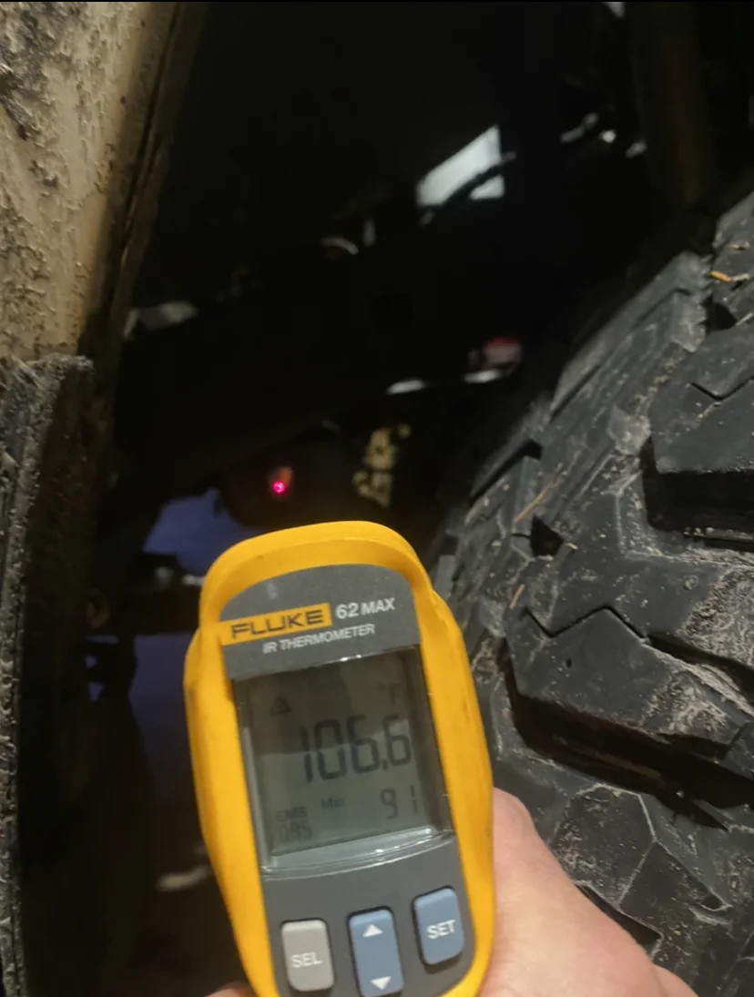

This morning I plugged in both the block and oil pan heaters to test them. Outside air temp low 30s. This is temp at the heating element after an hour.
I felt around the block and it was warm to the touch.
Same with the oil pan.

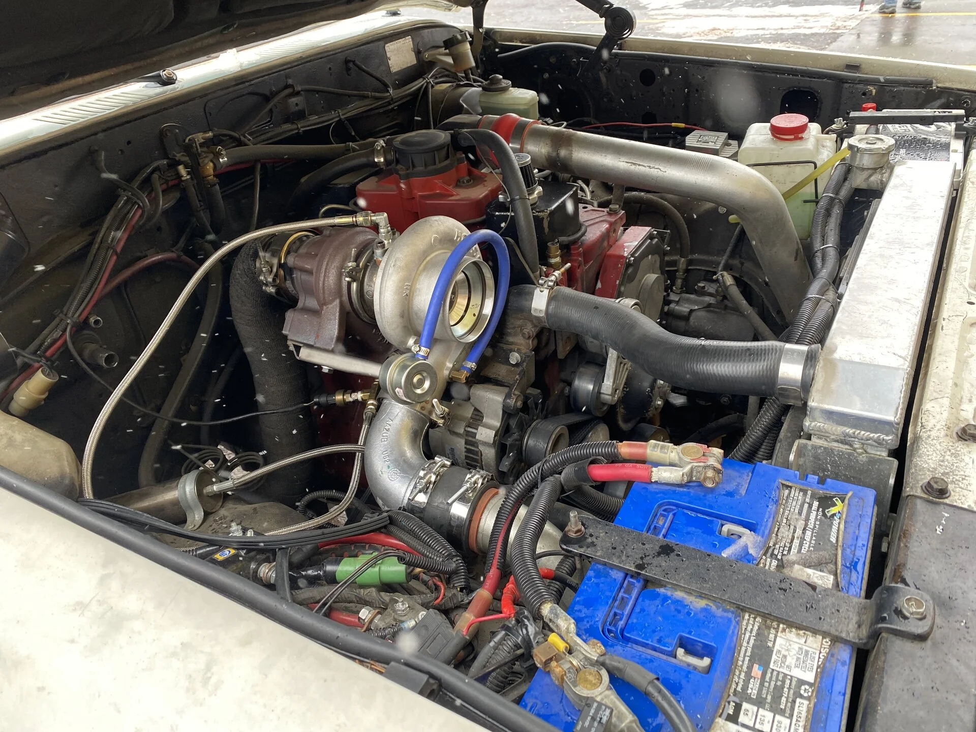

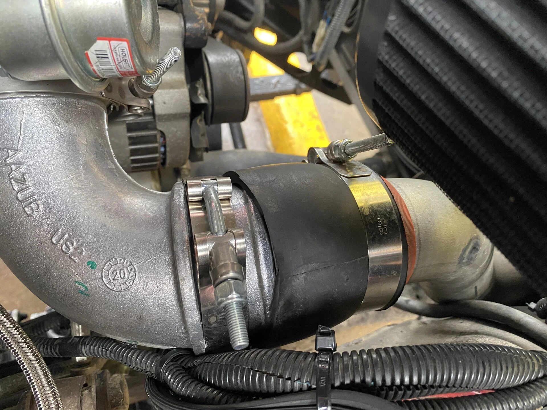

While climbing the grade I passed a vehicle and heard a pop and heard massive surge.
Pulled over to see I blew the boot. Being so busy I forgot to order the reducer boot from Frozen Boost. Was able to get it back together in the blowing snow.

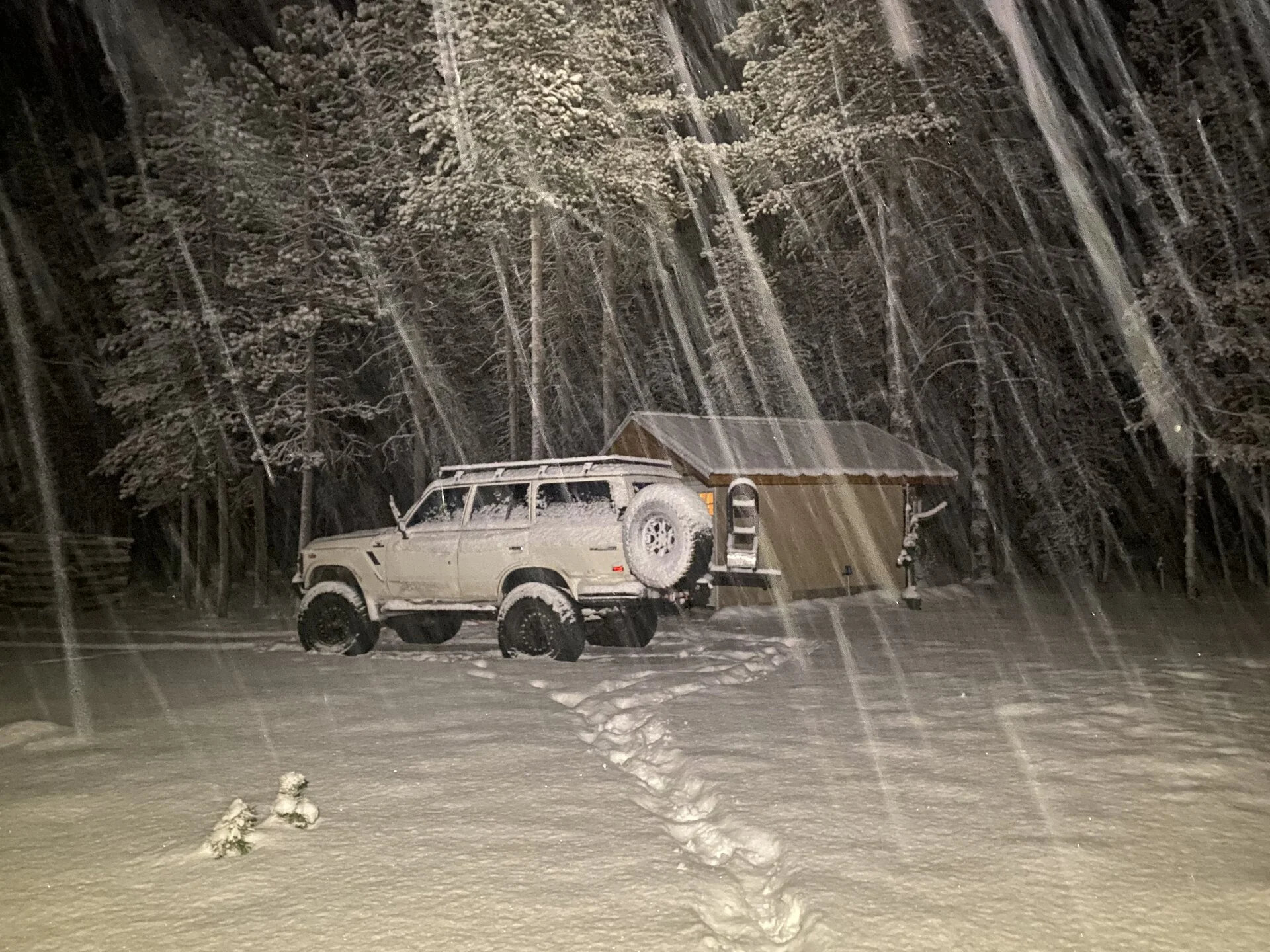

Made it to the property just as the snow was setting in.

looks like you’re getting things set up to deal with cold starts nicely. if you find that you need more cold start help a webasto or espar are really nice (albeit expensive). i have a webasto and use it a lot when its -20C and colder here. it’s also really nice when there’s no power to plug into!
i’ve also had some hose pops over the last year. the frozen boost reducers are really nice

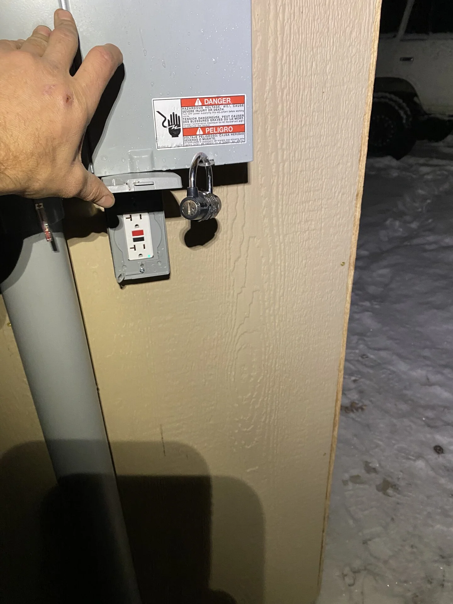

Picked up a 20 amp GFI outlet and weather proof box on the way here. Installed the outlet and ran the power cord to the 60 for the block and oil pan heater.
Looks like you're having a fun winter! I've had my charge pipe blow off at the turbo while pulling a big hill with a trailer, and got the tip from my buddy who has a 4bt in his old Jeep to spray hair spray and then slip the boots on. The wet hair spray will let the boots slip on easy, then help keep them from slipping off when it dries sticky.
I haven't had an issue since, and have put about 7500 miles on the truck since getting it running.
The best holding is a good clamp and a good boot with the tubes having raised ends for boot holding. The boot Hojack used was a temporary rubber deal to get him home from my shop when we installed his new turbo. The silicon boot he plans to get should solve this issue. Due to compress air being hot air (especially climbing grades with higher boost) any spray's are likely to heat up and melt (even paint, personally found that one out) and could act as a lubricant to slip the boot off. Clean, even lightly scuffed tube ends would be best.
