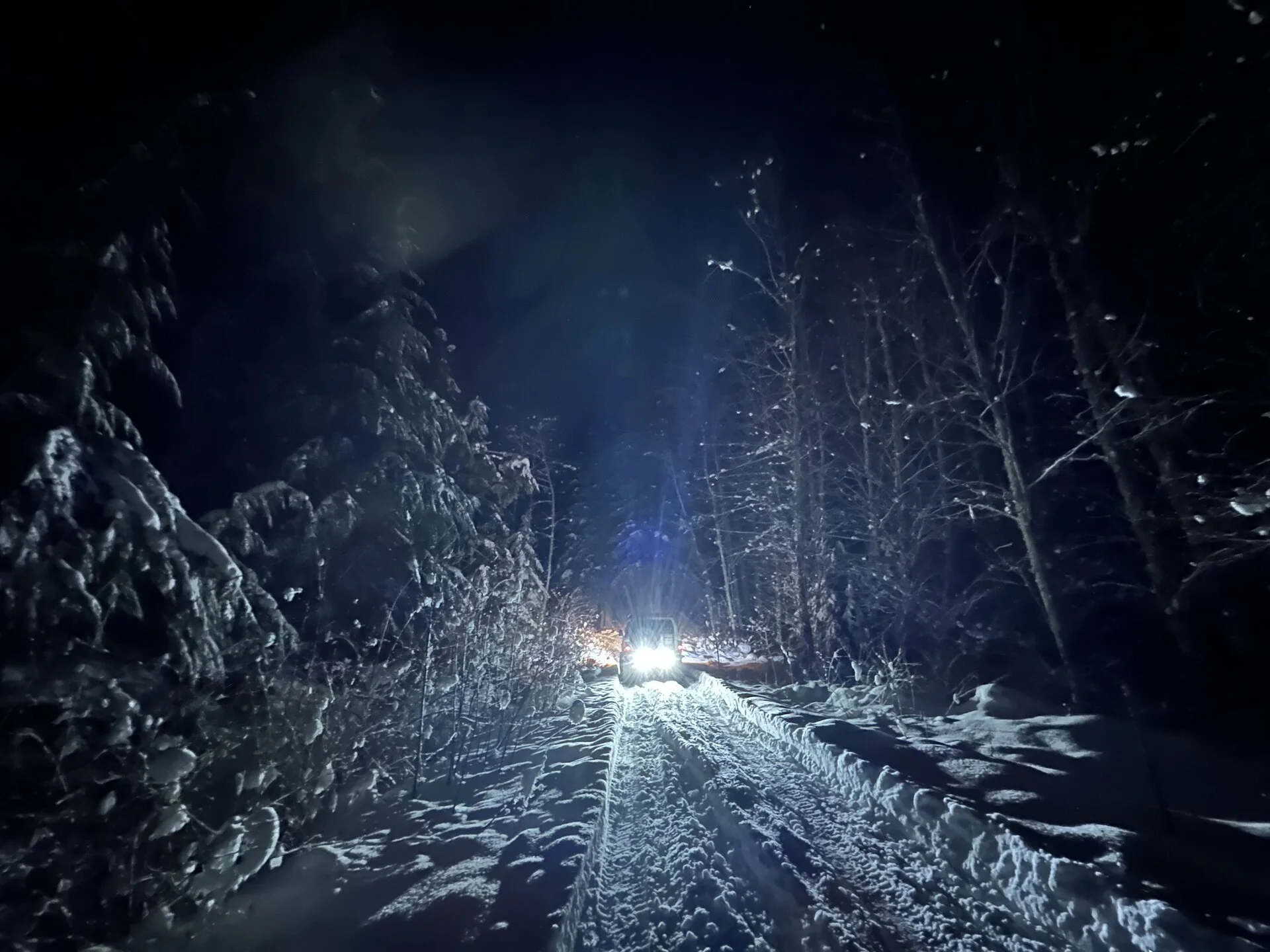

The Cascades got some fresh snow yesterday so decided to head up to the High Cascades in Oregon to get a Christmas Tree.
Went to a hidden snowmobile cabin that’s actually free to stay in.
It doesn’t get much better than this!

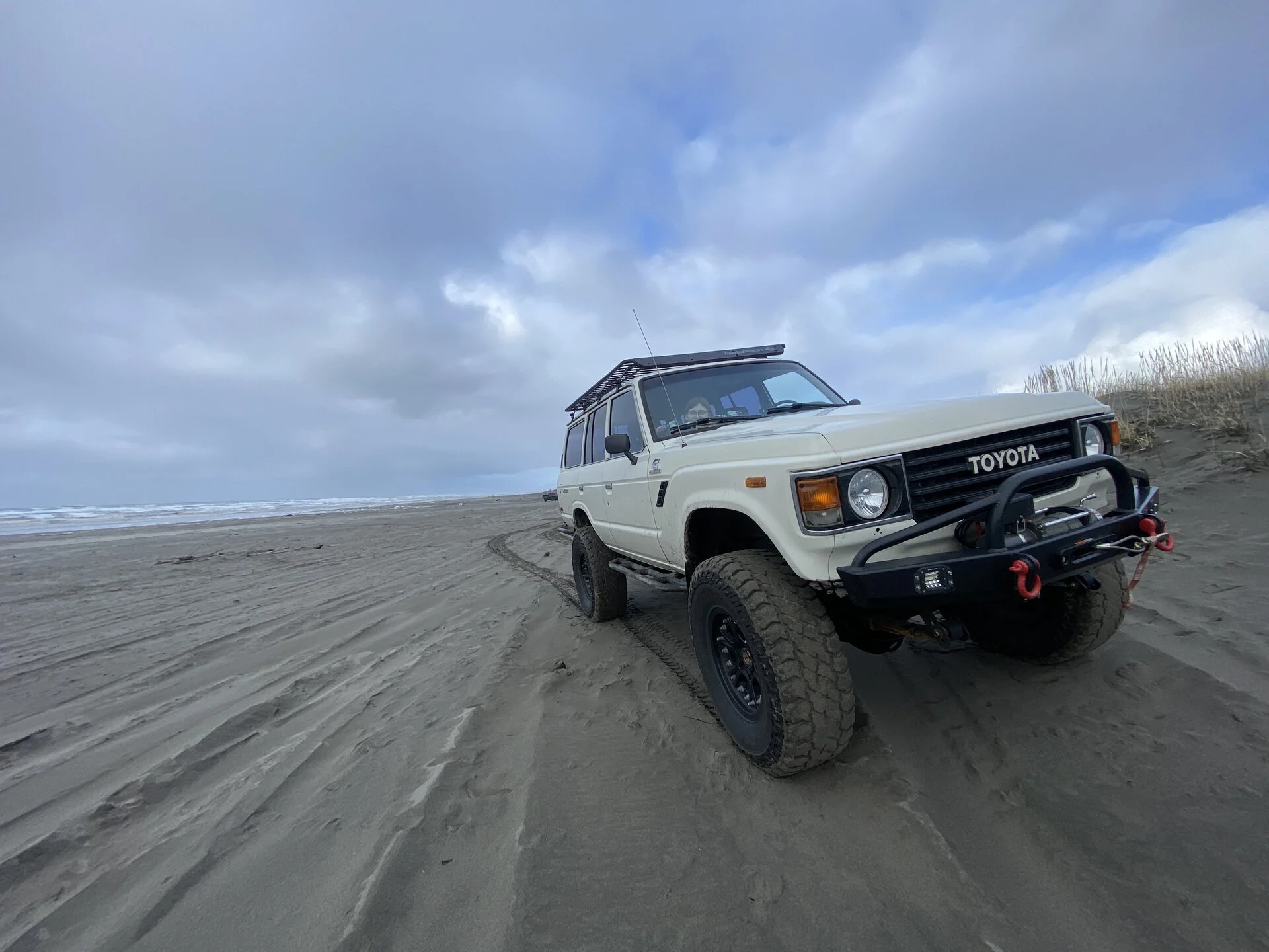

I can’t remember the last time I’d clean or washed the 60. My wife wanted to take it down to the beach and dig razor clams while staying at our friends house in Ocean Park, Washington.
Left this afternoon on the 160 mile drive from Oregon across the Columbia to Washington, back across the Columbia to Oregon and then back across the Columbia on the 4 mile long Astoria bridge to Washington and up the Long Beach peninsula. Up to Ocean Park to the beach house.
Project Snowball❄️ tucked in for the night.

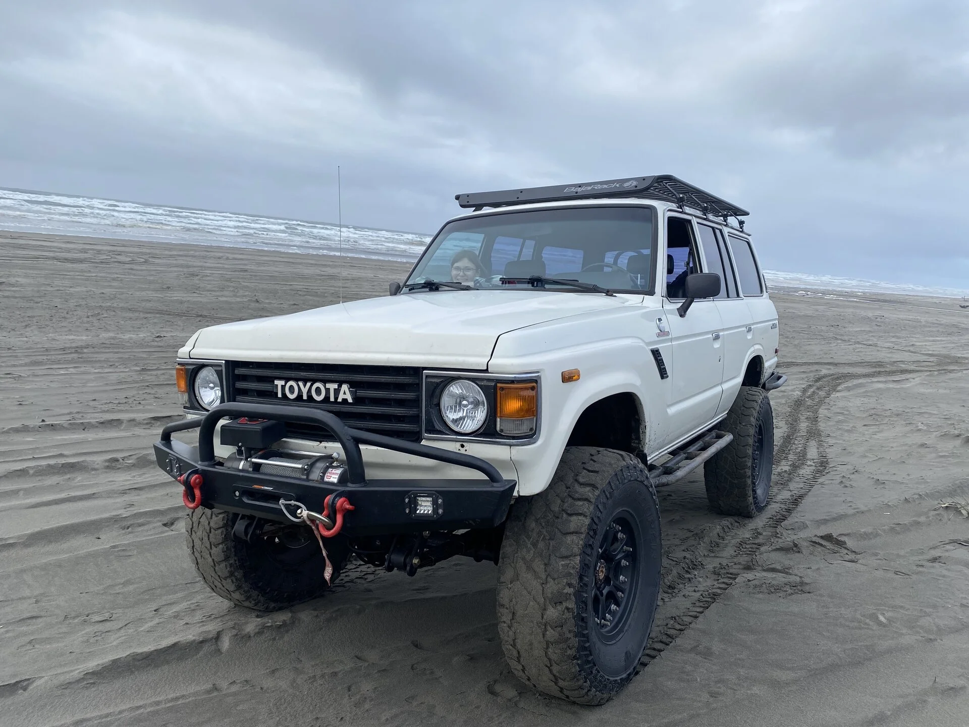

Low tide was at 8:20pm and was only -0.8’, but low enough to dig razor clams. The lower the easier to dig them. With the waves in the dark it’s harder to get them and then dodging the bigger waves. Really a lot of fun. We got 22 of em’.

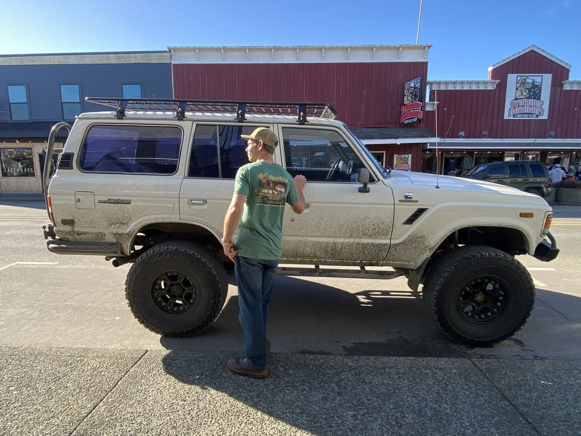

Now this is a vacation… was going to Long Beach to play pickle ball when I spot an SOA 60 parked in town. Drop off the fam to hurry and meet up with the owner. The dude was stoked to go play on the beach.
What an amazing February day at the PNW coast!
Long Beach, Washington

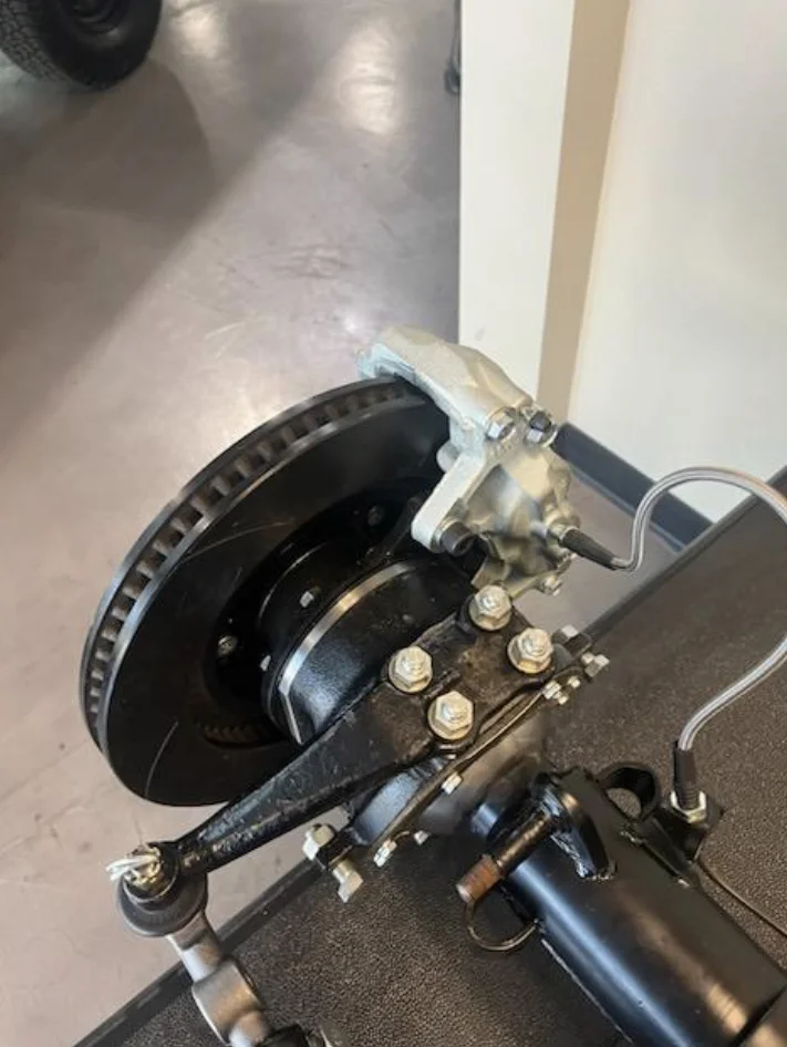

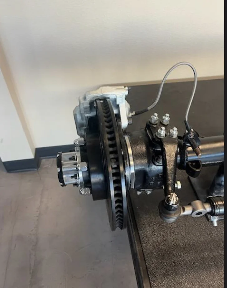

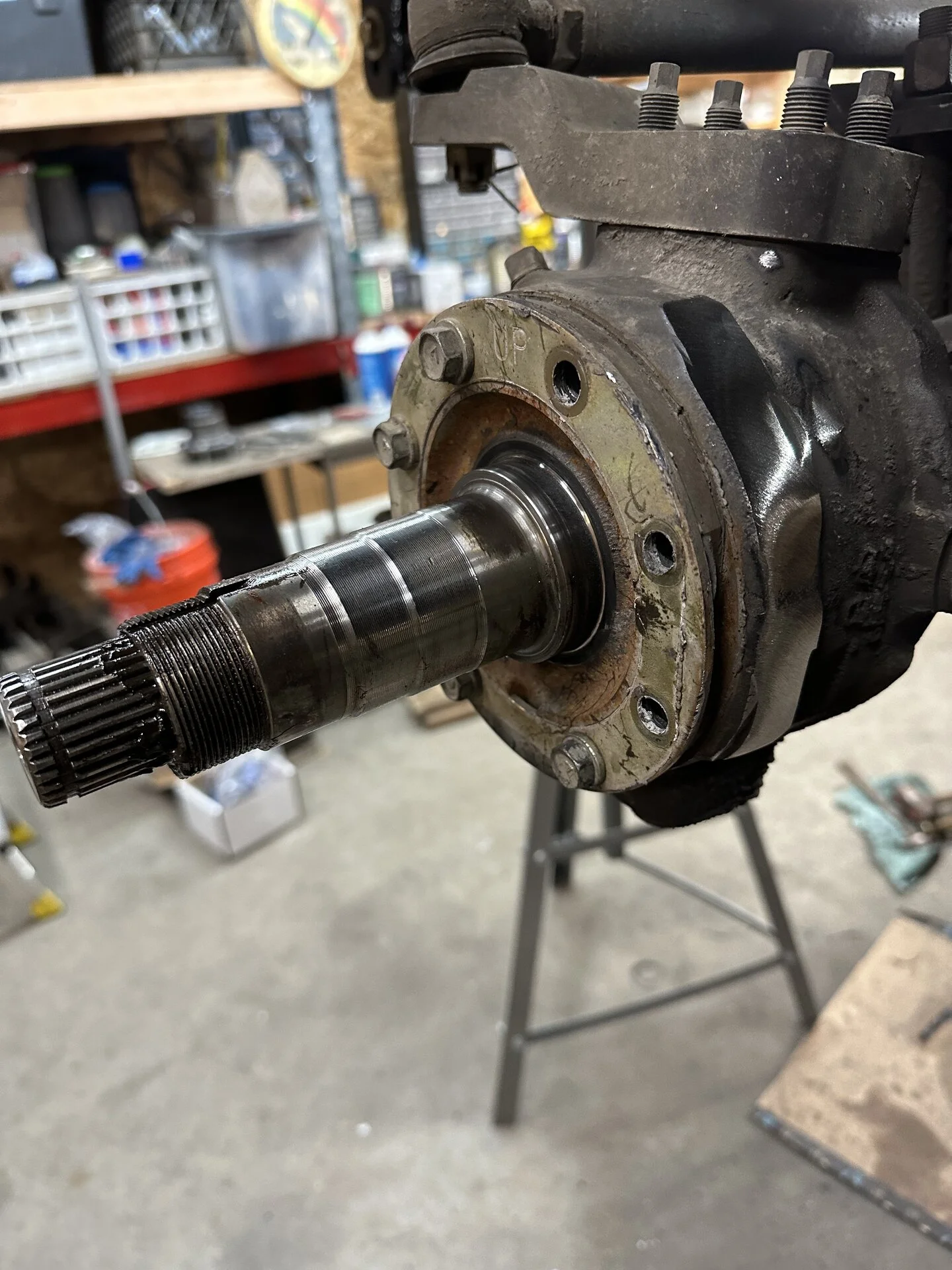

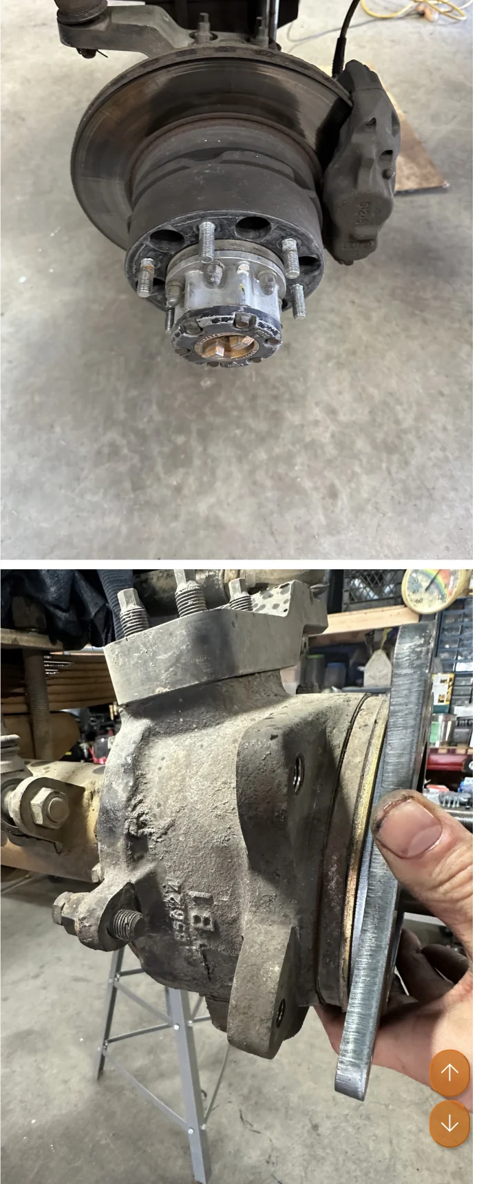

Saturday I went to @boots4 shop and installed Manafrelv Big Brake Kit.
manafrelv.com
Front Big Brake Conversion Kit for 1975-1990 Toyota Land Cruisers - Landcruiser Parts
Front Big Brake Conversion Kit for 1975-1990 Toyota Land Cruisers. Upgrades your Calipers to the largest Calipers Toyota offers.
manafrelv.com
manafrelv.com
The awesome part is the kit widens the front axle width by 2” on each side so the 2” wheel spacers aren’t needed. I already have the 80s series rear axle with disc brakes and an 80s series master cylinder.
The steel plate that holds the calipers had a tack welded plate, no instructions why it was there or how it went on. When I rebuilt the knuckles got rid of the dust shield so already had that plate on spindle.
Used grinder and removed the kits plate and also needed to remove the caliper mounts on the 60s knuckle as they interfered with the placement of the calipers.
The hub factory has 2 steel dowels, the new one has 6. 4 holes need to be drilled. Mike did a great job with the drill press.
The kit rotors are slotted and heavy duty and marked for L and right.
The kits calipers are about twice the size of the stock calipers.
