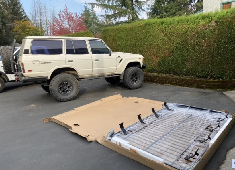

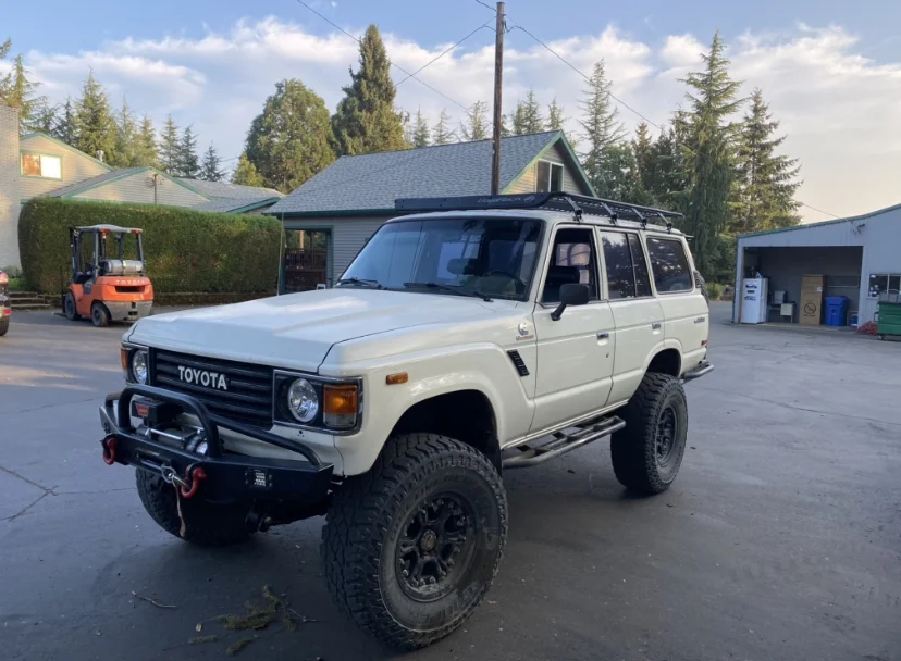

Got done with work and got the Baja rack installed.

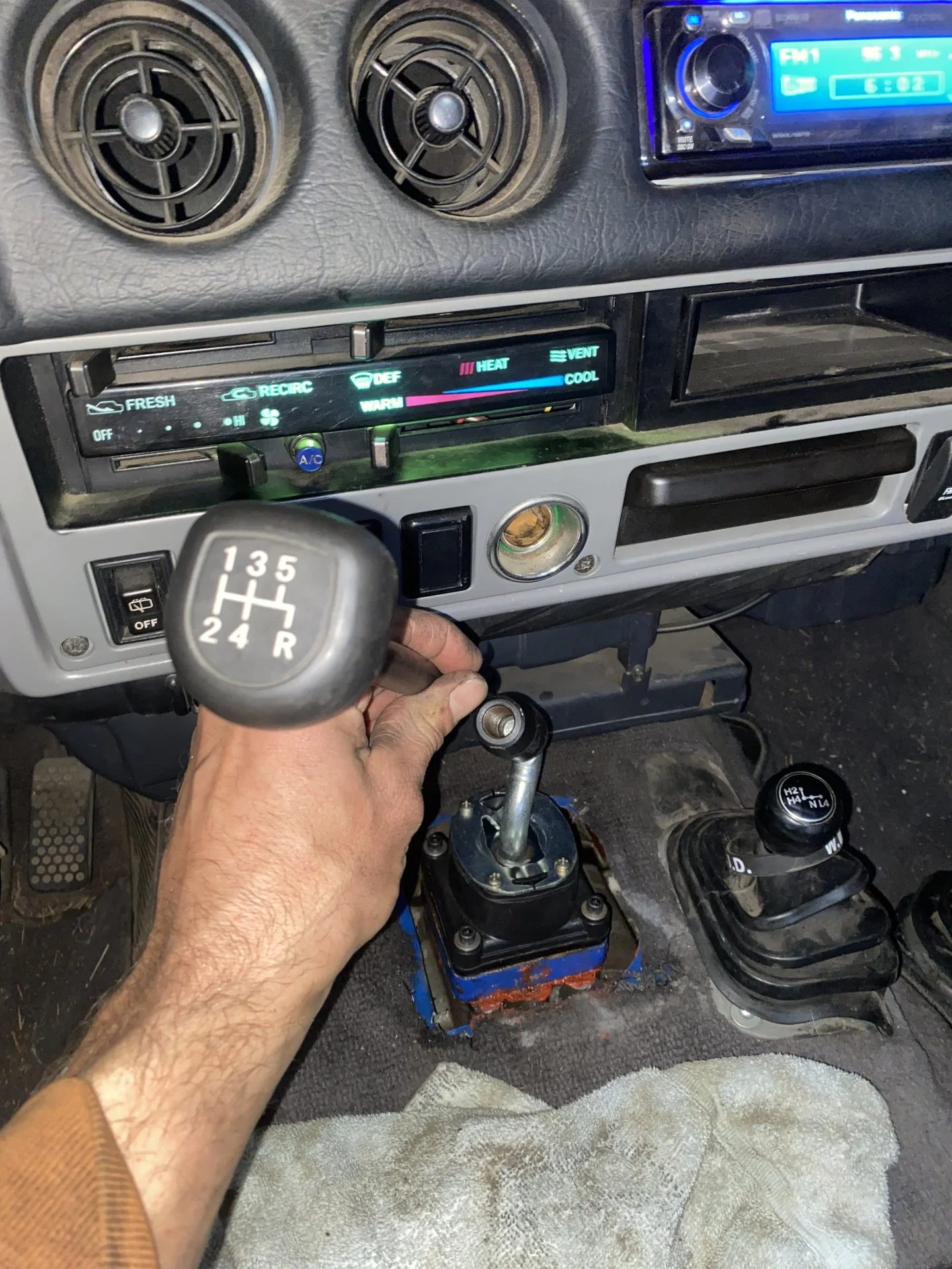

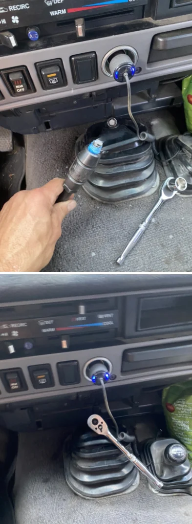

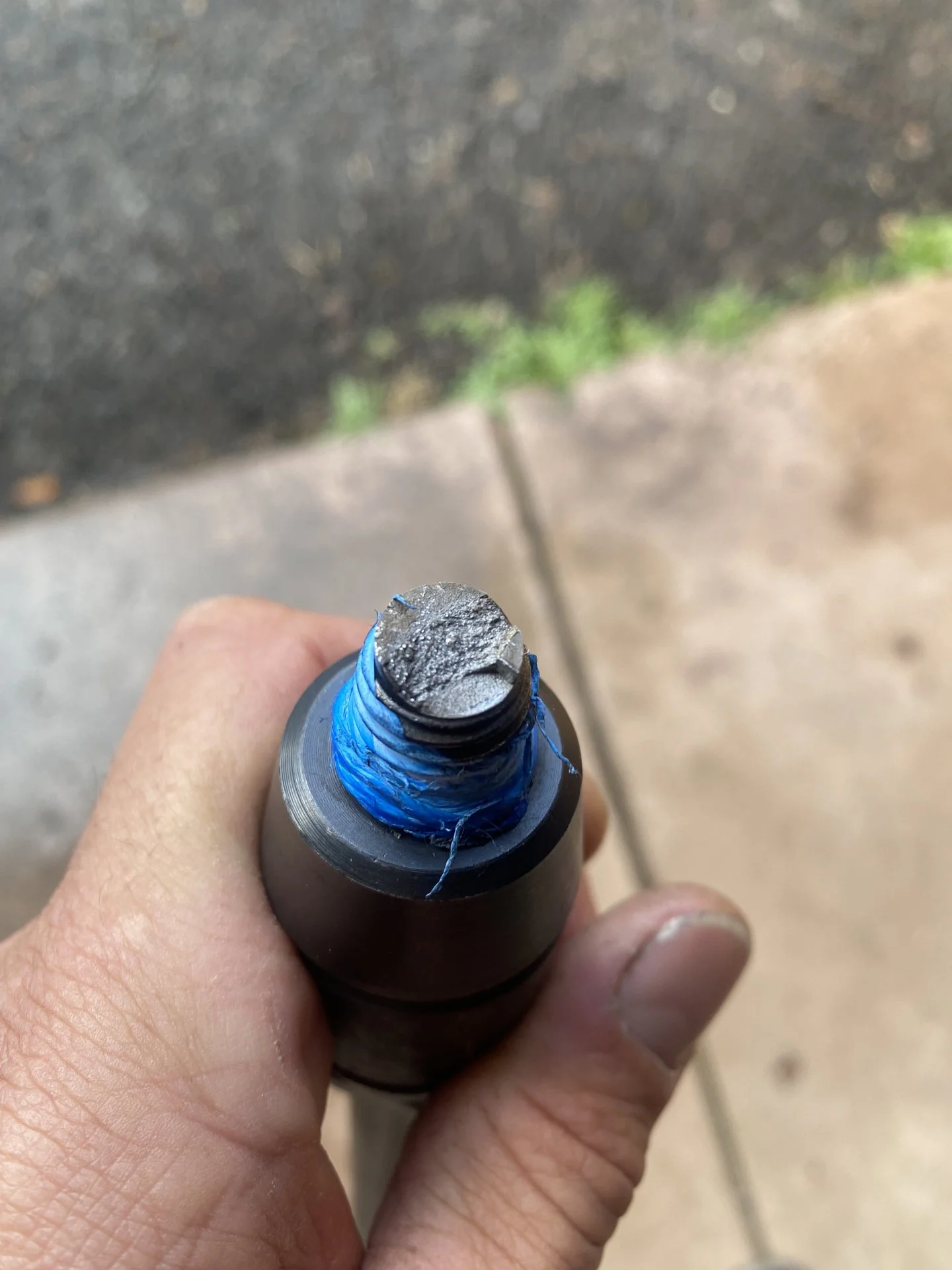

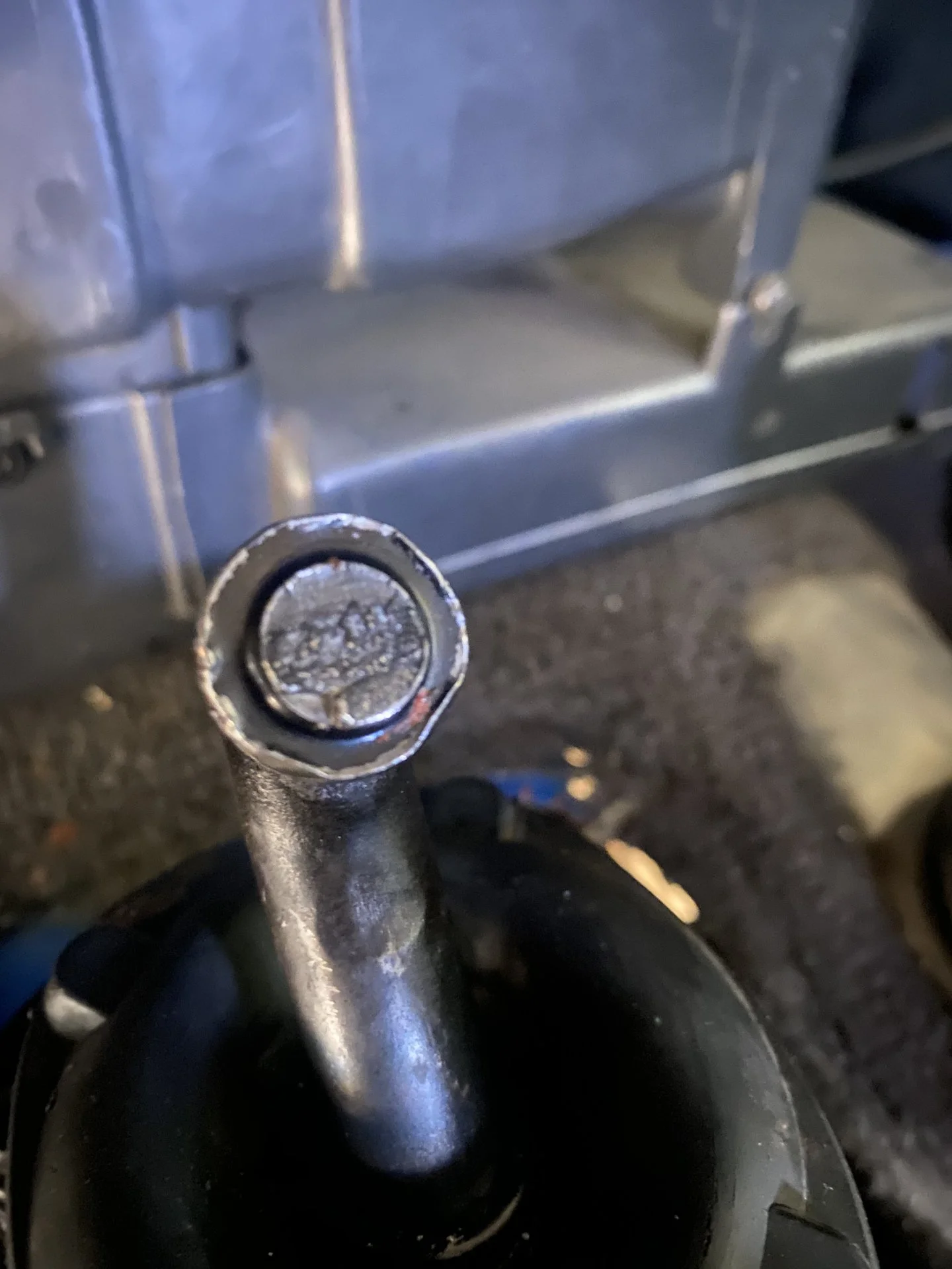

The stick shifter broke off right on the threads of the short throw shifter…😵
There was no way of shifting gear by hand. It was getting toward 5 o’clock. All day on the road I’d only seen one other vehicle. It was about 8 miles to Bennett Pass where it meets HWY 35 at Mt. Hood Meadows ski area. I brought a chainsaw and some hand tools… Looking inside my tool kit and only tool worth trying was a socket on a socket wrench. Blown away I was able to get the 60 in reverse and then into first and make my way to HWY 35.
Made it to Bennett Pass as snow was accumulating on the HWY. Was able to get the transmission in 3rd gear which was not easy… I’m was still 50 miles to home. One nice thing about the snow on HWY 35 was the snow on the road made other vehicles drive slow. It wasn’t until HWY 26 that the highway was wet but then it went to two lanes. I put on my hazards and just limped home the entire way in 3rd gear. There was only one traffic signal on my drive home which was in Welches and thankfully I made that. Next was the turn off the HWY and onto the side roads home. At Shorties Corner I made a break and had no oncoming traffic. Next was 2 stop signs in about 10 miles of driving in the foothills. Both stop signs I was able to go through without having to not stop. Very thankful to make it home, it would have been a rough night in the 60 on the mountain.
Wow, that's an unexpected break. I just sent one of those levers back with my core trans too, damn.

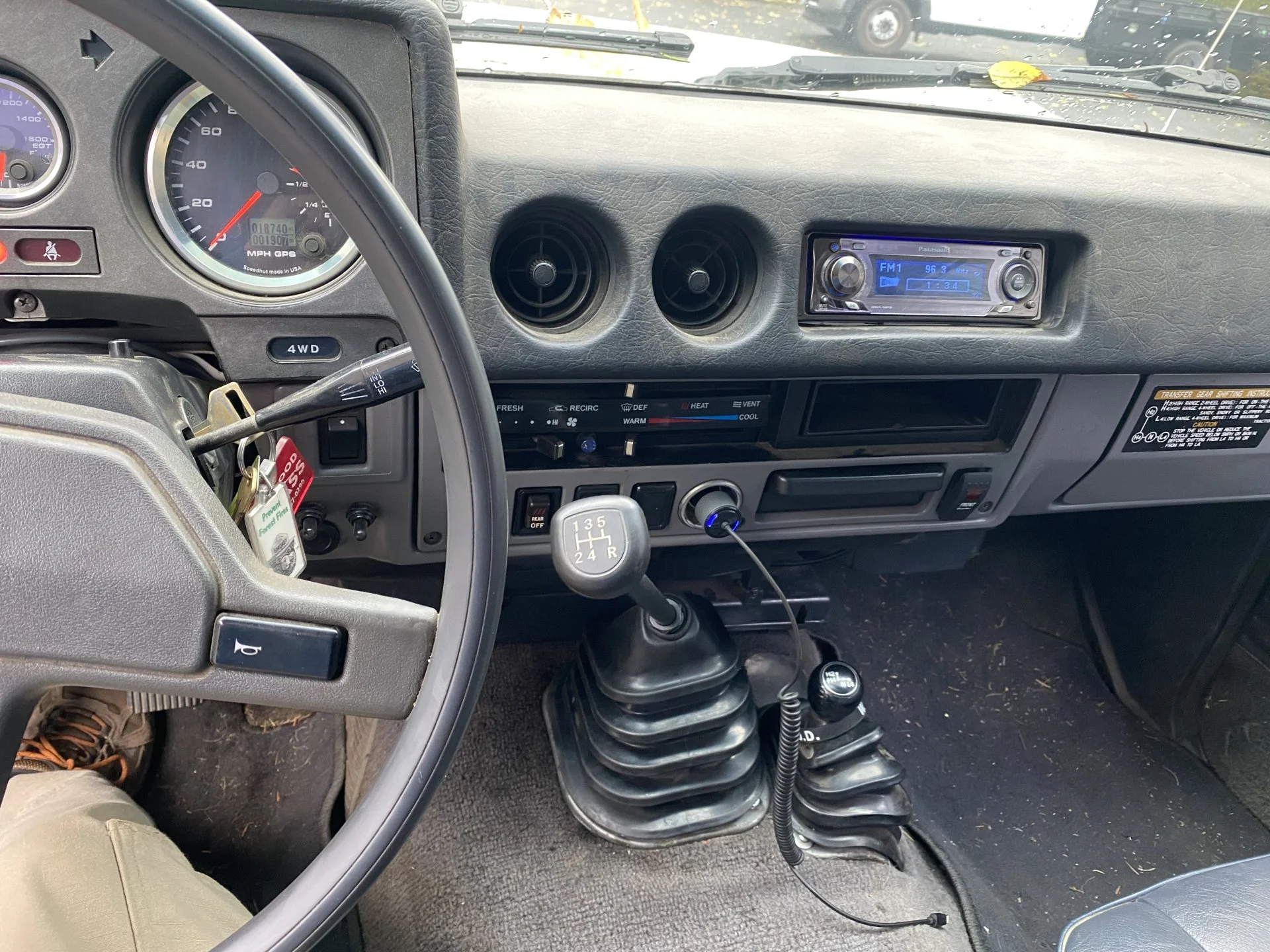

The short throw shifter was heated and bent because it interfered with the steering wheel.
Instead of doing the same thing I’m going to shorten the shifter handle 4”. It’s actually feels more comfortable at the factory angle towards the driver. I installed the handle and raised the steering wheel all the way up and drove it around and it actually shifted smoother. It went into reverse easier.

Allstate Gear short throw shifter was out of stock and unknown when they’d get any back in with the supply chain problems. Told me to check Ebay and found it. The previous short throw shifter we heated and bent. Instead of heating and bending the short throw shifter decided to shorten the shifter handle by 4”.
What a difference!
