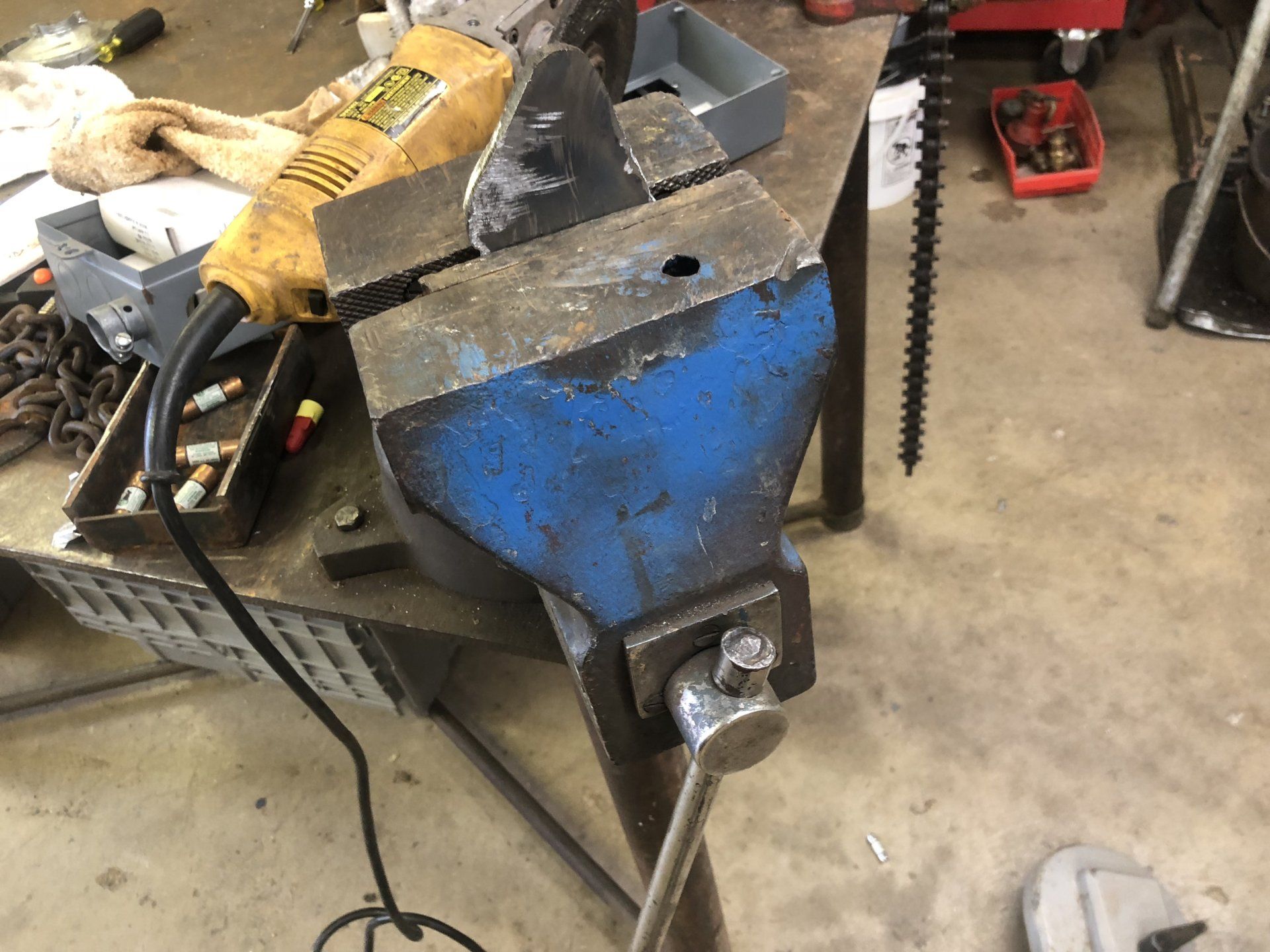

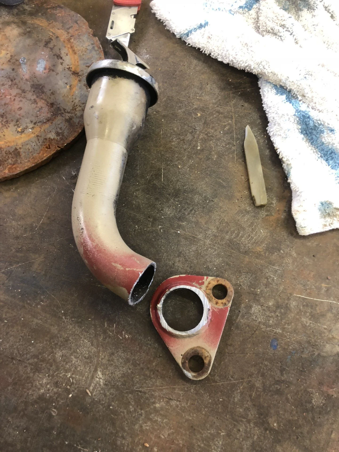

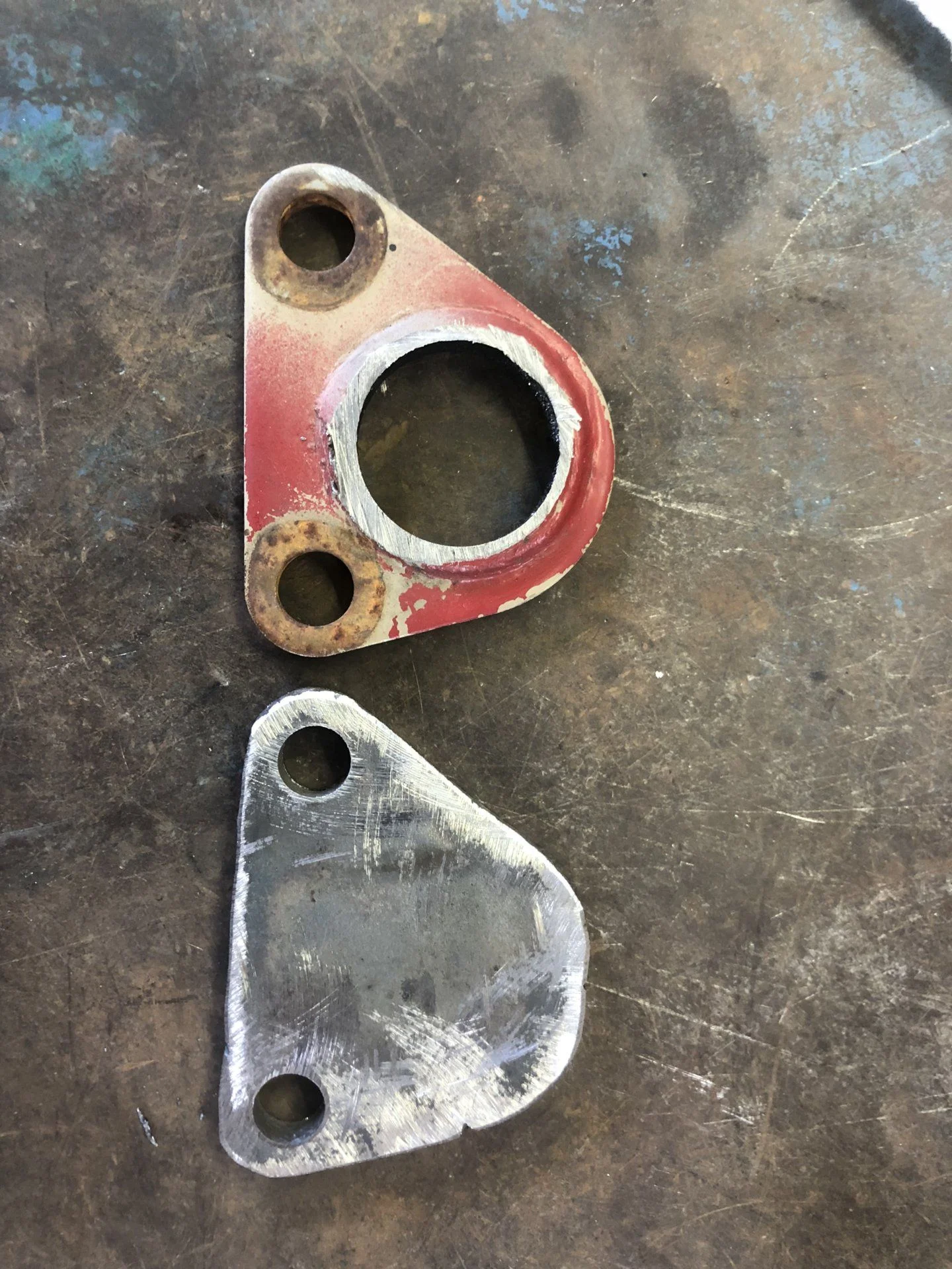

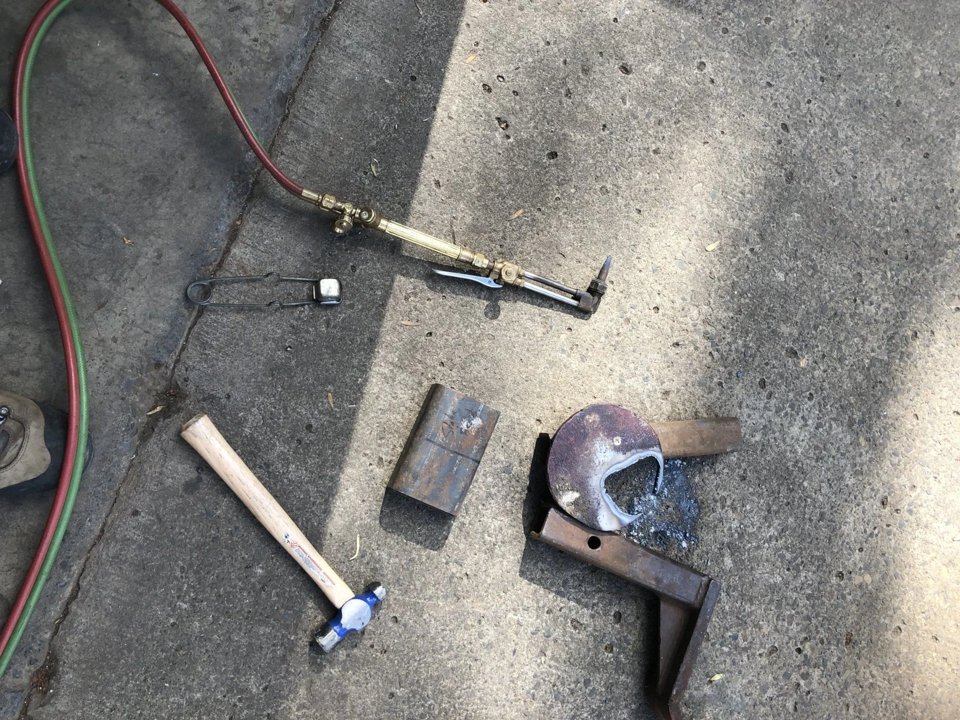

Cut off oil fill neck to use as a pattern to a blank flange. Cut off with portable bandsaw. Trace pattern with soapstone and cut with oxygen/acetylene torch. Cleaned with angle grinder. Center punched holes and drilled in drill press. Clean edge with grinder and paint. Hook up trailer to my dodge and haul up to Jeremy’s house. Blew trailer tire on hey 26 going about 65. Was luckily two miles from his house. Cut off flap of rubber and made it there to deal with latter.

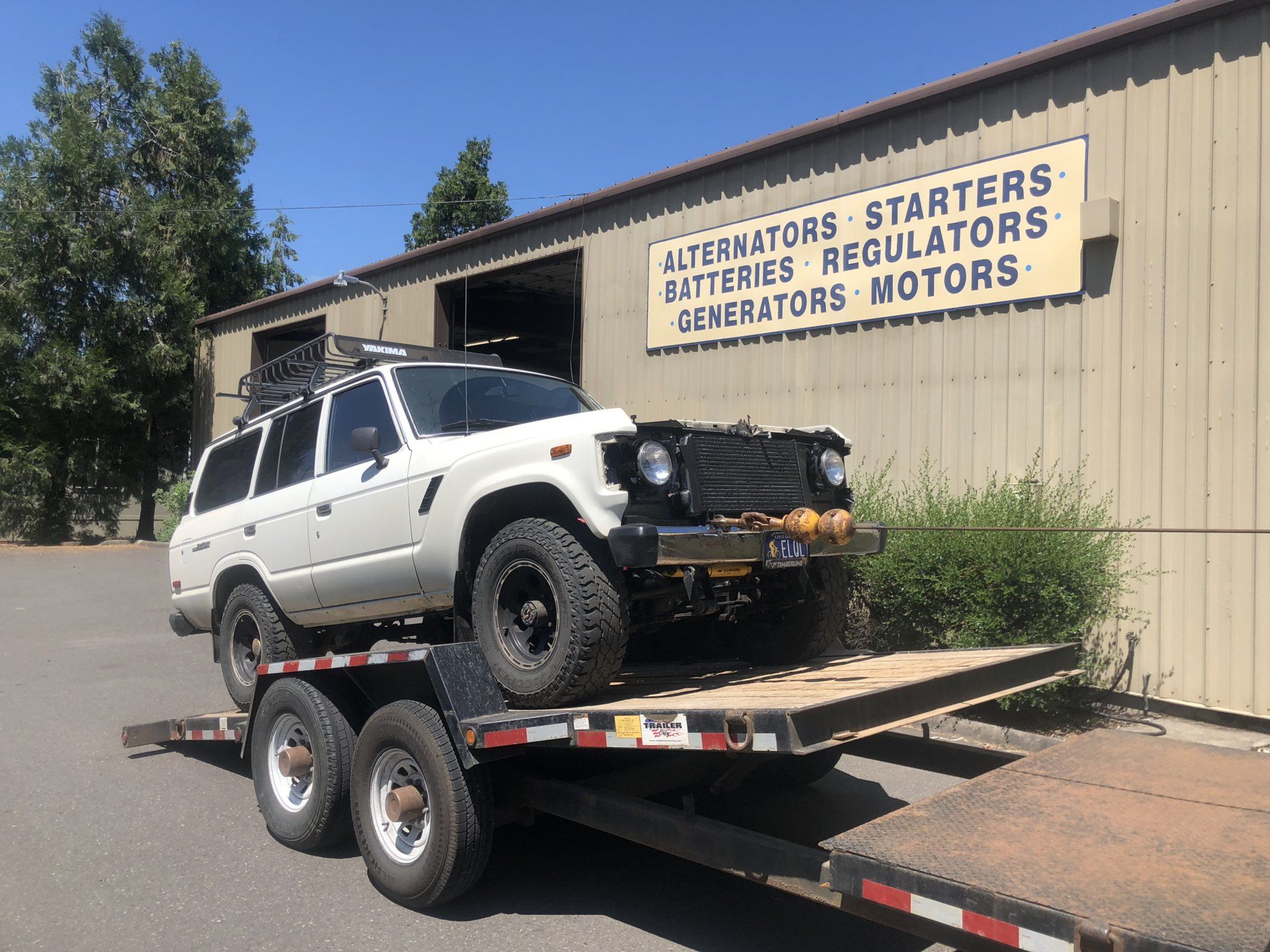

It’s been frustrating the past few weeks trying to pin point our problem getting the motor to fire. We think we have narrowed it down to my VE pump. It’s currently at the shop.
