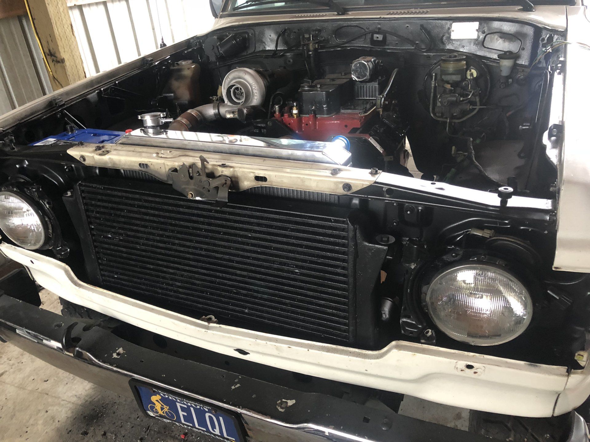

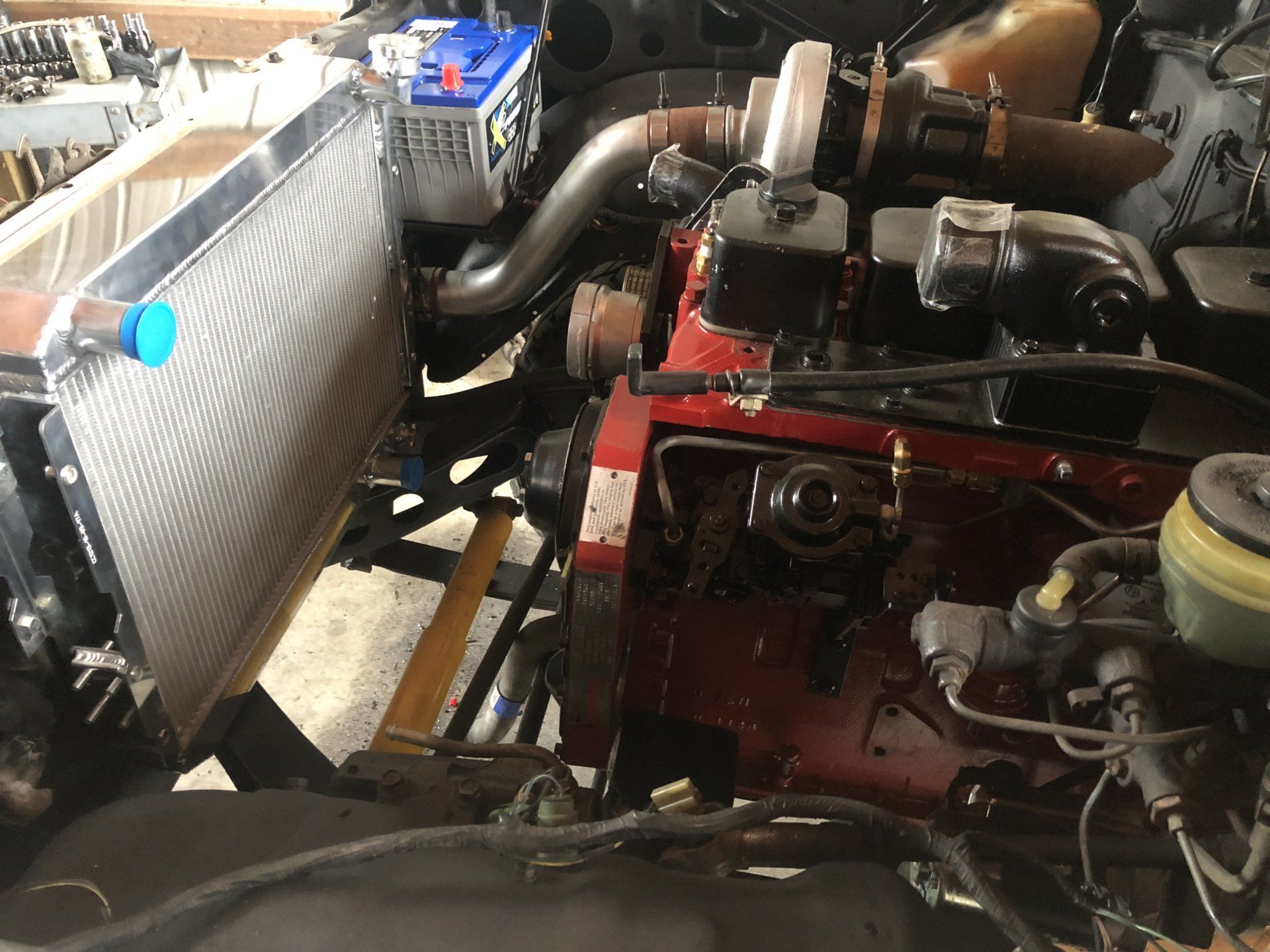

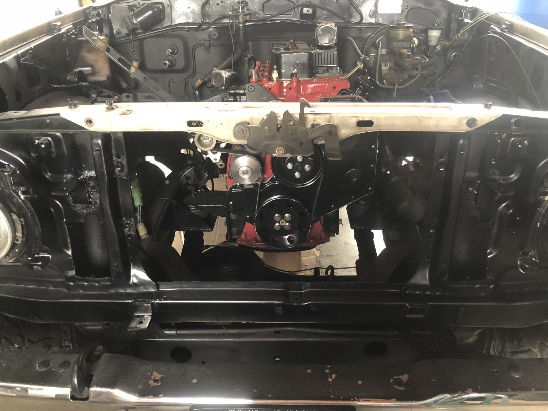

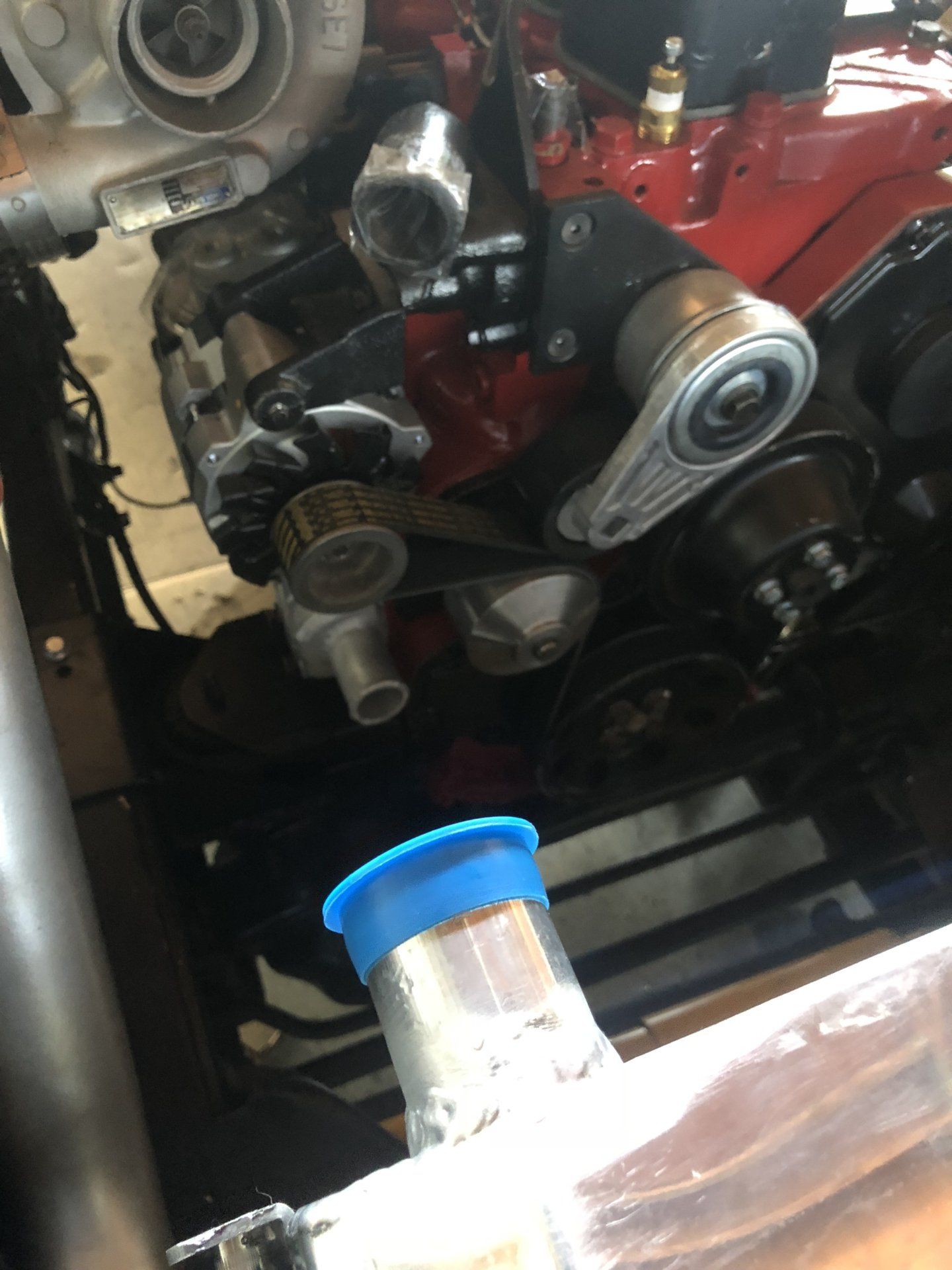

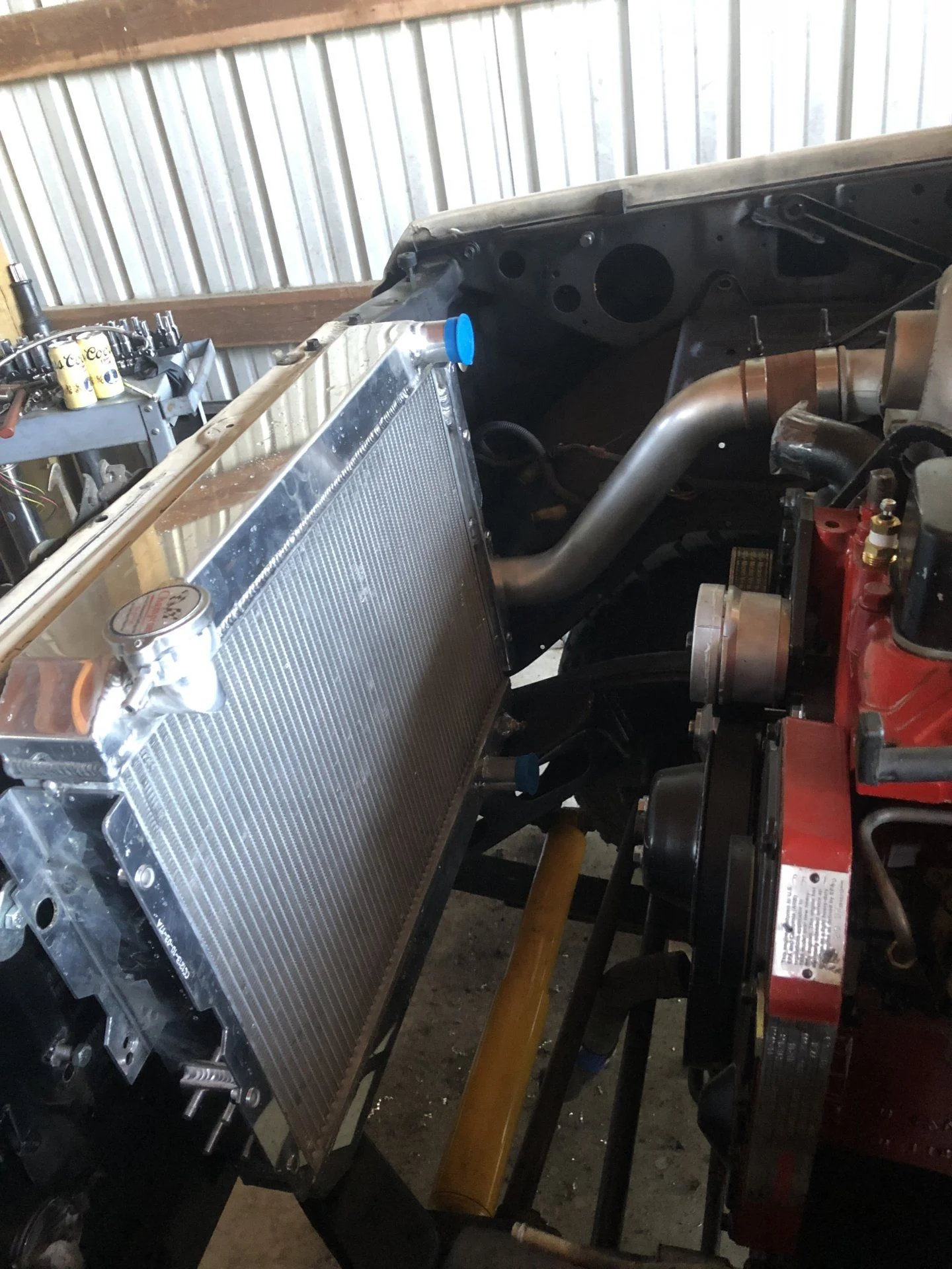

Time sure does fly by. Works been busy as well as any time off for family so it’s been slow as molasses on the cruiser... until today. Was able to get the innercooler painted and mounted in the location just behind the Toyota grill. Mounted the Chamipion Radiator in the stock location.
Once the Tcase is installed it will be time to start the SOA conversion. Dropped off the radiator tonight to my friend who welds aluminum for the top ports in the radiator to be swapped.

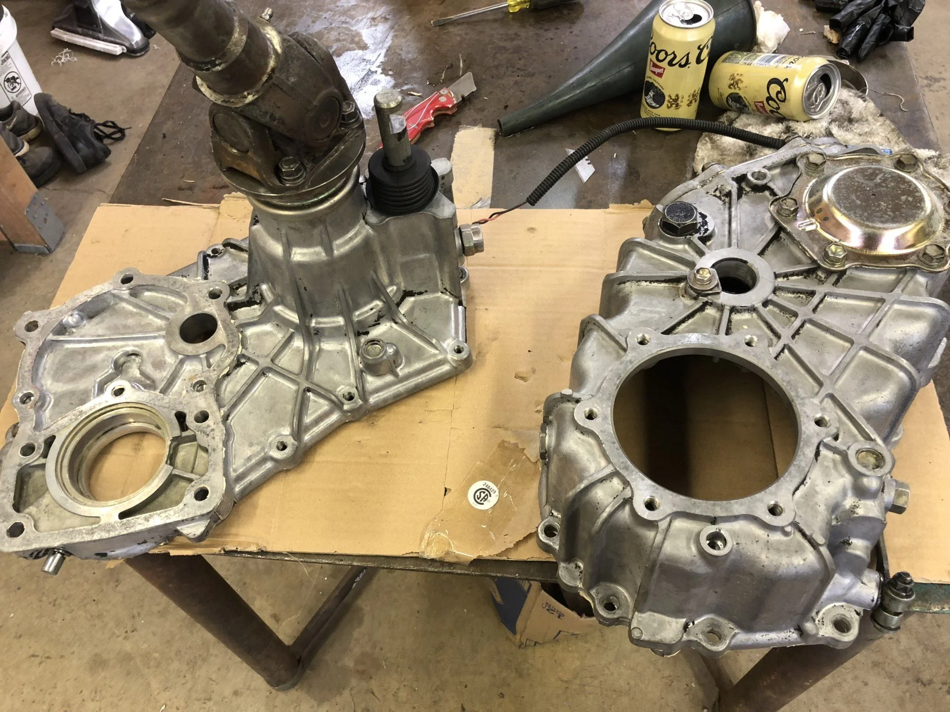

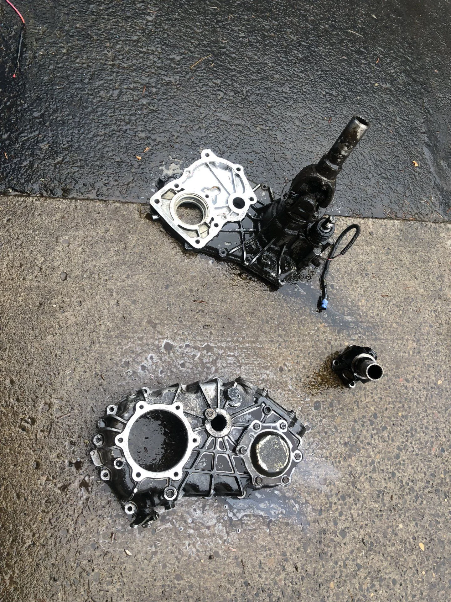

I used purple power degreaser to clean on half of tcase and crusader degreaser on the other half. Both cleaned about the same but I combined them together and was amazed at how well they worked. I know... I know... don’t mix chemicals but wow!
I thought you used the Coors in your second photo to clean the case.

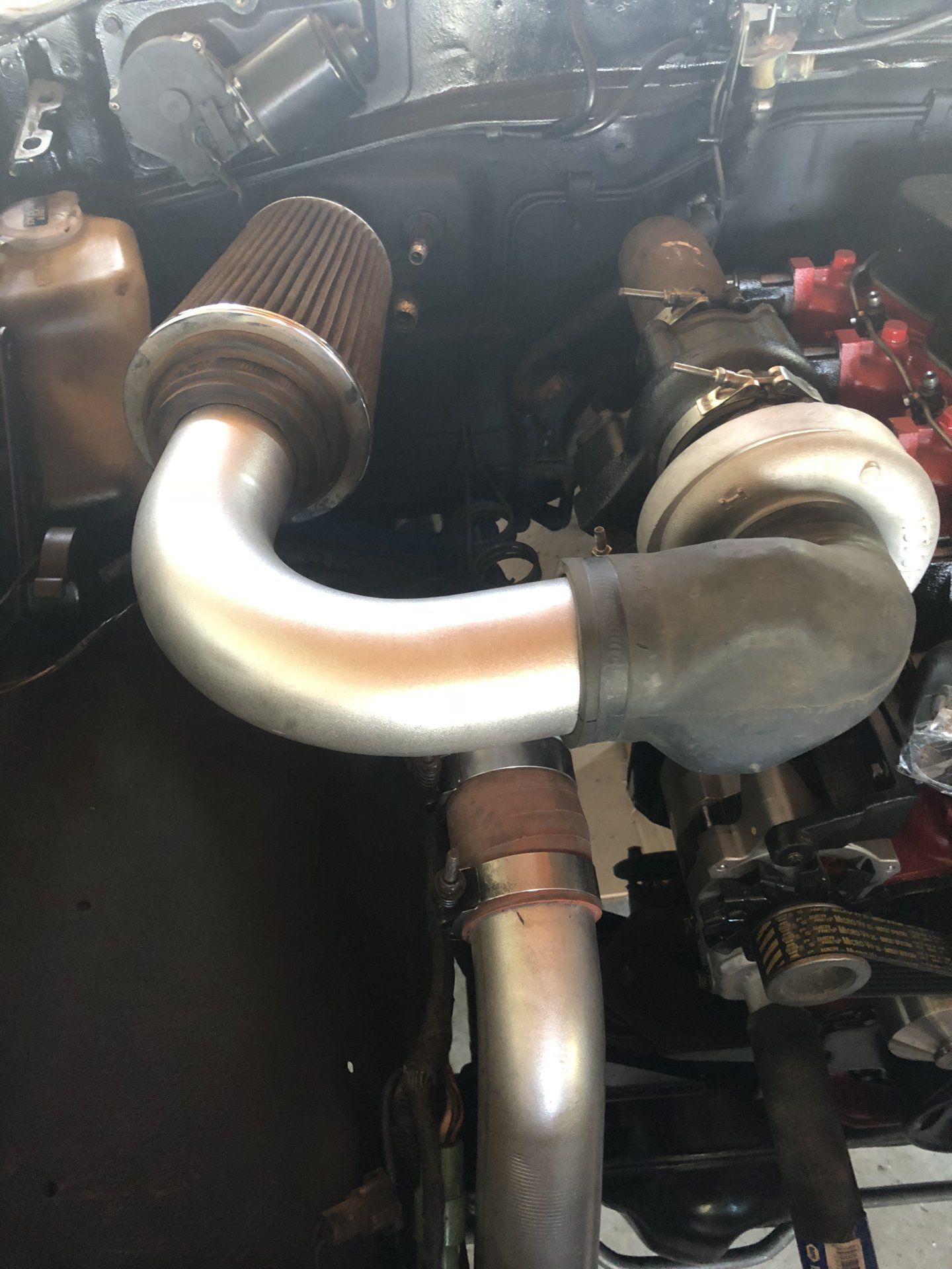

Best part of buying the complete stepvan is rummaging through all the spare parts.... score. Many of the stepvan parts actually work on the cruiser. The innercooler was a great one. The innercooler piping will all work as well. The only modification will be the line from the innercooler into the motor. The 90 degree bend and rubber 90 hose clamp connectors will work great for the air flow line into turbo. Sand blasted and painted with Krylon metallic aluminum. Sandblasted and painted the radiator supply line into motor also.

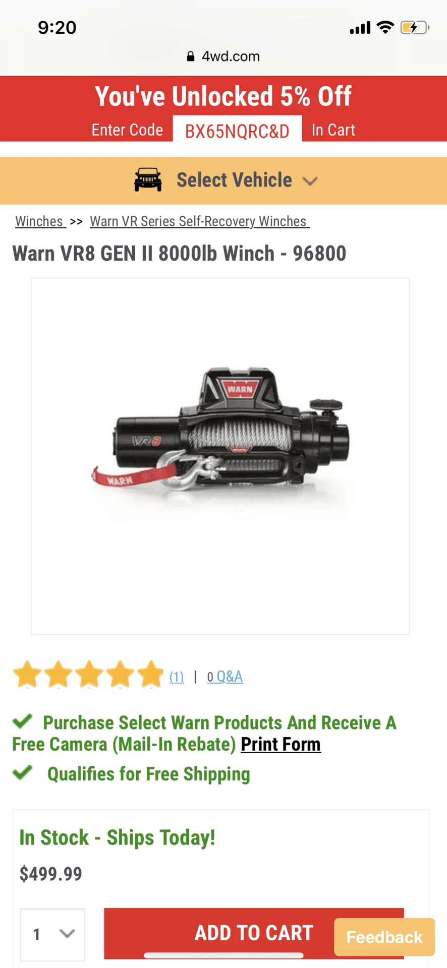

Getting closer to get @Rustic76 4plus bumper so it nice to start thinking of some toys to add. Found a warn 8K winch with 5% discount and free shipping. Anybody have any input?

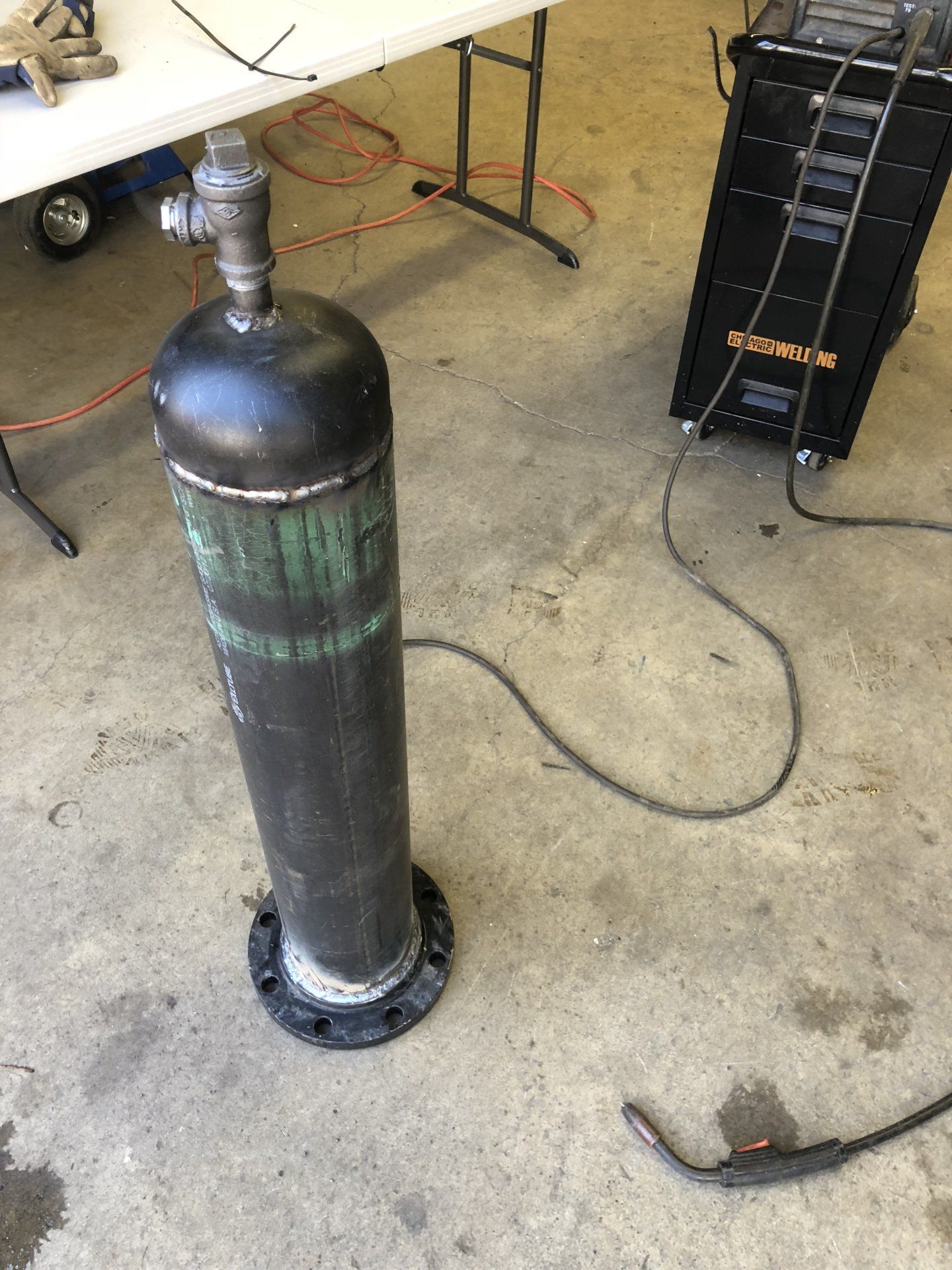

Not related to the cruiser but thought I’d share a picture of my creation for a job at work.
So far I’ve been able to reuse everything from the stepvan for the innercooler setup. The 90 degree elbow from air filter to turbo. The turbo to intercooler pipe was an exact fit. The angles on all fittings matched to a T. The only modification was to add about 4 inches of straight pipe from the intercooler to air supply on motor. Coming together really well now with milder weather and sunshine. As the daylight increases it’ll give more time to work after work.
