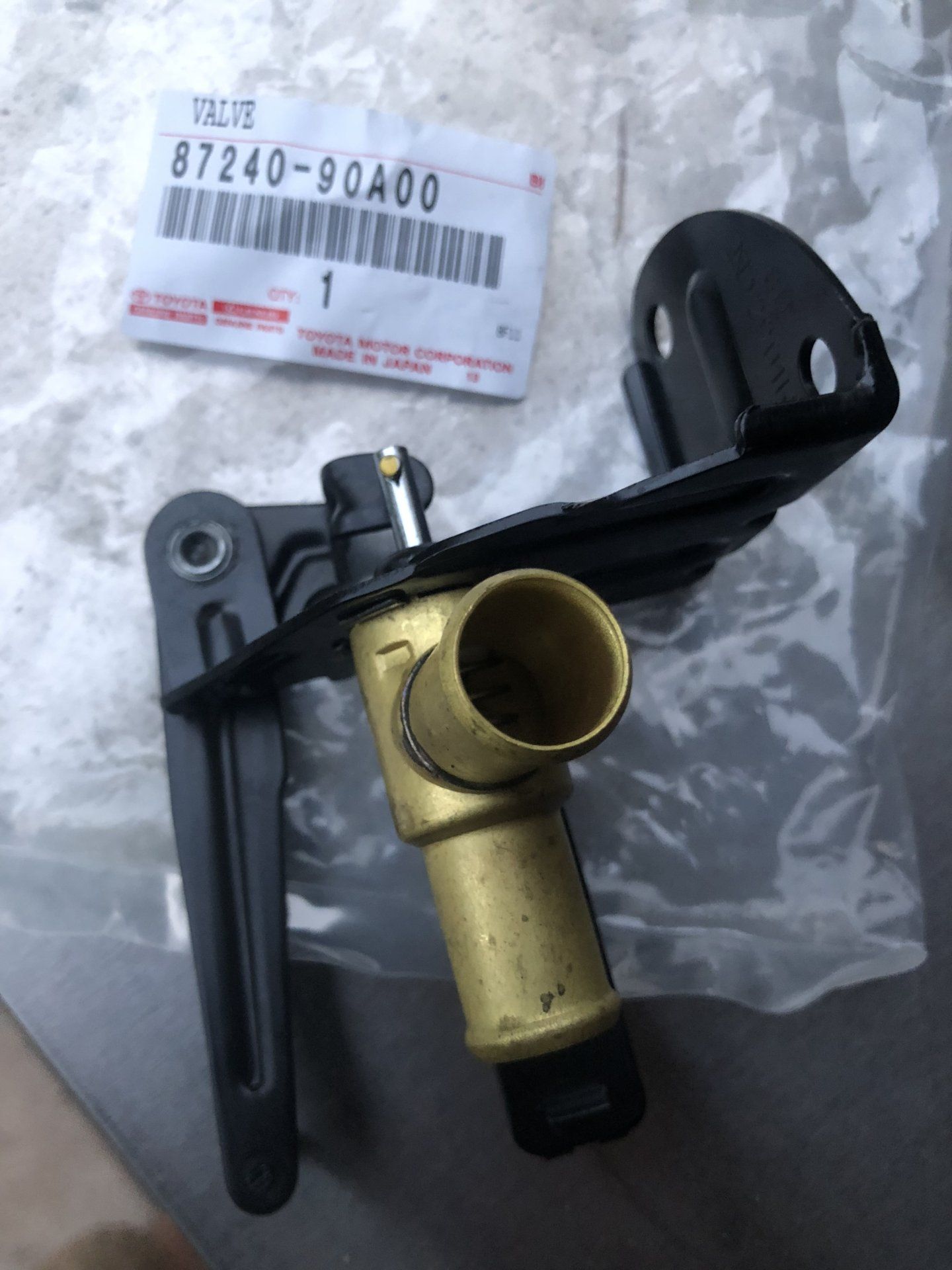

New Toyota coolant water control valve showed up today. Old one was in need of replacement. Never leaked before swap but with all the work in the engine bay it does now. Good time to install a new one.

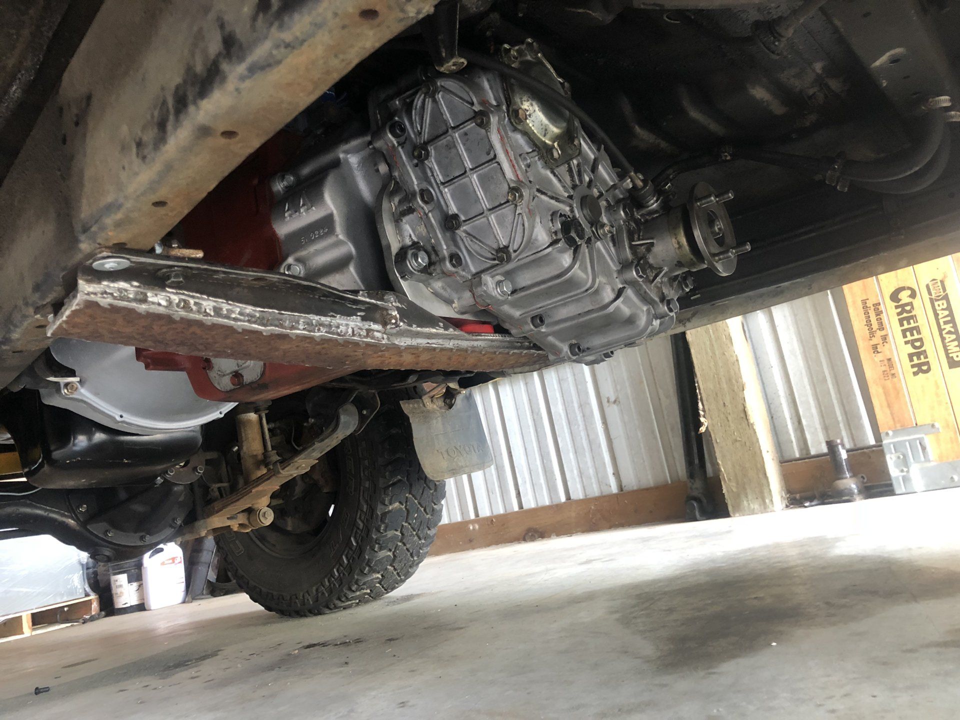

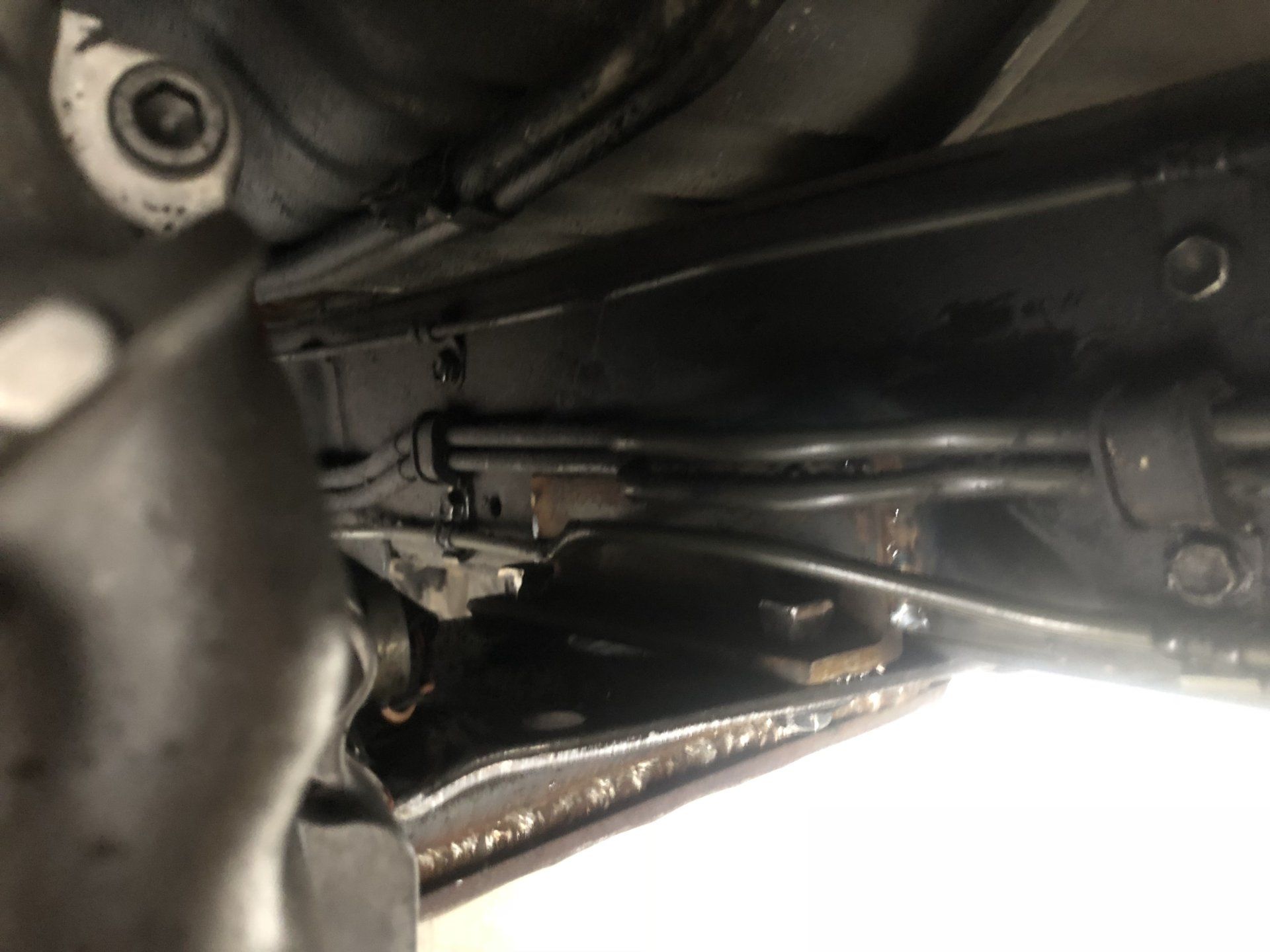

Stock crossmember was custom fabricated and installed. Engine, transmission and transfer case are resting on the frame. The crossmember will get removed now that it works and get painted. Fuel lines connected. Injector lines cleaned up and painted and installed. The 5 speed shifter lines up exactly in the factory location. The 4WD linkage still needs some more modifications as I mentioned above. But it’s getting closer to starting.
What bushing did you use to the crossmember. Is it bolted into the adapter?
