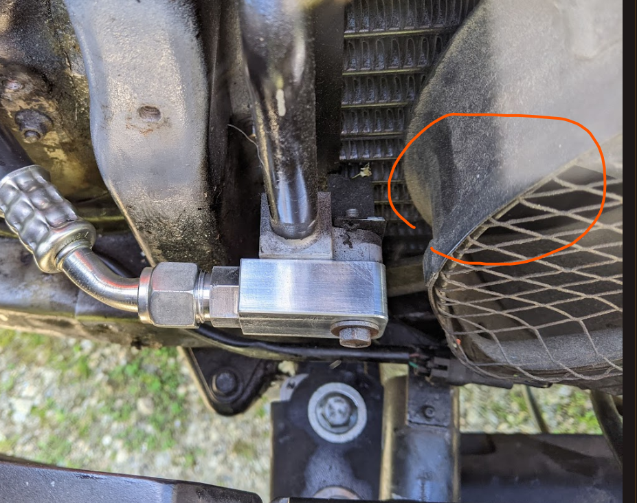

Can you share what fan you used for the AC condenser. May not need one in the pacific northwest but will probably install one.
Hey
NeverFinis,​
I bought it from Rock Auto. Denso makes the OEM condenser.
DENSO 4770554
That fan is from
Thanks for sharing the condenser. what is the fan you used?
That fan is from a 3rd gen Toyota Supra. Bolts right up to the land cruiser condenser.
This maybe the same one: 88590-60010 but I can't confirm.
Edited to show what I have installed.
Here is a picture of my fan, wired it up using Sumotoys instructions.

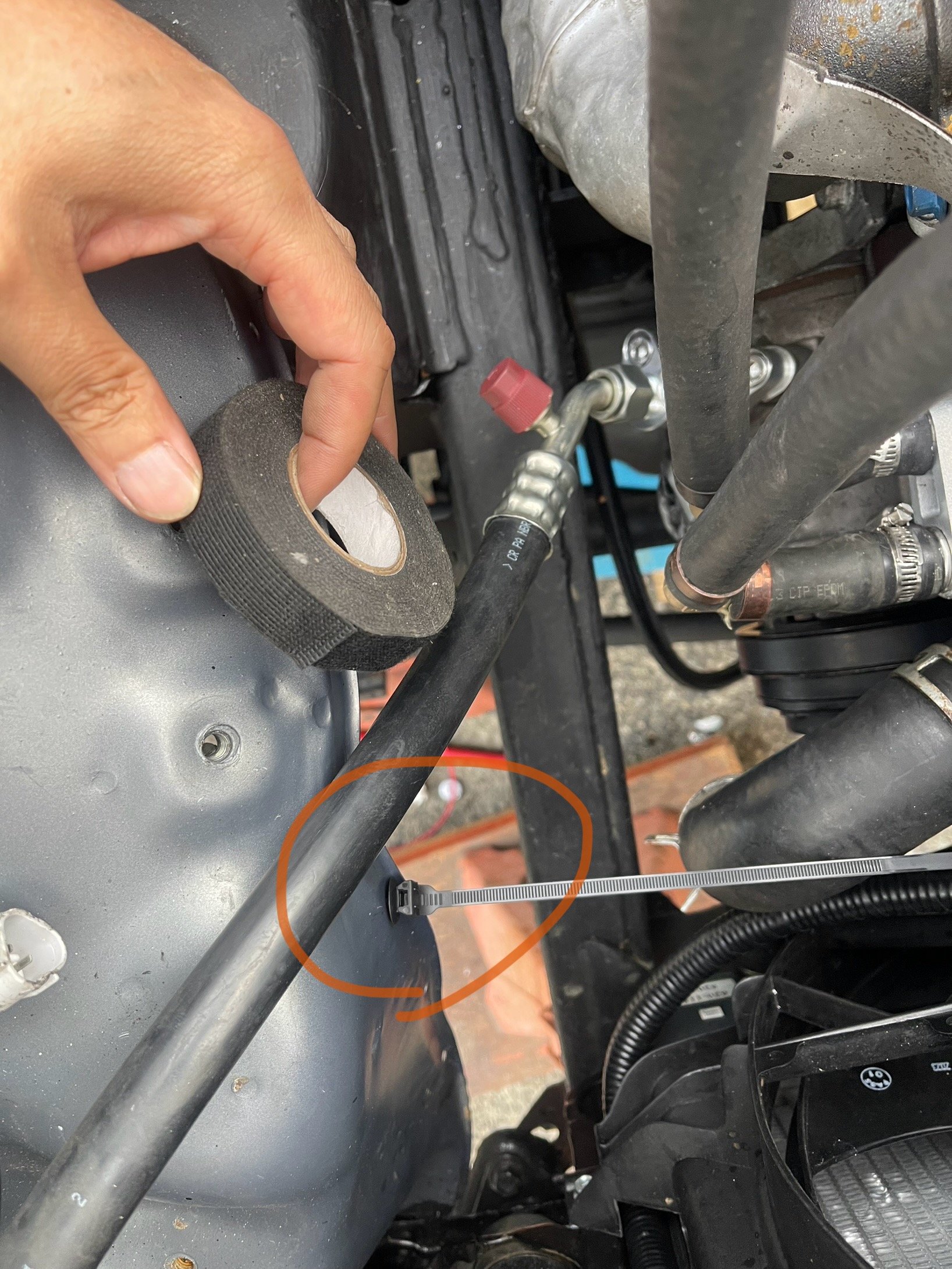

In responding to neverfinis on how I tied the ac hose down. There is a hole on the lc chassis. I used the special zip tie to plug into the hole, then use anti high temperature abrasion tape to wrap the area where the zip tie holds the hose. There must be a better method; works for me. By the way, cruisermatt. Don’t think you need to extend the upper hose if you connect the upper hose properly. Fits perfectly now. Cheers
