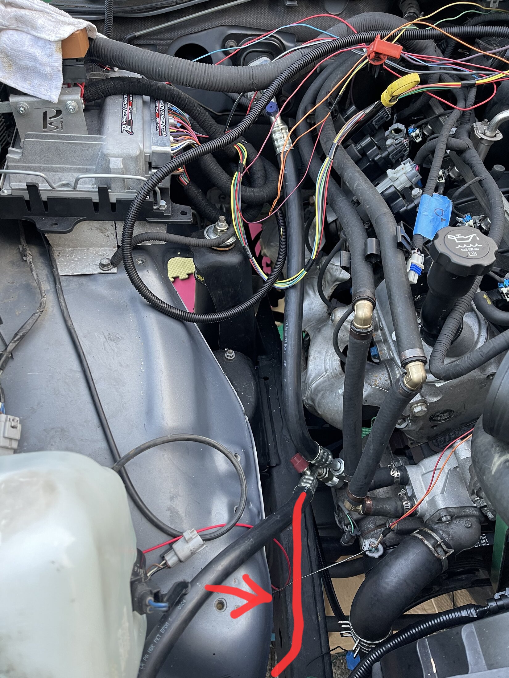

Thank you for posting this. Is there a way to push the hose towards the engine the way it is shown on the picture below? I have a second battery where the hose wants to go.

I have @cruisermatt AC lines and a second battery box being used as my primary battery. That line can be moved and shifted underneath the battery box. It is tight but works. Hard to take photos because it is below the LS air intake and below the battery box but I can see if I can get some photos later.
The best way to do it is to take a factory hard line from the condenser and cut it off after it passes through the firewall radiator support and have someone crimp/solder on an A/C line.
If there is a change to make to the kit I am 100% open to making change. Maybe making the fitting off the compressor a 90 instead of a 45 and adding a few inches of length to the hose?

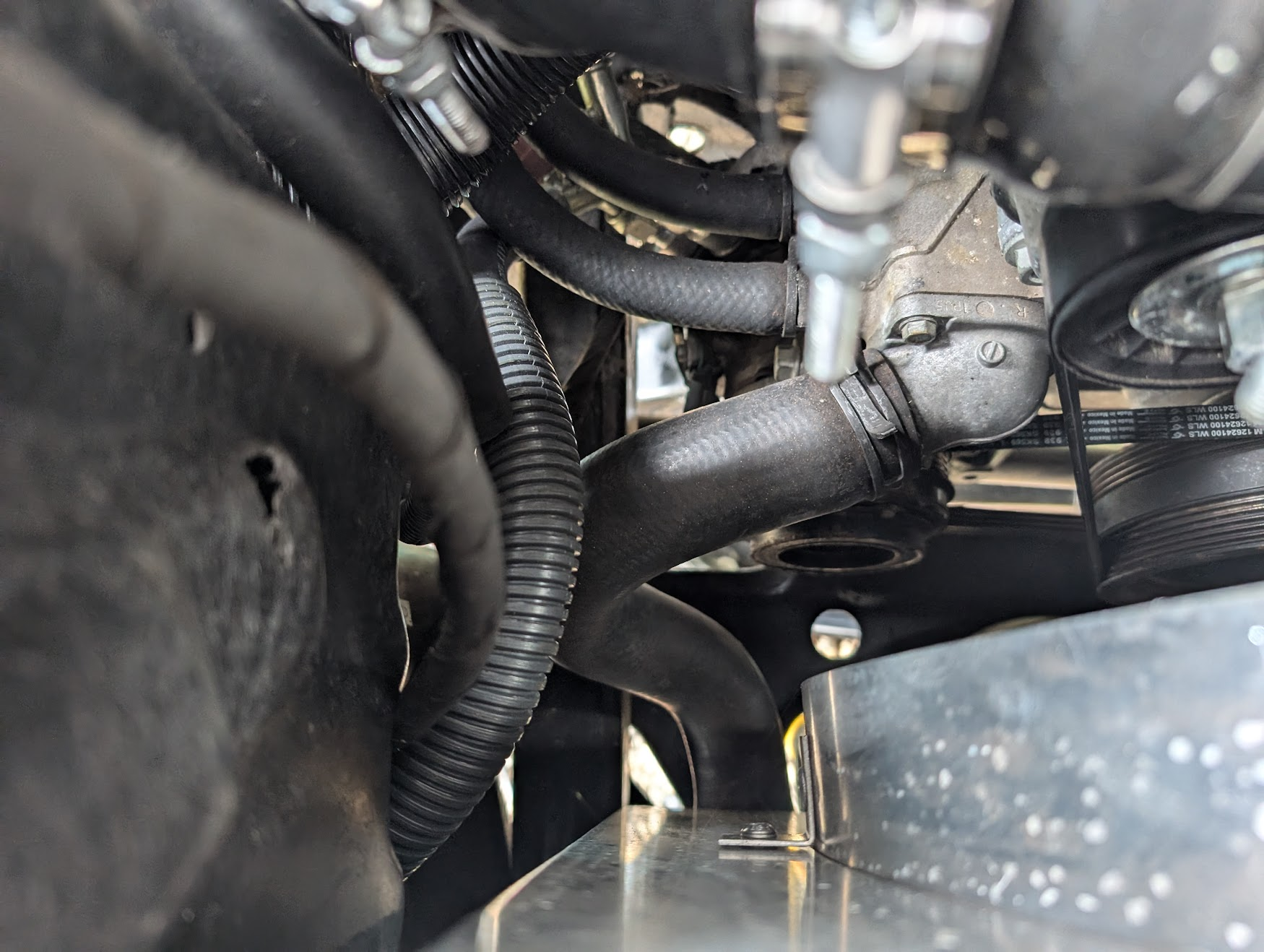

This is what my A/C looks line. It is the hose with the loom cover next to the low rad hose. I used the loom to protect it going through the radiator support, and for abrasion resistance against the body underneath the battery tray.

A few inches to the upper hose would be real nice. It was a little difficult to connect the fittings but not too hard. Initially I was thinking about having a shop fabricate these ac hoses, however too much time and $$, so i'm glad matt has it.

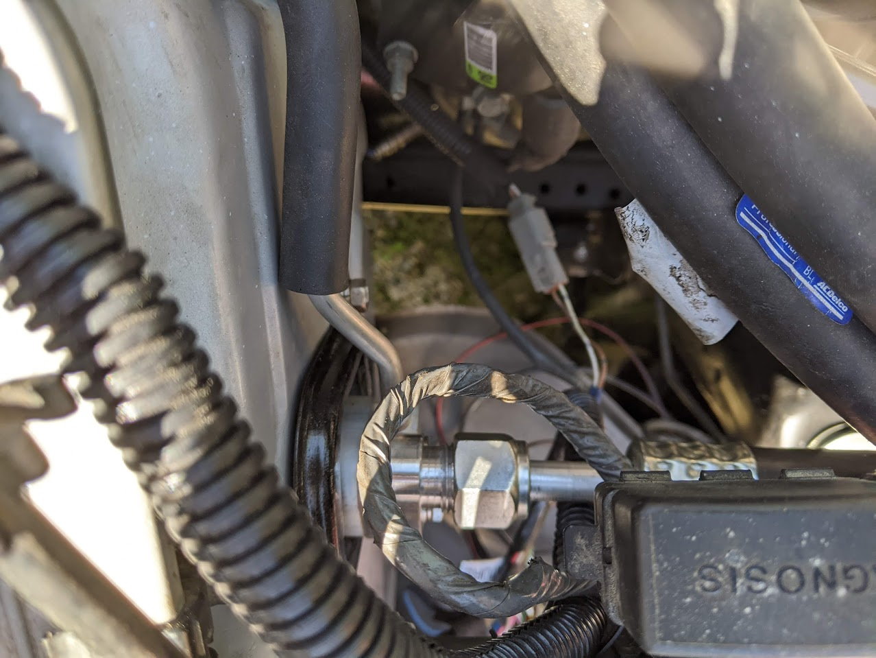

I am wondering if this changes will make it fit better with OEM airbox and the second battery:
- 90* elbow right at the fire wall and 90* elbow at the the compressor and additional ~4-5" of hose for the low pressure hose
- 90* elbow at the compressor and additional ~4-5" of for the high pressure side.
I just looked at my pictures again on desktop. You have the low pressure (large) hose in backwards. Try flipping it around so both charge fittings are at the compressor and you’ll find it a lot easier to install. Did you look at the pictures on my website or in this thread?
