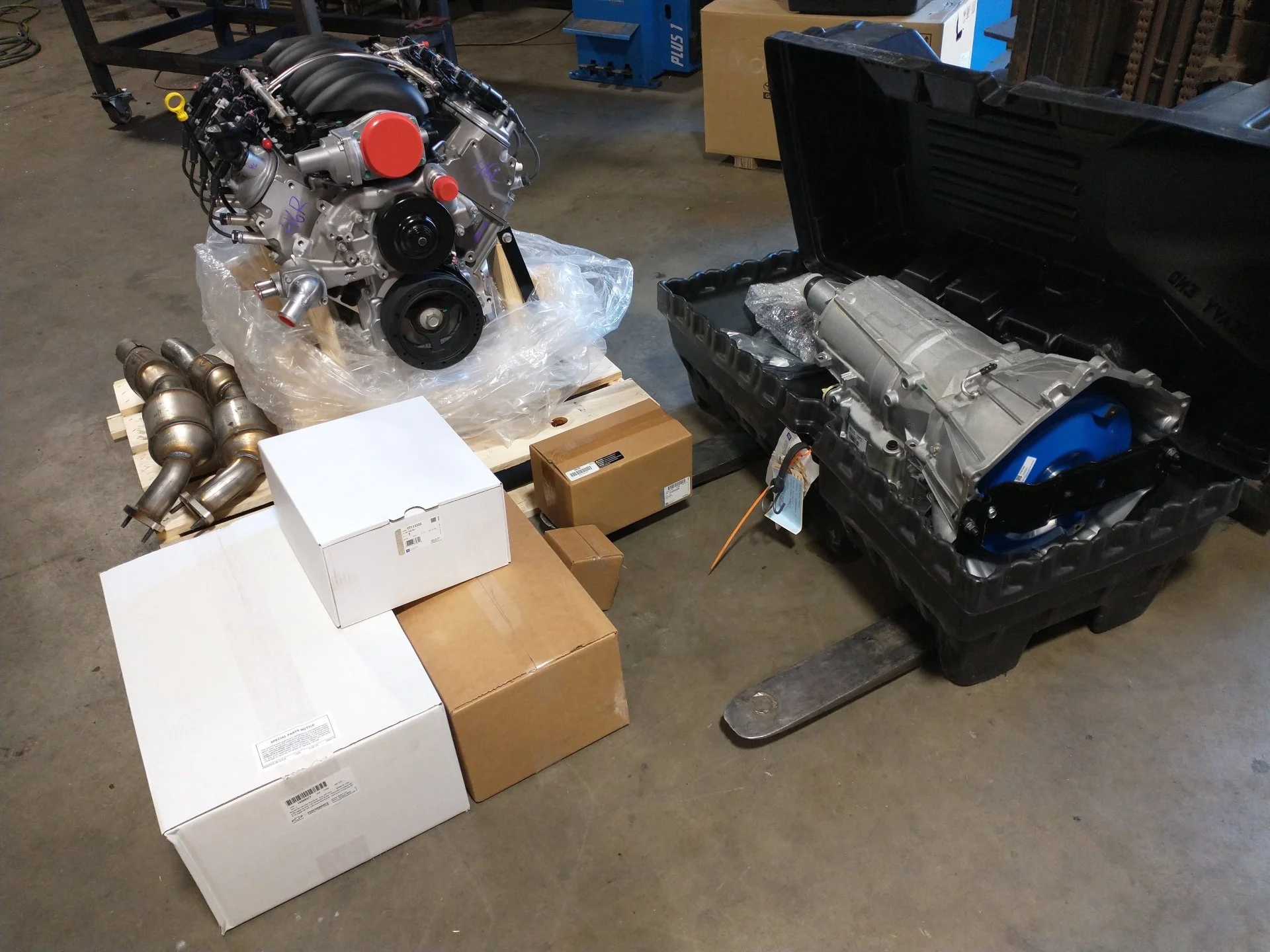

Picking up the motor/trans that will be making its way into my 92 at some point.
2015 5.3 Gen V and 6l80e with 27k on them out of a tahoe.
My first question is motor mounts, I see tons that are bolt in options for 93-97 but does anyone make one for the 91-92 80's?

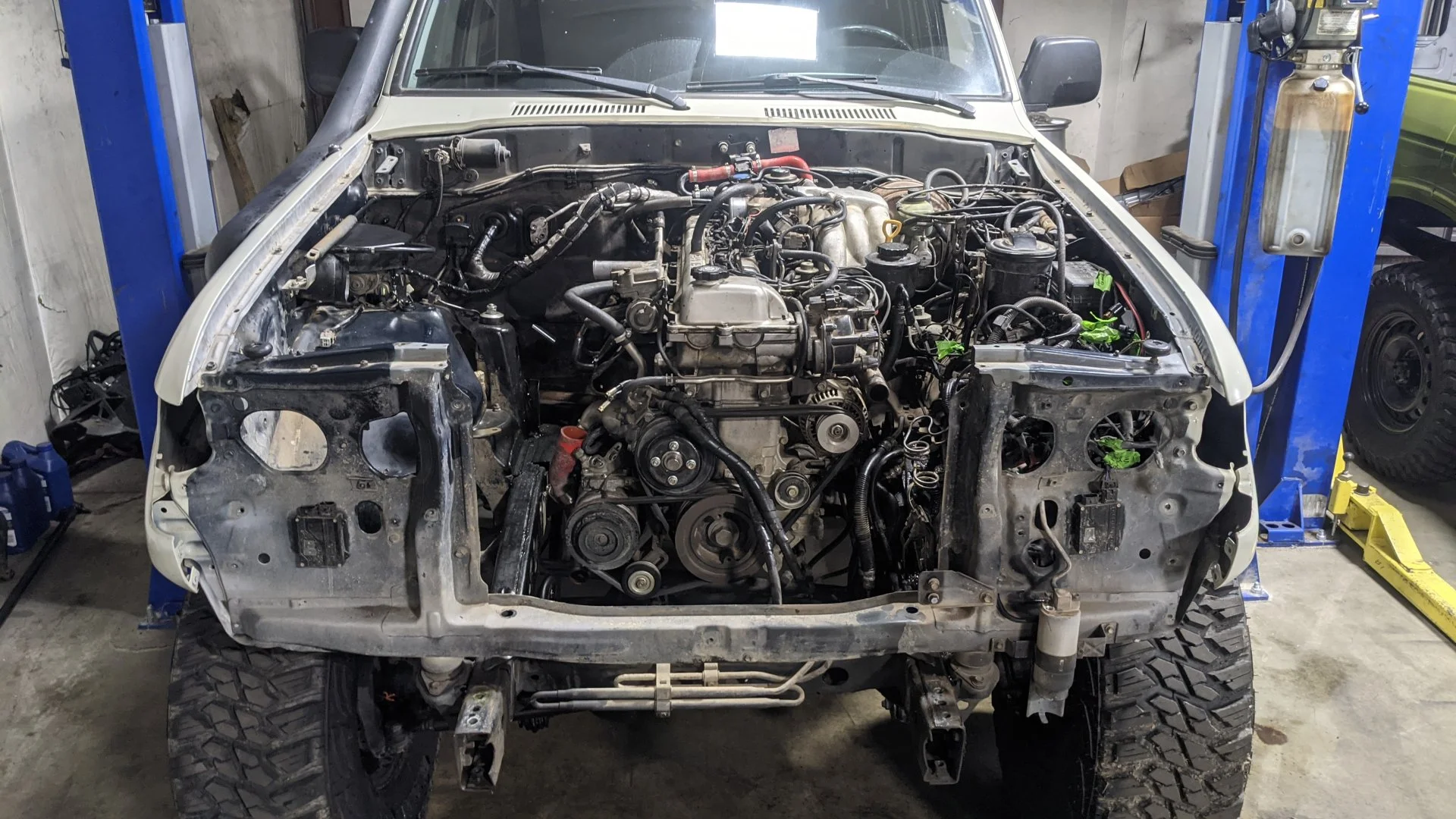

I am thinking of doing a V8 swap into my Land Cruiser over time.
What is a good motor to go with that wont kill the bank account but still provide enough power and torque? What transmission is everyone using? I am not against using a Chevrolet transmission and an adapter for the transfer case.
Where is everyone sourcing their adapters, mounts, wiring harness, etc from?
