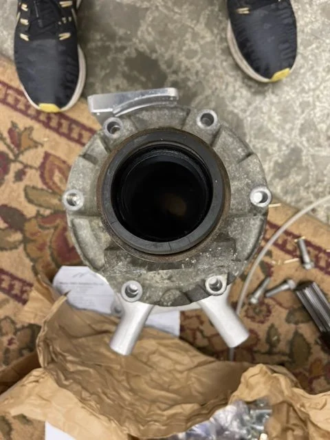

Curious if anyone in here has mated the Marks adapter to a 6L90? I have had my adapter for a few months and as we are just about to get the new engine back from the machine shop...it seems like the adapter isn't fitting on the back of my transmission...
The sku I ordered was MFP1945A
Here is an image of the adapter lined up to the output cover of the transmission to see if the holes line up. Only 3 of 6 line up. Am I doing something wrong? Also...the shaft extender they sent has a diameter that is too small for my shaft. (Thats what she said.)
Thanks for any advice.

Even if the output shaft is wrong. The adapter should line up. I get it that it’s aftermarket. But 2 of the hikes are at least 1/4 an inch off. I’ll call Marks today to get an update.

So 5 of the 6 holes line up. I had to grind a small part of the casing a bit to get the adapter to fit. The issue I have now is that the output shaft of the 6l90 is a 36 spline and Marks only supports a 32 spline...There has to be a solution. I will call @torfab tomorrow to see if they have a solution. I just can't believe that this can't work.

As far as my research goes, you need to have the output shaft milled to 32 spline, which Moser will do for a low cost, or purchase a 32 spline 6l90e output shaft.
There is a Camaro ZL1 6l90e 32 spline output shaft. I posted earlier a link to a parts diagram.
I posted this earlier, and I am not 100% positive this will work. : 45678DD - 6L90 USED 4X4 OUTPUT SHAFT - Product Details - https://www.buffaloengine.com/catalog/p-110387/45678dd-6l90-used-4x4-output-shaft

Did you see the answer to your question a few posts back, and several pages back? These are easy to tear down and there is a stock output shaft that will be cheaper and stronger than a one off spud shaft.

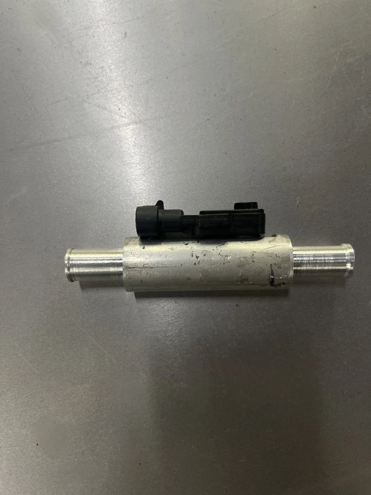

Made something for my soon to be CA legal 5.3L swap. In-line fuel tank pressure sensor mount. This thing seals up tight too, no leaks. this will go inline with the vapor line off the tank to the filler. I’m going to put it right off the tank.

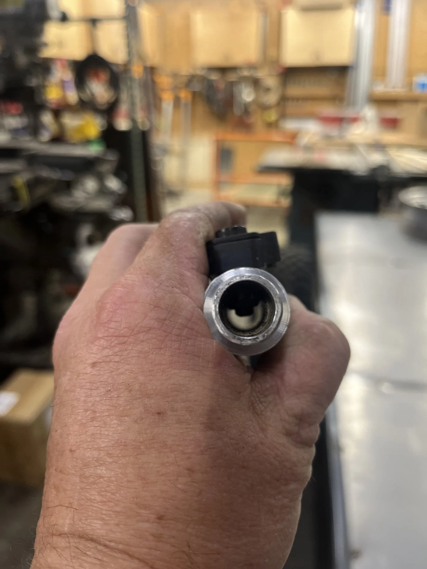

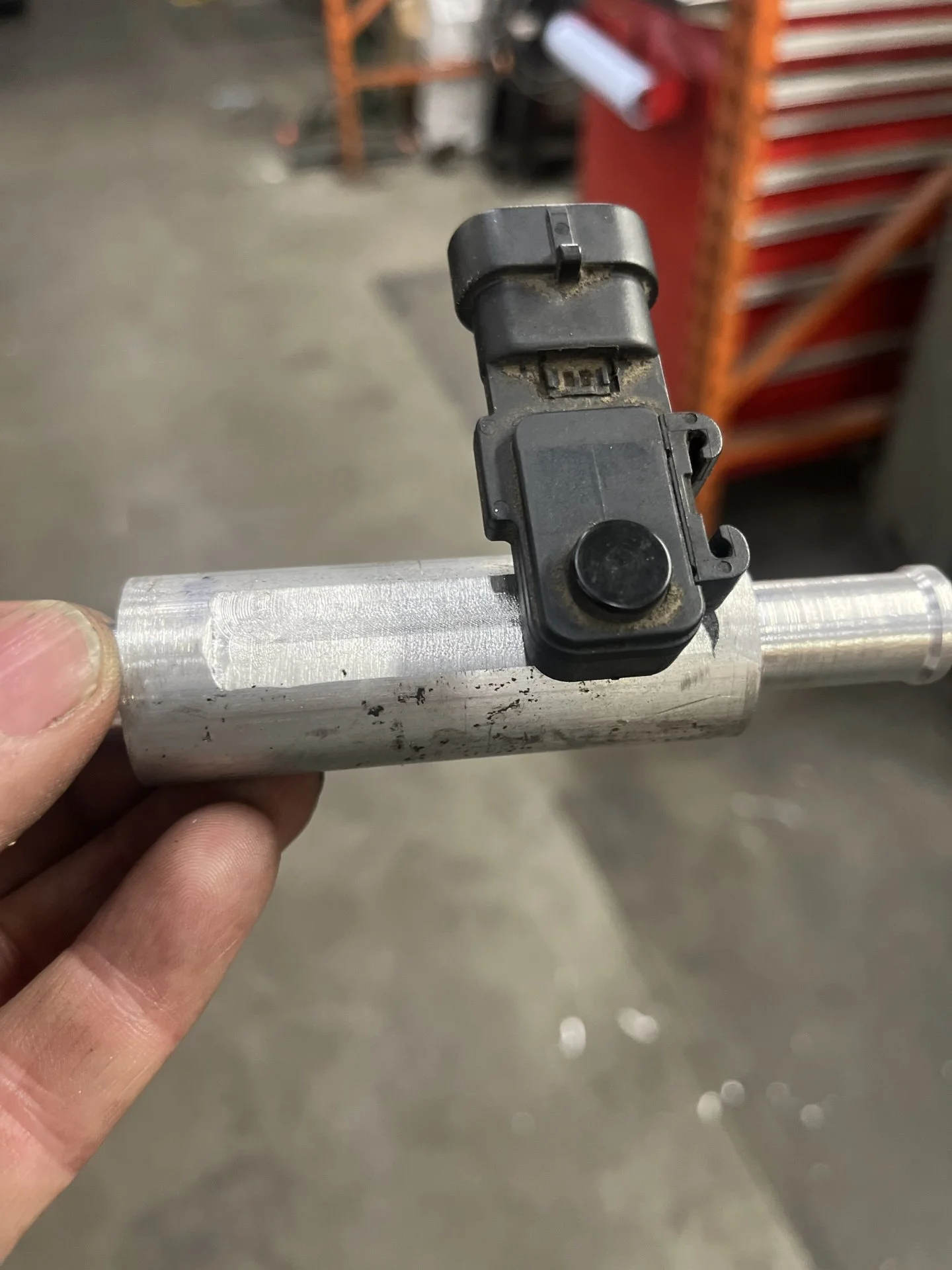

This is just to show the flat area for the sensor.
Made something for my soon to be CA legal 5.3L swap. In-line fuel tank pressure sensor mount. This thing seals up tight too, no leaks. this will go inline with the vapor line off the tank to the filler. I’m going to put it right off the tank. View attachment 2966431View attachment 2966432
Nice ... I put mine up near the charcoal canister.
What are you doing for the GM fuel level sensor? That's still something I need to figure out.
Did you use the GM charcoal canister? I have to for smog compliance. On the sender, I removed the GM one from the fuel pump assembly and going to mount it to the side of the Toyota one. Then run the wires up to some boss style terminals in the factory fuel pump top plate. I saw someone on here that did that and it was cleanly done.

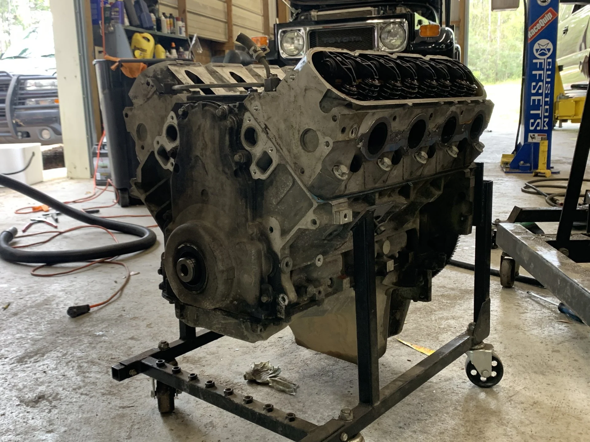

Managed to fanagle my way into this puppy for $300. It’s been 5 years and it’s time for phase 2 :hillbilly:
Mild build with a little PSI on top. Give me a year or so to collect the other goodies. “Old” engine with go in the 40.
