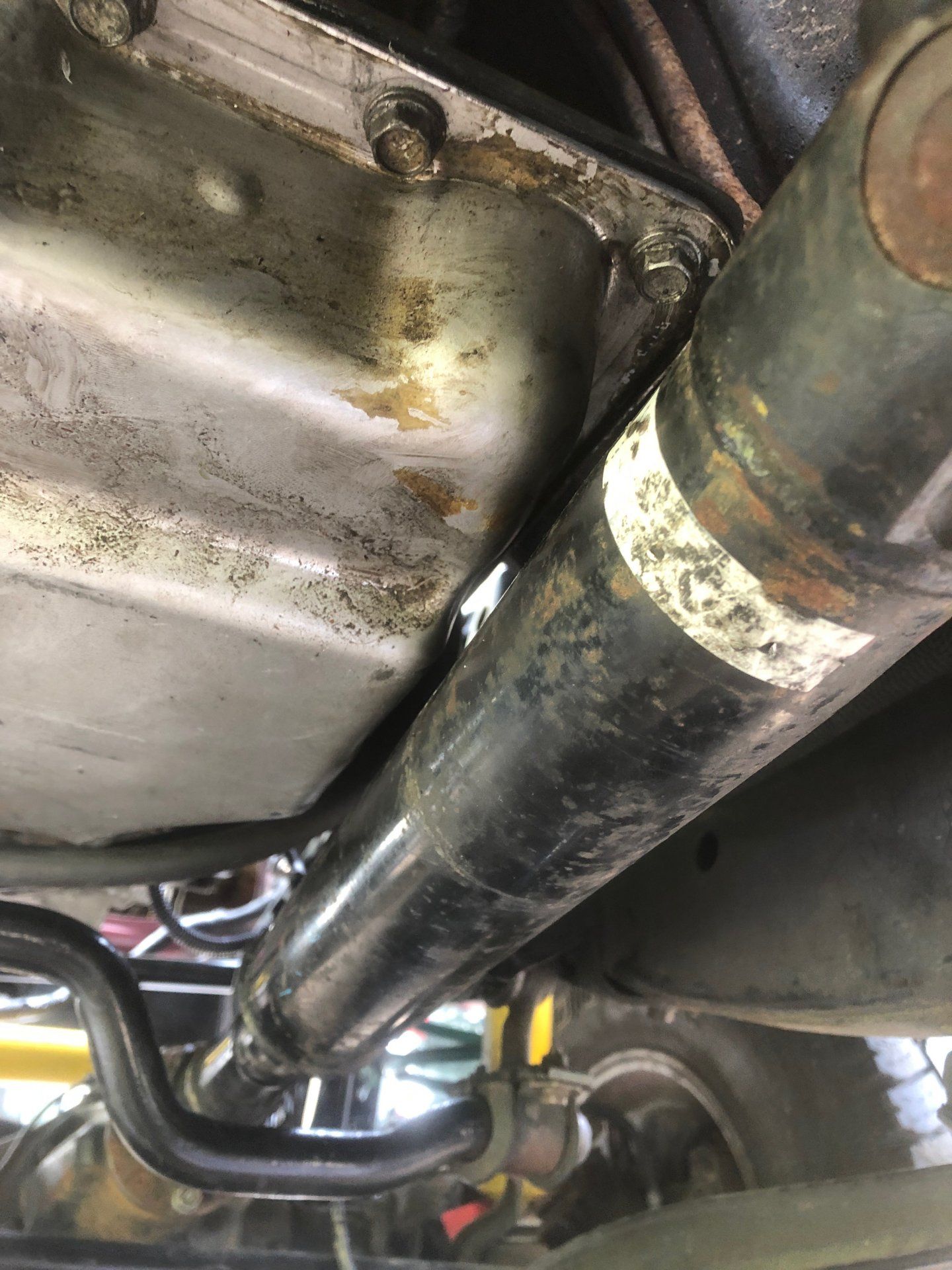

Mocking up my trans and engine. This, right now, is my front driveshaft/oil pan clearance. I havent had much luck creating more space there. How much more room do you guys think is necessary to prevent any rubbing?

Mocking up my trans and engine. This, right now, is my front driveshaft/oil pan clearance. I havent had much luck creating more space there. How much more room do you guys think is necessary to prevent any rubbing?View attachment 2333673
Remove your springs/shocks and lay the axle on the bumps, add some wiggle room after that. You'll probably need a smaller OD driveshaft. Any driveline shop should be able get you setup.
