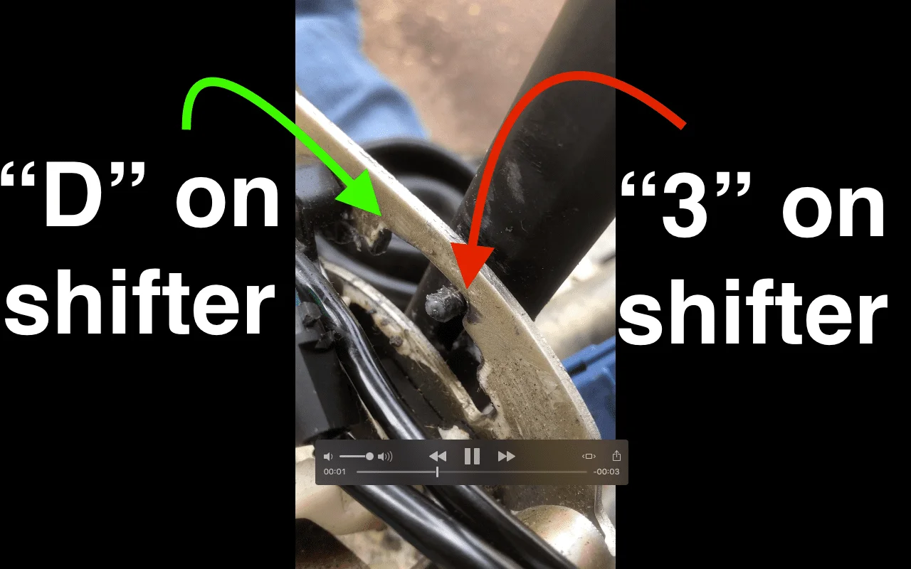

I’m installing a shifter out of a (I think) 94’ cruiser, because of the extra shift you get with them. It seems there’s no stopper in between D and 3rd gear though. Can’t you accidentally shift into 3rd going 70mph?
I’m installing a shifter out of a (I think) 94’ cruiser, because of the extra shift you get with them. It seems there’s no stopper in between D and 3rd gear though. Can’t you accidentally shift into 3rd going 70mph?View attachment 2308234
I believe it has to be from a 92 or earlier; that’s what gives you the extra position. The FJ80, not the FZJ80, is where you find that shifter.

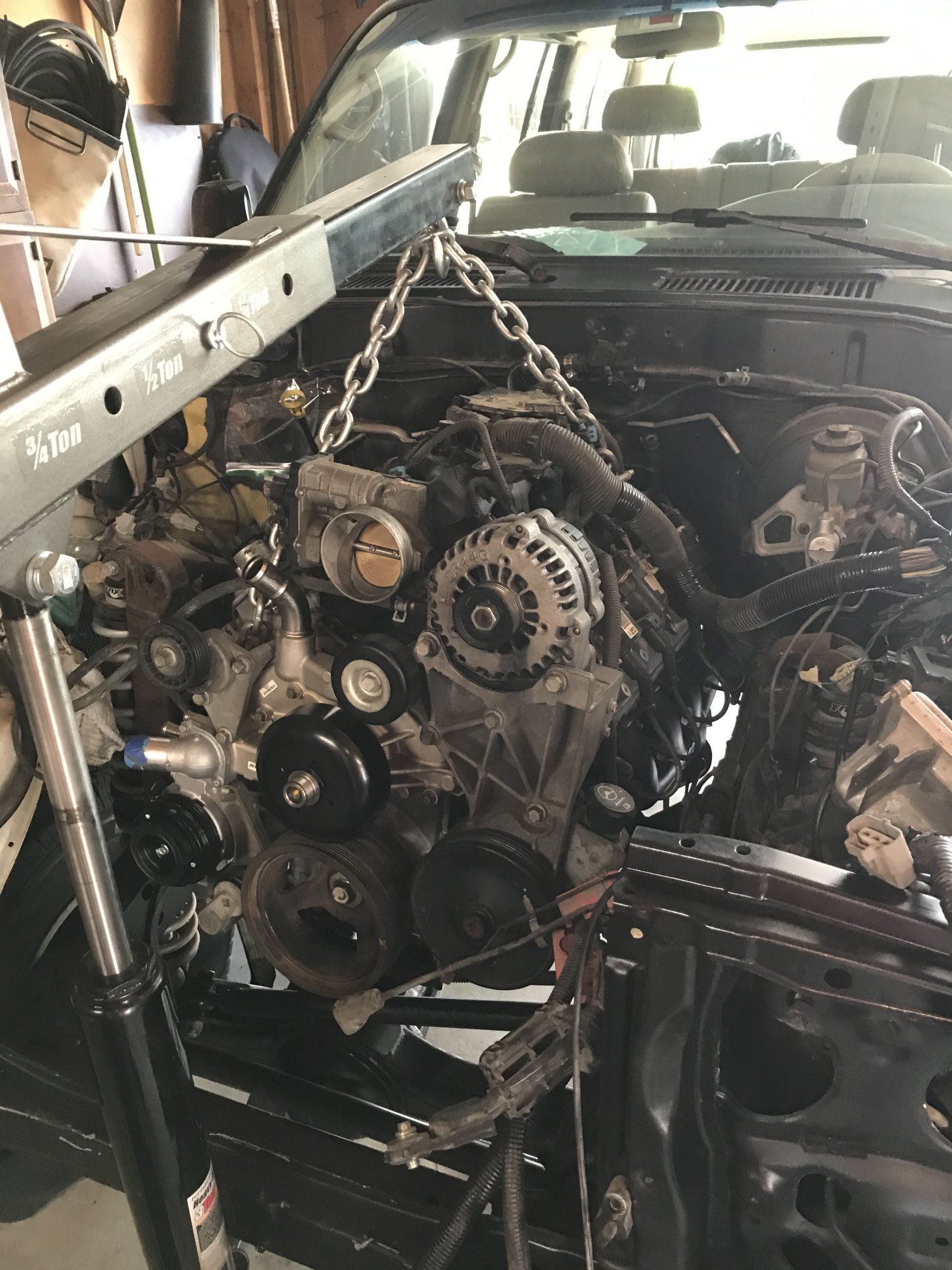

Did this today. 👍

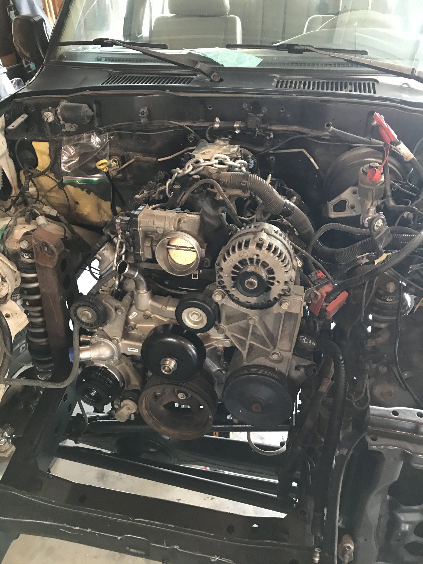

So the motor is wired and ready to fire. Obviously I have a lot more to go. I am just going to stick w/ the stock cluster. I hoped that the GM one could work but it’s not.

still a lot to do, but fired up the motor last night!
