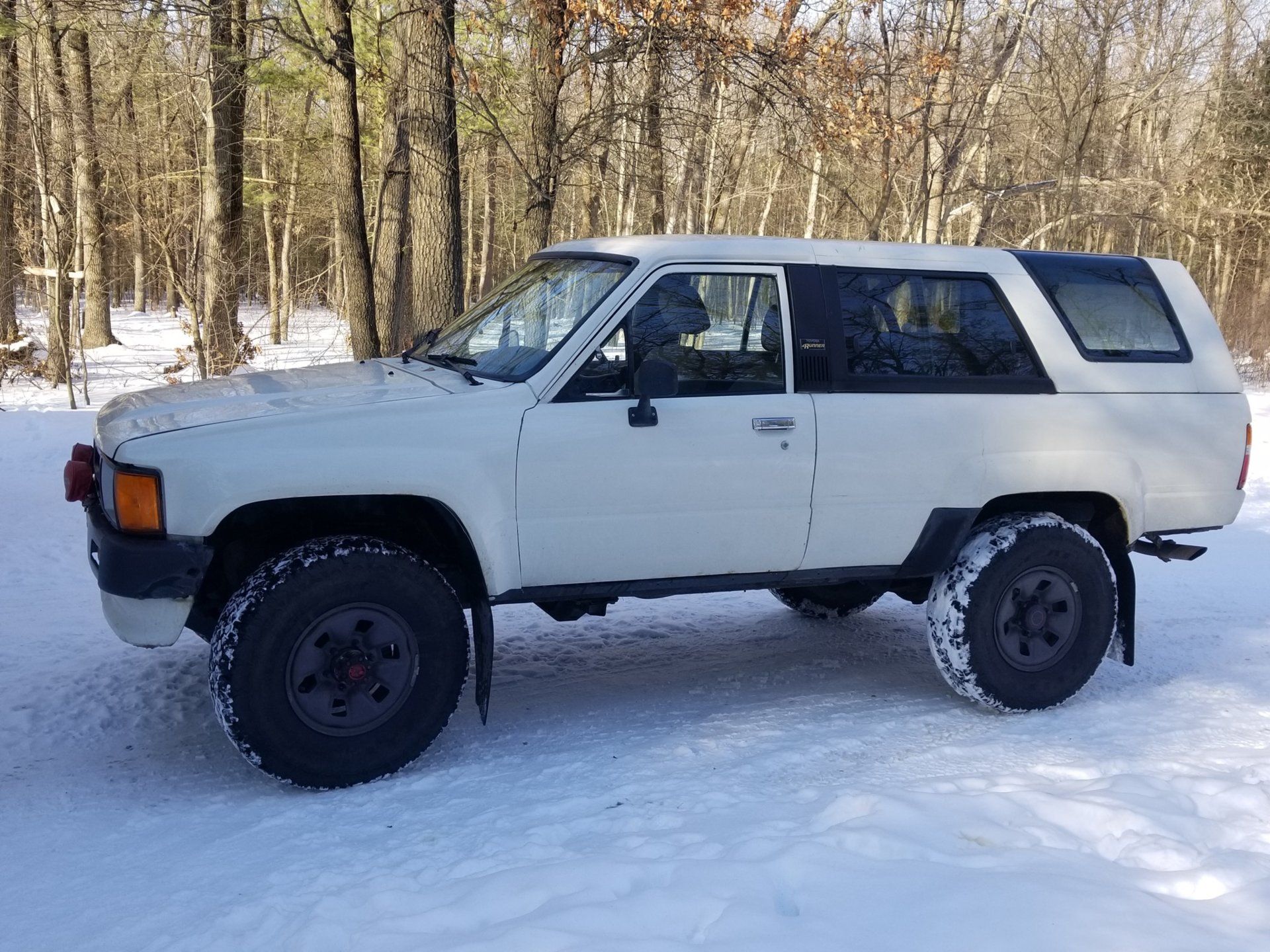

Put new driver door hinges on the skinner today. I guess at 32 years old even a light Toyota door can wear out the hinge.
Hinges were about the same price as pins and bushings, but I would not do them without taking the fender off. If my passenger hinges ever wear out, I’m just doing pins. Or pre-runner fenders.

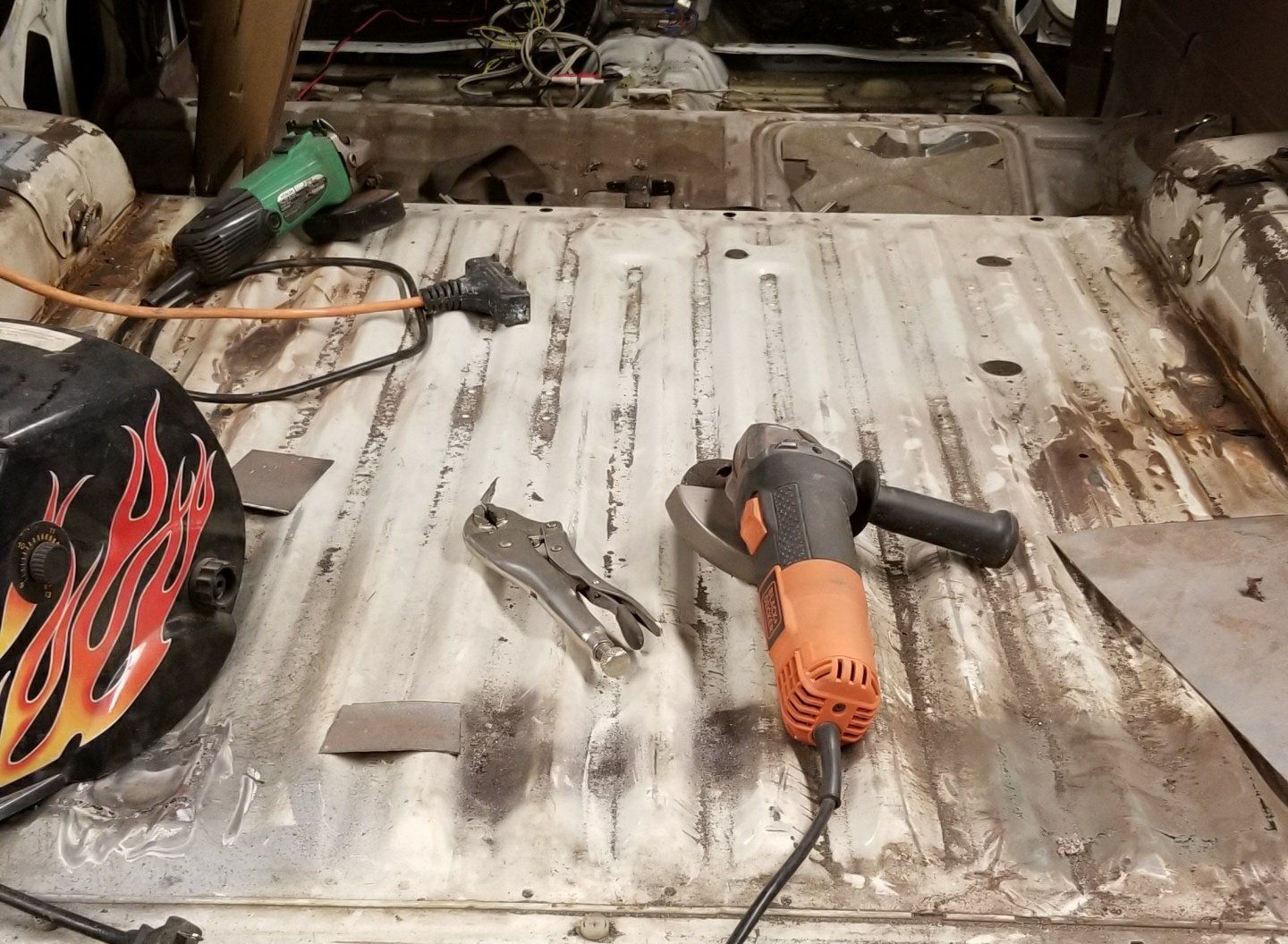

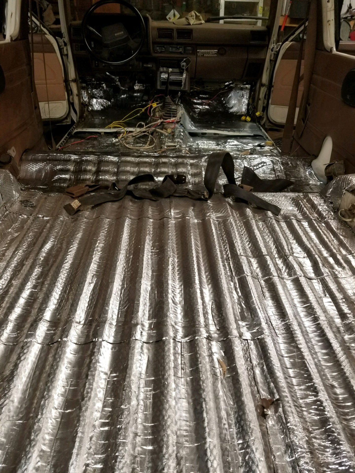

I used noico. You can get it on the amazons
Amazon product ASIN B00URUIKAK
I used this too. Get the roller for it, helps get it stuck down much better. I covered it with the Frost King adhesive closed cell foam. I've done the 1/4's to the door jams, need to do the doors next.
