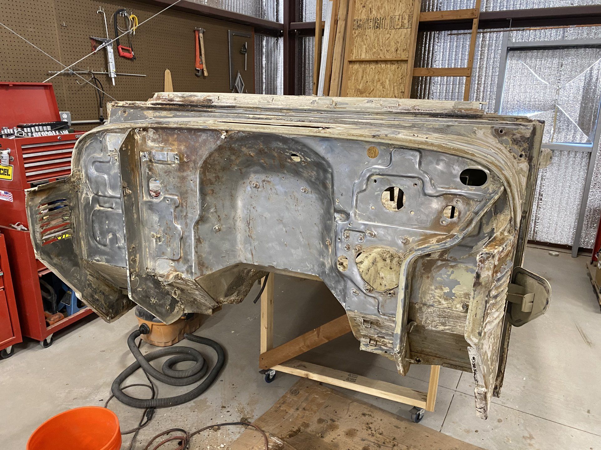

Chemical stripping and sanding ain’t going to be an option for me just too dang much work and too much mess. I called around for bids and leadtime for local media blasters but everyone’s very busy and very expensive. So I thought I’d give it one more try at home, and I added a little extra CFM from the rental shop.
After 90 minutes and $20 worth of media I got the firewall and dashboard stripped. It’s not necessarily a fun job but it is
satisfying. It’s kind a like cleaning your car with a pencil eraser a lot to do and small bites at a time. I’ll keep trying it for a little bit and if it’s too much I’ll take it into the pros

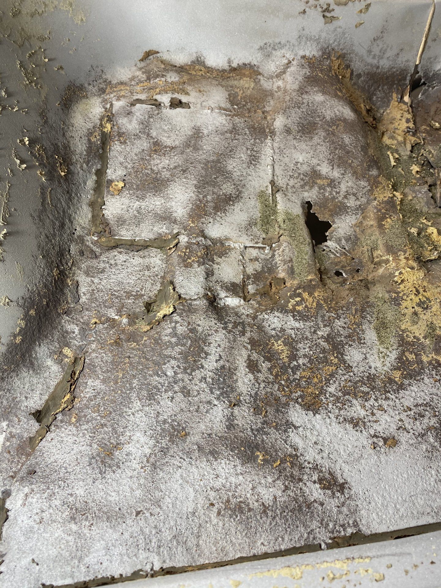

Today was my test run to see if I wanted to strip the whole thing and the answers no I’m gonna go ahead with the media blaster and let a pro do it. However I did clear up the worst rust areas on the floorboards and got a better sense of what I’m dealing with the passenger side had been patched with some steel plates and the floor pan underneath is Swiss cheese. The body mount on the passenger side is shot, I can’t imagine I’ll find one so I’ll have to fab something up.

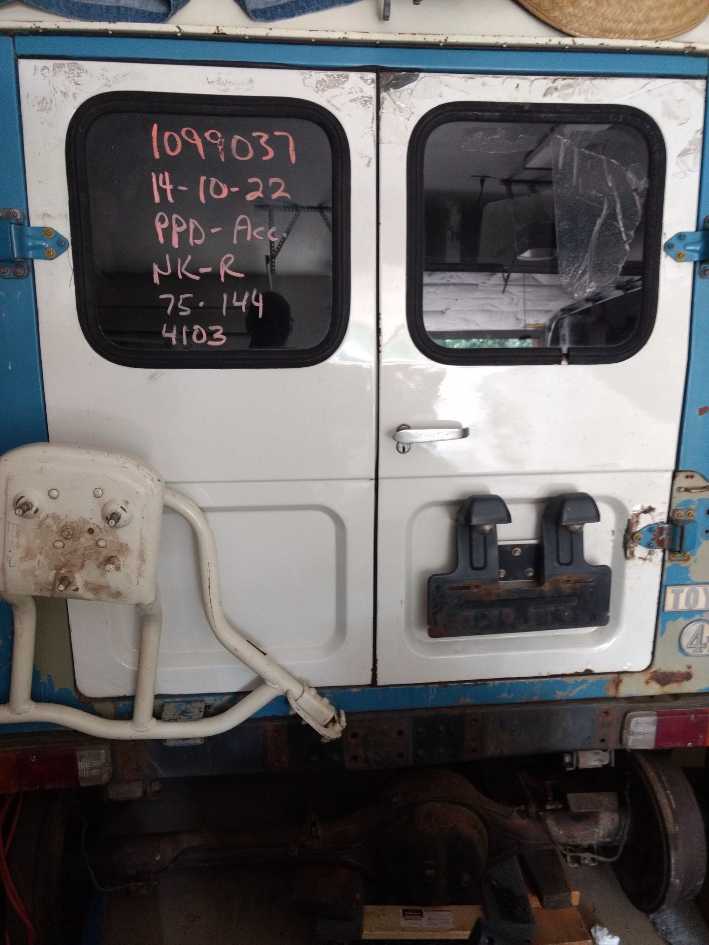

Only noticed the sold out because it did look like it would would have been a good option. Sadly a very nice 84 HJ47RV from Australia got totaled in Phoenix going on six years ago. Front end was destroyed but the back was actually is decent shape. These are the ambulance doors off that 84.
If timing would have been right would probably let the tub go for few hundred dollars. I know the troopy is long gone.

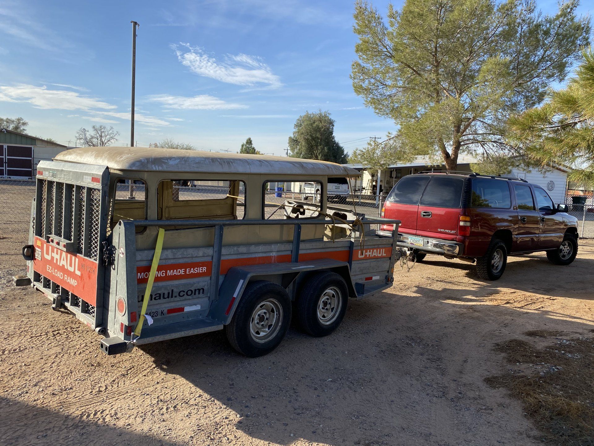

I was loading up the body parts to take to the media blaster, and the dang U-Haul trailer with the drop gate wasn’t wide enough to fit everything in so I had to go up and over kind of a pain in the neck but ended up getting it to the shop this morning may not get the parts back till after Christmas, everyone’s really busy right now
