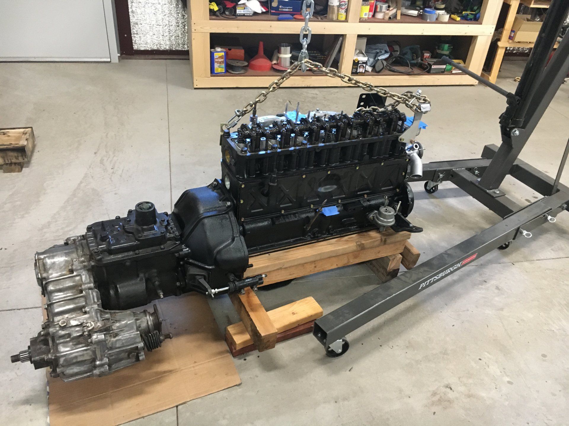

The white knuckle portion of the install is now over finally got the tranny and transfer case mounted in the whole unit tucked in between the frame rails. Slowly started to put the pieces back together.

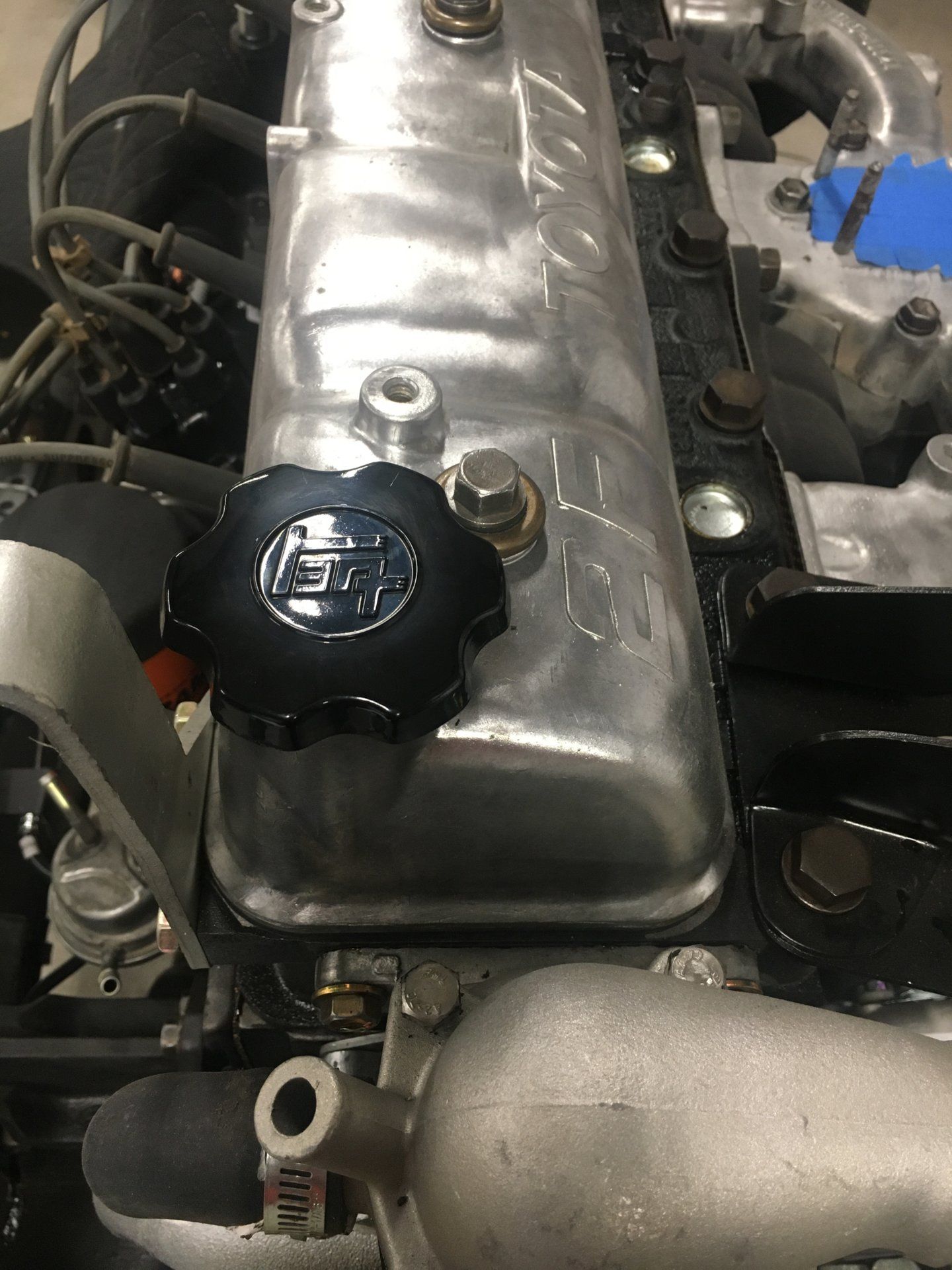

Well I had to go and tempt fate I want to take a break and do something fun and easy to clean up and put the fan back on only to find that the belt housing and mounting points don’t lineup. I’m sure it’s not a good practice but since I was stuck with this water pump anyway I pulled off the old molding plate and swapped on the new one will see if she works

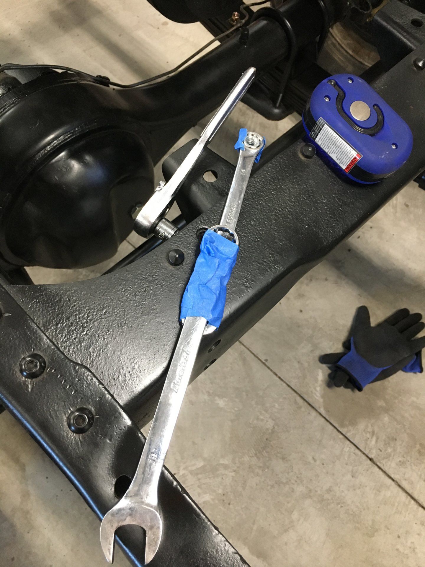

So today was supposed to be a light day putting the parking brake back together, like making a watch. But I come to find out you can’t slip the parking brake onto the transfer case while it is in the vehicle the crossmember interferes.
So drain some fluid, pull out the engine hoist lift it up enough to remove the crossmember then lower the transmission put everything in place and then reverse the process...... I’m tired!

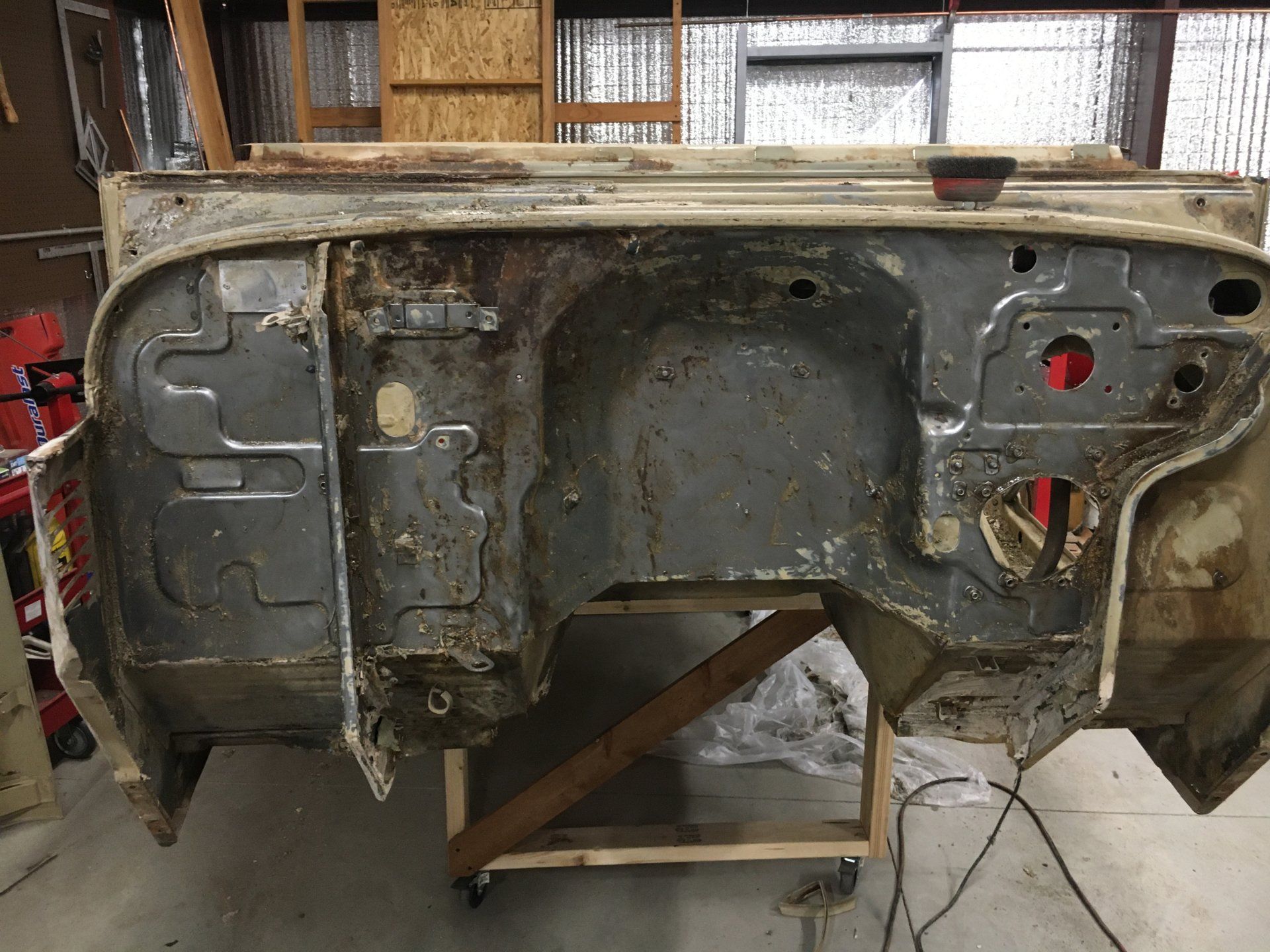

I know this is not a race but it was my goal to start bodywork in February and I plan to start stripping the tub next week. I know it’s the last week of the month but I unexpectedly lost a couple weeks to some other projects so I’m gonna call this on schedule.
I spent most of the day getting ready for the spring planting season, made a raised garden bed out of some old cedar fence boards lying around.
But I was able to do a little test strip on the troopy bed. I’m not a big fan of chemical stripping but I wanted to give this stuff a try since it’s much more pleasant to work with. Painted it on yesterday covered it with a little piece of plastic, and then this afternoon just a couple seconds with a wire wheel and it’s down to bare metal. I’ll try more later this week.

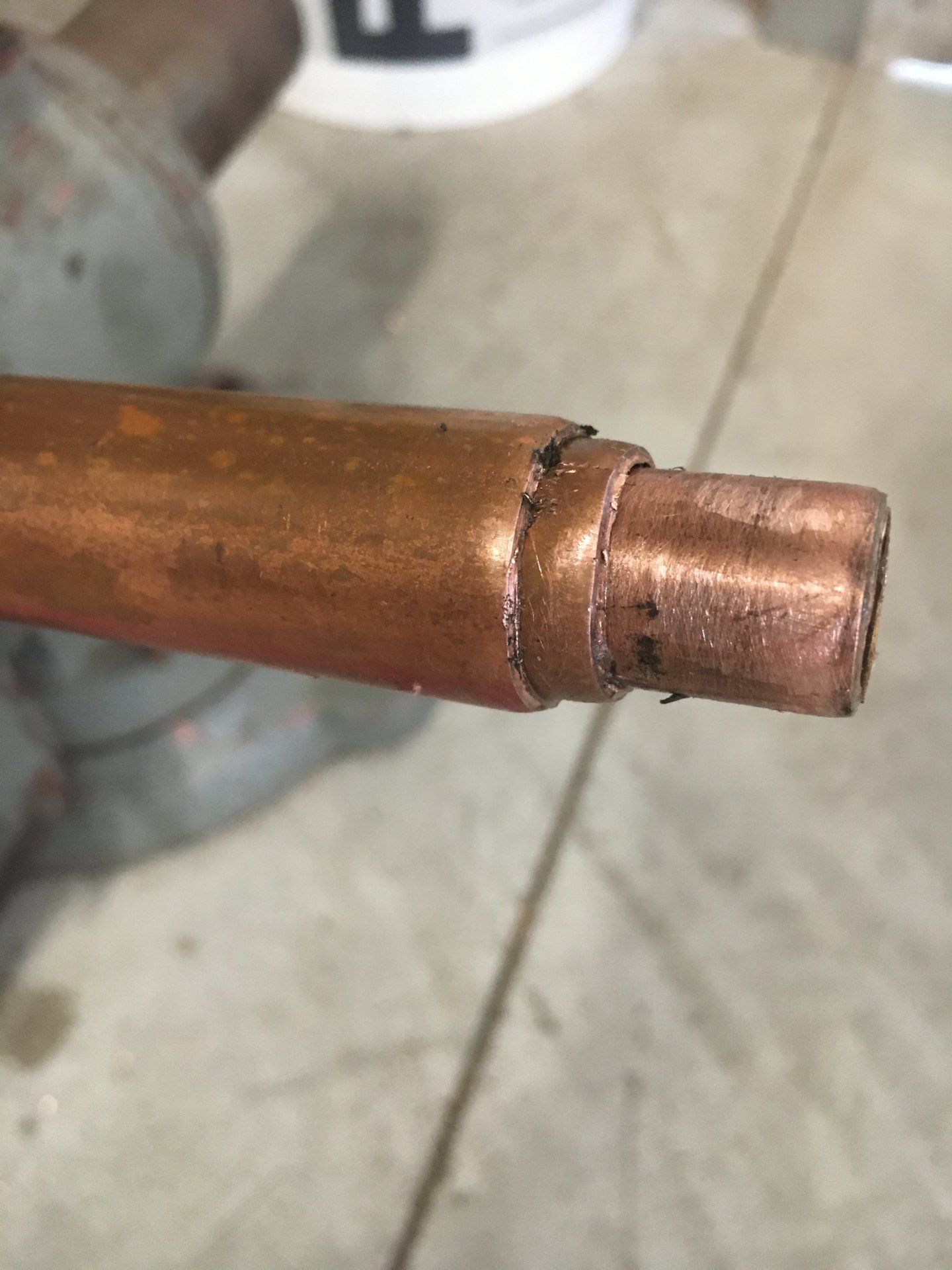

Took a break from bodywork today, and completed a nice to have and a half to have project and my cheap little blast cabinet. I repurposed some of the creating material from my metal building and put the blast cabinet on wheels so it’s fully mobile now. That was the nice to have, I also fabricated a new media wand that has much better airflow and now I get a steady stream of media at much lower pressure.
Are used some half-inch copper to make the suction wand and some three-quarter inch copper to make the vent tube. Then I cut a piece of three-quarter inch tube split it open trimmed it and made a filler between the two wands so I could side of the joint. So far so good
Next stop I need to improve the lighting inside the cabinet
I literally just did this last week on mine, but also added a new gun from TP tools. It is a night and day difference. Parts that I used to spend a half hour on now take only a few minutes. By far the best mods you can do to these cheap cabinets.
TP Tools blast gun

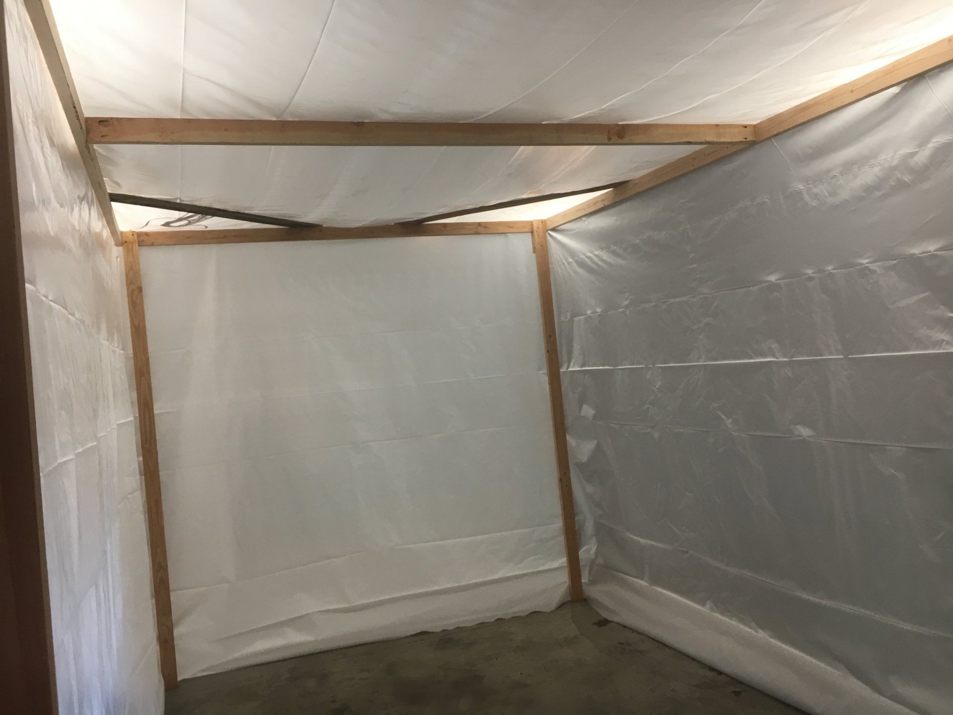

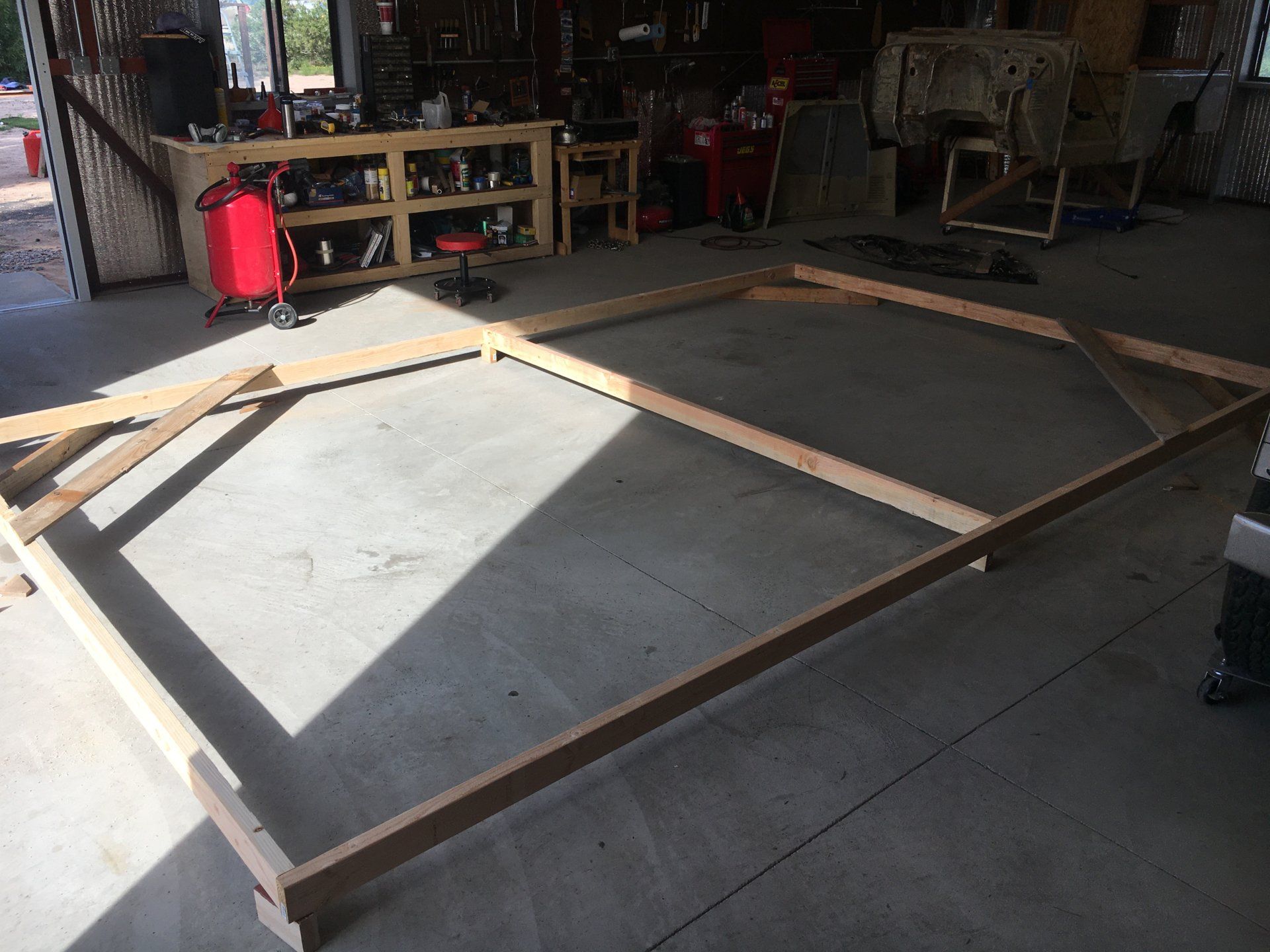

The blaster was working OK however I was going through media an alarming rate so I’m putting together a little blasting tent (16'x10'x10') to see if this helps I hope to at least get a couple cycles out of each tub of media

Well I’m a slow learner, the tent works great but a home blaster just can’t handle a big job like this. It would take for ever and bankrupt me for media.

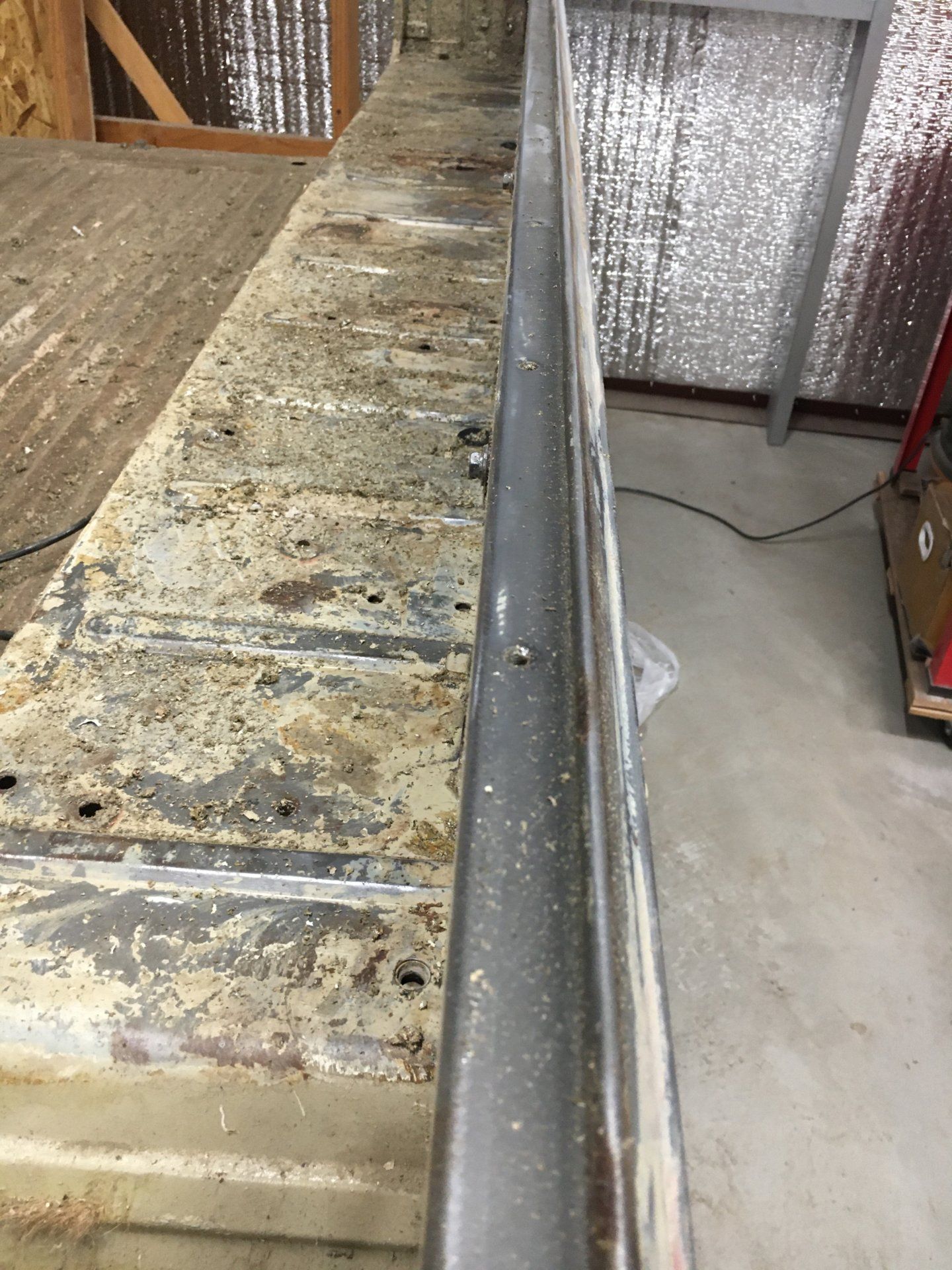

While I’m considering my options trying some new aproaches. I coated one panel and covered it overnight with some painters poly. That gets 75% off then one more coat and that gets the rest. I used a 4” grinder with wire wheel to clean it up.
There are at least 2 coats possibly more. Where there is only one coat ( rail under the top) it comes of great like soft butter)
