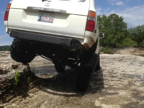

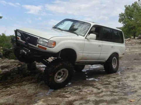

That front end looks like it is flexing very well, mission accomplished?
90% there on making that statement.
Here's the proof in the pudding.

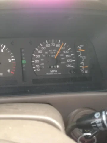

Not hardcore because we (son and I) were the only vehicle there and I like support. Regardless, wheel a few hours, then make the drive home at
and it's smooth as glass. No driveline vibes, Caddy-like plushness, just the hum of the Krawlers and 1FZ purring at 3k.
Need to finalize the resi mounts, since the trial run appears a success and get a rear sway that'll mitigate body roll, then I'll consider it a mission accomplished.
Driving home today was the first time I actually felt like all the issues were worth it.
(5.29s and 37s, no speedo correction, by the way. 75mph is more accurate and the speed limit).

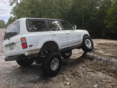

Member of CSC posted a pic of the LSPV bracket permanently affixed in the max diverted position, which I'm going to try. If it works, going to rework the lines and abandon the LSPV altogether.
First step will be measuring the variations at the rear corners with an instrument, instead of butt dyno, and seeing what it affects.
If butt dyno agrees, will test for awhile, then figure a way to bypass.
Declines today weren't as nerve racking as I thought they'd be, but with the crawler gears, speed can be controlled by throttle. At one point, I did brake hard, and the ass end elevated enough that I threw my arm in front of the boy, reminiscent of the days when Papa (pronounced Pa-pAW) would, damn near, bruise my chest in the old 1966, three on the tree, propane Ford that's brakes were merely a notion. Haha.
Speculation, but I think that opening the rear valve at 100% and gaining viable rear anti sway would fix the issues.
I'm starting to think the lack of a properly sized sway, along with the higher COG, has a lot to do with it.
Another "issue" is power steering fluid.
Relatively mundane run through the rocks, considering we were solo, yet PS faded to almost nothing.
We stopped, and after a few, I opened resi and the fluid was roiling, no bubbles, but obvious movement like a fryer.
Now, I'm not going to question Mr T's choice of ATF over PS fluid, but running synthetic PS fluid with a marketed higher boiling point, yet it was hot, very hot, and (assumption) lost full PS effectiveness because of.
I'm running a larger Jeg's sourced aluminum cooler, but planning to swap to an OE tranny cooler, plus swapping the OE resi for the largest I can possibly fit in that location.
Local crew plans a trip back next weekend, so going to get shock resi's mounted and general maintenance done, and give it all she's got.
Try to see at what point it all deteriorates and adjust from there.

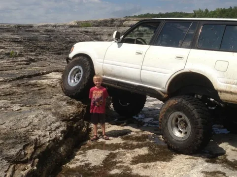

Mini-me (Gage) was more excited about spotting duties than I've seen him at Xmas, so all worth it for that alone.
