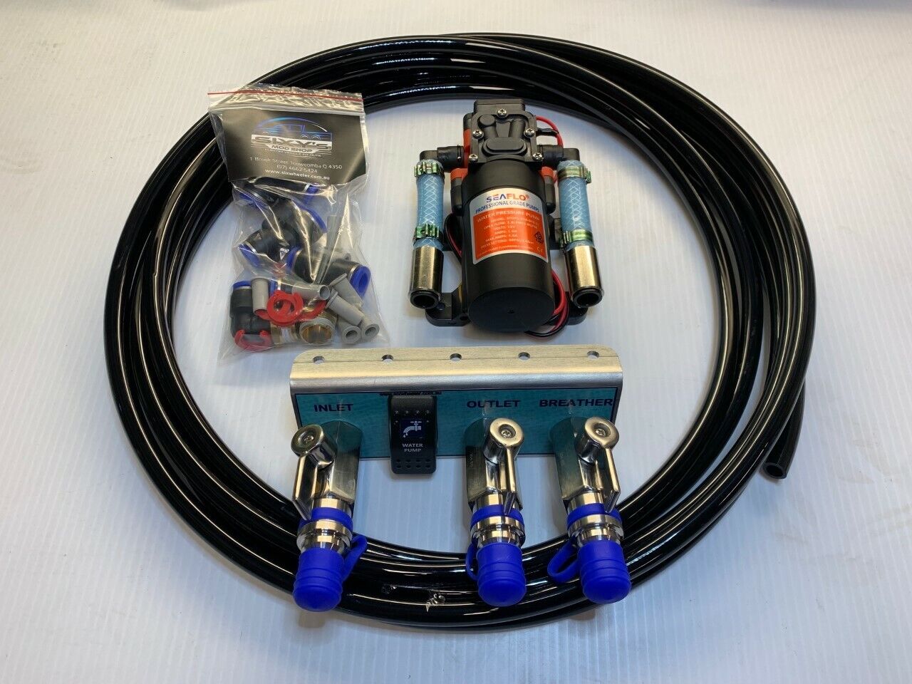

I've got to fit my 40L water tank to the chassis and then buy this to work with it, this plumbing and pump i want to permanently fit in the pig:

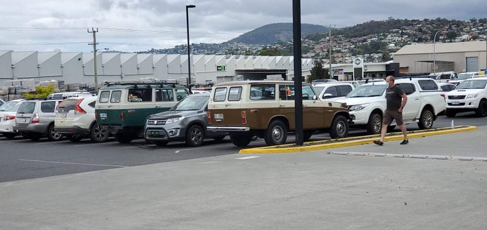

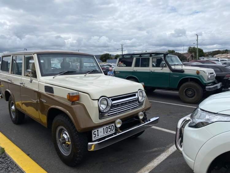

the stars were aligned today and both @Tassie tom and myself were at Bunnings at the same time..
We got to catch up and drool over each others pigs briefly.. its amazing to see this perfect example of a fj55 in the flesh

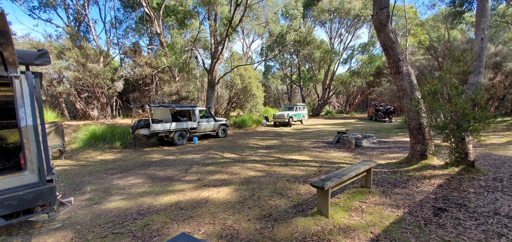

Last weekend was a long weekend for us so we camped at the block for the first time which was pretty nice. We had neighbours doing spotlighting and shooting the first two nights but the last night was quiet..

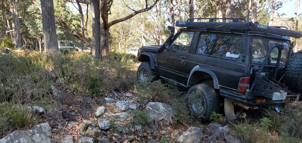

Then the weekend just gone I went out to Adamsfield via the Saw back track with the No Limits 4wd club. It was pretty dry and not much of a challenge but the old girls big bum copped a few decent hits... lucky no panel damage this time. I had the boy with me and we had a good time.
