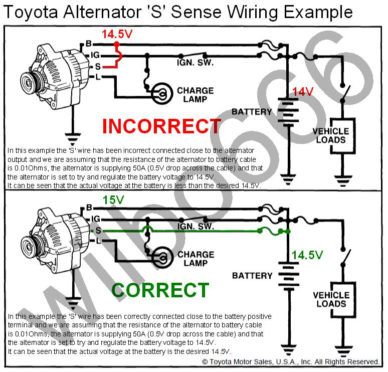

Are you sure you don't have a charge light wire at the reg plug? It may appear to be ~12v ignition as the alternator provides a ground path to complete the circuit on this wire when not charging. The charge light may be shared, eg may double as a "filter" light on the BJ73 loom with a diode.
possibly. do you think a continuity test between the plug and the charge light at the dash would confirm?

Yeah, just be
Yeah, potentially ;)
Just be aware that there's likely a diode so your continuity test may only work in one direction! Once you've found it, ground that wire via to see if the light turns on (preferably via the smallest fuse you have at hand just in case you've made an oopsie)
I'm not familiar with the internal functions of the alternator, some people say that an alternator won't work without the light wired, but I assume this doesn't apply to the the 3+1 Toyota alternators as they use a separate Ign wire. I guess if people say alternators need the light to be wired, some alternators (eg types 5 & 7 in the diagrams you posted) are fed ignition power via the idiot light, and feed ~12v back so the light turns off when the alternator is working (with a diode so it doesn't feed back into the entire ignition system). In this case you'd want to pay attention to the bulb check function as a dead globe could cause a failure to charge!

Depending on whether you're a perfectionist or not, sense wire ideally should be straight to battery via a fuse so it doesn't get voltage drop which could cause the battery to under-charge (eg from memory on a 40 series loom the WL wire at the regulator just T's the the fat WL charge wire), and I'd consider adding a fresh fat charge wire to the battery (I think my new int reg alternator I bought for my 15BFT was 2-3x the output of original ext reg alternator)
