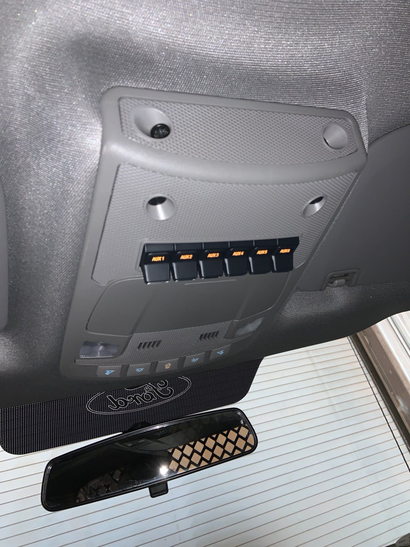

That’ll be nice having good mounting points for an overhead console like that. Definitely like the idea of overhead lights and switches and other things. 55’s are a touch shy on headroom which can cause an overhead console to walk a fine line between being handy and being an obstruction.
We recently got a 2019 Ford F550 where I work. The console in it is pretty sweet.
Valid point, well its a nice to have at this stage, if we're NOT short on head room at least theres somewhere to bolt things now.. Also considering replacing the single interior light with the 1st, 2nd and add a third row interior light/ with door trigger function.
