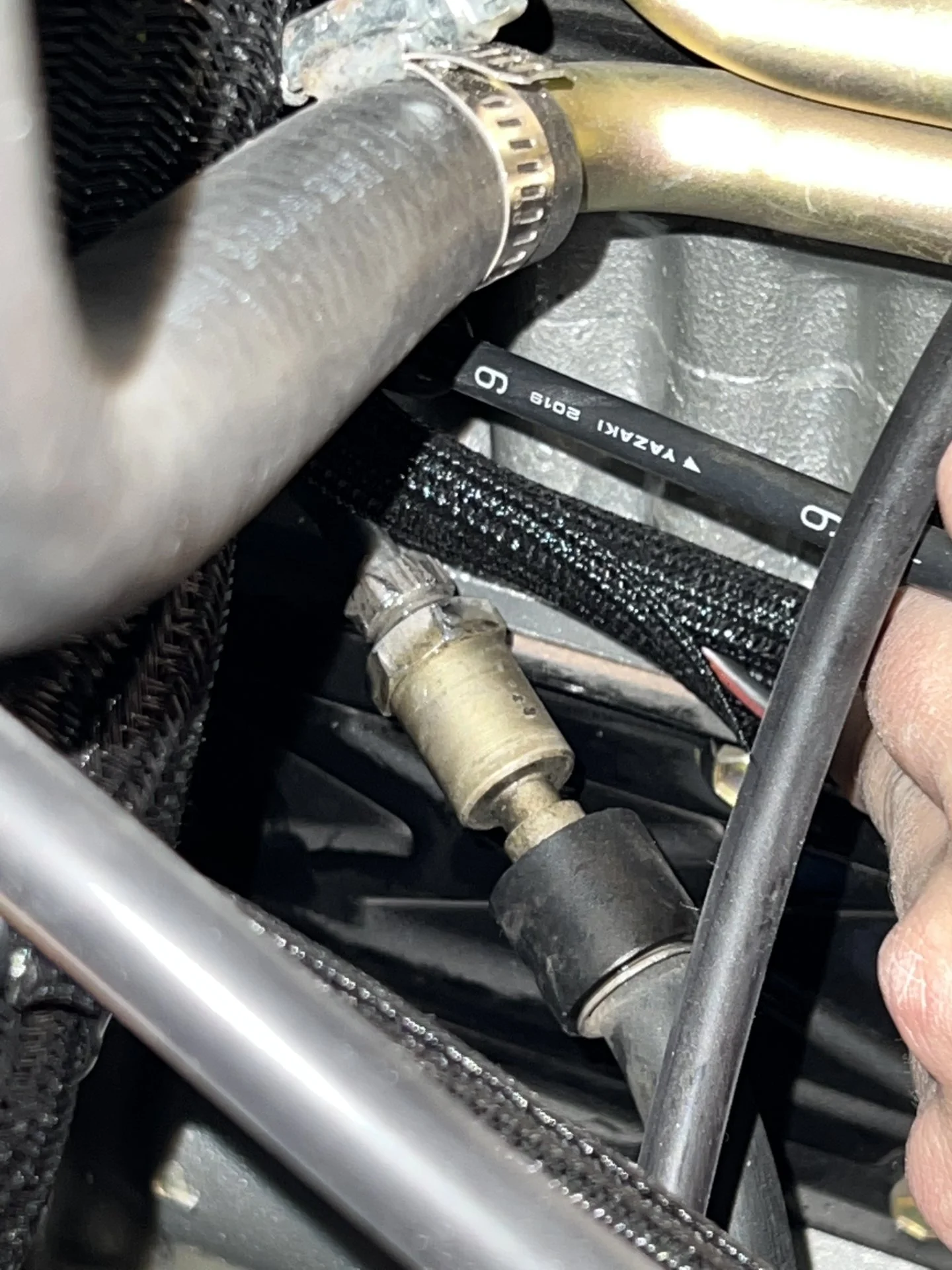

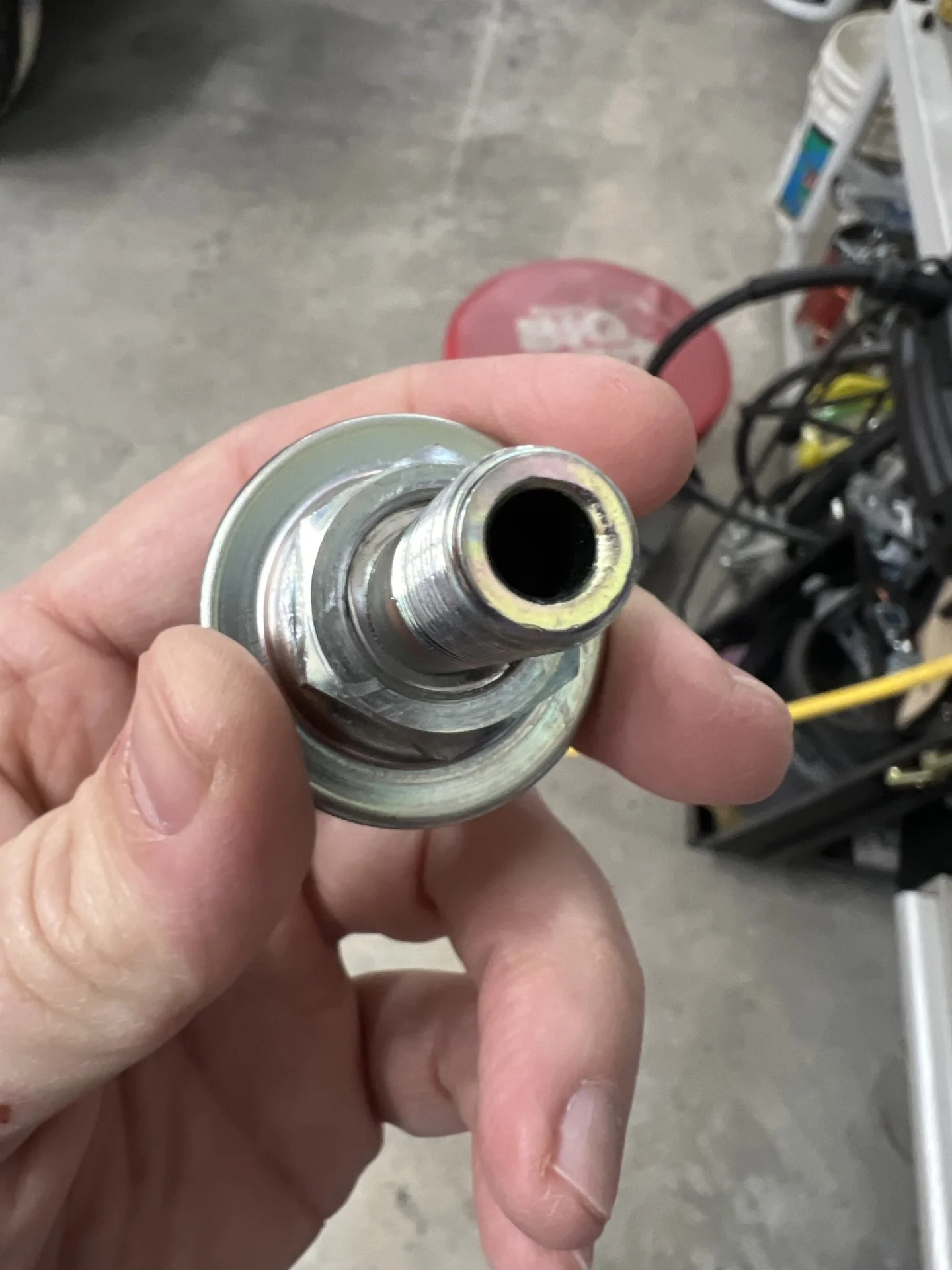

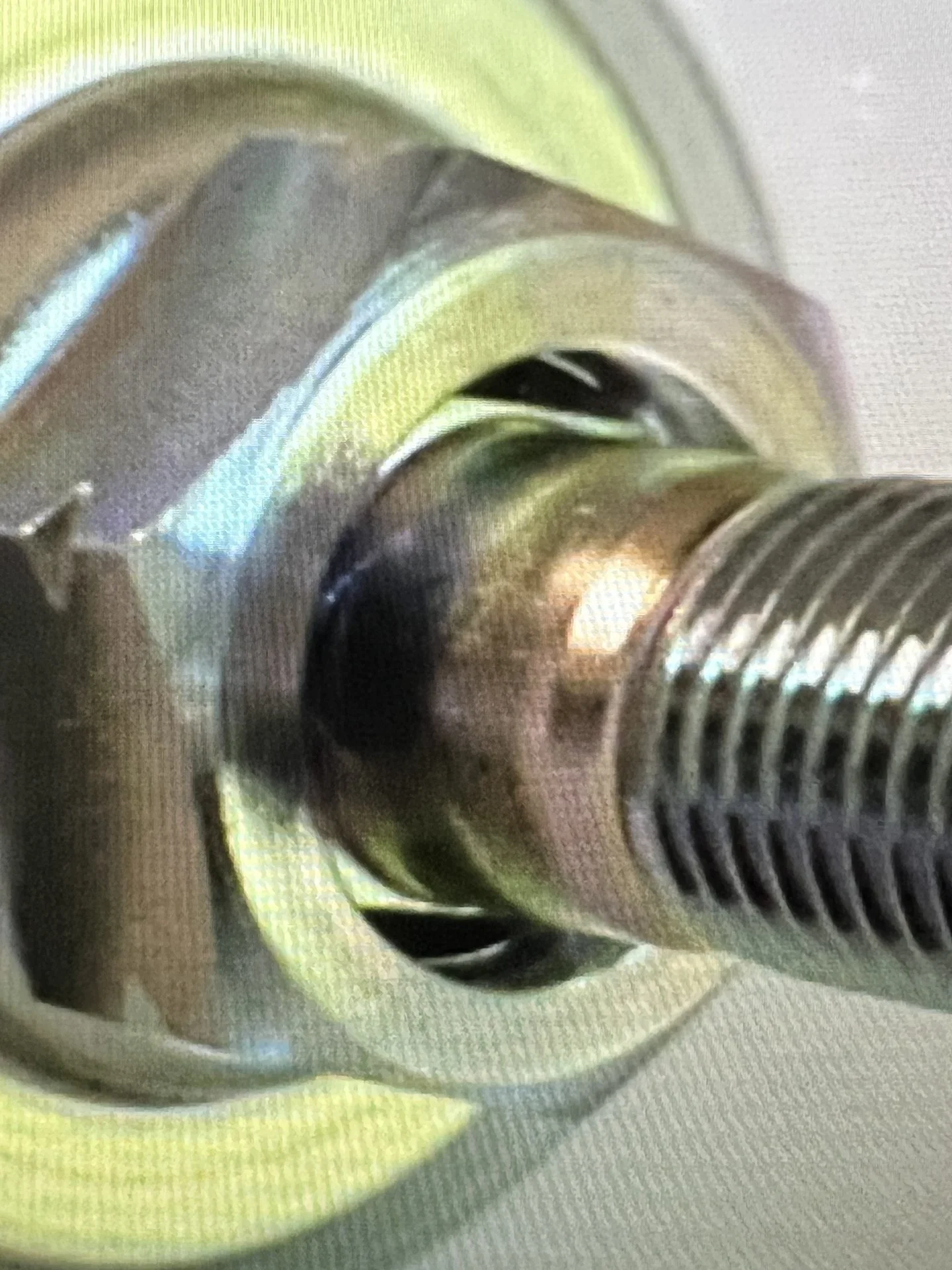

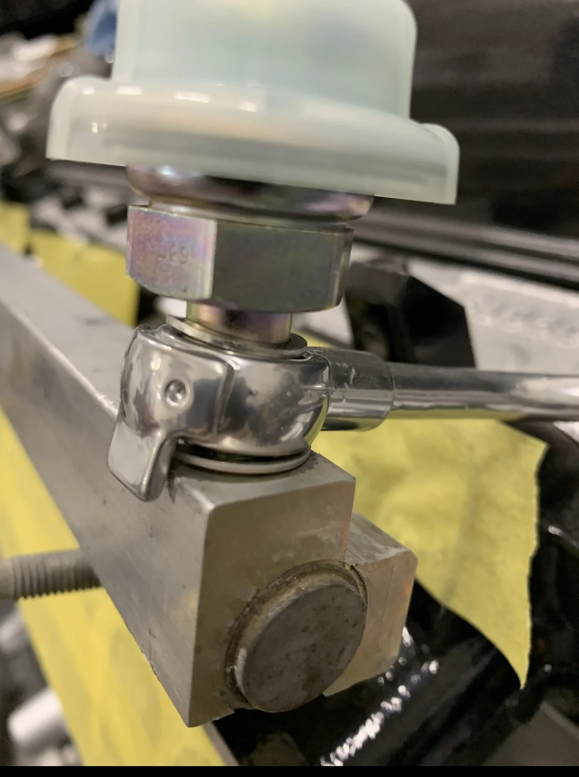

I will when it works. Tried to start it up, but had a few problems. I have fuel leaking from both sides of the hard return line that goes around the back of the engine (3FE). Fuel is leaking from under the pulsation damper, and from the connection to the soft return line. On the end under the damper, I have a suspicion on what might be the problem...I think when I powder coated the hard line, I didn't cover off the ends, thus not getting a good seal. Here:
As for the other end, where it connects to the soft return line, this has me worried. I cannot get it any tighter since it is so hard to get in there and work...not enough leverage, and the tightening bolt is already not in great shape.
Gonna see what I can do today. Aside from those problems, I am not sure I am getting spark when I turn it over. I guess it was too much to expect everything to work beautifully on the first try.
Your pulsation damper/banjo bolt connection photo, looks to me like the upper crush washer is too small on the outer diameter to seal? The lower one looks to be quite a bit larger.

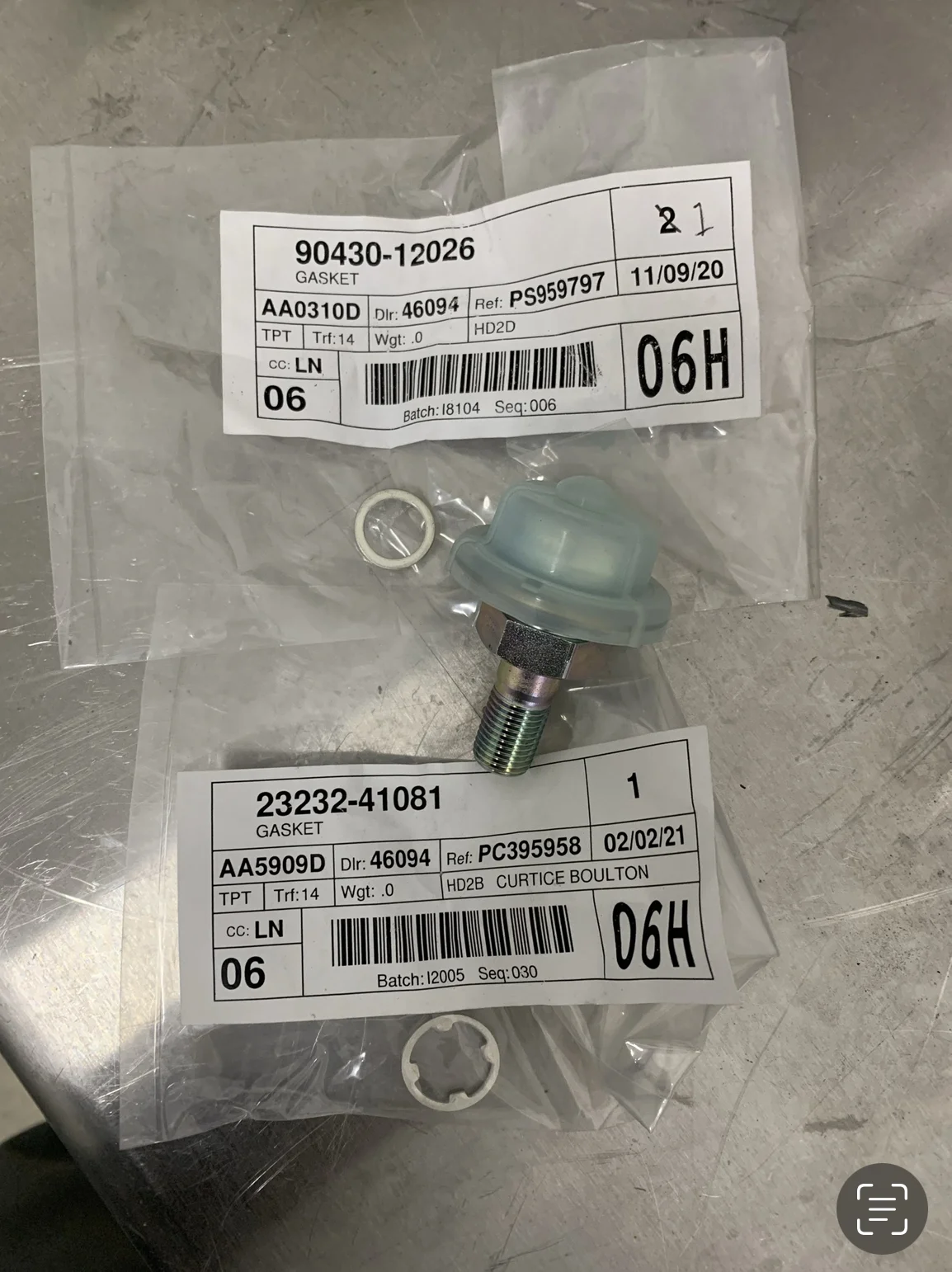

Thanks I agree, but I double checked that I had the right part number. And this photo I took before installing it shows the gasket is the correct pn, at least according to Toyodiy.
OK...figured it out today. And @Andrew S - you are on point. That is the order I assembled the crush washers, but they are wrong. I refer to Toyodiy.com quite a bit for part numbers etc. and up until now, it has been great. But according to that site, the part number for the tabbed washer (23232-41081) is the lower washer. But it is actually upper washer. This makes sense since the gaps in the washer are needed to let the fuel flow through. I figured this out because based on how I had the washers, I could not figure out how the damper worked, since it seemed to block the flow of fuel.

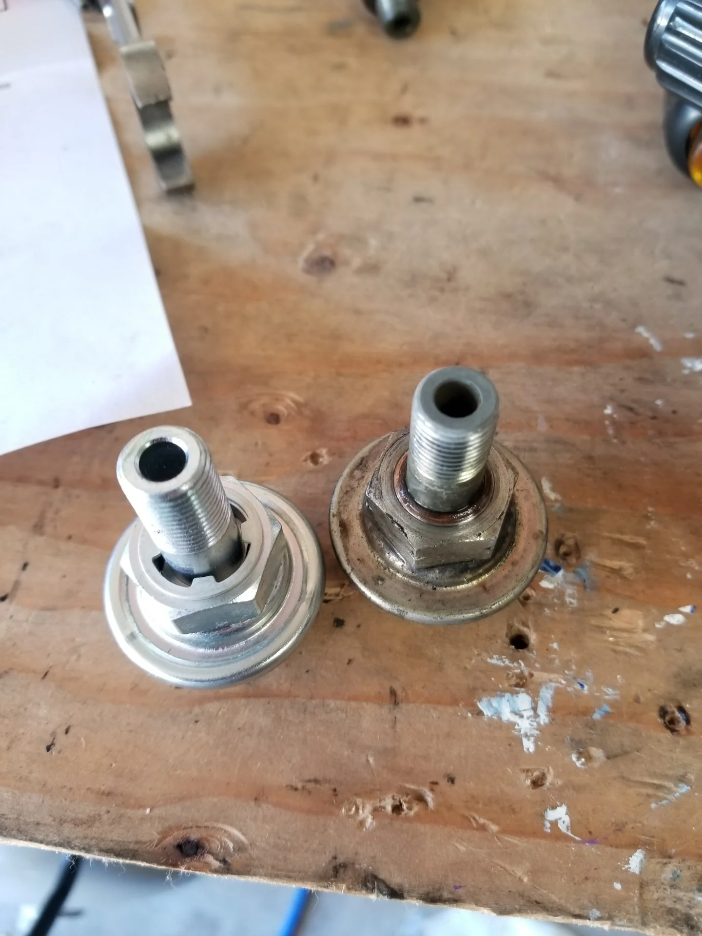

Unfortunately, that washer is jammed in there and impossible to get out, so I need to order a new damper and gaskets. It appears I am not the first person to have the problem, I found the below on another thread...one on the right is wrong, like mine was. One on the left is how it is supposed to be:
Anyway, so because of that, fuel was being stopped at the damper and not even going into the fuel rail. I assume this is why I was leaking so bad to, because there was all the pressure from the pump and nowhere for the fuel to go, since it was blocked. Also, this is why the engine wouldn't start (hopefully).
