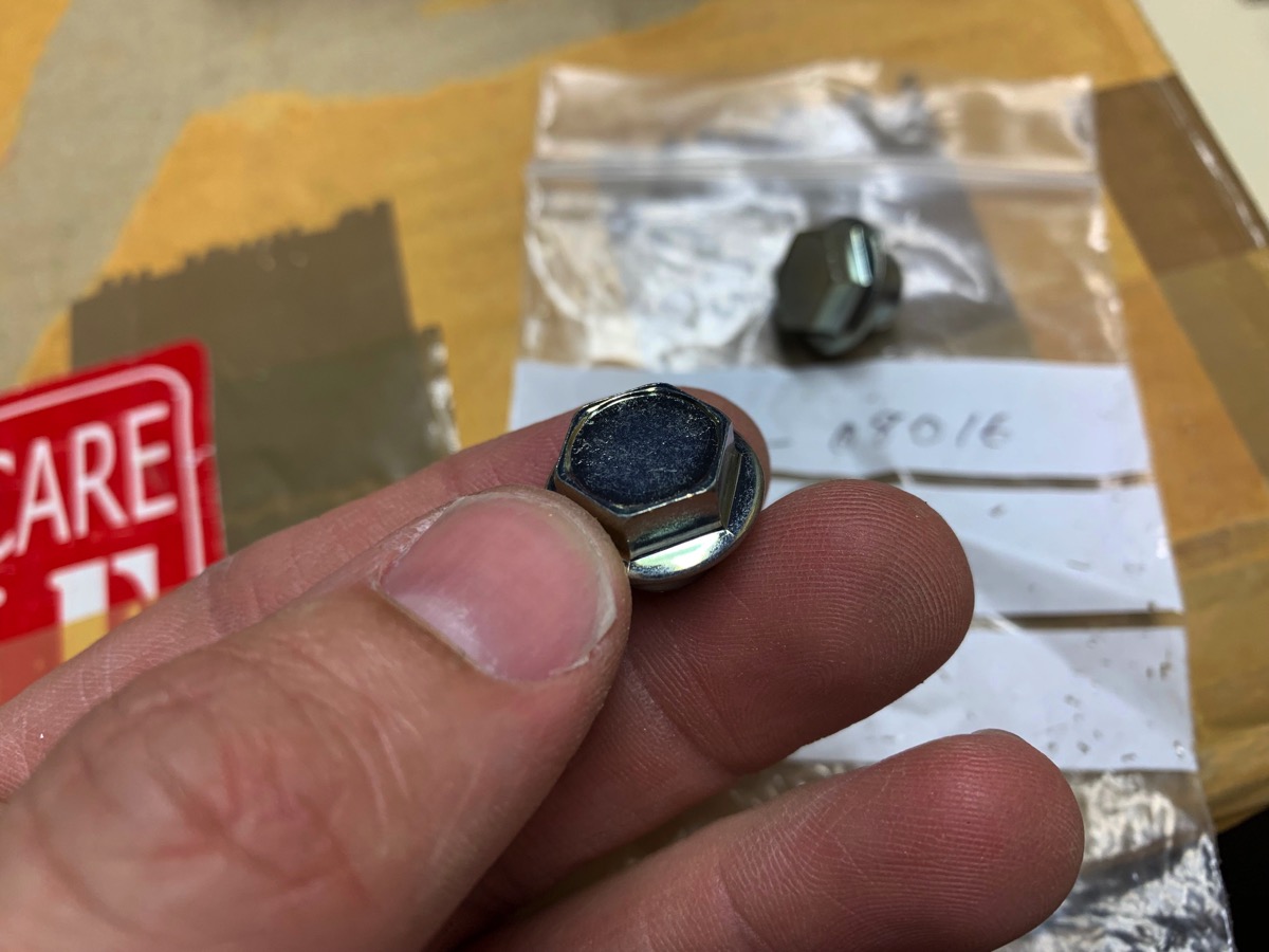

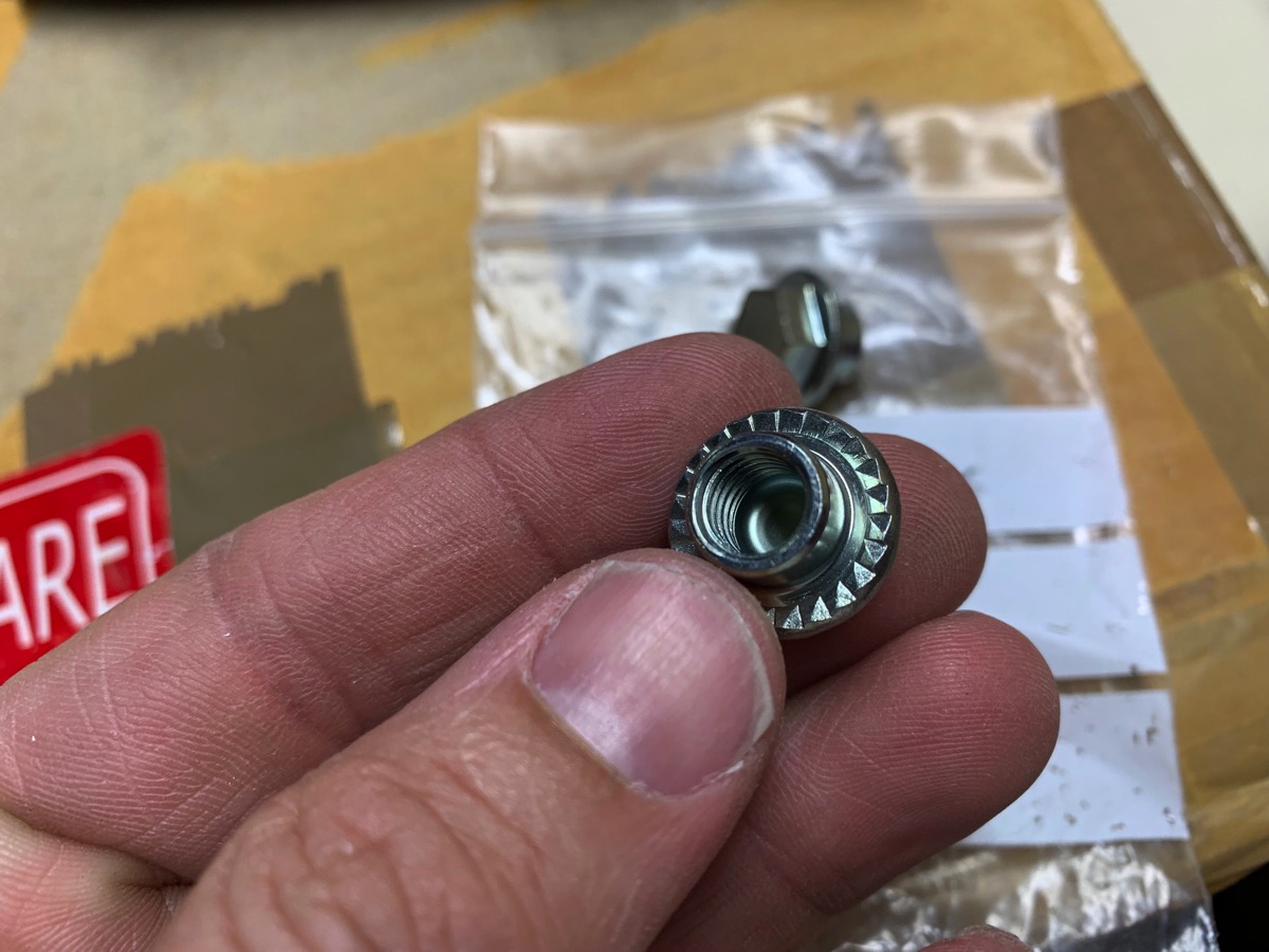

My 75 had some wonky wiper arms on it when I got the truck and oddly screwed in wiper blades. I replaced all and had to use more modern part numbers from an FZJ78... my old numbers were similar to yours.
You may also want the proper nuts... 90176-08016.
If you don't already have this sorted.
Great information!!! added to the parts list.
