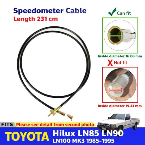

83710-60370 speedo cable says no longer available, anyone know of other options for it..... looks like every other older toyota cable.
I will go ahead and pull it out and measure the length, I assume that is the only real difference....
Something like this should work, I would think...
UPDATE: took it out this morning, 88 inches long, same ends, so ordering this one.
